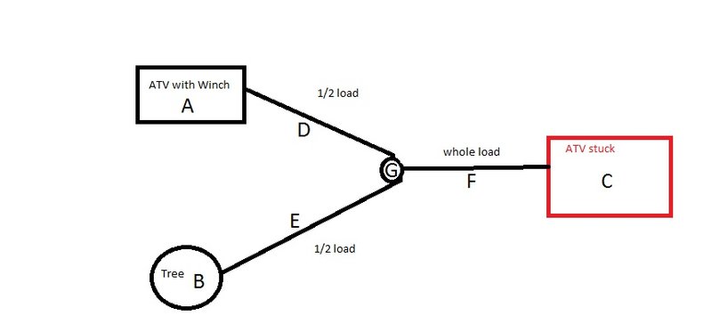

    Wrap a tree saver around a tree (which isn't shown in that picture), with a D ring hook that to a snatch block. Run your winch line through the snatch block and to the stuck vehicle. This is a snatch block By using that he could get a better angle to pull the truck out versus having his truck right behind that ford ranger.. Not much room to work then

    Forget F and C, A is @Bobert14 's truck and B is the stuck ranger, G is the tree with the tree saver and snatch block.

    The snatch block lowers the resistance on the line and at the same time "saves" the bark, since the bark is the only living part of the tree, from being ripped apart.
    The snatch block theoretically doubles the pull power of your winch at the same time.

    If you look closely, he actually has a 2/1 purchase on the truck! A block on the tree, a block on the victim truck, and the hook end to the tree! Smart!

    Yep, ran my winchline through a snatchblock attached to the tree via a tree saver and then to a snatchblock on the back of the ranger and back to the tree. Pulled it straight out. He's so freaking lucky his pickup stopped where it did.
