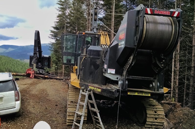

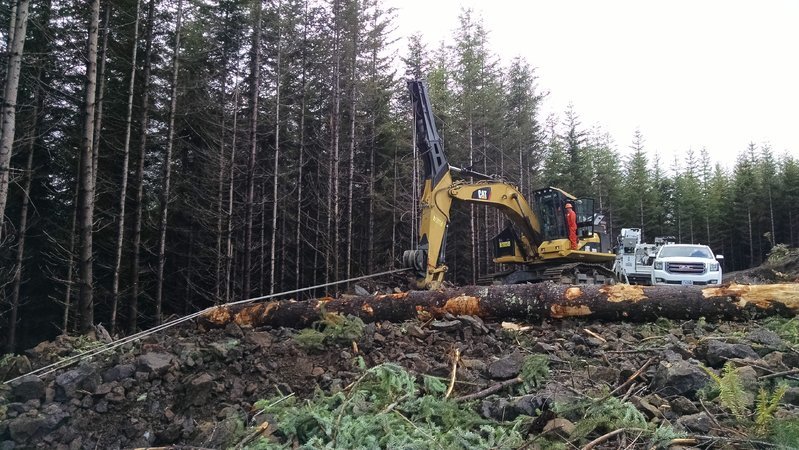

    When you need two winches to assist a machine up and down the harvest unit.

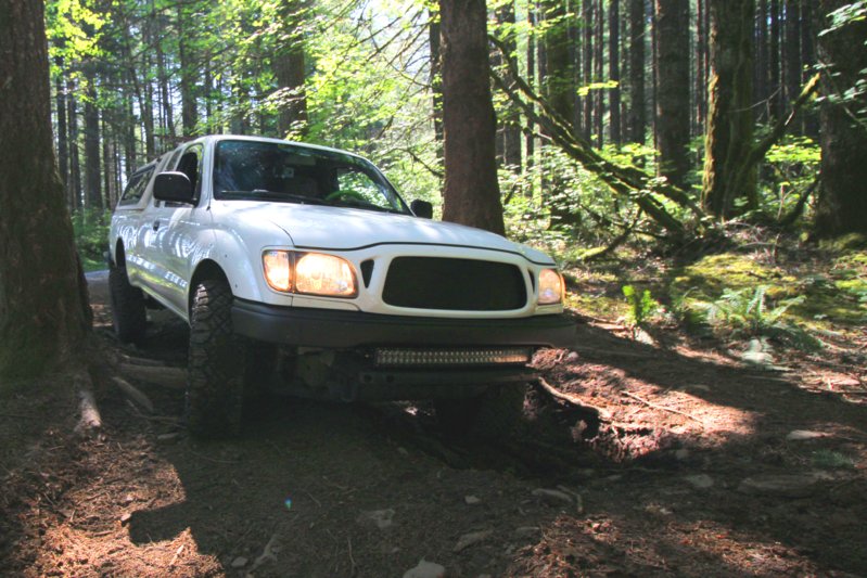

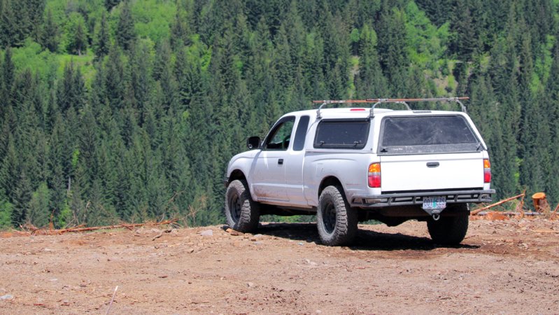

    Haven't been active here for very long so I wanna know: How many people are in/around Corvallis?
    I see @Bobert14's truck parked during the day all the time and I definitely know that machine shop @04LTtacoma, I'm assuming you must be taking ME250 right now? I saw another very nice white first gen going down HWY 20 headed toward Corvallis with a topper, swingout, and a bit of a lift I think?
    I'm around Corvallis and Salem/Keizer a lot,IMG_2327.jpg IMG_2353.jpg if y'all see me.

    Welcome man. Sweet lookin rig. :thumbsup:
    Nice to see another 1st gen in here.

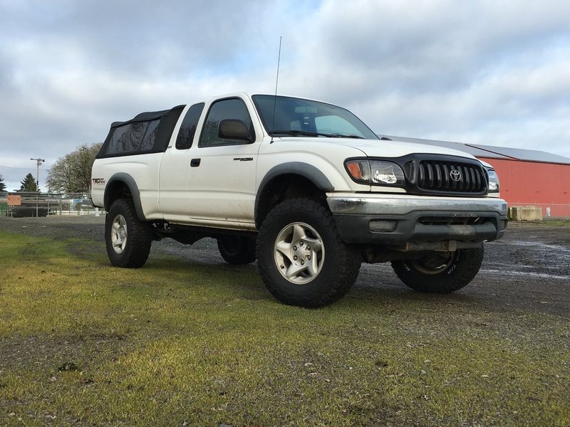

    Im in Corvallis, I go to OSU. I haven't seen you around but our trucks are pretty similar,
    Ive been running around without the windows in the soft top lately, also look for the California plates.
    yankeehilux[QUOTED] likes this.

    ^^^ Nice! I like the black and white theme you go going there.
