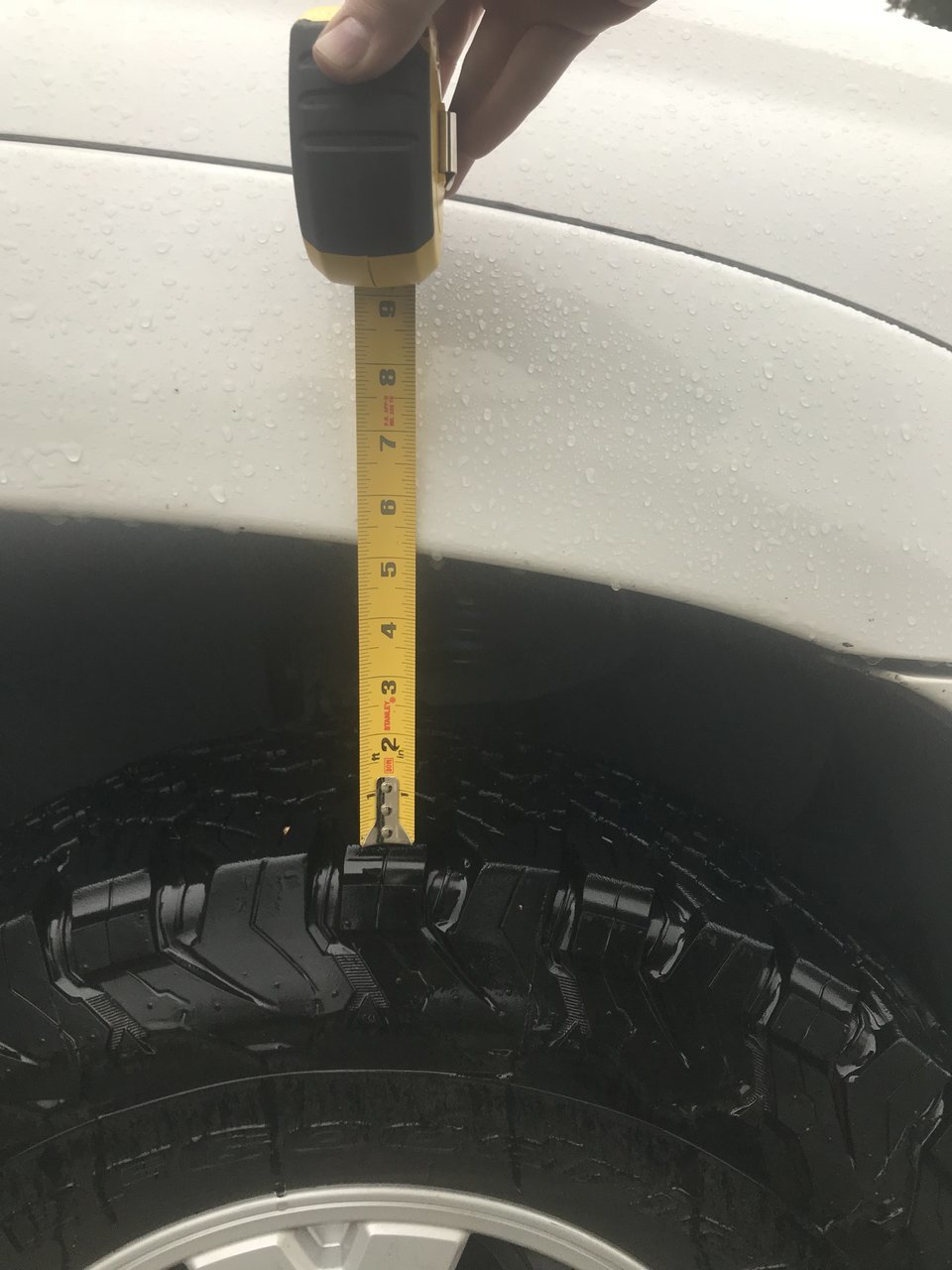

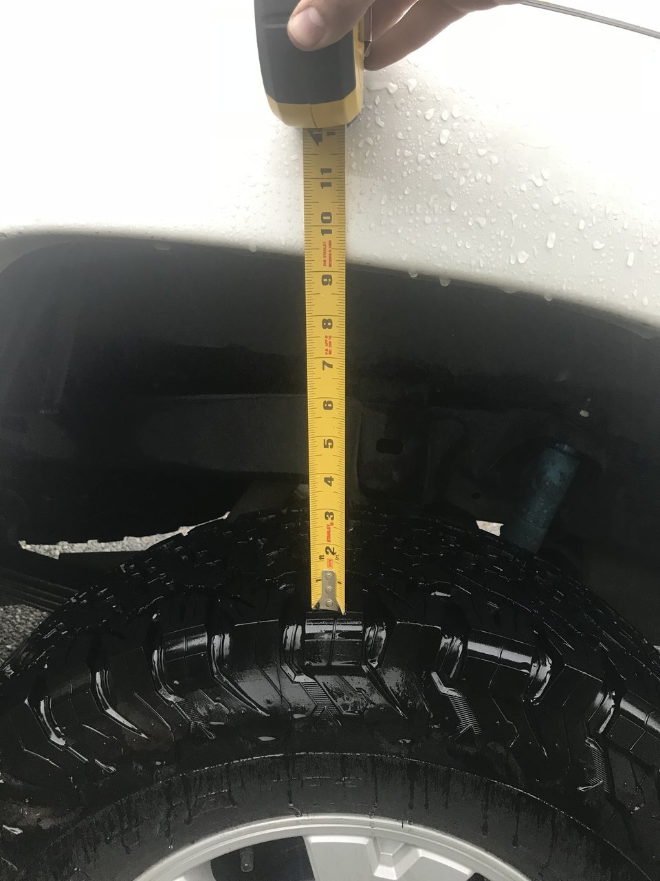

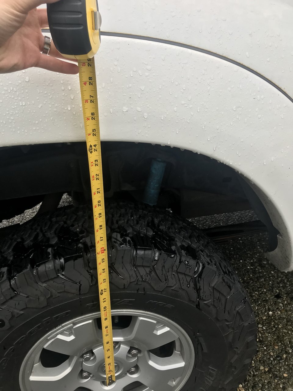

    Measurements

    Just a fyi, you should measure from.the center of hub to fender line for a more consistent way to measure height of the truck or lift over stock. Tire wear will mess with the magic number you're looking for.

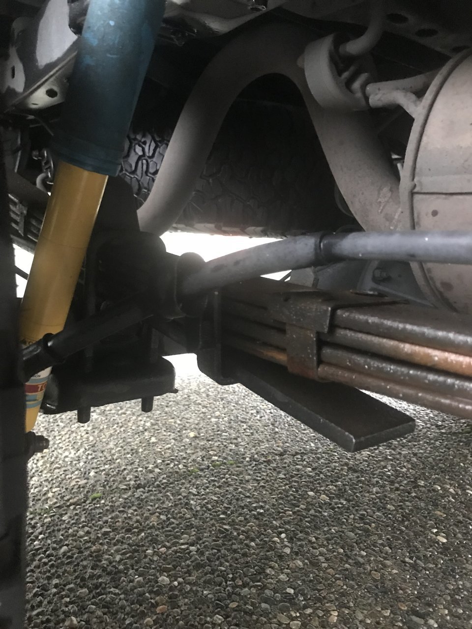

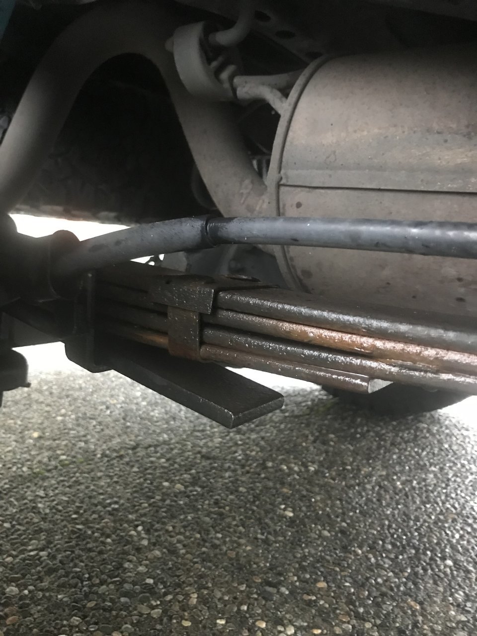

    So here is fully story.
    I bought truck from Tacoma Motors Northwest located in Tacoma. October of 16
    I thought the truck was stock, apparently that was wrong.
    Recently I decided that it would be beneficial for me to replace said suspension because it was riding super rough.
    @danneskjold upgraded his suspension for his 2017/18 Off Road Tacoma with 5k miles on it I believe.
    I took that suspension from him (front shocks/coils), Rear shocks, Rear leafs.
    I did not install the leafs because the one on there were not sagging. The difference between then 17/18 leafs and mine is 1 leaf on mine.
    I believe my leafs were upgraded due to TSB a recall done by Toyota. So perhaps stock but not stock.
    Even if I dropped that three leaf suspension in I don’t think it would really drop that ass that much.
    Pics below
    With previous suspension
    After putting 3rd Gen on.
    Drives side bent and uncompressed.
    Both drivers and passengers side.
    Rear Strut
    Maybe a leaf mount to help

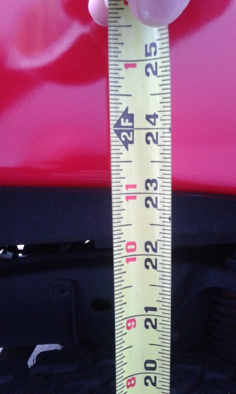

    Measured from hub center.
    Front: 5100s set at 0 with 884s
    Rear: TSB leaf pack with AAL.

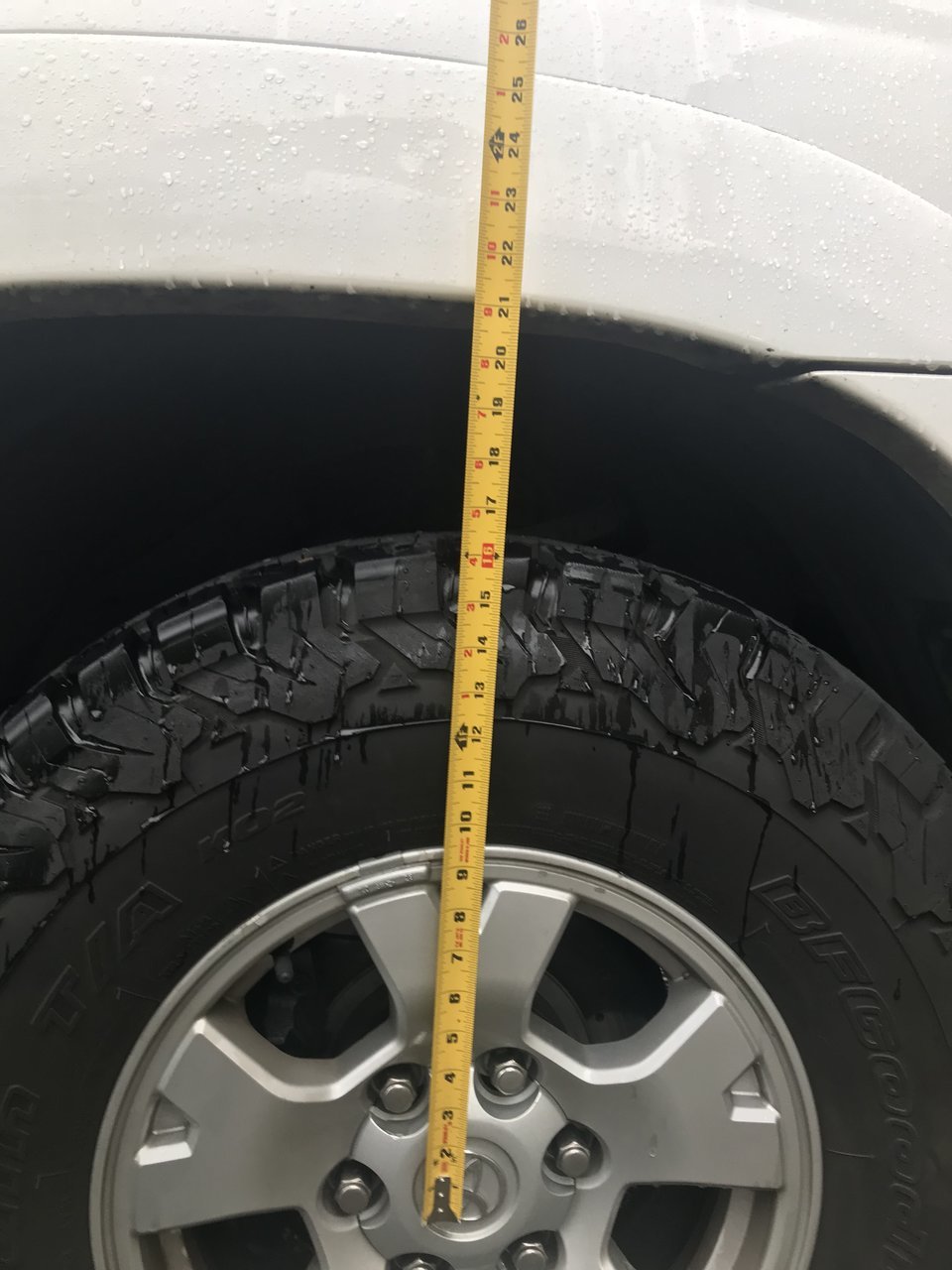

    I double checked after photos.
    21.5 in front
    24.5 in back

    How can I be taller and you have 4 leafs with an extra AAL?
    Maybe tire size?

    Non-OE springs that provide lift. Measuring from hub center takes the tire size out of the picture.

    The center of hub to fender measurements takes tire size out of the equation.
    What if that’s AAL with the overload bar still under it?

    Yours are probably aftermarket.
