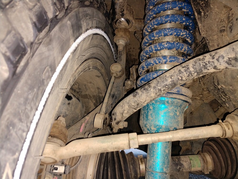

    Here's a pick of the damage, anybody got any ideas?

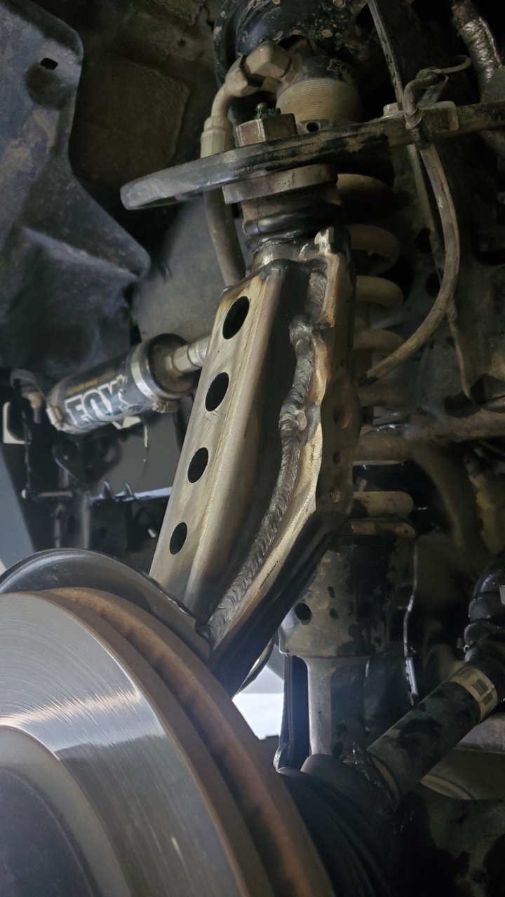

    Spindle. it's the only thing that will allow the tire to rub on the spindle. Someone had a pair for sale in the pnw for $150. I would suggest buying them and doing gussets

    That's what I thought, man I was talking about doing spindle gussets on Saturday as on my list of to-dos.

    I considered buying the set posted and doing gussets instead of pulling mine off to do them but you need them more than I do.

    Here they are, probably worth grabbing the lca's just in case yours is bent also.

    Spindle gets my vote as well. It's a known weak point.

    If you need some guessets glued on your next set of spindles, let me know :welder:
    I just have some Total Chaos ones on my spindles, but I'd definitely reccomend the Jd Fab or Dirt King guessets.
