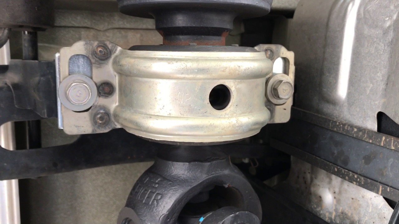

    Hopefully a dumb question but can you mess up the carrier bearing spacer install? I added a half in carrier bearing spacer and now I have a little whine. Notice on this picture the bracket holding the bearing allows for adjustment forward or backwards. I just ignited the bolts not really thinking about aligning anything.
    I also installed Spidertrax 1.25” spacers in the front but that was straight forward

    You want the bearing under no strain front to back. Adding in those spacers changes its location front to back slightly, so looks right to me.

    So a couple thoughts on 1.25'' spidertrax wheel spacers and carrier bearing spacers. I added carrier bearing spacer and it didnt get rid of the slight vibration I developed after installing the add a leaf. Not sure if I should now just remove the spacers from it.

    I've always ran no carrier bearing spacer, but have "flipped" the carrier bearing bracket upside down which slightly raises the driveline. Helped with I first did Dakars, now running a different leaf setup though.

    Interesting because I thought you wanted the spacers to help correct the angle after adding a lift in the rear. You are saying that you rotate the bracket so it sits up higher than stock and therefore making it more of an angle?

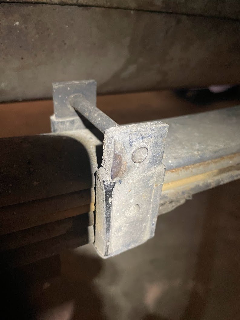

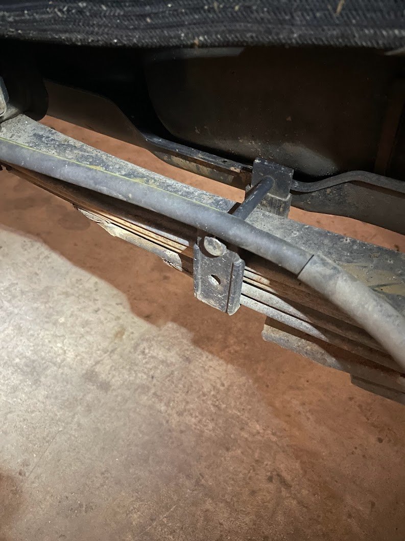

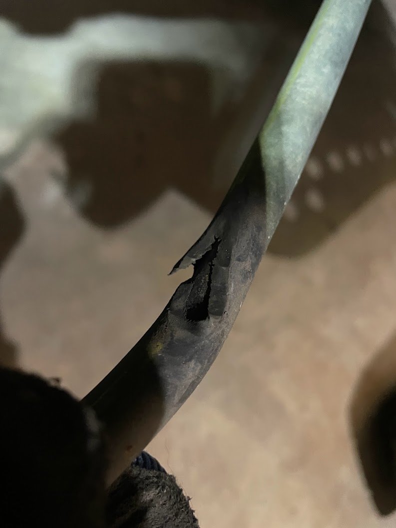

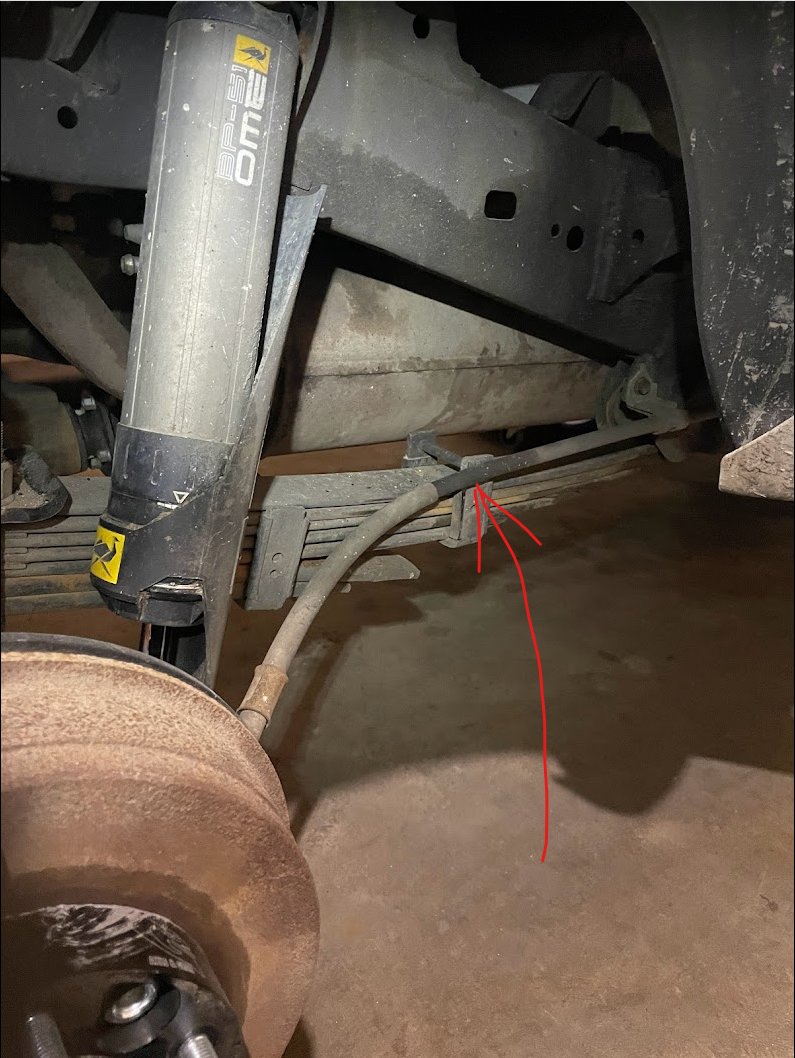

    Can anyone tell me what this line is near the rear leaf springs going to the drum brake?
    I just noticed that it's been rubbing on the leaf pack shackle and has now worn through some.
    JYIwxAAKc6Ud2760A_oXdHN3gywUrtofWHlZw-U-_8d6c25ab6605fea3ab09b0bec374f60226cf9328.jpg
    1QDzxDFPJ3mgptDO4bvcBSXpLm8qiaOgFJM44UGt_dce0bd33624d7a66b149c396e4309b9c678bd440.jpg
    x3r0CIVkP9DOKGu83pcGGNMqc-E_pyr9MCWhFLVp_5709d74bf1d430fc0000a16ab7ee4bdc5e59df1b.jpg
    It's only rubbed through the outer layers so far and not the internal tubing. Is this replaceable on my own? Any suggestions are greatly appreciated!
  15. Feb 28, 2022 at 10:35 AM
    urshur
    urshur Well-Known Member
    Sep 17, 2020
    #341066
    171
    2020 TRDOR ACLB
    That there's your parking brake cable
    I don't think it's all that terribly difficult to replace, although I've never had to do it.
    stonylaroux[QUOTED] likes this.
  16. Feb 28, 2022 at 12:50 PM
    JeffRoyJenkins
    JeffRoyJenkins Essentially Non-Essential
    Dec 18, 2013
    #118807
    2,097
    Jeff
    Lake Stevens, WA
    2024 F-150 XLT PowerBoost
    Like mentioned above, it's the parking brake cable. As long as your parking brake is working you should be fine. Just figure out something to move it away to keep it from rubbing any more. Maybe wrap with some electrical tape or silicone tape if you have any.
  17. Feb 28, 2022 at 2:09 PM
    stonylaroux
    stonylaroux Well-Known Member
    Sep 3, 2020
    #339711
    463
    Seattle, WA
    2015 Toyota Tacoma TRD Offroad
    Awesome, I'll definitely get it mounted further away and get some silicone tape on it. The parking brake is working with no issues. I didn't even realize that was something to that I needed to check until I just happen to notice it the other day.
  18. Feb 28, 2022 at 2:18 PM
    Benson X
    Benson X My build thread sucks...
    Nov 13, 2010
    #46123
    5,678
    Ben
    Olympia, WA
    '11 MGM DC/LB
    If you don't draw blood, you're doing it wrong!
    Yup - try to bend the bracket further away from the leaf pack to prevent further rubbing and wear.
    Before you wrap/tape up the worn spot, maybe spray some WD40 or PB Blaster in there to prevent any corrosion - if the parking cable gets bound up, seized, or stretched out too much, it could cause weird issues with the e-brake.
