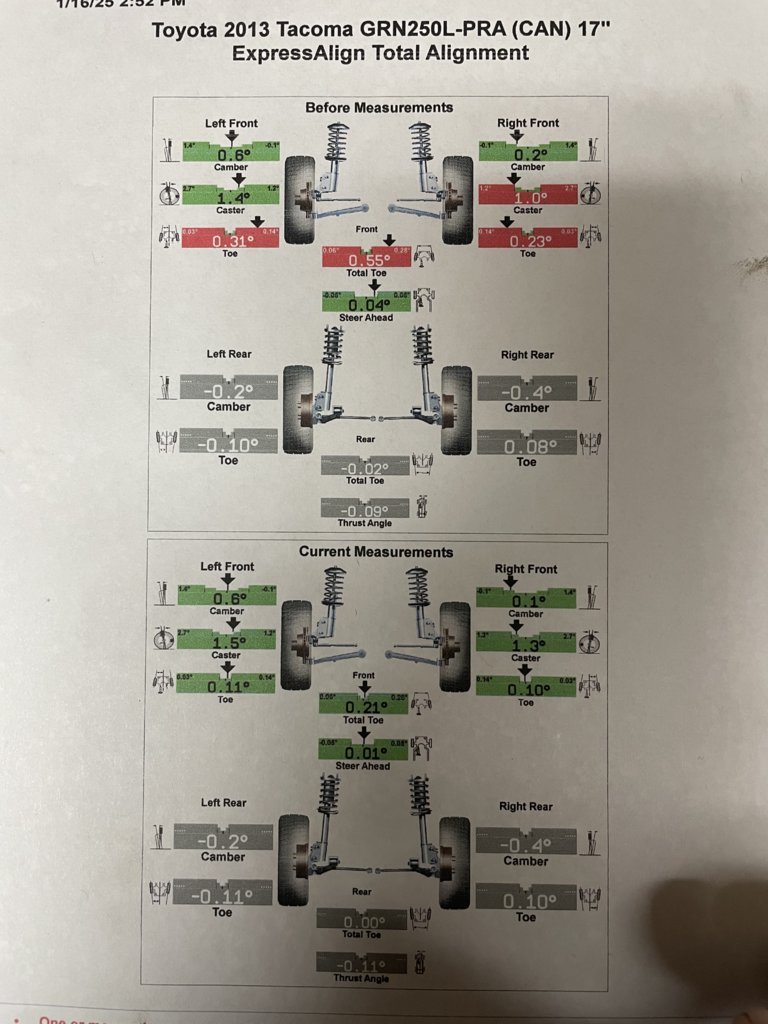

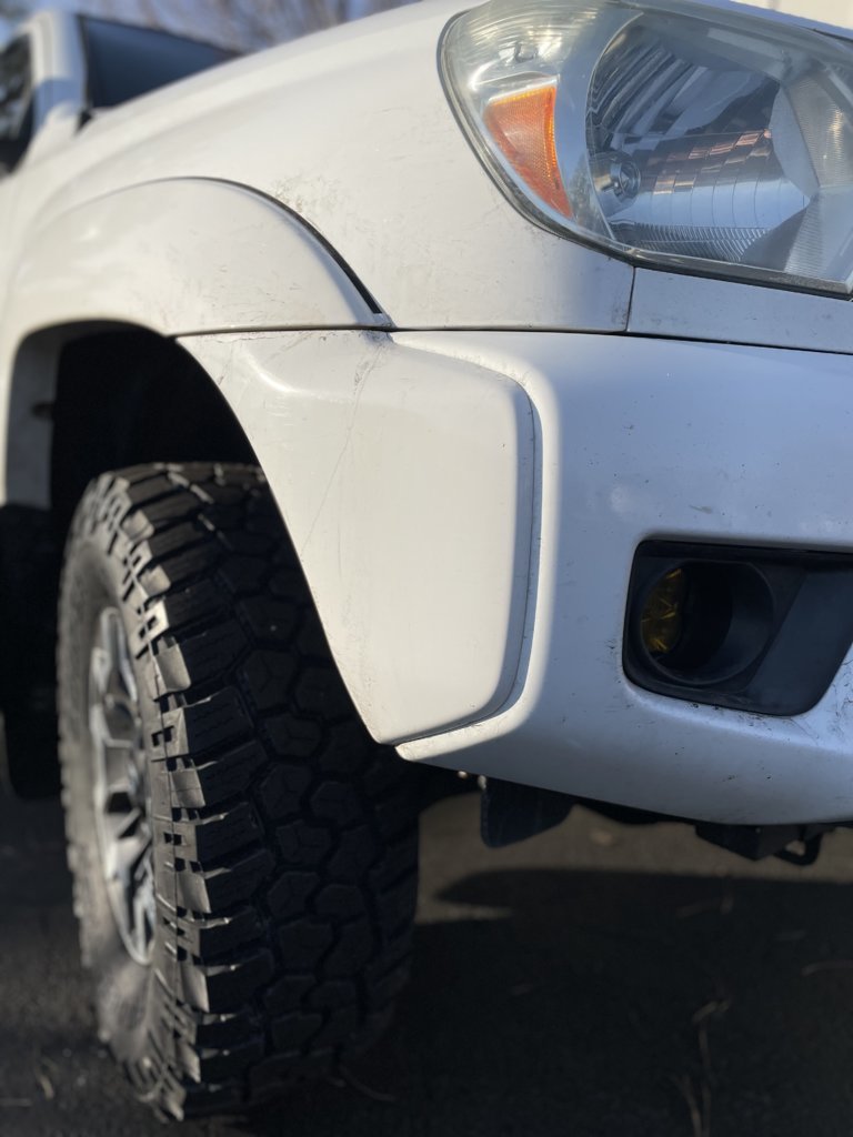

    Been battle tire wear for a while. Outer lugs wearing excessively fast to inner lugs. Like drastically. The driver side being significantly worse than the passenger. Outer lug wore down to slicks, inner lugs still had 1/4”-5/16” of tread life left.
    Anyways, after multiple, multiple shops seeing the truck, alignment after alignment, being told nothing is wrong, yada yada.
    Bought new tires Monday, alignment being done now. Techs are saying both lbj’s are worn and have excessive play in them.
    Likelihood of both lbj’s going bad simultaneously? Im skeptical.
    Would bad lbj’s cause excessive outside wear? Everything I’m reading is it should cause inner wear, not outer.
    Truck has the following.
    1.75” lift up front. Coil over
    1.5” lift in the rear. Leaf springs.
    Truck has 123k.
    UCA, LCA and upper and lower bj’s are original.
    Convinced my wear issues are the result of poor alignment after poor alignment but this is the first shop that has actually “found” something wrong. Again skeptical though because this issue didnt just suddenly come on. It’s been a battle for a couple years now. Prematurely wore out a set of coopers, then a set of Goodyears, not trying to repeat for a third time.
    New skins.

    Alignment printout for you experts.
    Quote for 617.27 for both lbj replacement.
    Said that’s the best they could do with the ball joints being bad.

    I must have missed it. How many times did they get rotated?

    Every 5-6k. Didn’t do cross rotation. Just front to back. So both sides had similar wear on both front and rear.
    Tire wear essentially looked like
    Drivers side
    Outer / inner
    Passenger side
    Inner \ outer
    Driver side wear was way more extreme than passenger.
    Currently rabbit holing tw for what all is involved with doing the whole lca replacement. The shop quoted ball joints only. I have a feeling that quote is going to turn into everything is fucked and we are going to have to cut it out.
    How big of a job is this for a guy who’s never done it before?
    Editing for clarity….

    Positive camber will wear the outer lugs.
