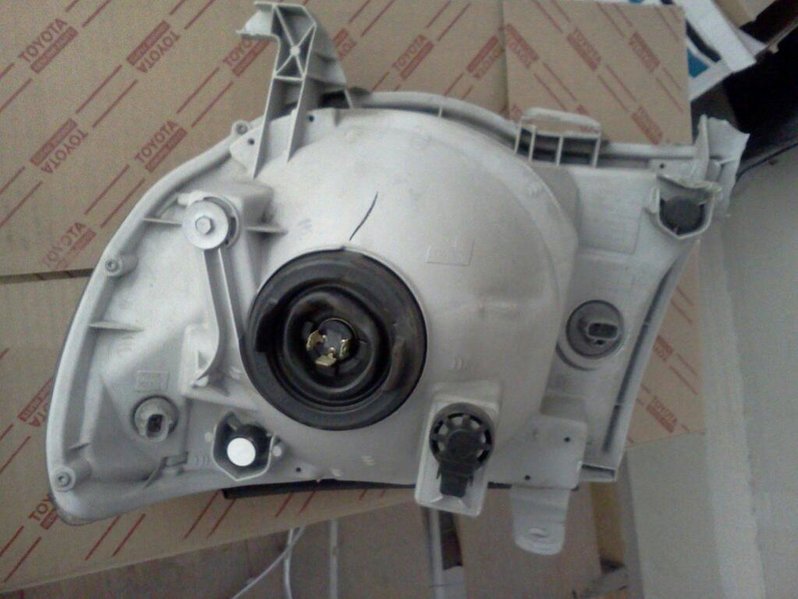

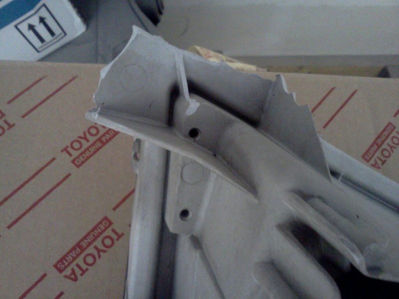

    So I found a set of black headlights on Craigslist. I feel like I'm stealing them they are so cheap. But there is a problem. A couple of the mounts are broken.
    How easy would it be to fix these mounts? Is it worth it?
    Here's a photo

    If he has the pieces it'd be easy... just epoxy. Without them.. not worth it.

    The dealer sells replacement tabs. I don't remember how much they are but I think they are in the neighborhood of 8 bucks a piece. The holes that you see near the tabs are where the replacement tabs screws into.
