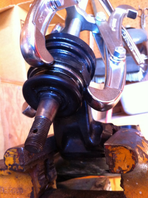

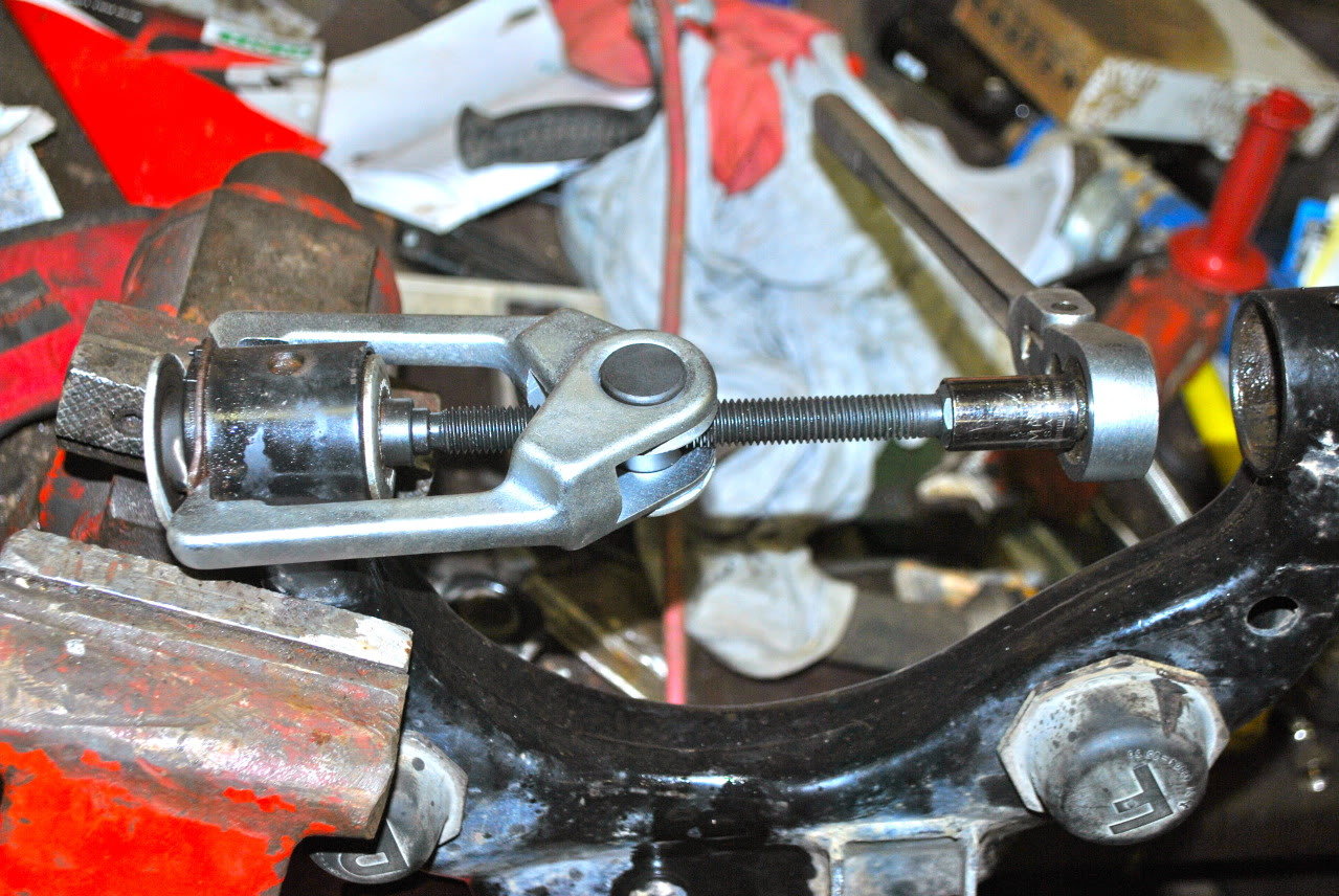

    Zach - that comes part of . I found the joint separator to be the only thing of use (used it for the ball joint - careful with that, I had it pop off like a cannon, too)
    Autozone basically gives you . Typically, this is the easier, safer, way to do it, but Toyota LCAs can't use them for crap because the rings you need aren't included (plus that lip Robert shows). There's an expanded set you need that costs another $100, which Autozone doesn't carry.
    Robert - We sprayed the living hell out of things, too. We tried a 3 arm puller and had a 4 foot cheater bar on it and eventually busted the metal arms off the puller. This shot is right before we busted it. The BJ is actually the part that came out easiest for the press on both arms, surprisingly.
    37A03CFA-E104-4480-850A-18585421E153-180_6d1c91c902c684ddf9b0bdd846ca83b959a84ad4.jpg
    This is pretty much exactly what we used in the end, and this worked. Like I said, the bushings came out like they were shot from a gun.

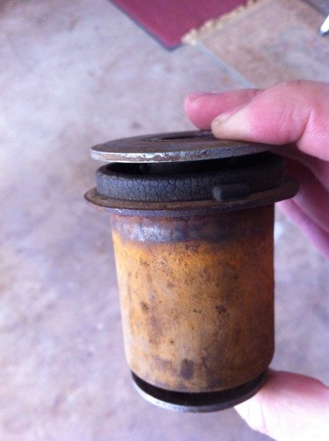

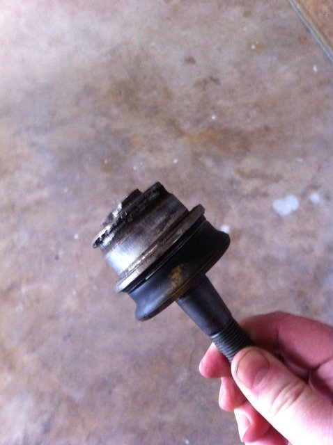

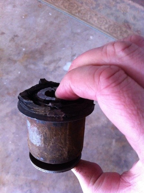

    Here's the bastards. The first one is where we drilled and cut it before giving up on hand tools, the rest were taken straight to the press.
