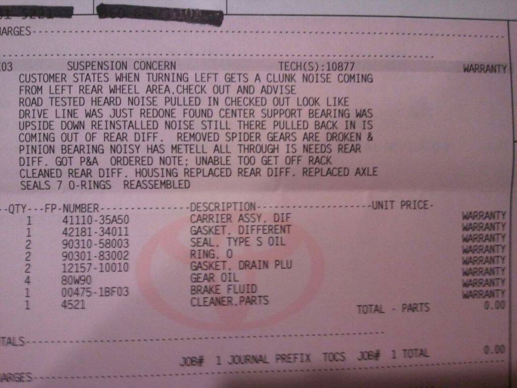

    Why was your carrier bearing installed upside down?
    $1400 in free parts alone dude! Ba damn

    I did that when I was initially troubleshooting it. I was changing the driveshaft angle to see if it made a difference.

    And they didn't slap you on the wrist for that?!? Damn. My power steering rack leaks like a bitch since 15K. They still refuse to fix it. I need to venture up to that dealership

    I was surprised that it was so "painless". The service manager was making some worrysome comments like "it might be from the lift" and "I'll get you an estimate" but I just kept quiet and took the don't ask don't tell stance. He never gave me an estimate and no talk of money was brought up so I just left it at that.
    I told the tech that I recently had the driveline balanced and I was messing with the angles. He agreed that after the lift, it's best to get the front and rear shafts as close to the same angle as possible with shims or spacers. He gave me some shit about my bashed-up skid plate and other damage, and one of the other techs told me to throw in a locker too. They were cool about the whole thing.
    Honestly, I had already planned on them saying No Warranty and giving me a $2000 quote. I had a rear 3rd and ARB in my cart from ECGS just waiting for a phone call. It's hard to pull $1500 out of your ass though...it painful, unhygienic, and the g/f would not have been happy, so it's worked out for the best all around.
