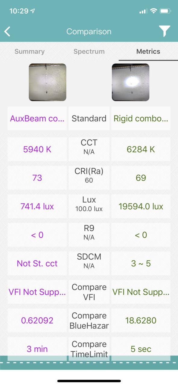

    Caliraised is basically equivalent to rebranded china auxbeam. They don't make their own lights, it is just rebranded cheap china products that are poor performing. @Kidwidataco came over with his auxbeam 30" light bar, ditch lights and cali fogs and we did a lighting shoot out with all his LED pods, light bar, fogs and headlights against just my headlights and the peak output was about equal. All that low quality china product barely met the output of my headlight low beams alone, it was pathetic. Yes you can definitely 'save money' with Cali, but they are kids toys compared to real engineered lighting products.
    As typical with most that come to my place, he upgraded to better lights and picked up an older used Rigid 30" combo light bar. We setup a test to compare output of the Rigid bar to the auxbeam combo bar, lux measurements below.
    Rigid was 26x+ output intensity of auxbeam. And that was with an older Rigid bar. If you just want a light bar to have a light bar or cheap pods, Cali can save you some money but their performance is abysmal compared to real engineered lighting solutions.

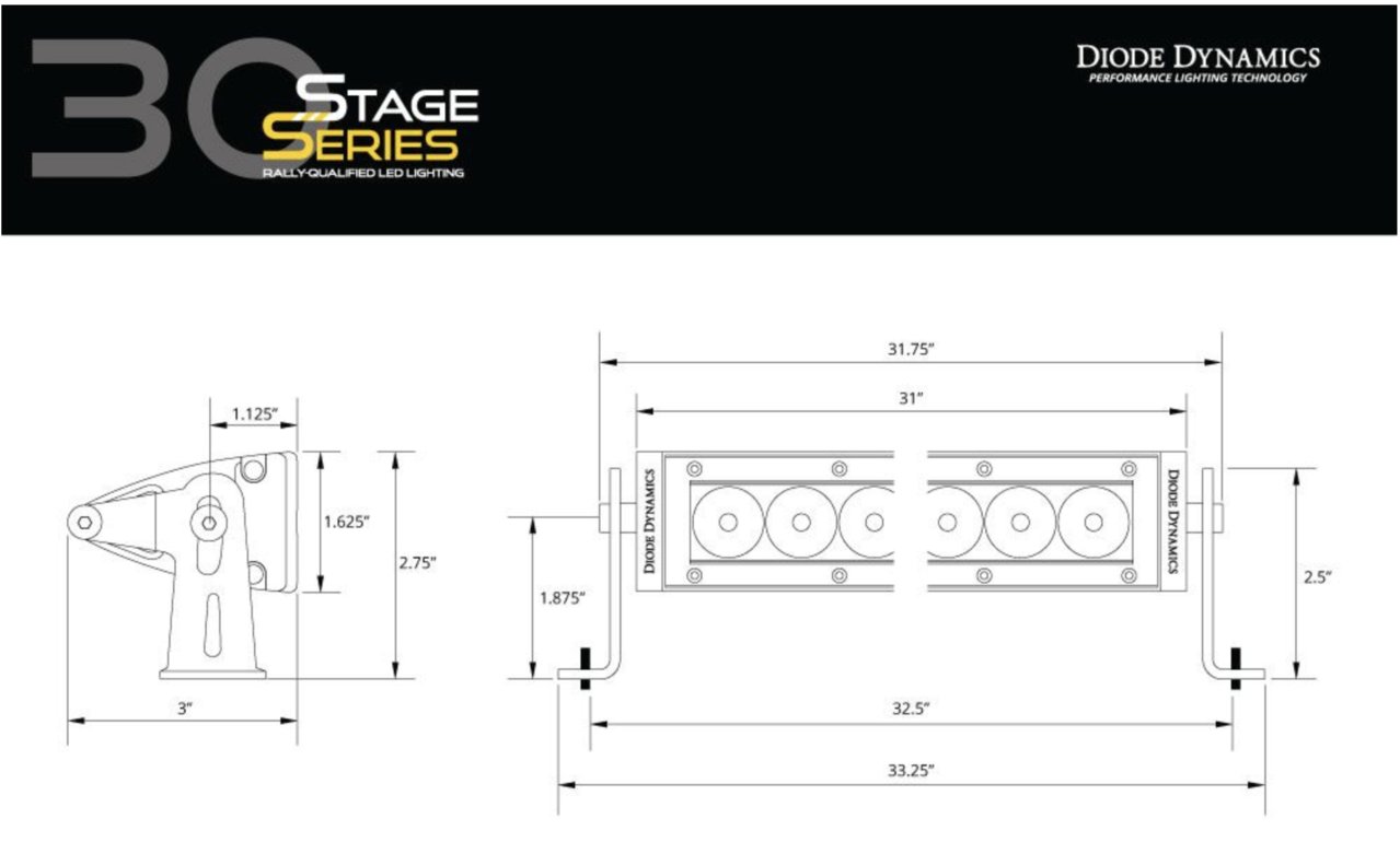

    Rigids and Baja Designs are also great imho as well in case the Diode length is not correct. There is some size variance with most brands it seems.

    Unsure what you mean by the Diode Dynamics length is not correct. Diode Dynamics does an outstanding job on specs across the board. What tends to confuse people is when Cali mis-advertises their bars as "32" by using the outer stud as the measurement point to make their bars seem larger than the competition, when the industry standard is to use the emitter area. So what all other manufactures call a 30" light bar, Cali calls it a 32" bar. That should tell you plenty.

    Not that it is “incorrect”, just making sure that he knows that it seems like some brands have different measuring points and not all bars fit in other brands mounts.

    Fair point, most brands provide product measurements in the spec to verify before ordering.
