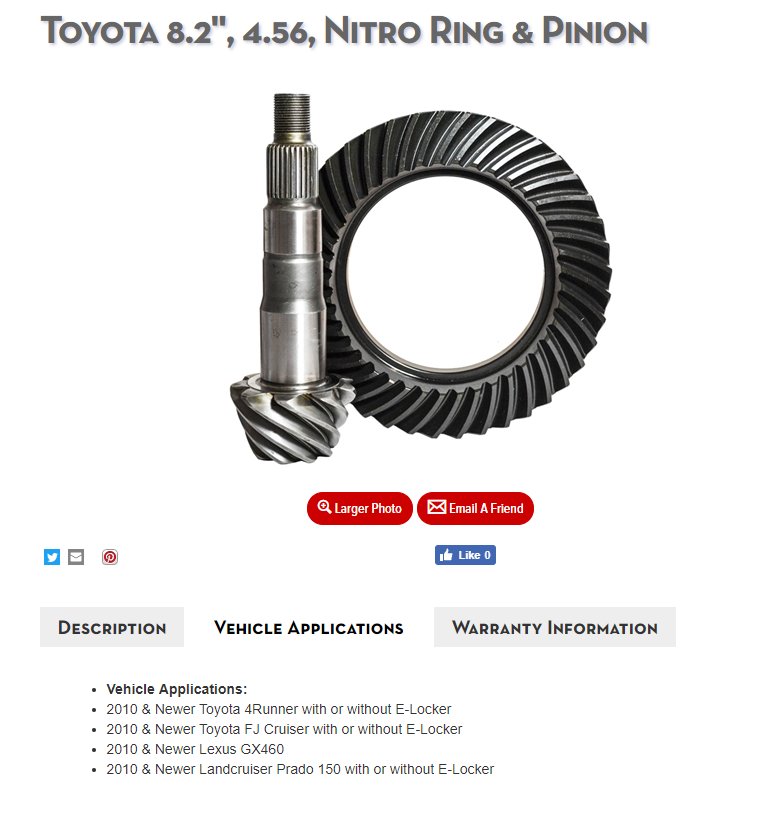

    Same gear ratio? Just larger ring?

    Its a 8.2" vs the 8" that came with it. Also theres a good amount of evidence that the 8" gets sloppy near 200k and can grenade which is why it got changed in the 4runner and FJ in 2009

    8.2? Or like the 8.4 in the non off-road Tacomas? It's really still an 8" ring gear but 12 bolts holding the ring gear to the carrier instead of 10 on the elocker. bearings are slightly different too.

    8.2 for sure. I dont know much about the black magic inside, im just regurgitating shit ive read on facebook

    More than likely the casting is different, but they may share the same shafts if the wms is the same. Or they could have beefed the spline count up.

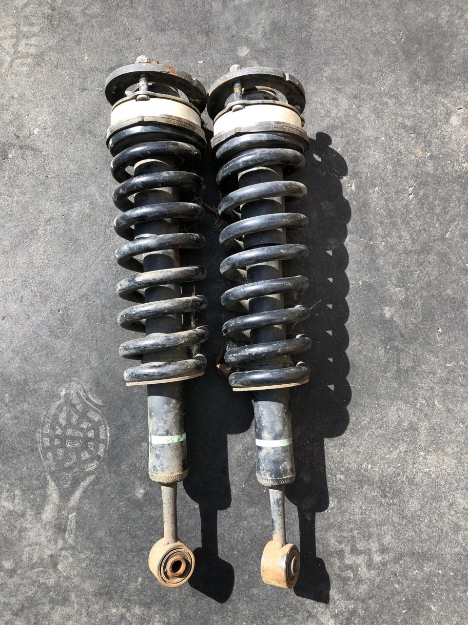

    D826C1A6-3060-4904-893B-37C5122F6C2F.jpg Free to anyone before I scrap them this weekend. Stock 2nd gen shocks and coils with a 1.5” spacer.

    When i shredded my diff the guys at nitrogear said it was a common issue in 8” rear ends.
    The TRDsports now have an open 8” and the TRDOR have a locking 8.4”
