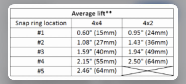

    that will all be depended on your set up really. But you could see what the estimated lift is for that set up on a 3rd gen and assume it will be a little more on a 2nd gen and that will get you to a close start point.
    edit: yeah basically what @JimSnell said

    The guy selling them said he gained about 2.5” with them on the 6/5 notch. So maybe at the 4/3 setting with the 650lb springs would net me around 2”?

    I didn’t think adjusting the clip setting was all that easy?

    Inthought I read somewhere that someone did it. Maybe an extra hole or two to drill. I’ll contact BAMF if the guy get back to me with a yes.

    So I am opposite. I have the 2nd gens on a 3rd gen. The 3rd gen version has a lower stock height setting. So for your application you should just use the chart for 2nd gen clip setting but subtract 1 from whatever lift height you want. Given the 650 coils you may end up a little higher if you don’t have any extra weight.
    The 6112 gives a 2nd gen an extra 1/2” at max height than a 3rd gen so I wouldn’t try them at the 5/6 they’re on. What height are looking to get?

    I’m looking to get 2-2.25” I saw the 650lb spring gainz you another 1/2” of lift if you are stock. Which all I have is sliders but I can’t imagine that affects much.

    So I’m on clip 3 on mine and got 1.25”. Same as clip 4 on yours. Add 1/2” for being a 2nd gen truck. Add another 1/2” for the 650 coils. Should put you at 2 to 2-1/4”.
    Keep in mind you need to +1(I think I said -1 earlier) from the clip setting on this chart. And then add the .5” you think the 650lb coil will get you.
    If I’m not explaining that right just ask. In my head it makes sense.

    I’m kinda confused because clip #4 to me looks like 2.15”? Not
