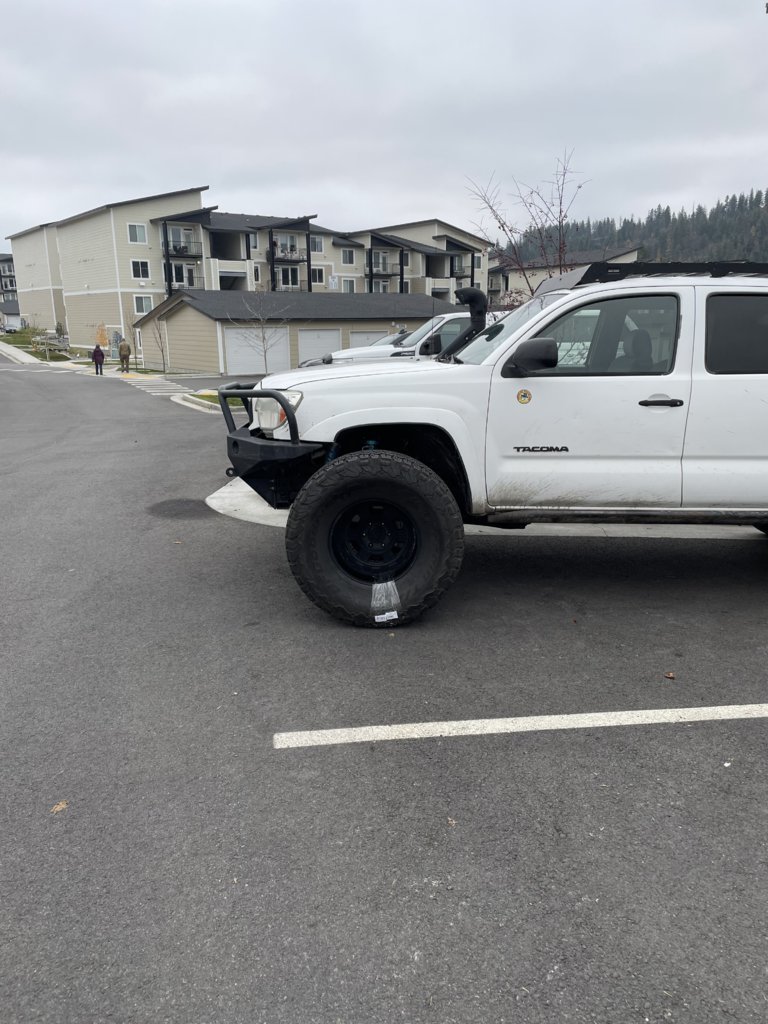

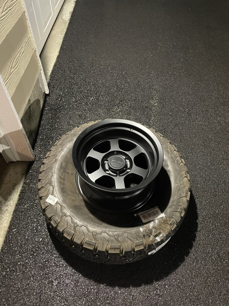

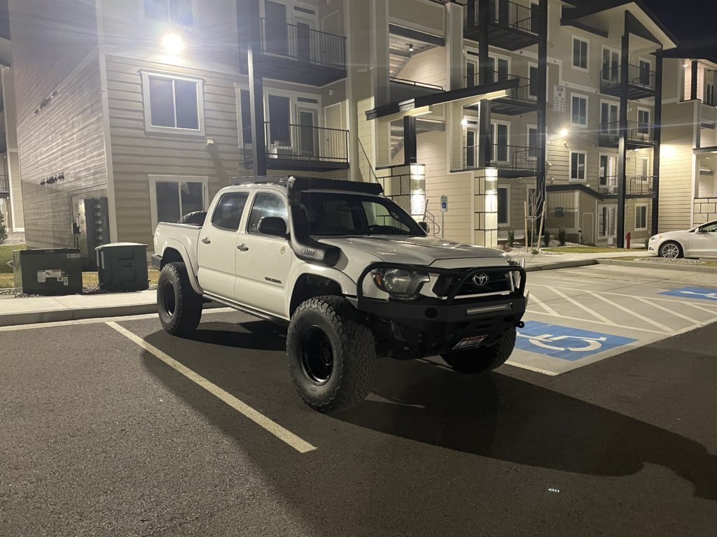

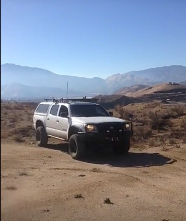

    I should have left it as is when I first got it.. 1st version of the build with baby tires and no cutting or other BS. 2nd version of the build was me making a clapped out tacoma beast special that drove and rode like crap. The 3rd version of my build is my attempt at making this truck reliable again, comfortable, and replacing crap parts with quality.
    37s finally on. now time for cab mount relocation, clearing the firewall, and hopefully making new fender liners
    2025 on 37s
    this is an in progress part of the build as of today 04/16/2023
    Current -
    Pelfreybilt full hoop steel bumper
    rear bumper is a 4X4 body armor that I cut up turning into a high clearance
    wheelers sliders
    Pelfrey skids
    front king 2.5s
    .25 JD fab UCAs
    rebuilt OEM LCAs with mevotech tough terrain ball joints
    front ARB locker, rear OEM TRDOR locker
    5.29 gears
    9SIX9 Six-1 Deep 17x9 offset -36 B.S. 3.58+
    BFG KO2s 37/12.5R17 load range C
    front runner slime line rack
    KP offroad alighnment tabs
    safari snorkel
    facelift parts
    Rear King 2.5 25001-121A 0-1.5
    need to install -
    wheelers super bumps F/R + ubolt flip
    cam gears
    need to buy -
    BAMF shackle hangers
    rear diff skid
    want -
    brute force rear bumper
    upgraded axles front and rear
    supercharger

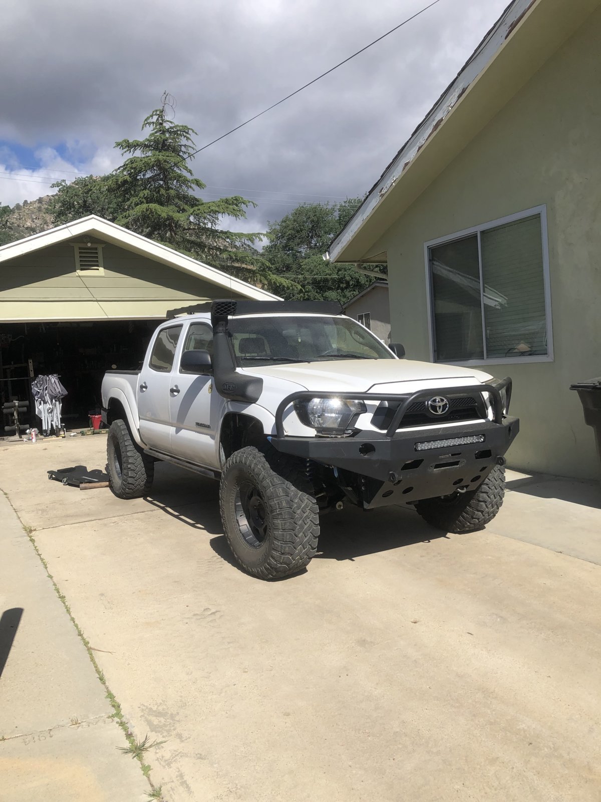

    Armor
    -allpro steel
    -4x4 armor bumper with tire carrier
    -weld on sliders.. Forgot the brand.. :/
    -Pelreybilt front/mid/rear/gas steel skids
    Wheels and tires
    -315 75 16 wildpeak muds
    -procomp 60 series black
    Suspension
    -nitrocharger shocks front & back
    -88x front springs
    -Dakar leaf springs
    2in of lift
    Other stuff
    -CB radio
    -snug top camper shell with Yakima bars
    -Front Runner Slimline 2
    -super 10 muffler
    -safari snorkel
    04/16/2023
    over the years this truck has had some failures -
    blown head gasket - 2015 engine with 3K miles went in at 228K
    engine mount cave into frame - fixed in 2020
    power steering pump fail - rebuilt 2023
    flattened cam tabs replaced with KP Offroad tabs 2023
    rear diff leak - fixed and regard 2021

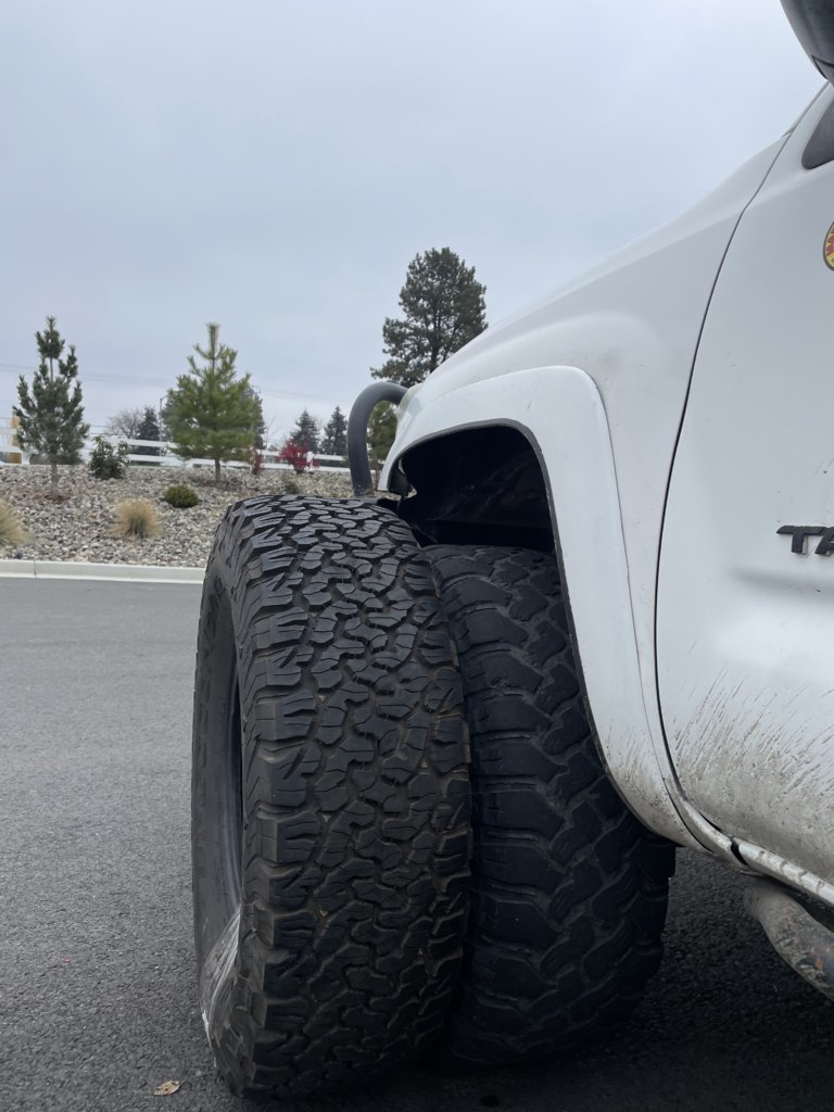

    kings with load range C ko2s ride like a cloud on the road
