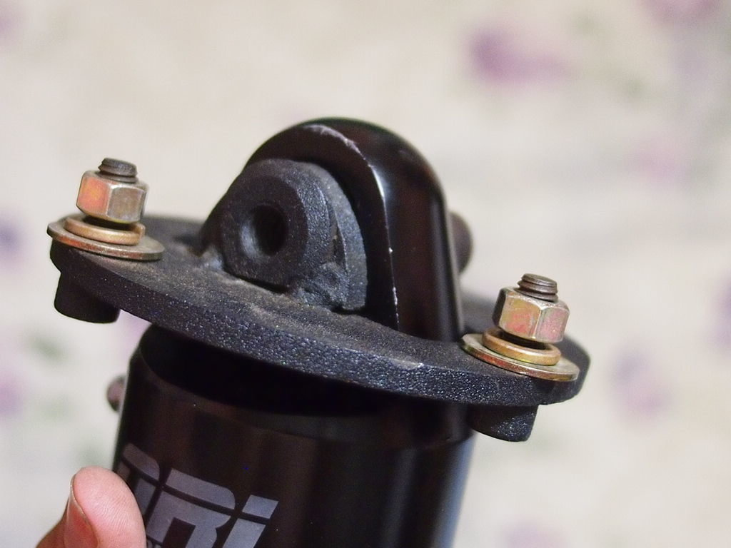

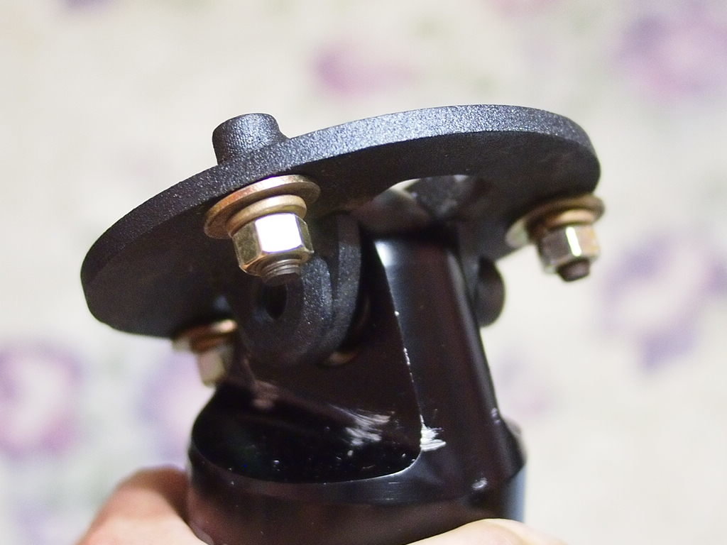

    Does anyone have a picture of how you mounted the ori shocks on the top?
  12. Aug 24, 2019 at 6:29 AM
    #192
    weldo
    weldo Well-Known Member
    Oct 15, 2014
    #140423
    1,337
    Pittsburgh, pa
    2014 base ac 2.7 5-speed 4x4
    I did them this way...
    For clarification...
    I was told that if you mount them with the top hat the other way like the pic below, the shocks will allow the control arms to droop so much that the CV joints will become damaged... DO NOT MOUNT THEM LIKE THE PICTURE BELOW!

    Thank you for the pictures

    Would it be possible to use a mount from any other normal coilover?
  19. Sep 12, 2019 at 6:19 AM
    #199
    JLee
    JLee The Man! Vendor
    Jul 20, 2010
    #40461
    19,606
    Jerry
    Benicia, CA
    02 Extra cab SAS Linked front and rear
    I lost track thousands of dollars ago.
    No it won't
  20. Sep 12, 2019 at 1:36 PM
    #200
    weldo
    Oct 15, 2014
    #140423
    1,337
    Pittsburgh, pa
    What makes the ORI top hats different from others from say Fox or King? Is it the height at which the top shock bolt is located? I found this pic of a traditional coilover (not mine) and the top bolt of my ORIs is higher than the one in the picture below, since the ears point upwards toward the hood not downward toward the ground.
    Could a different top hat be modified to work? Like maybe flipped and grinded for clearance or something?
