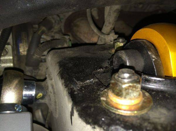

    Got my ORIS in last night, its worth metioning in here that you do have to clearance a small notch in the top hat in order to clear the bolt. Other than that they went in perfectly. Just make sure jerry gets you some misalignment spacers that he's machined. That or be real steady with the grinder :)

    Yep. Doesn't take much. JW did mine with a dremel. The driver's side needed more than the passenger side on mine.

    That's odd the 2 sets I've installed didn't need anything to mount up.

    Both JW and I had to do ours. He is a pic of the drivers side after JW got done. It was so little you almost can't tell other than the paint is missing. The bolt that mounts the ORI to the top hat doesn't quite fit through the hole in the coil bucket.

    Good to know I can just clearance the next batch of top hats before powder coat.

    I ninja edited my post above. It's not the top hat, but the bolt. The head is a little big on those bolts so it doesn't fit through.
    Just to be sure we are on the same page, I circled the spot.

    Yep, thats exactly it. I'll take a pic tonight (doing the rear) so everyone knows what to do. It's pretty straightforward and shouldn't affect anything, but pictures always help.

    Jerry this is what we clearanced. Charged them up tonight and ran home on them. Will do more running around tomorrow but I know for sure I'm dropping the spring rate down from 90. Could just be that everything is really stiff.
