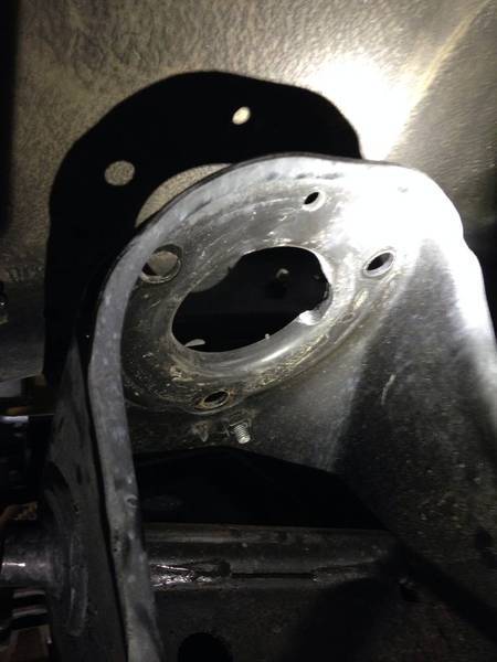

    I finally got everthing I needed to and installed. I spent this past weekend installing all sorts of crap on my truck. It seemed as if it was one thing after another that kept coming up and slowing down the progress but it finally got done. Like others, I had to trim part of the top coil bucket to fit the BAMF kit. I still need to weld on the reservoir mounts and find the final settings for the struts. Thanks to all those that helped me out.
