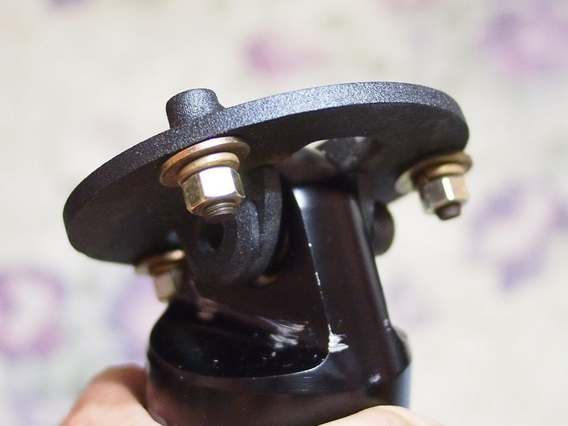

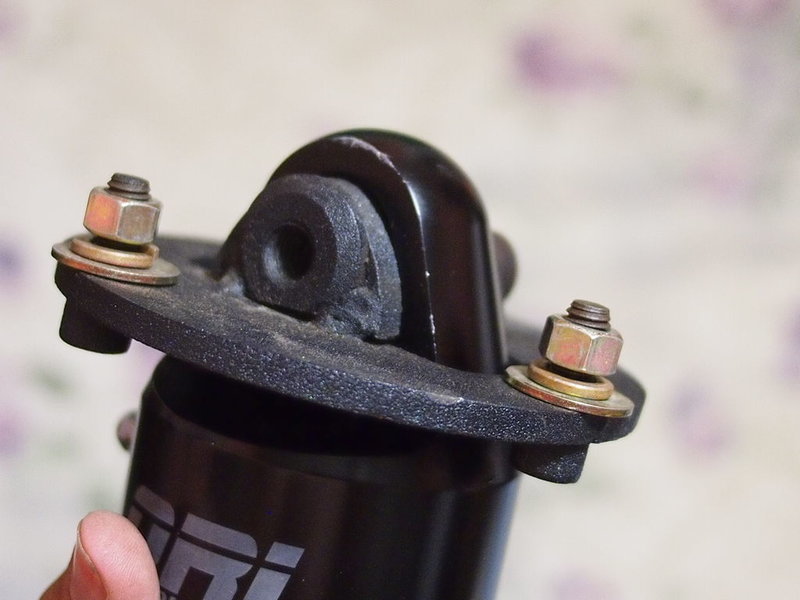

    hey you guys running these struts, which way do the top hats go? I got mine 2nd hand with no instructions. I think they are the BAMF hats. Mounting tabs up or down?
    Judging by the marks on the strut bodies I'd guess they go tabs up, but I'd like to be sure before I install.

    Would have to be this way for the studs to go through the coil bucket and have the nuts thread on.

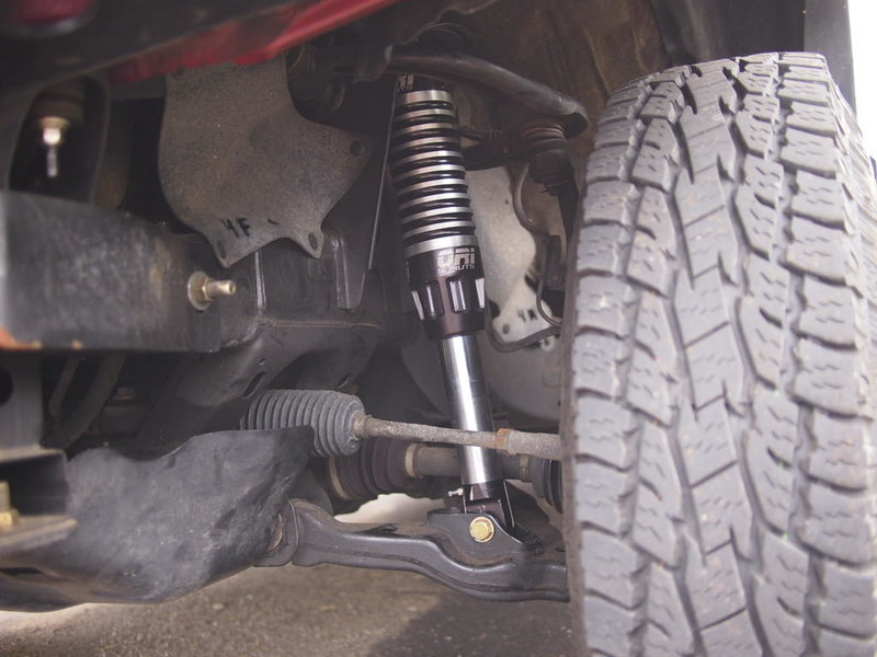

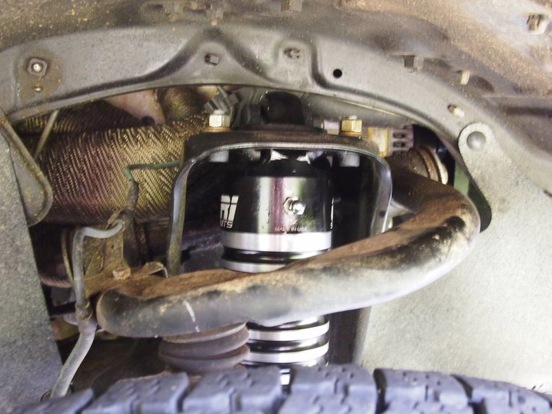

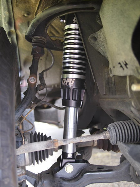

    Some pics after my first adjustment. Looks pretty level. I wanted some rake, I don't mind the rear being a bit higher. Based on rough measurements from the top of the tire to the fender flare the rear is about 3/4" higher. I'm currently at 90psi on both bottom chambers. Driver side top is about 690psi and passenger top is about 660psi. Sits pretty level with me in the driver seat. Without me the driver side is around 1/4" higher.
    Some under carriage shots. There's right around 6" of shaft showing. Wish I could be closer to the middle of travel but I guess I'd have to lower the rear...
