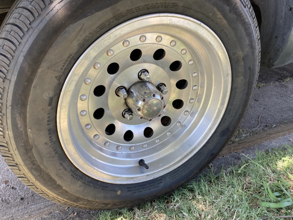

    They came with different rims depending on the dealer package..
    all the steel wheels where probably mostly 14" on 5 lugs.
    And I notice a lot of these 15's on 5 lugs.....much of been a common dealer option

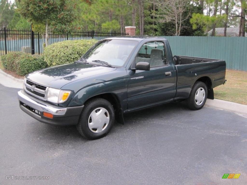

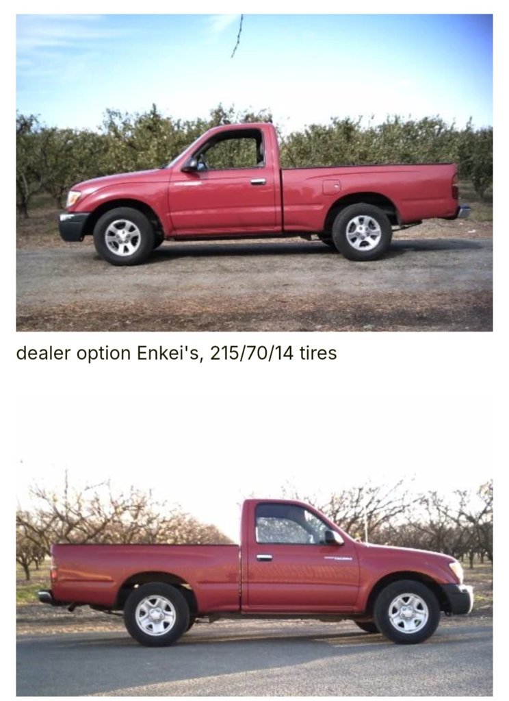

    Either black steel wheels with hubcaps or possibly these.

    Black steel ones where covered....
    and silver rally ones have the center cap

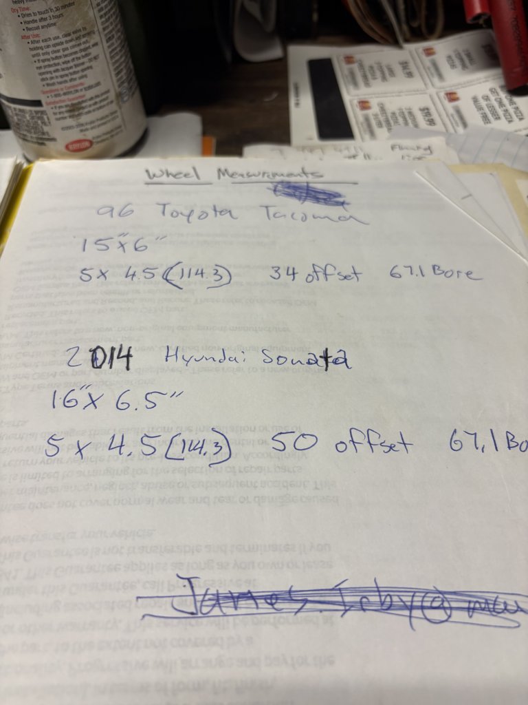

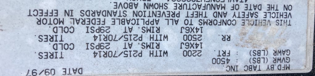

    Guessing yours (like mine) came with 14inch steelies
    this is 3weeks of research I did to find out what other manufacturers rims would fit
    (Measurements of bore/bolt pattern/off set/etc)
    My plan was to find something cheap that would bolt on and be larger (nothing crazy…..just new rims)

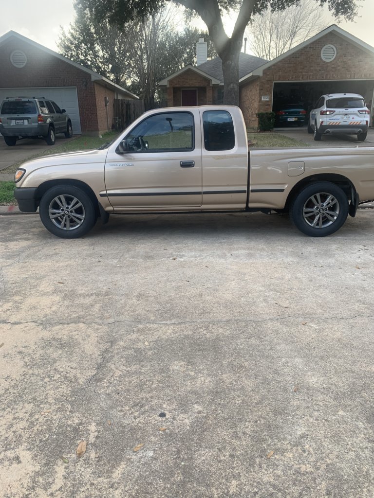

    The $100 CL find purchase/result:
    The sonata rims fit perfect
    And….some other rims fit but your lugs won’t/front center caps will not clear axle cap
    With sonata rims, original Toy lugs fit as well as center caps cleared front grease caps
