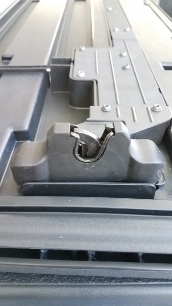

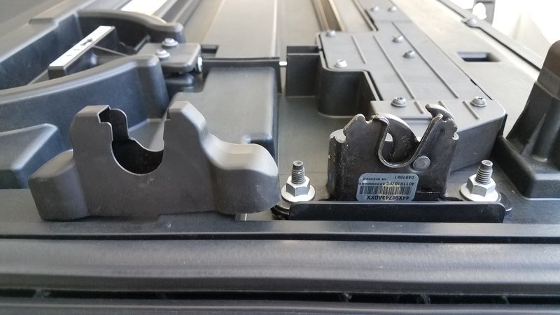

    I had this problem! The latches on the tonneau cover that lock to the bed rail have a plastic insert in them. I found one laying in the bed and didn't know what it was so I threw it in one of the little cubbies back there. When I tried to close the tonneau there was a lot of play and I could lift it up a little when it was "locked". I was gettin pissed so I looked at the other latches and they had the insert in it... I grabbed that back out the cubbie and put it in the latch and now it fits snug and locks immediately. Check to see if you're missing the plastic insert in the latch that doesn't fit snug!

    This is what I was referring to. The first picture shows the latch with plastic cover over it. The second picture shows the plastic cover removed. When the plastic cover is removed, I notice that the latch has a little play in it both horizontally and vertically. The plastic cover restricts that motion.
