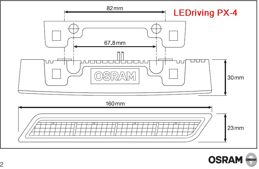

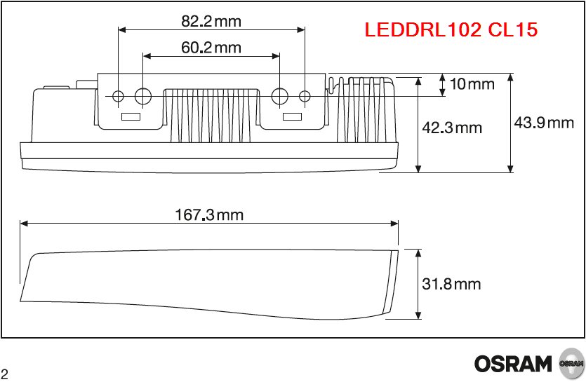

    The important dimension is depth. PX-4 is the shallowest from Osram/Sylvania series. I also checked some Phillips but they are bigger and take less power (less light).
    Osram version of the "pipe" style lights is LEDDRL102 here are the dimension of the light from Osram documentation:
    For comparison this is what I used:
    The other feature I did not like (as it is not 100% legal in Poland) the Pipe style light do not turn off when headlights are on, they just dim to 50%. I did not want to take chances of explaining when I would get pull over. I wanted 100% street legal truck. It's the first and the only one in the whole country.
