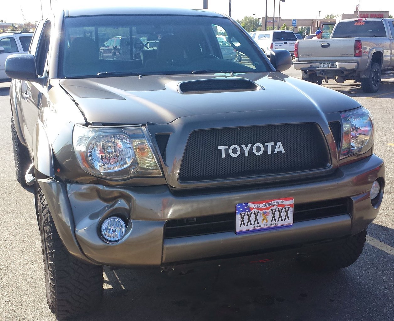

    I got an involuntary mod to my truck this morning. :(

    Oh man was everybody okay? This shys me away from wanting an armored bumper. So sorry to hear, hope you get her back on her feet soon.

    Yeah, everyone was fine. Both of us were upset that it happened but physically fine. It was pretty low speed and I'm amazed how much damage happened at the speed at which he hit me. Why would this make you shy away from buying a plate bumper?

    I say it shys me away from a plate bumper because the factory bumper is designed to absorb shock so that neither the frame nor passengers are damaged (if possible). Plate bumpers conduct the force straight to frame damage or whiplash. I used to think they would just protect you more but I quickly found out that was not the case.

    Yeah, who knows. Maybe I would've been hurt or had frame damage with a plate bumper. Then again, I almost never get into accidents and have never had one that was my fault so that might be a pretty low percentage possibility. Something to think about though.

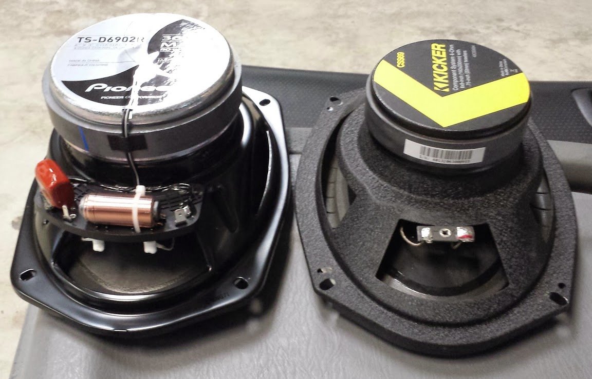

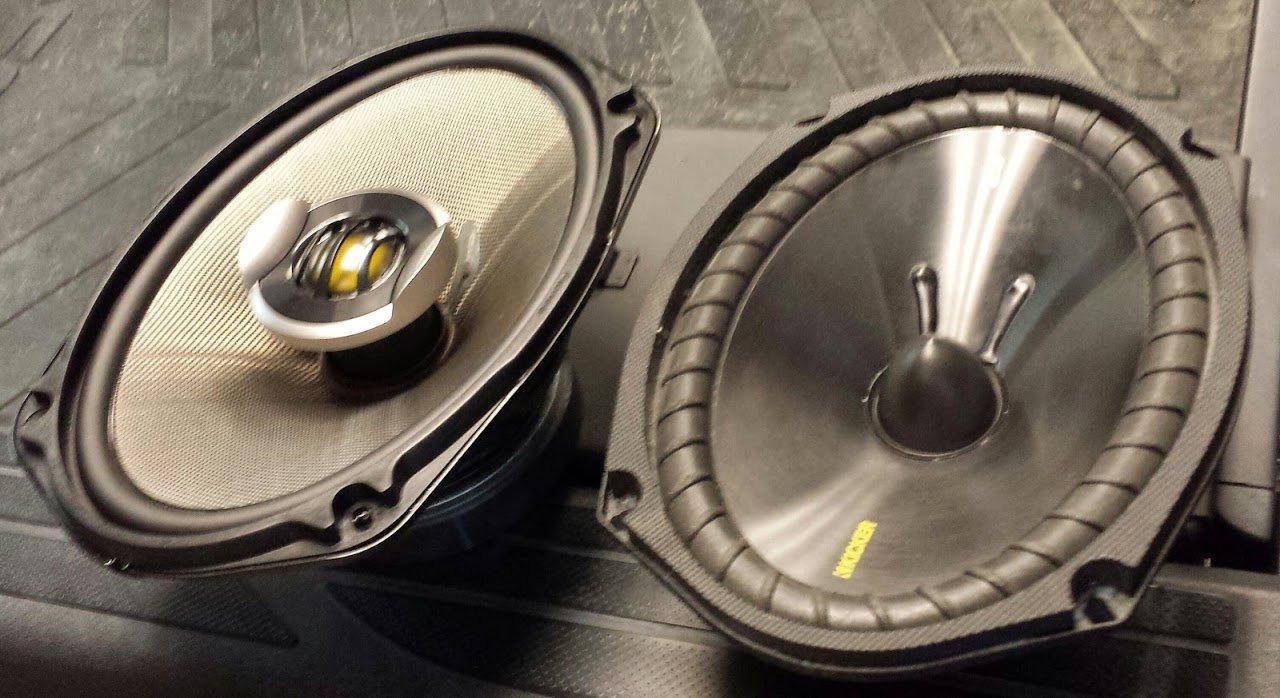

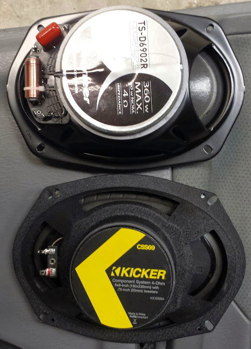

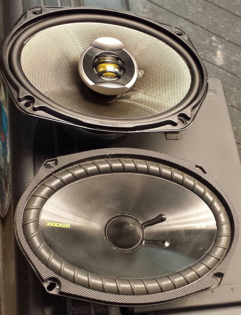

    Quick audio system update:
    After having my setup for nearly a month I decided I disliked it enough that it was time to make some changes. The Kicker 6x9 components were just WAY too bright considering the factory location for the tweeter was about as close to ear level as you can get without putting them in the B-Pillar or something silly like that. The crossover had a three position switch to set the tweeter and even on the lowest setting it was still painful even at moderate volumes. I had hoped that as the rest of the speakers broke in they would fill up the void in the lower frequencies and maybe the tweeters would mellow out but that just wasn't the case.
    So, back to the drawing board I went.
    This time I knew I probably wanted a simple 2-way 6x9 that had good ratings w/o costing a fortune. What I ended up with after reading way too much was a simple 2-way Pioneer 6x9 TS-D6902R that was once $200 that I think I paid about $85 for. Thanks to Amazon Prime they showed up quickly and I was able to return the others at no cost so trying them out really didn't cost me anything and ultimately these speakers not only sound better but saved me some money over the Kicker components too. They have a more rigid cone, better surround, much larger magnet and just a better construction all the way around at a lower cost. I took some pictures as I was swapping them out for reference (no pics of the tweeters or crossovers on the Kickers that came out but you can imagine):

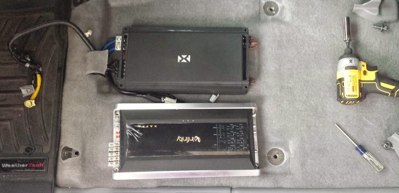

    Another update on this amp fiasco too:
    Got another brand new NVX amp and all four channels worked fine but the sub channel was still under powered for the JL Audio 10w3v3 sub. I had another new Infinity amp on the way but decided that since it was a little bit longer than the NVX and got in the way of the rear Weathertech mat I'd rather just run the NVX even though the sub channel on the Kappa amp seemed to put out more power than the NVX amp. So I decided I'd order up the same sub as what I had installed but in the 2ohm flavor which would effectively add about 50% more power. The sub showed up today and in about 5min I swapped it out and it was exactly what I was looking for! Much more power to the sub now and the absence of painfully bright highs from the tweeters all spells a much more uniform sound system. Not to listen to it for a few weeks to get all the speakers 'broke in' and then I can tune it a little bit better and see how it's going to perform but so far I'm quite happy with it. Should give me plenty of enjoyment.
