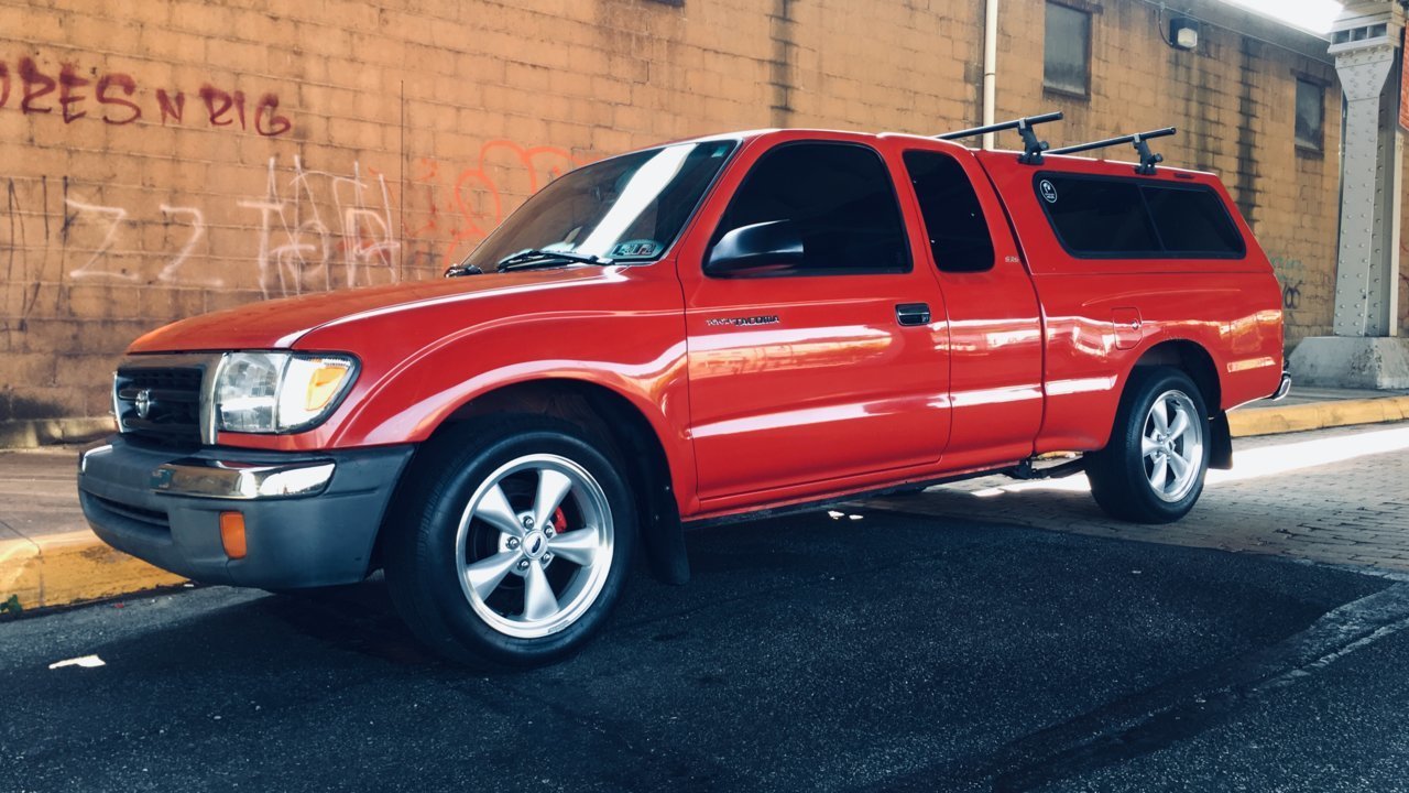

    17" 5-spokes from my '09 Mustang GT. They fit just fine with no spacers needed.
    Different model years of the newer Mustangs had slightly different offsets, so I would stick with the 2005-2009 S197 generation to play it safe. I've seen SN95 wheels on 5-luggy Tacos, though, so I guess those fit as well.

    Wow nice truck!
