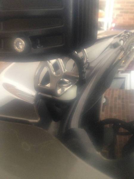

    So none of you have had problems with dually's on the hood hinge mounts? Finally got mine on and passenger side hits the wiper when opening the hood, have to stop the wipers in the up position before opening the hood. Any way to avoid this?

    Mine do the same thing. I'm just careful when I raise the hood.

    I seen where you guys posted problems with the clearance of the RI D2s on these brackets. I put a set on my 2013 and had some clearance problems. The D2 on the passenger side hit the wiper when the hood was opened as you have stated. Also the D2 on the driver side was being hit when I turned on the wipers.
    I solved the problem by placing a 1/2" nylon bushing between the D2 bracket and hood bracket. The 1/2' nylon bushing raised the D2 enough to miss the passenger wiper when the hood was open. It also allowed me to move the driver side D2 to the left more not hitting the hood with the D2 mounting bracket. Now the driver side wiper has enough room to go all the way left without hitting the D2 mounting bracket when on.
    I picked up the two bushing at Lowes for less than 3 dollars. They are white and you want to paint them black before putting them on your vehicle. I left them white and should have painted them.
    I used blue treadlock on the D2 nuts because the bolt thread is just at the end of the nut. The treadlock stopped the nut from coming lose when adjusting the D2s to the right or left for night driving.
    This is what I done.

    1/2" bushing[​IMG]
