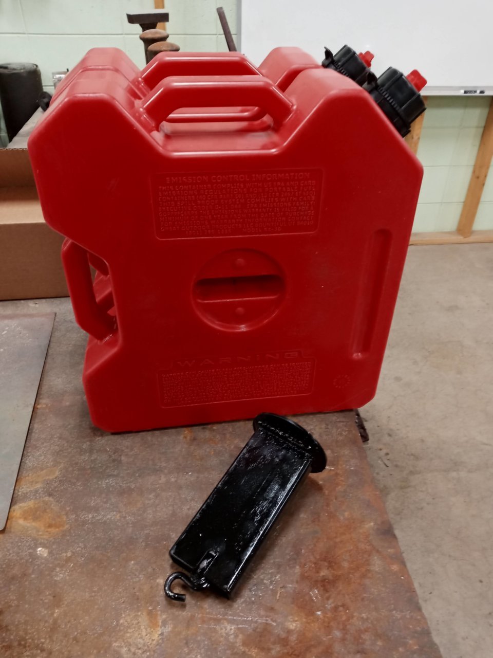

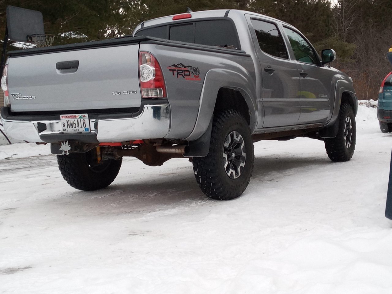

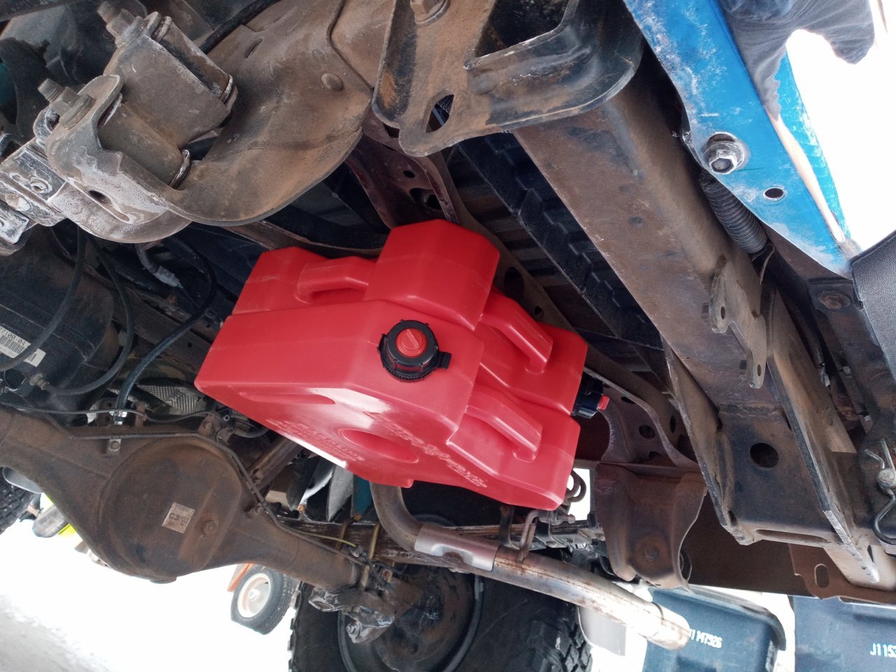

    Here is what I have done:
    Made a bracket and uses the factory hoist system-can go back to stock with no modification. Yes they are plastic-so is your gas tank...
