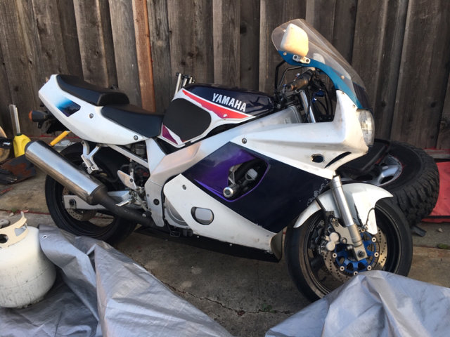

    For while I've been saying my next biggest mod would be a daily driver so I can park my truck and keep the miles off it. Last Monday I bought the Taco a taquito.
    So far, with a lot of help from my good friend, we've rebuilt the carbs, replaced the fork seals(they puked oil all over the front brake pads) replaced the front brake pads, replaced the battery and I bought a helmet and gloves.
    I'm at about just under $1,000 for a 50mpg vehicle.

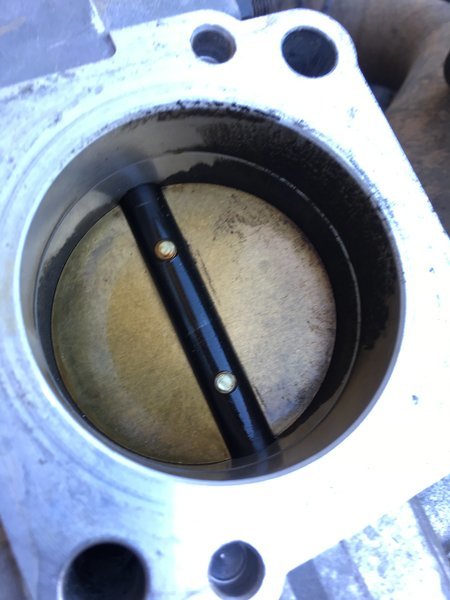

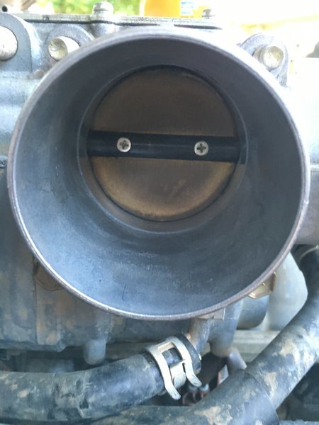

    I cleaned the throttle body along with the MAF sensor the other day. The truck idles so much smoother now. It seems to have a little more power. I drove it to work today. It normally downshifts on a couple inclines here and there. Today - no downshifting.

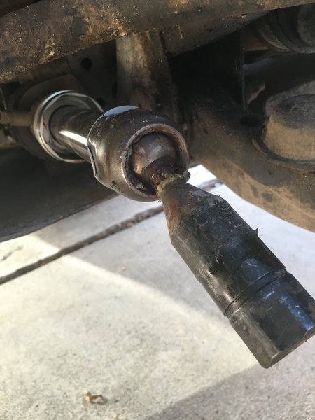

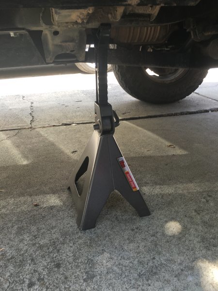

    I bought some 6 ton jack stands from Habor Fright on sale for $40.
    Replaced my inner tie rod and boot.

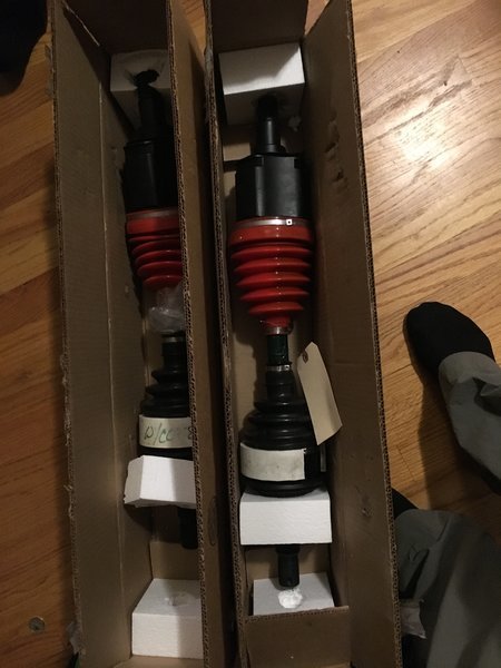

    Got some CVJ Axels with high angle silicon boots. Hopefully those will go on next week.

    $467 for the pair...core charge is $150. Once I send back the old axles they'll be $317 for both. The red high angle silicon boots are $42.something each axle.

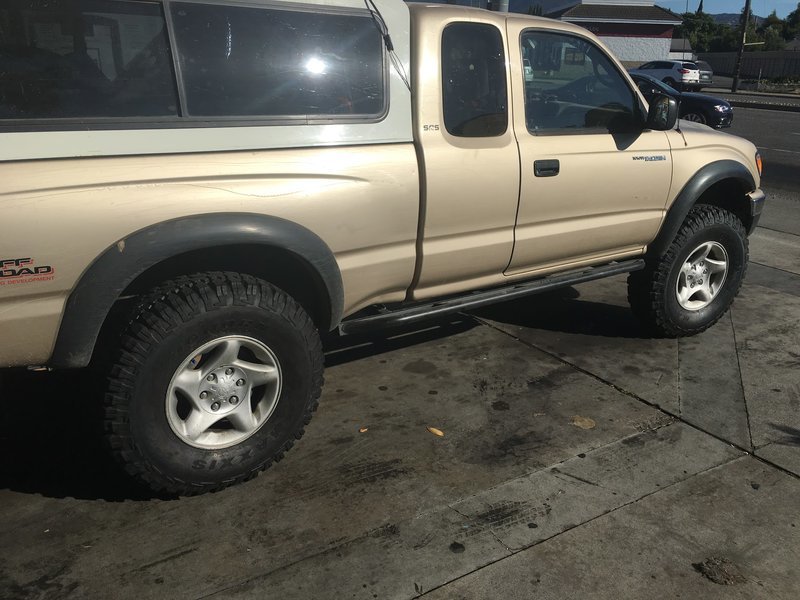

    got some new tires yesterday. 255 85 R16 Maxxis BigHorn M-762. They're a bit more than 33" tall and 10.5" wide. They're much quieter on the highway than I thought and drive okay so far. They rub a little on the frame at full lock.

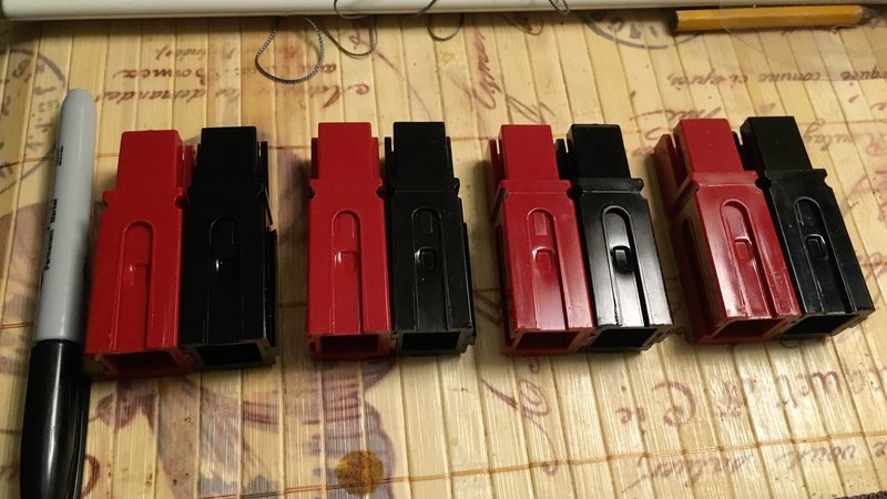

    My Anderson connectors came in the mail yesterday. Thanks @EDDO for the idea!
    Explorer_1144 and EDDO like this.
  17. Jul 18, 2016 at 8:21 AM

    Pretty much the same set up as your's.
    One connector coming from the battery. The rest of the connectors going to the winch (which I won't have for about another year or something), compressor and jumper cables.
    I probably won't do anything with them for a few weeks. I have a transmission leak which I think is coming from either the dipstick tube or the pan gasket. I also have to install the new CV axles still. Now that I only drive it once a week I take forever to do any repairs.
    Also, I got 50mpg on a tank on the motorcycle the other day. That's the best I've gotten so far. I'm going to replace the air filter and sync the carbs maybe next weekend. I should get a few more mpgs after that. I've been averaging 44.something but that includes two tanks where one of the coils wasn't working so it was running on 2 cylinders instead of 4 and only got about 35mpg.

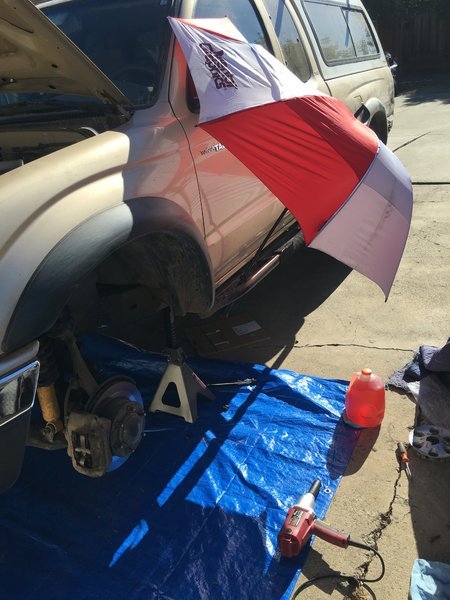

    Yet another use for sliders -
    The impact gun in this pic has been super useful. It's gigantic and heavy but it was on sale at Harbor Freight for $40. It also has either on or off. There's no modulating the speed.

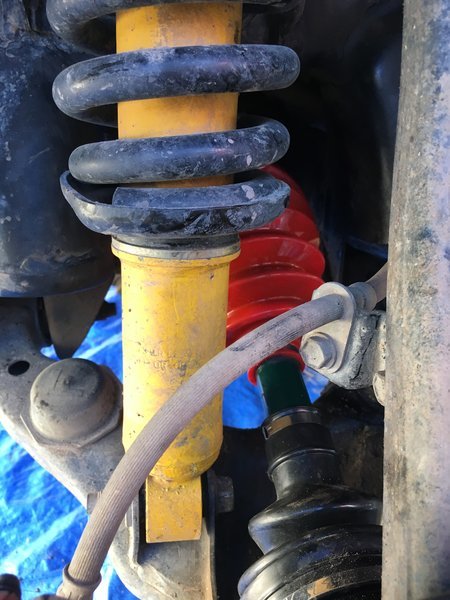

    It took me 3.5 hours to reinstall my transmission pan with a new gasket, fill the tranny and replace both CVs. Mostly thanks the impact gun for removing bolts. I thread all bolts by hand and finish with a ratchet and then a torque wrench. I do use the impact for replacing wheel lug nuts before using the torque wrench on them.
    My passenger sway bar end link has been broken for months. I finally cut it off with the angle grinder. The driver side end link hex nut was stripped out and the bolt was seized so I chopped it off.

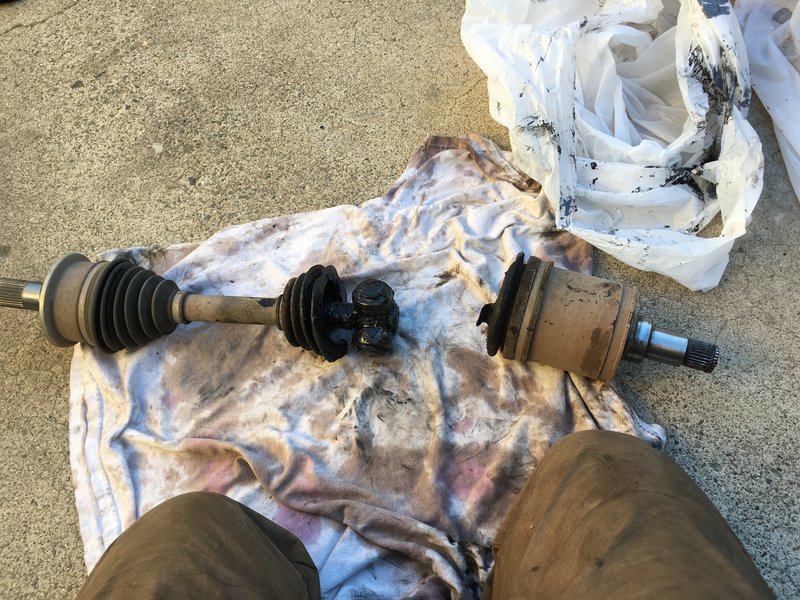

    New CVs's Yay!

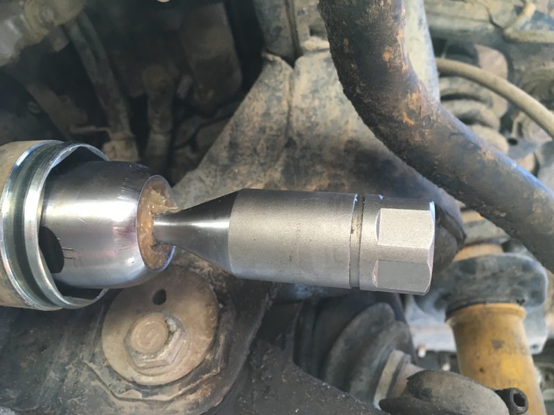

    There was definatetly something wrong with this one. This was an O'Rielly's with about 20,000 or so miles on it. The boot ripped after about 5,000 miles. It's replacement will become a spare on wheeling trips.
    I still need to top off the diff from the 8-12 oz the dribbled out while replacing the axles. I also need to add one more quart of transmission fluid and replace the skid plates. After that I'm all set.
