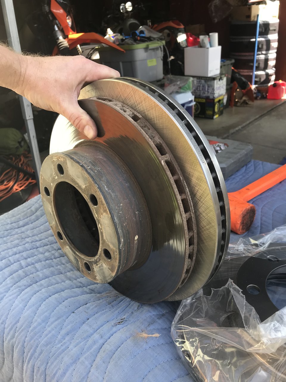

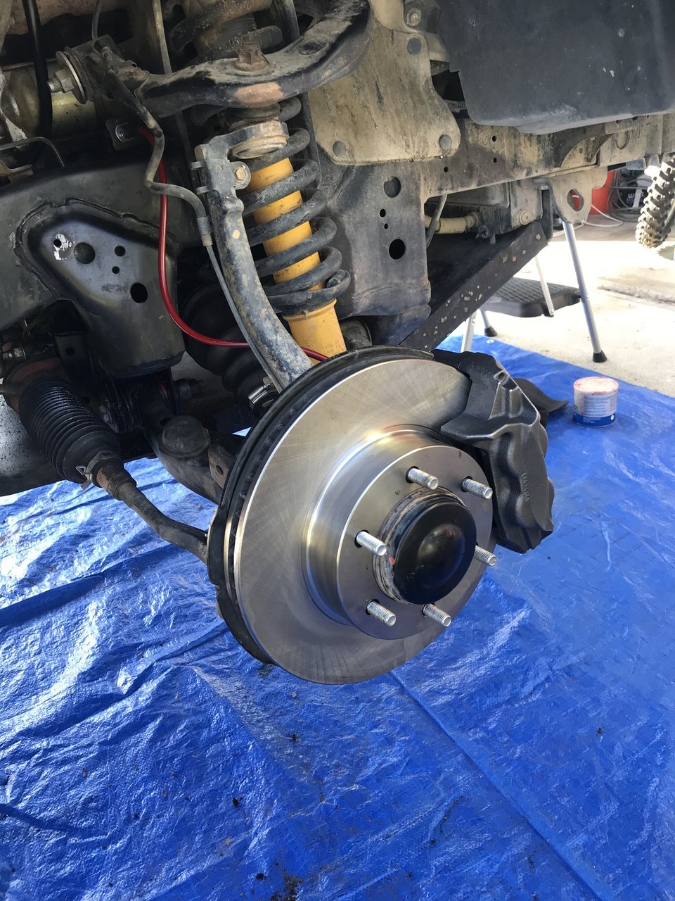

    Tundra Brakes! No cutting or trimming needed. Just did a little bending.
    Also, did Wheeler’s steel braided brake lines.

    How the tundra’s feel so far?

    So far so good. I don’t need to stand on the pedal to stop fast. They’re not bedded in yet so I suppose they’ll start better.
    Install was a breeze. We got slowed down because We put longer wheel studs in. The dorman studs are like .3mm fatter

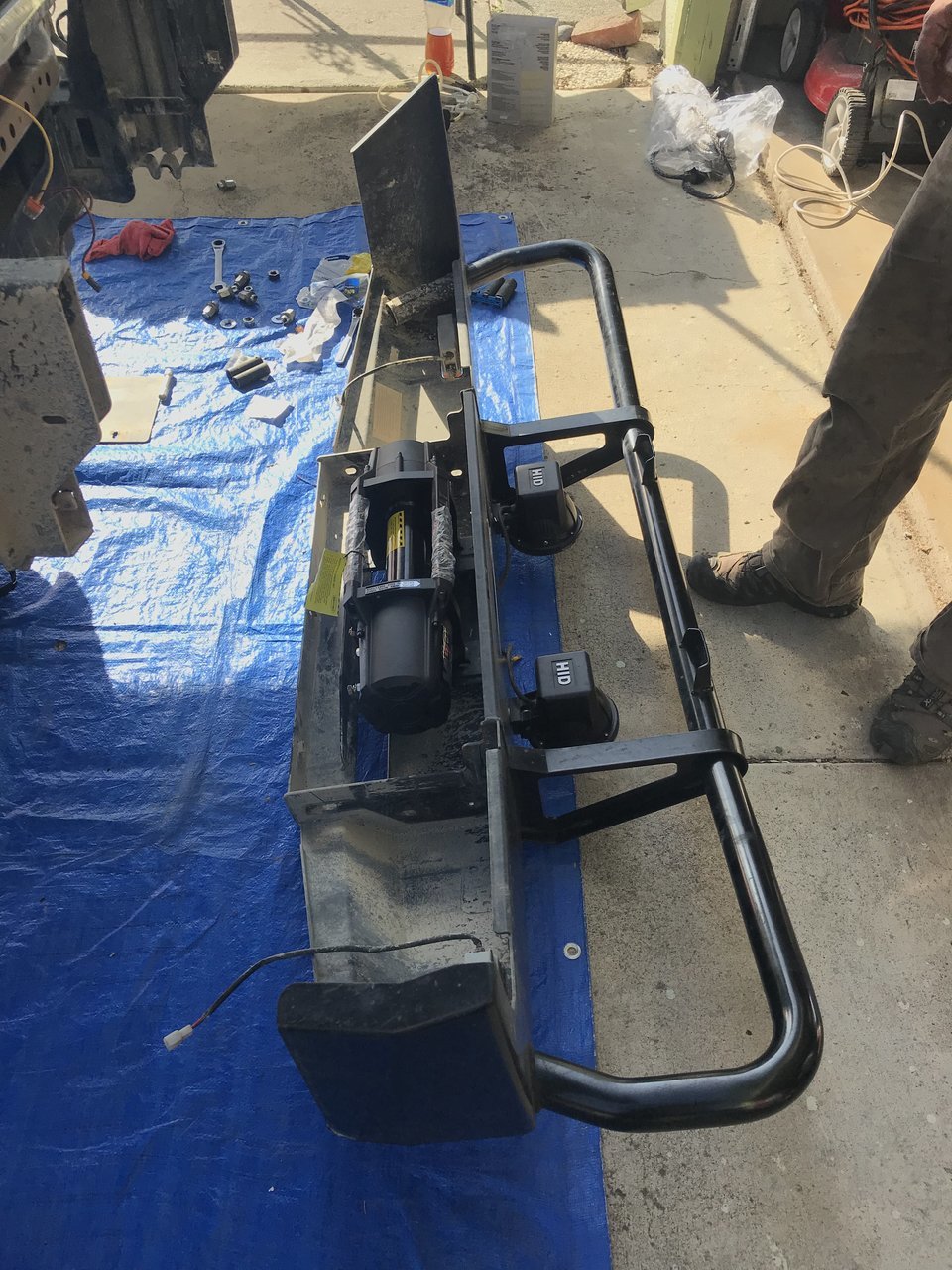

    Winch!

    You relocating the solenoid? I'm in the middle of installing what looks like the same winch lol

    I 3M industrial Velcro-ed it to the inside of the bumper next to the winch. I might change it to the engine bay. However, my engine bay is super crowded-dual battery system, fuse block etc.

    Ah nice! Yeah I am essentially mounting mine onto my battery in the bay so it's taking me longer fabbing a mount and extending the wires. Sadly a tube bumper is very bad at hiding things lol

    Lol..yeah the ARB has lots of hiding spaces. The control box sits in a kind of vulnerable position. I might have to makes some kind of cover for it.
    I'll take some pictures of it when I get home after work today.
    Edit: The battery area would be a good spot. I have 2 batteries so almost butts up against the fan shround. There's very little space between the battery tray and fan and belts.

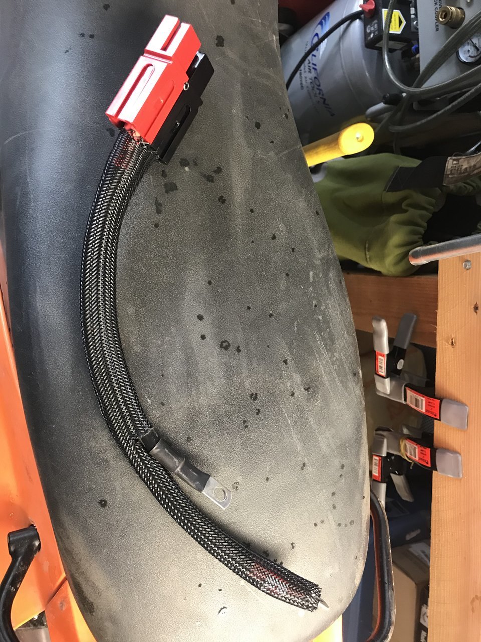

    I emailed ARB. They’re sending me new bushings for the shocks.
    Also wired up the winch. I cut the winch cable and added Anderson connectors. And stuck it in loop with a shit load of shrink wrap. I'm going to add an anderson connector to my jumper cables and my compressor. I don't really use my compressor anymore since I got a CO2 system but it'll be nice for when I need it as back up.
    I got this idea from @EDDO. How do you keep them clean? I'm thinking a small draw string bag for each plug.
    Just found these - https://powerwerx.com/anderson-134g4-sb120-dust-cover
    I finally got to use my hydraulic crimper I bought about 2 years ago. If anyone wants to borrow just let me know. It makes crimping these lugs super easy and clean.
    This connects to the battery.
    I might find a better place to run these wires but this seems to work for now. Also need to find a way to protect the plugs. Maybe a small draw string bag to fit over them.
    I did trim that purple zip tie. I highly reccommend these pliers for cutting zip ties. They cut is flush so it's not sharp. https://www.frys.com/product/293856...3ZNunfHtmi-Gc2IAzfSeTDHk6U0UyVD0aAgmfEALw_wcB
    I also need to put the rest of that yellow wire (goes to HID's) into a a loom.

    I bought these a little after this post. I finally got around to installing them. Two years isn't bad!

    i need to do this as well, Ive had the connectors in my garage now for a few months.

    Haven't done anything with them. The one just rides around under the hood naked and afraid. Sometimes making the connection sounds a little crunchy, though.
