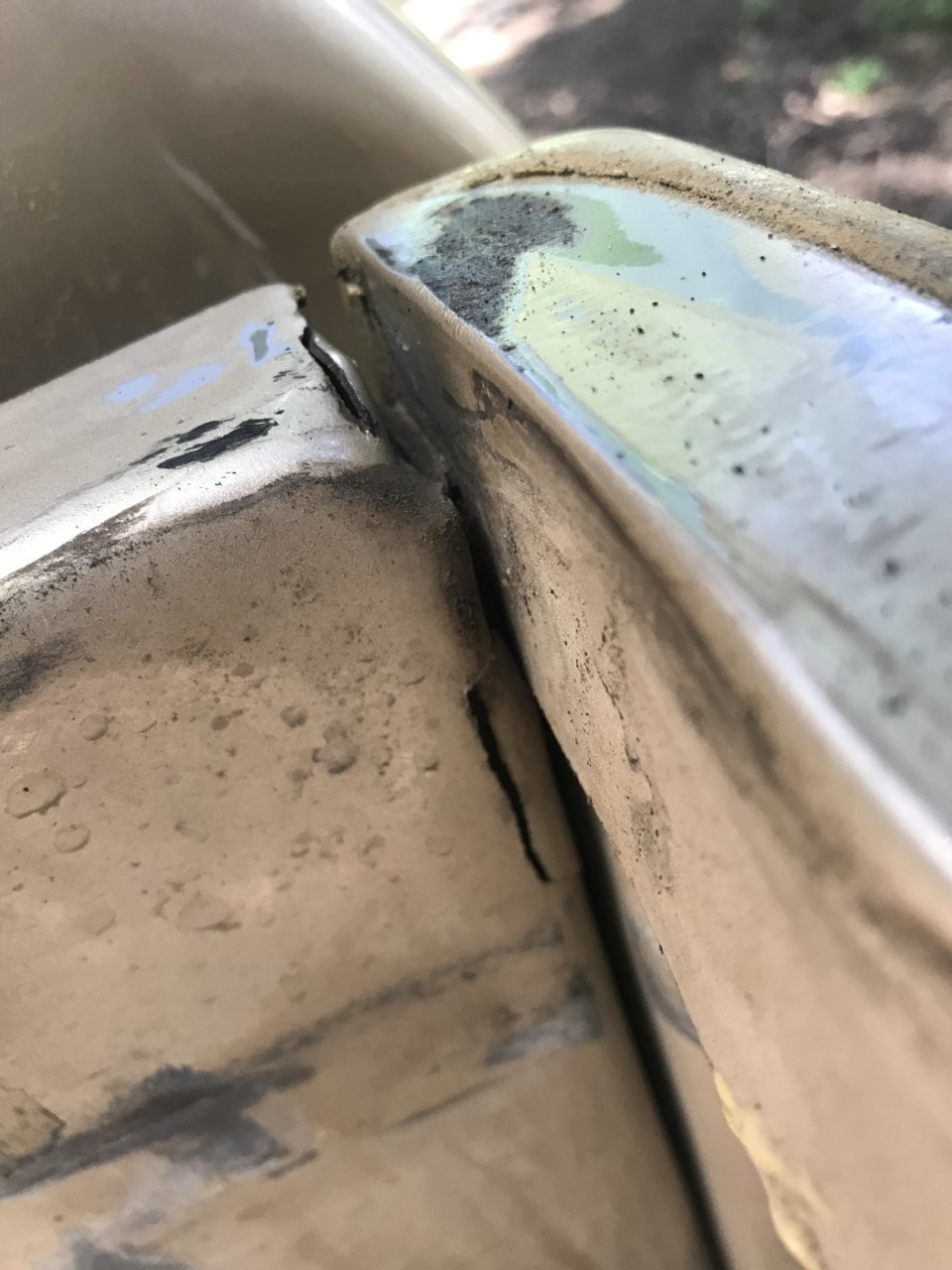

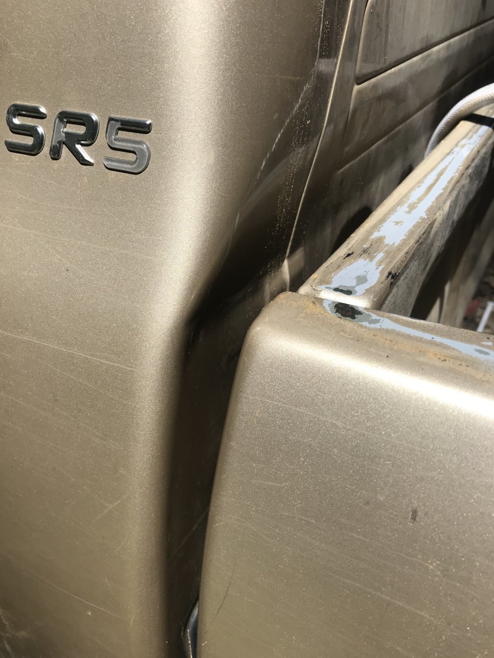

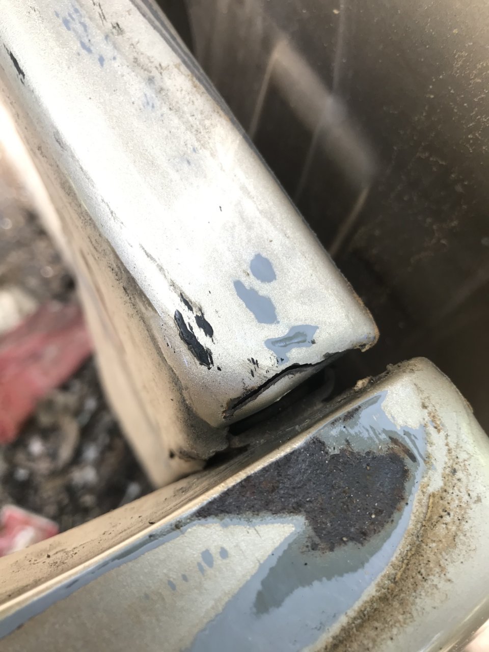

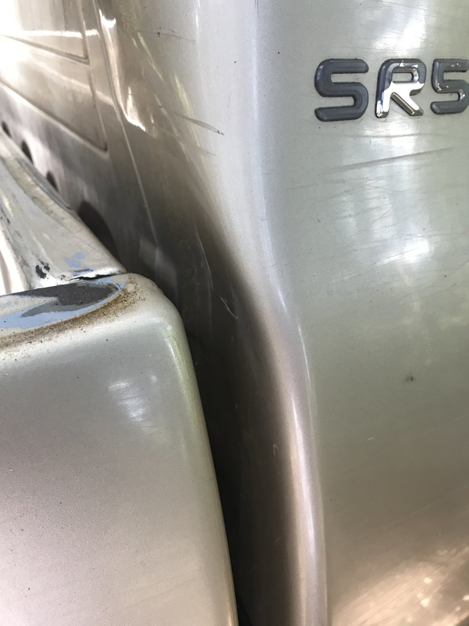

    Took off the camper shell and found some good sized dents in the back of the cab and the bed is cracked in the front passenger corner.

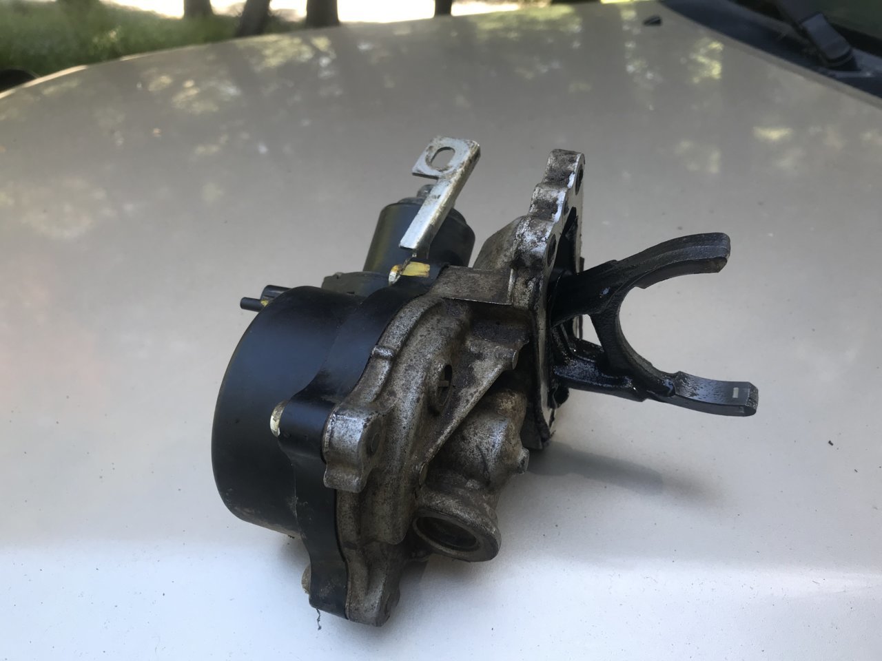

    My 4wd wasn't working on Saturday. I could hear the transfer case actuator doing it's thing but no dash light indicating 4wd. I put the truck up on jack stands and spun the wheels in 4wd and 2wd. The 4wd definitely wasn't working.
    The day after I bought the truck in 2012 the front wheel drive actuator died and I had it replaced by a shop for $800. It's only 6.5 years old with 110,000 miles on it so I didn't think it was that.
    I removed the actuator and bench tested it and it worked. So I reconnected it to the truck..still didn't work.
    Removing that thing is a pain in the ass. You have to remove the front diff mount bolts and disconnect the drive shaft.
    Next, I disconnected and reconnected all the plugs. After I did the one on top the transfer case it worked....just a faulty connector in the end. I cleaned all the plugs with contact cleaner.
    While I'm in there I drained the diff fluid. The RTV for the actuator needs to finish curing so I'm going to put new diff fluid in today.
    The only pic I took-

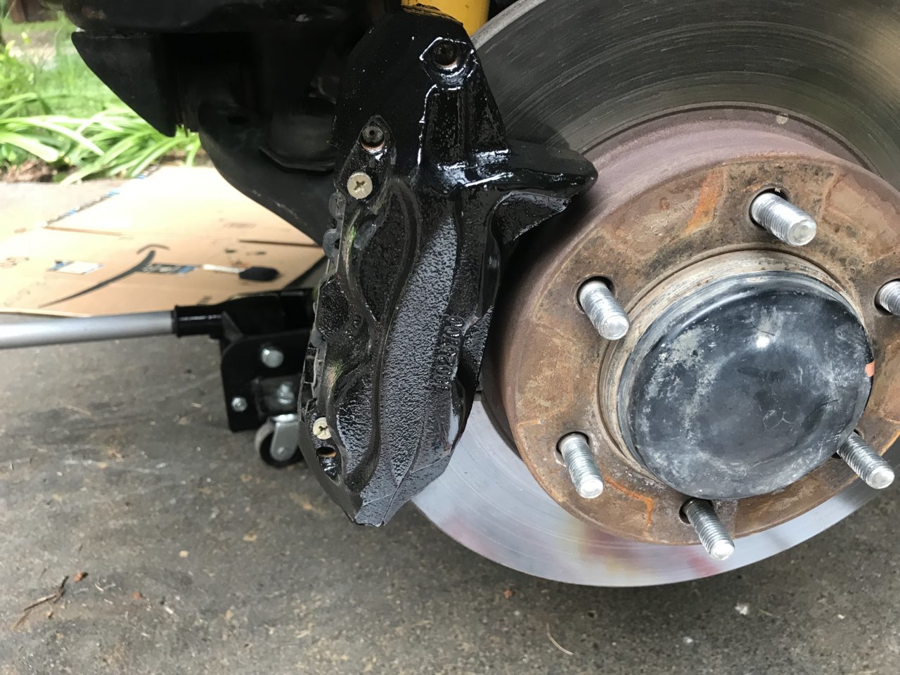

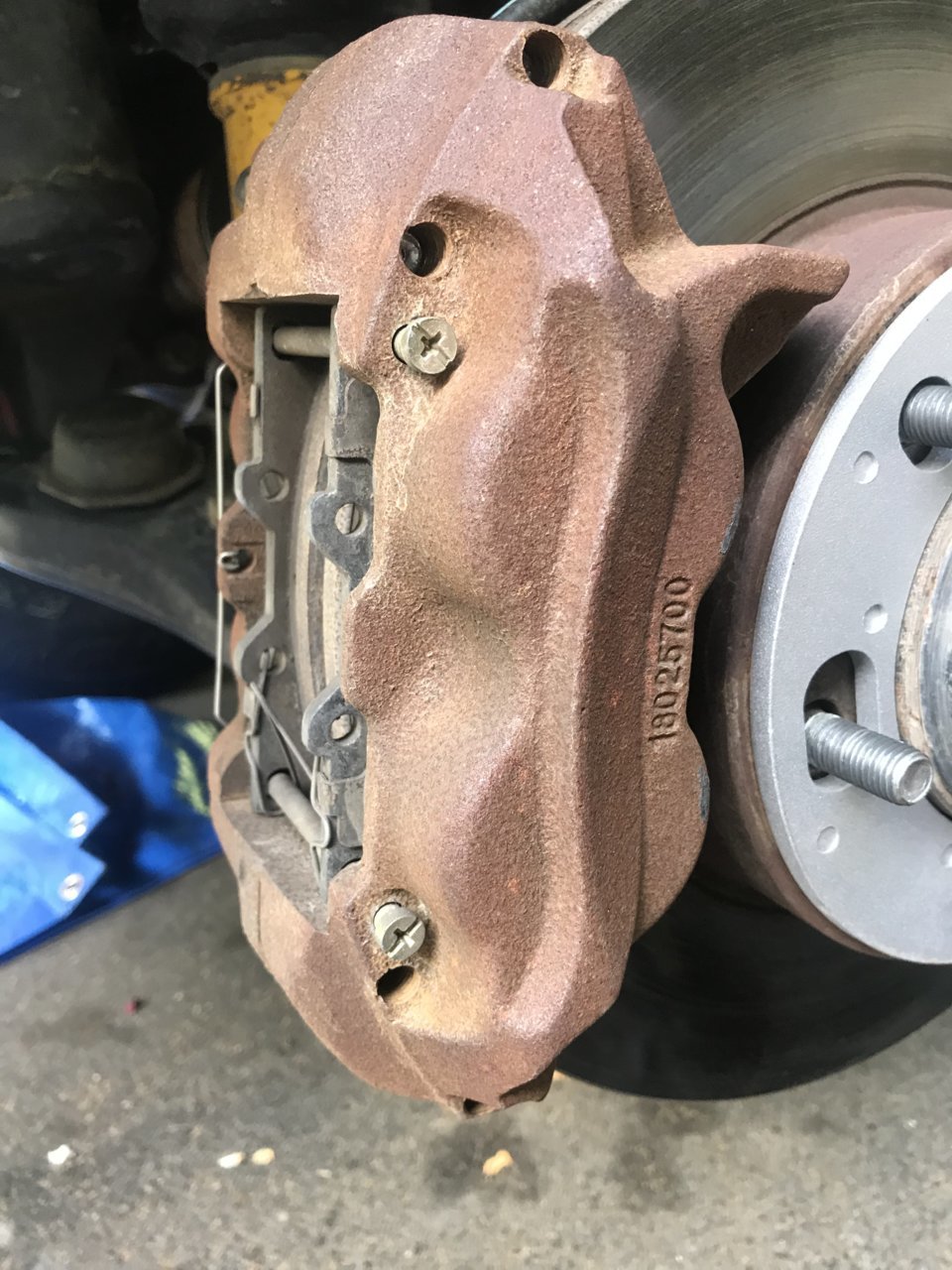

    Before-
    After-

    What did you use to treat/paint it?
  9. May 7, 2019 at 8:19 PM
    #249
    otis24
    otis24 [OP] Hard Shell Taco
    Dec 3, 2012
    #92402
    6,483
    Mark
    California
    OtisBound Outdoors Bodonkadonk
    OtisBound Bodonkadonk
    POR15 after good scrubbing, degreasing and POR15 metal prep.
    I have POR15 caliper paint which I still need to paint over the regular POR15.
    Edit: I might just leave it as plain POR15 though.

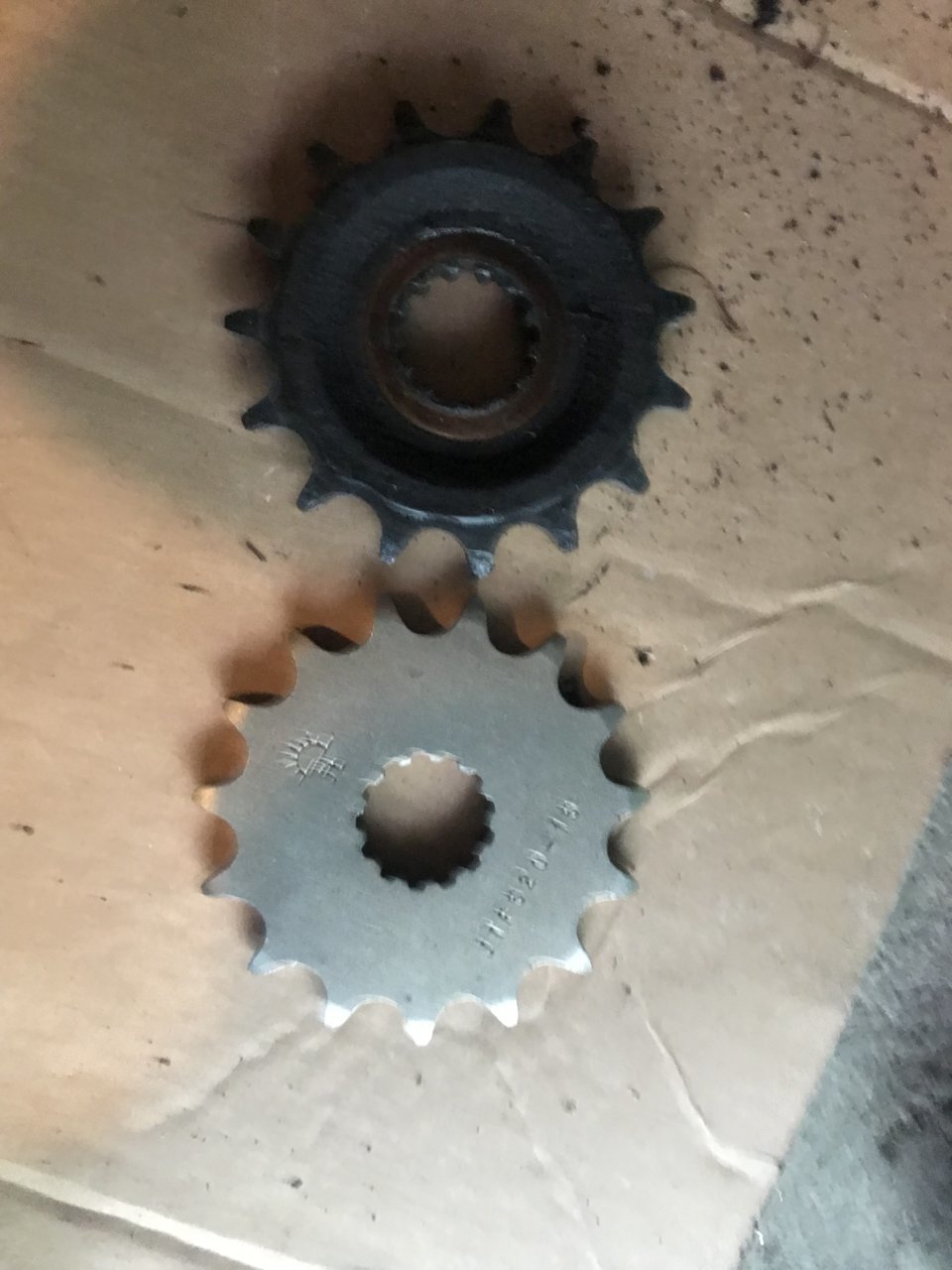

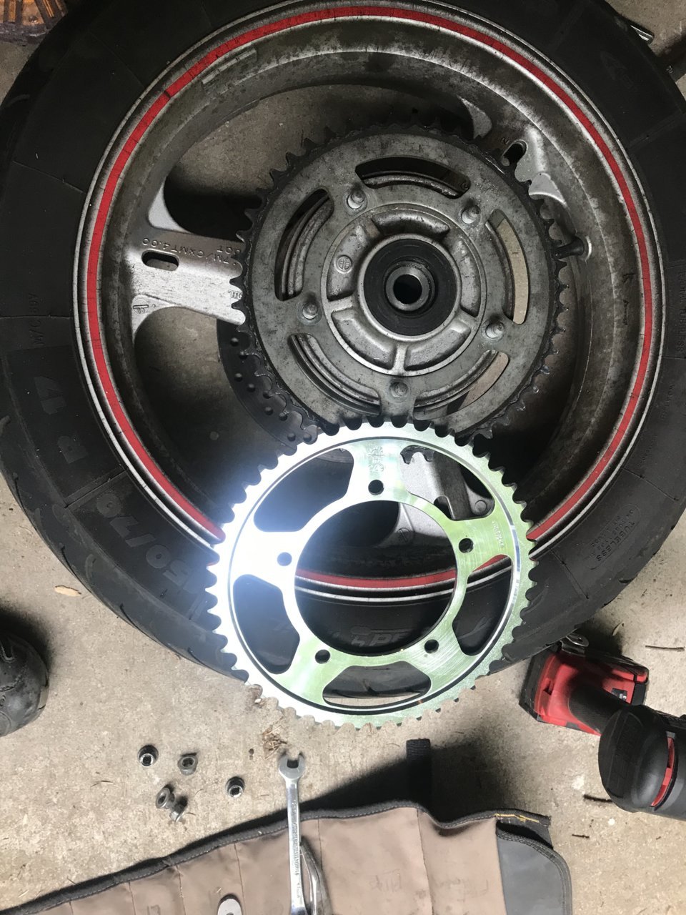

    Taquito got new sprockets and a new chain today.
    Also, a couple years ago I broke the shifter off. At the time we fixed it with a tent stake we found.
    I found the broken off piece under the front sprocket cover.

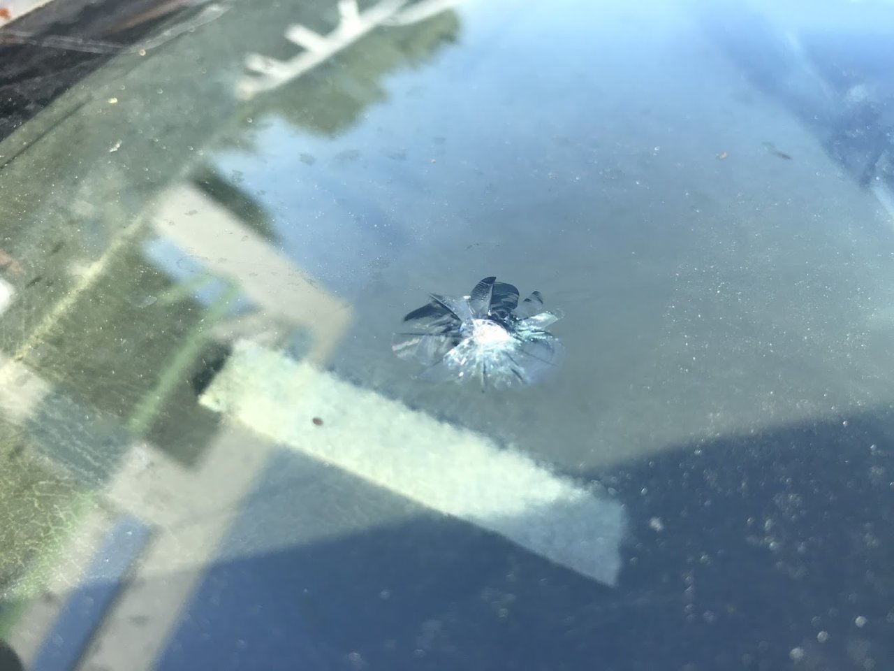

    I replaced my windshield in mid March because it had a crack across the length.
    Today I got this giant dime size chip on 880.

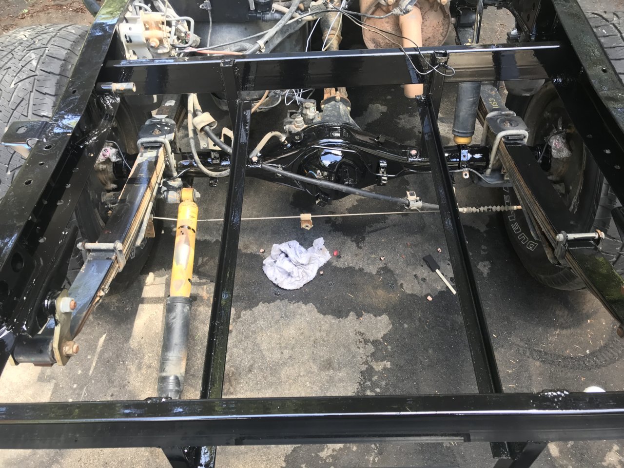

    POR15’d a bunch of the frame, aux tank hanger and axle housing.

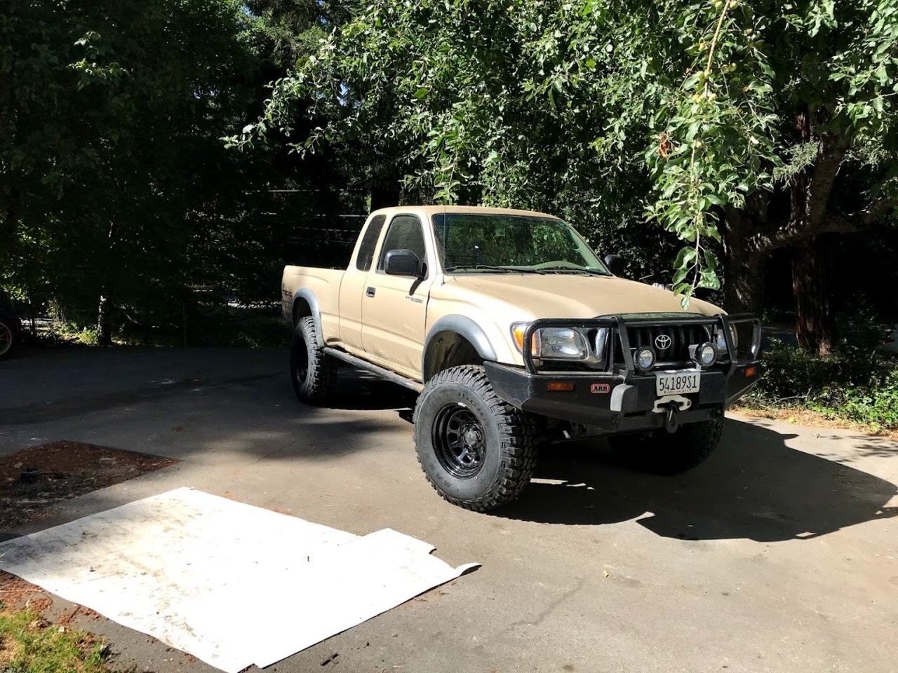

    New Wheels and Tires. Well, I've had the wheels for 2 years. I got them on Ebay for like $362 for 5 of them.
    Picked up the tires - Maxxis BigHorm M762 255 85 16's on sale at Simple Tire for $865 including installation. This is my second set of these tires.
