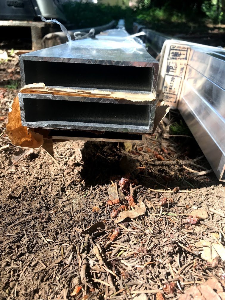

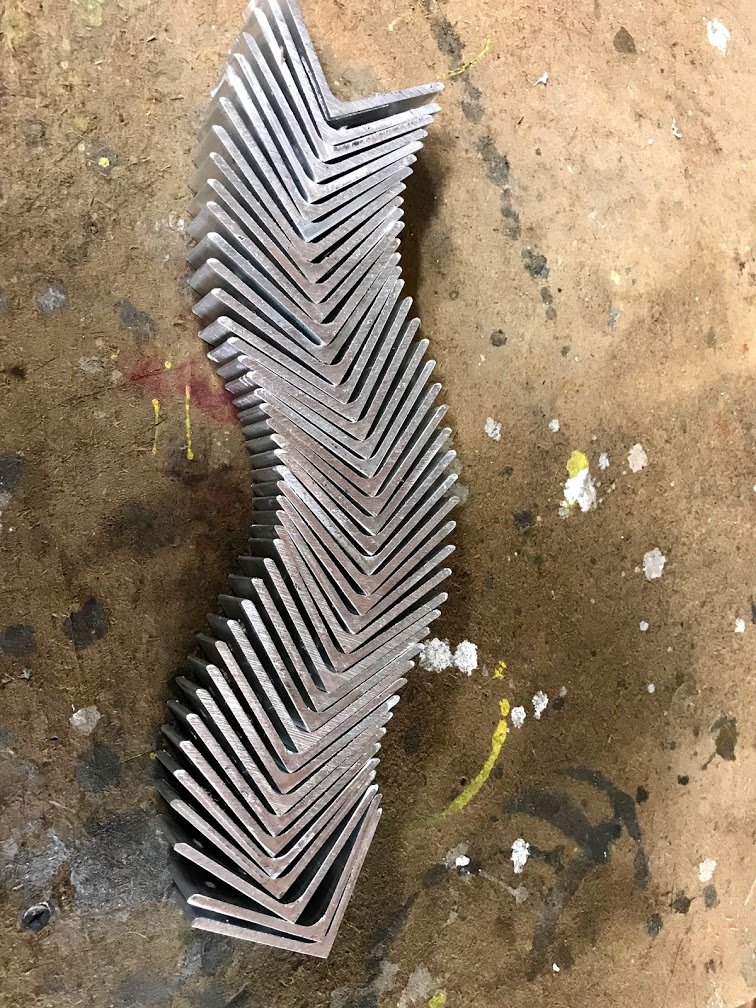

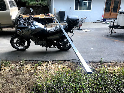

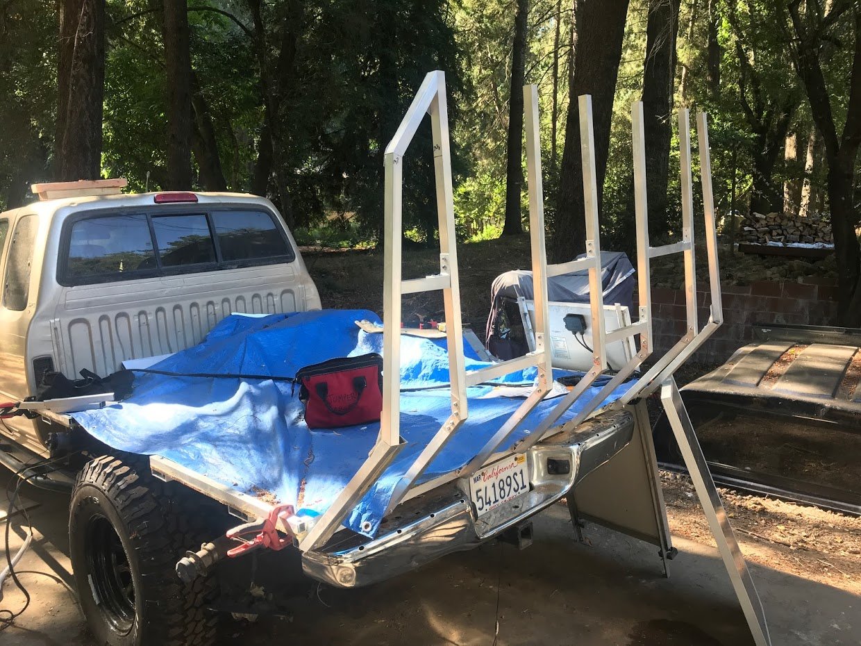

    After a shit ton of research I came up with making the frame out of 1/16 and 1/8 inch aluminum tube held together with brackets made from 2"x2"x.125" and then tape the sides on with 3M CV62F (commercial vehicle tape). I cut the Angle into 1" slices and then made a jig and drilled a bunch of holes in the brackets pretty early on because I had the bed of the truck off to POR15 as much of it as I could. I needed something to do in the meantime.
    Brackets I cut on a horizontal band saw.
    Next I had to make the base. I took forever to decide on this.

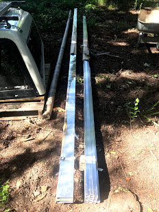

    In the mean time I needed my truck to pic stuff up, but I was able to get the tube delivered.

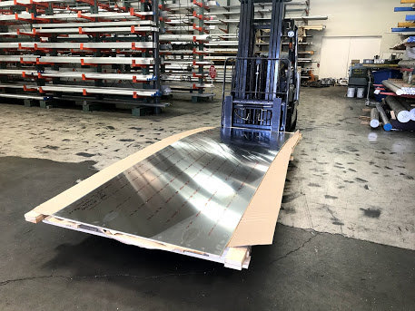

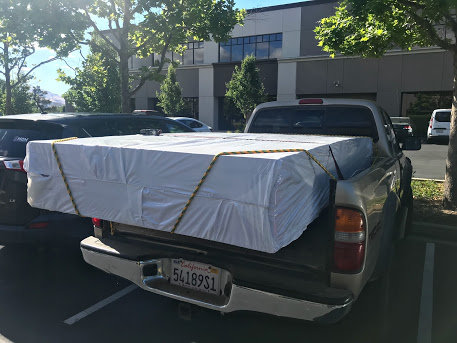

    I rented a Uhaul truck to pick up 5 4'x12'x.050" AL Sheet metal
    The last thing I need my truck for was to pick up 6 sheet of 2" owens corning foamular 250

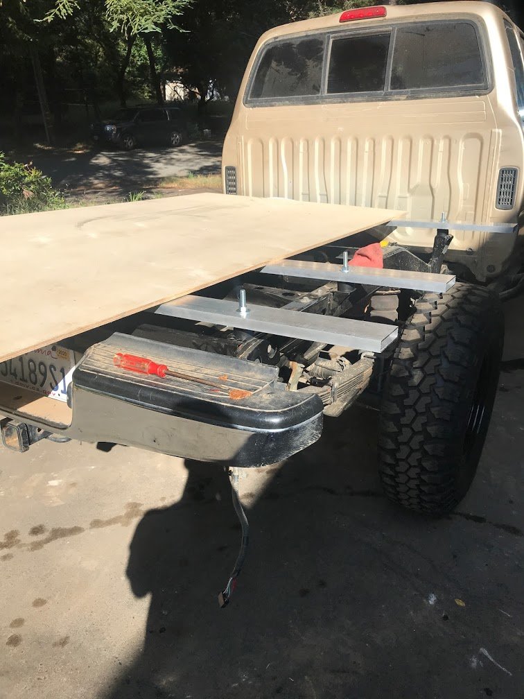

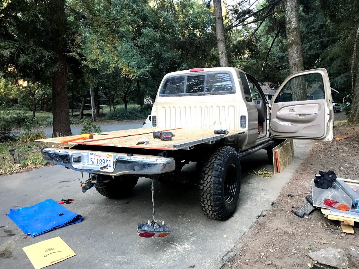

    The very bottom would be three 1"x4"x1/8" AL tubes bolted to the stock bed mounts. They're bolted down with 1/2 bolts and fat washers with a stack of bushings in between and underneath.

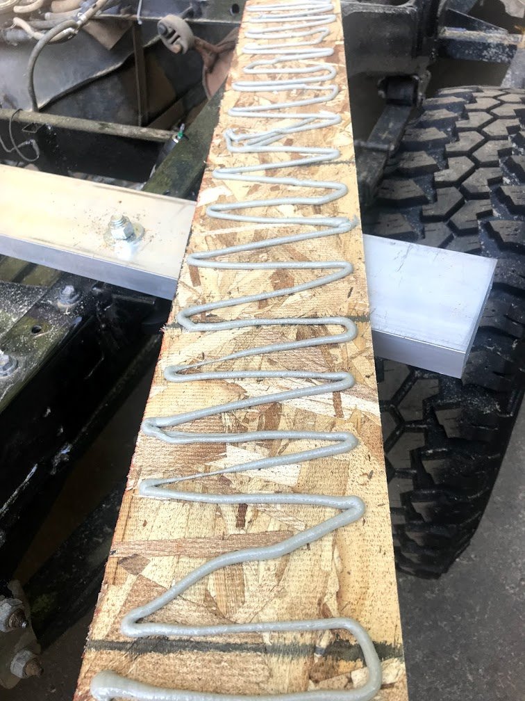

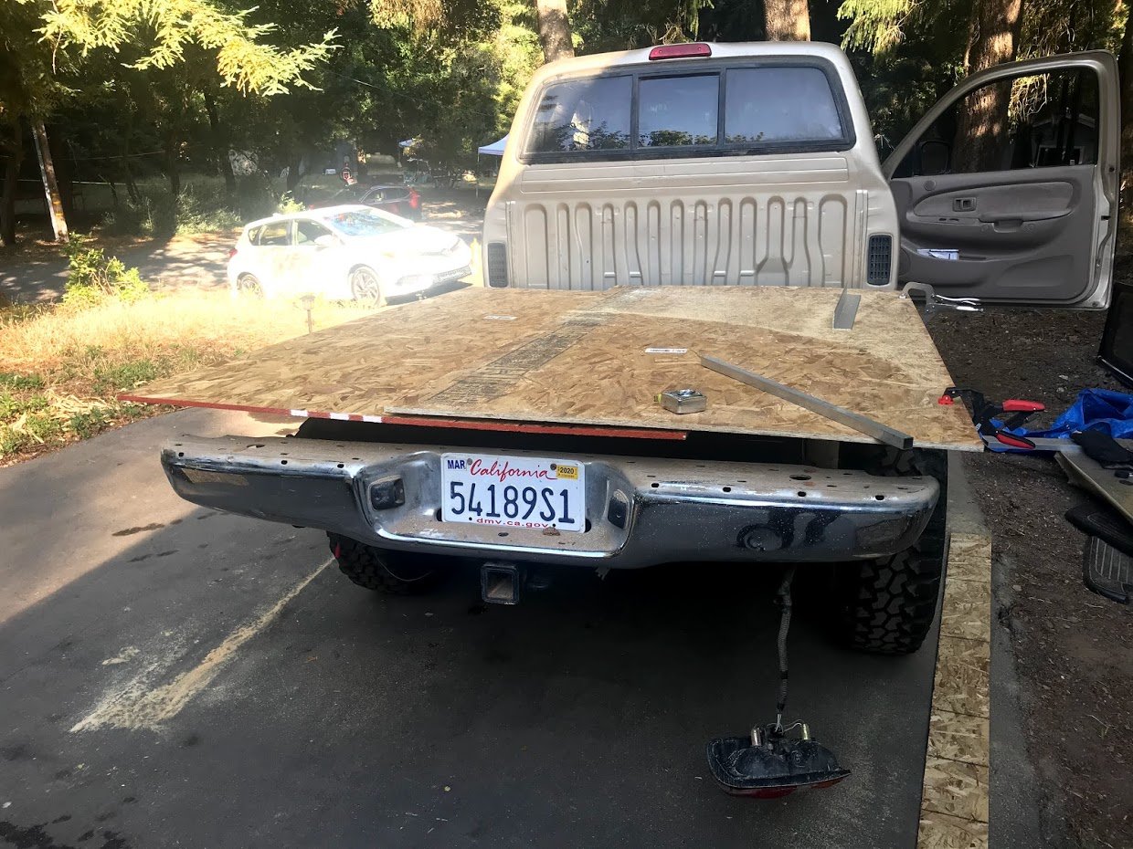

    On top the base tubes I decided on plywood. I still don't like this decision. I really wanted no wood, but plywood would be FAST. It was already July 13th and I'd just found out I was having surgery in a month and would likely be in the hospital for 3-5 days and would be out of commission for a month. My goal was to take this thing to Baja on November 15th for 2 weeks. The plywood would take a lot less time than a sheet metal and foam paneled bottom. But it'd be prone to ROT (bad!) At 1st I bought a sheet of 1/2" latvian birch plywood made with waterproof glue. It's in the pic above. Super nice stuff at $105 a sheet. I later decided to save this for other things. It's way too nice to hide!
    I ended up going with 3/8" OSB. I butted two sheets together and sandwiched them between 6" wide strips of OSB that were glued and screwed together.
    I think if the camper ever fails it will be here. I'll be able to replace the OSB if needed. It'll be a giant pain in the ass but it can be done.
    This is the OSB butted together so see where I'd need to cut it, Gringas looking on in the background...-
    Glueing the OSB with Loctite PL 8X...this stuff is crazy strong.
    You can kind of see the sandwiched strips here.
    Next I cut out the wheel wells.
    I had to waterproof the OSB. I looked into different kinds of deck sealant, paints and bed liner. In the end I coated the whole thing in 3 coats of garage floor epoxy. This took forever...about 2 weeks.
    YOu can kind of see the glossiness of the OSB here. I also cut the wheel wells and PL8X'd a perimeter of tube and started to build the wheel wells. I would later remove this wheel well and make another. These weren't right. The sides of the camper have a 3 degree slow. I made the wheel well vertical with no angle.

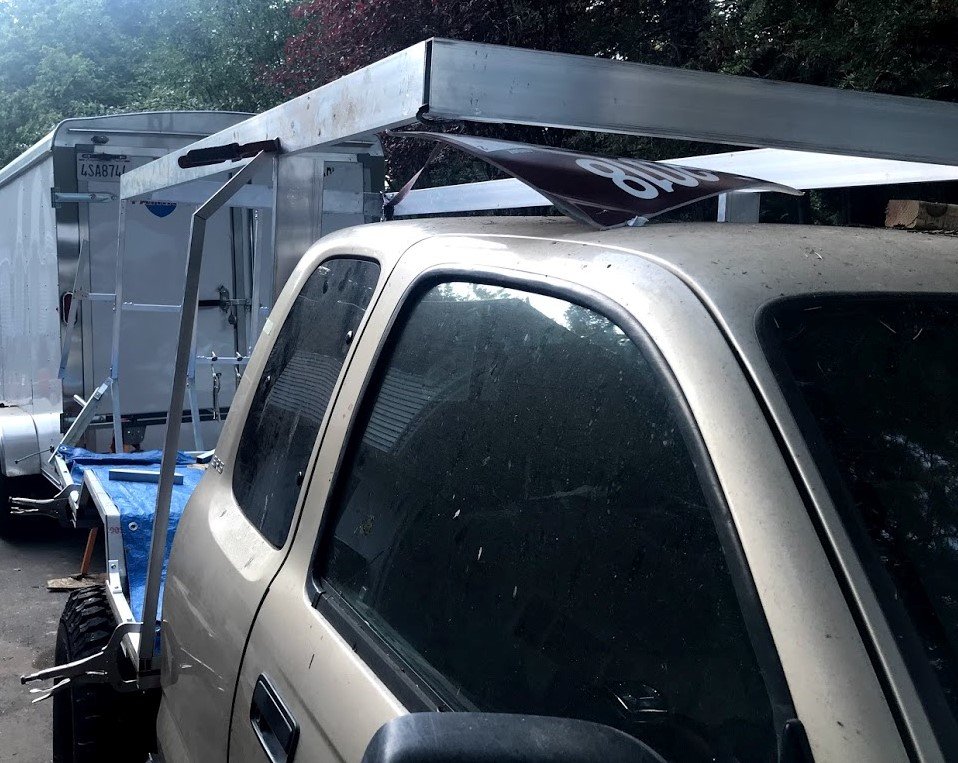

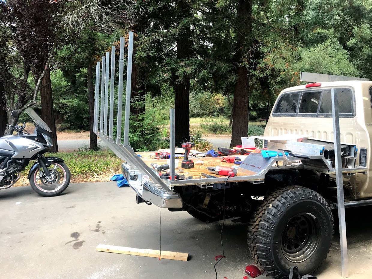

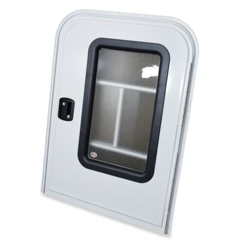

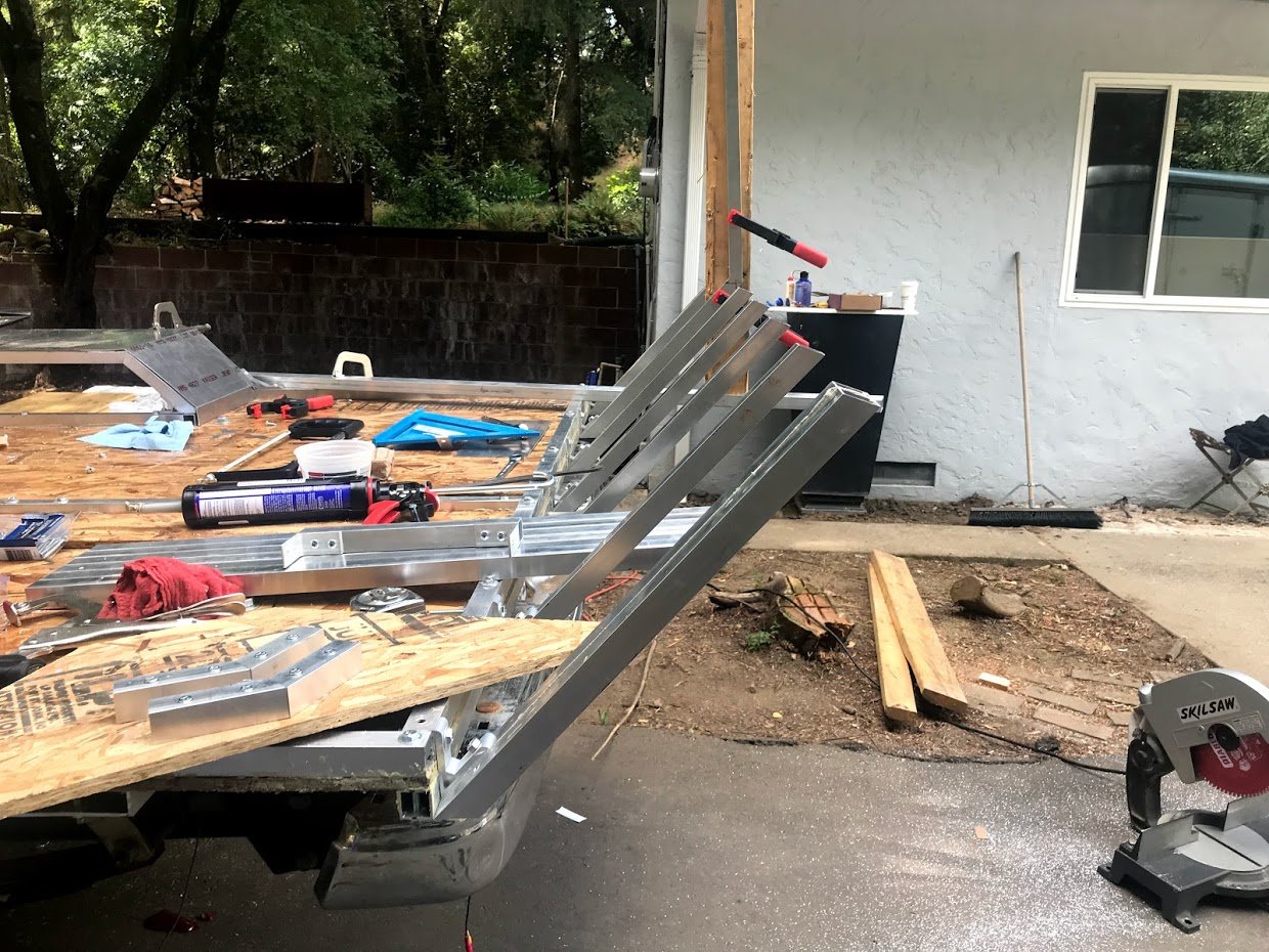

    After I felt pretty good about the base I started on the back. This actually took awhile. I didn't really know how to make the joints. I'll get to that later.
    I had a good idea of how far I wanted the rear overhang to go....about a foot. I decided on 45 degrees because I thought it looked nice.
    I made the distance from the back of the wheel well the back of the camper 36(?) inches because I was entertaining the idea of buying a tear drop camper door.
    like this -
    And then I decided screw that, I'm gonna make my own door 1st and it if sucks I'll buy the premade door. Also they're hard to come by with the latch on the other side.

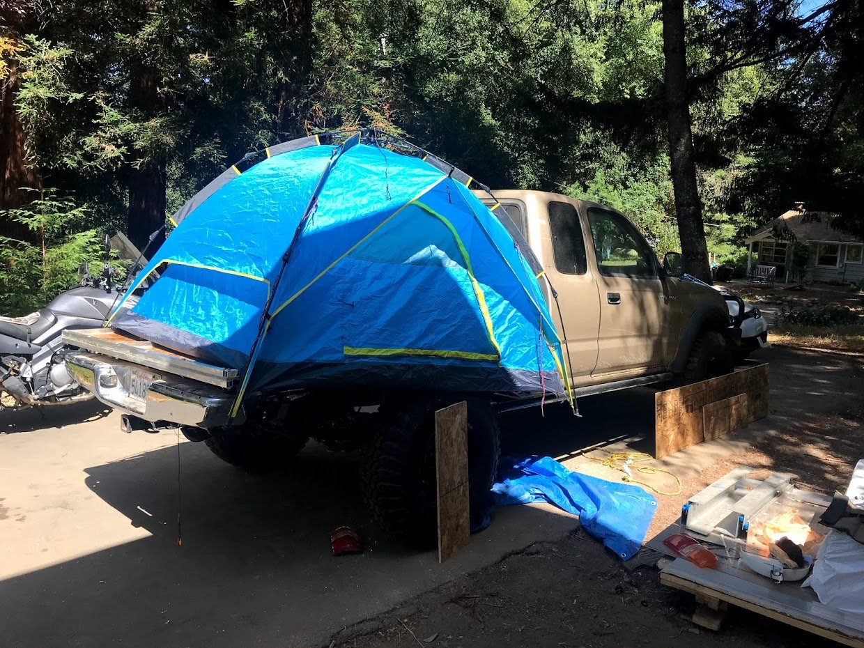

    For a little while I was like "Fuck it...I'm gonna stick my $45 Amazon tent on it and call it done!"
    I'ts sorta got a shapely ass.

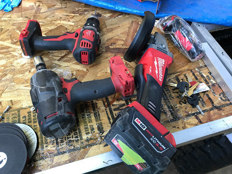

    My slowly growing collection of M18 tools.
    Taquito helping out as a saw horse.

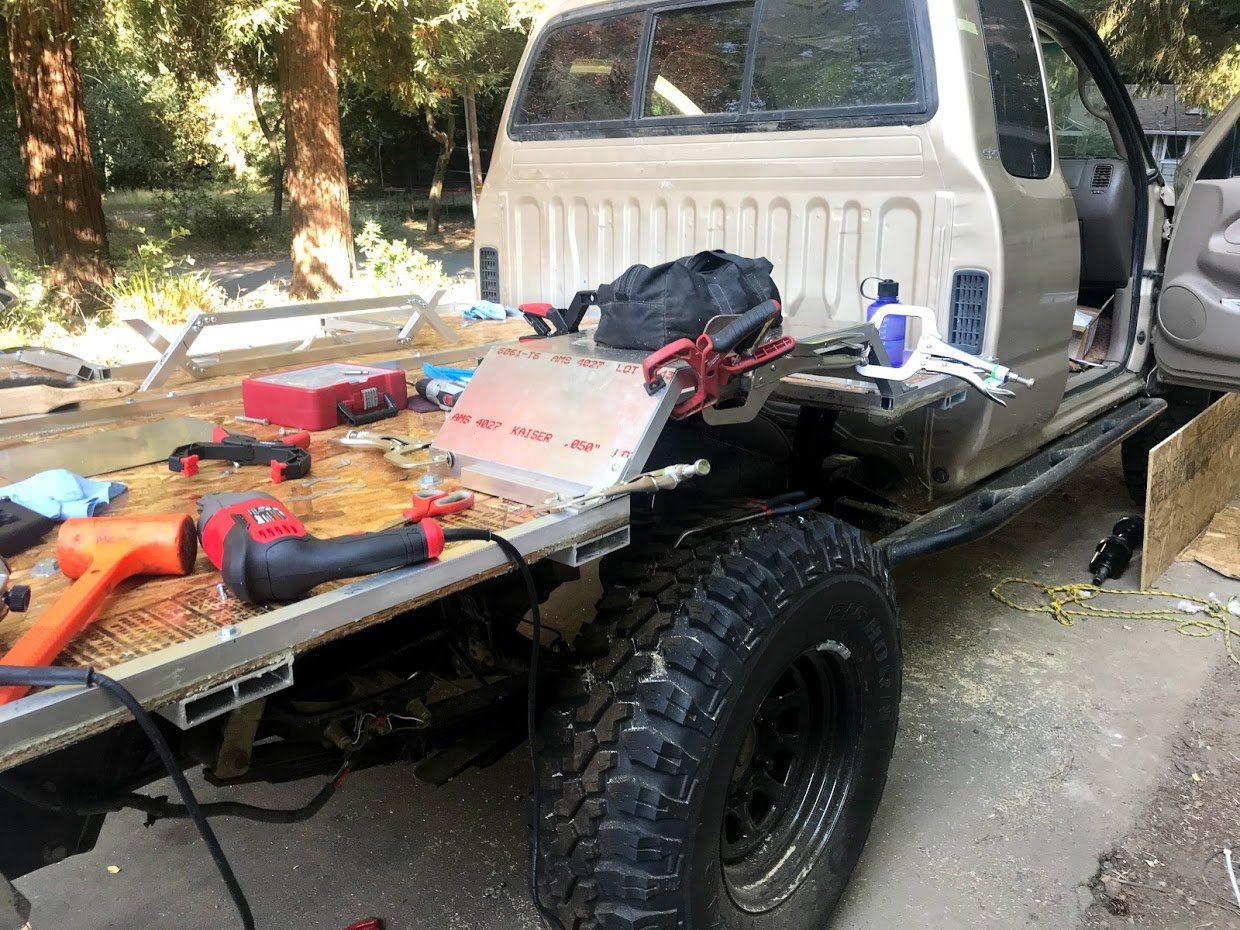

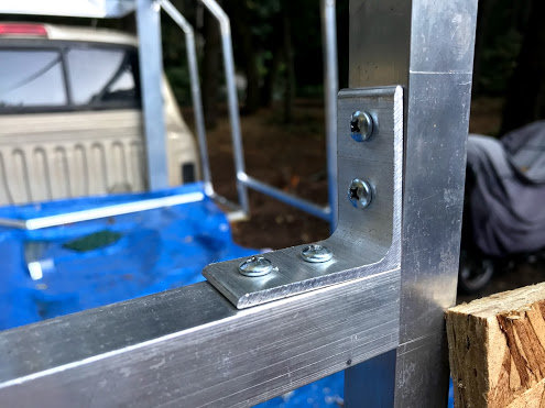

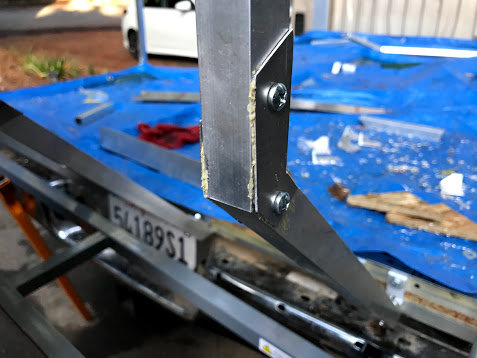

    This is how most the frame is held together. Self drilling, self taping screws and the brackets I made.
    And these brackets. The sheet metal skin cut to fit and screwed together with some glue.

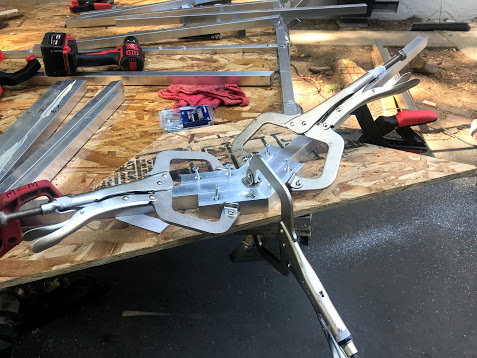

    Here's one of the jigs I made...or in this case it appears I'm in the process of making it.
    Here's a time lapse of using the jig. Actually the video might be a different jig. I made a few. But whatever, you get the idea of how it works.
    https://www.youtube.com/watch?v=3XR-sKwz4vE&feature=youtu.be

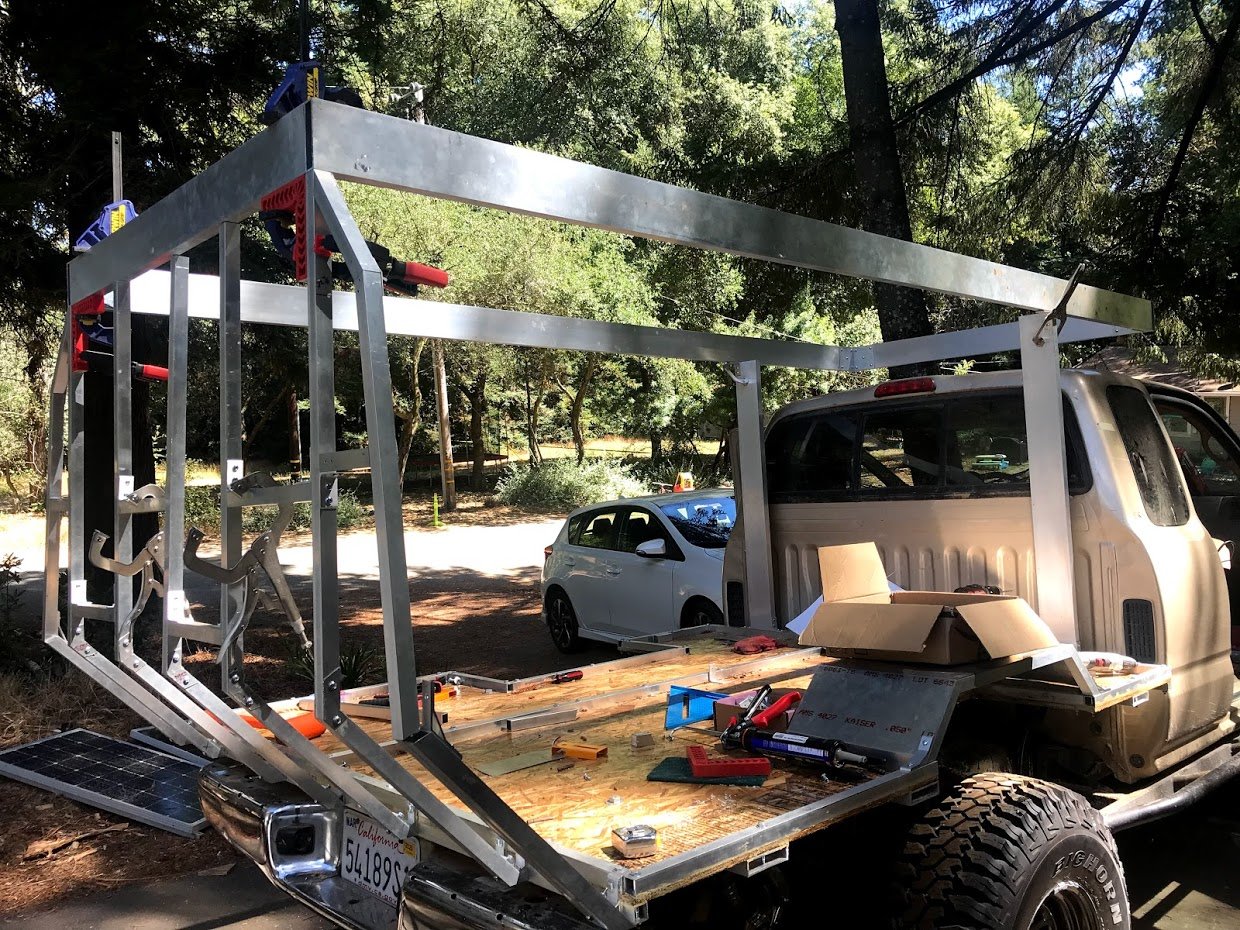

    After I got the back part mostly finished I stopped work for a month.
    when I came back I finished the back.
    I kept the garage floor epoxy coated OSB covered because I'm pretty sure that stuff is not UV stable at all.
    Next was put the top of the bottom on. It's 1"x4"x.125"Aluminum tube glued and screwed together with PL8x and self drilling self tapping screws. For the screws I'd pre-drill a hole slightly smaller than the screws. Otherwise nothing would line up very well.
