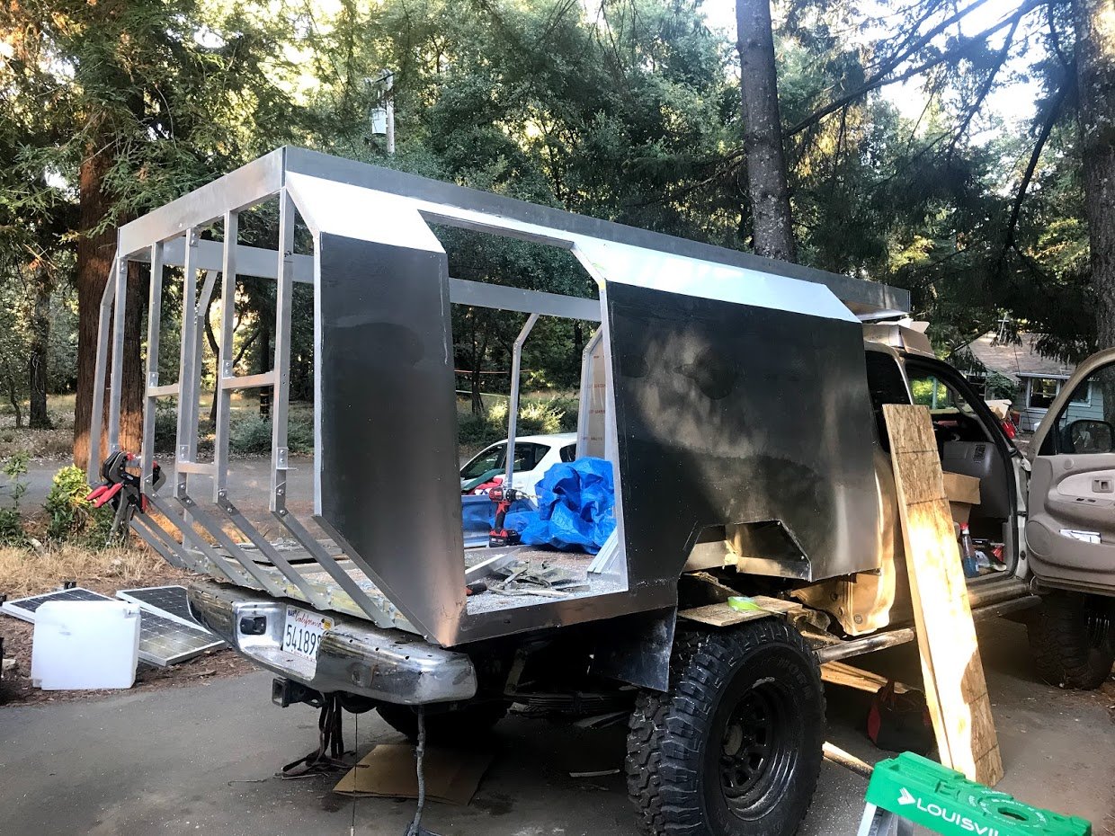

    Most of the frame ready for skin. I got rid of the wheel well I’d built. The outside if it was 90 degrees to the platform. It needed to be 3 degrees off.

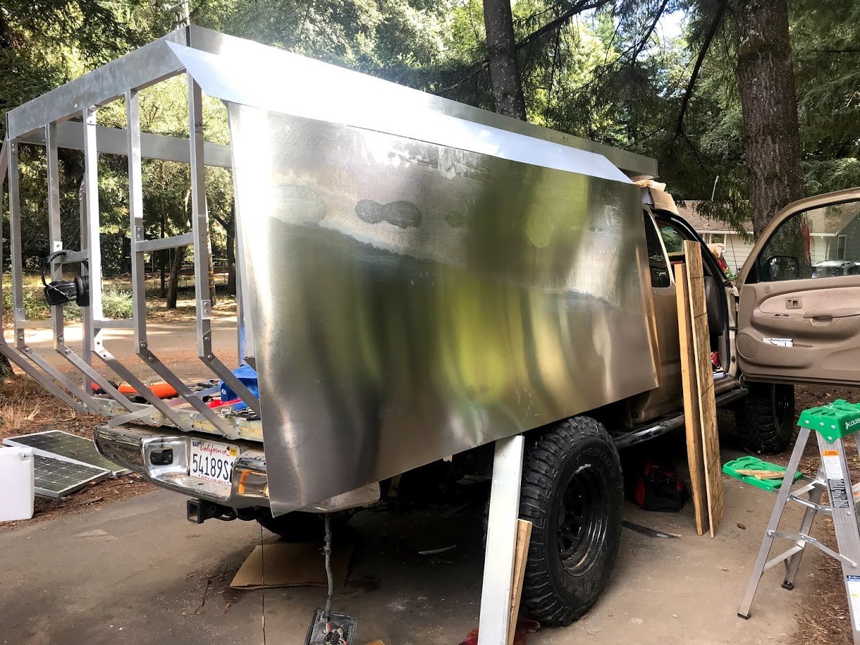

    Before I could put the skin on I had to frame the doors. I didn't take any pics but it's basically 1" square tube with 1"x1.5"x.125" angle glued or taped on top of it to form a lip on the inside of the door facing out to attach weather stripping to. With the framed doorways built I could cut out the part of the panel where the door was going.
    Originally I was going to bend the sheet metal for the angle along the top. I couldn't find a reasonable way to do that so I opted to use 2 separate panels instead.
    I still hadn't figured out using the router to cut the sheet metal so cutting the doorways was going to be a bastard with the electric sheet metal shears.
    This was October 6th. I had 4 weekends until I had to leave for Baja.

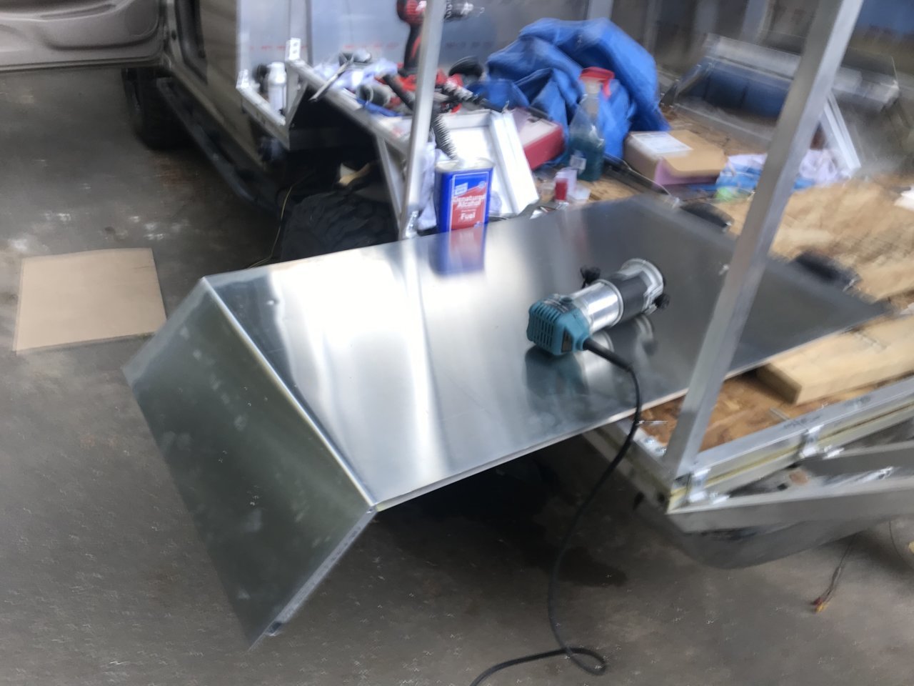

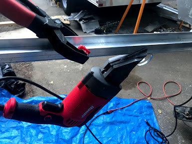

    Lol...I already had those. I bought electric sheet metal shears. The shears work great for straight lines but suck on curves.
    I finally figure out the router. It just needed to be at higher RPM's. Everywhere I read said low rpms will melt the aluminum and gum up the bit. Turns out that's not really the case. If you crank the rpm's you have to keep the router moving. If you go too slow it'll melt and gum up the bit.
    In the video below I'm using a piece of 1x2 aluminum tube as a straight edge and a 3/8" diablo straight side flush cut bit. This worked really well.
    https://youtu.be/LRaa5QxWo58

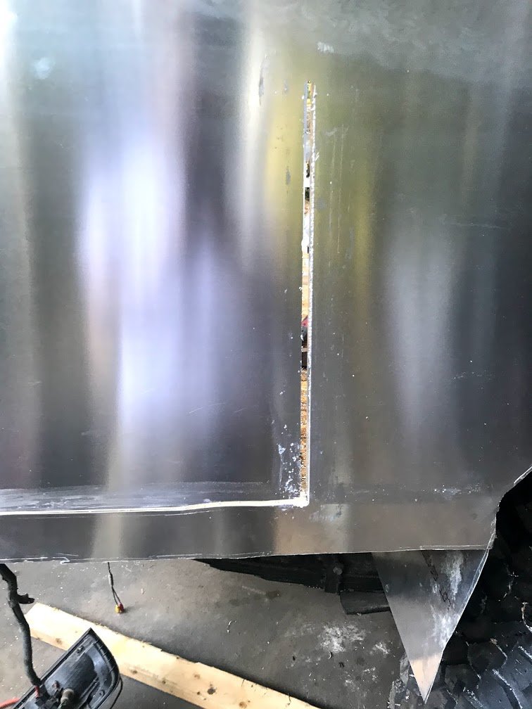

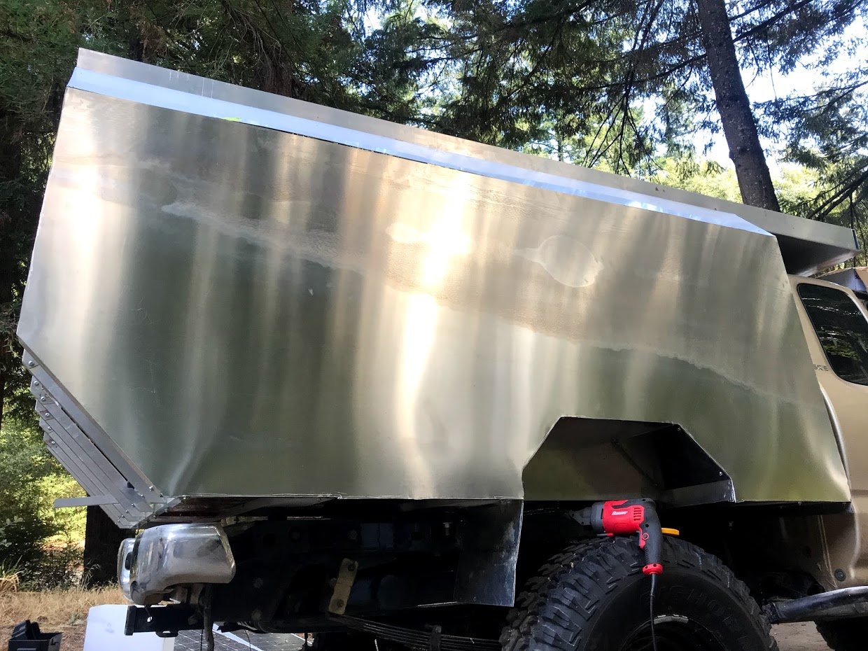

    This wheel well was a m*ther f*cker to cut out with the sheet metal sheers. I think it took me about 3 hours.
    And then I finally figured out that I just need to speed up the RPM's on the router.
    And like a minute later there was a doorway! I was so stoked to figure that out! And it was so obvious the whole time!

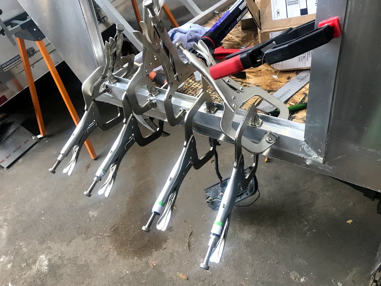

    Trimming the trim for the doorway.
    Lots of clamps for the door trim.
    "Give em the clamps, Clamps" was in my head the whole time.

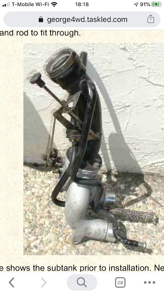

    I found a pic of this thing online. It's from Australian 80 series Land Cruiser. You pull or push the lever that's sticking out to fill one tank or the other. I'd love to have this. I haven't been able to find it anywhere.
    My current dual tank filler set up is all kinds of wrong at the moment.

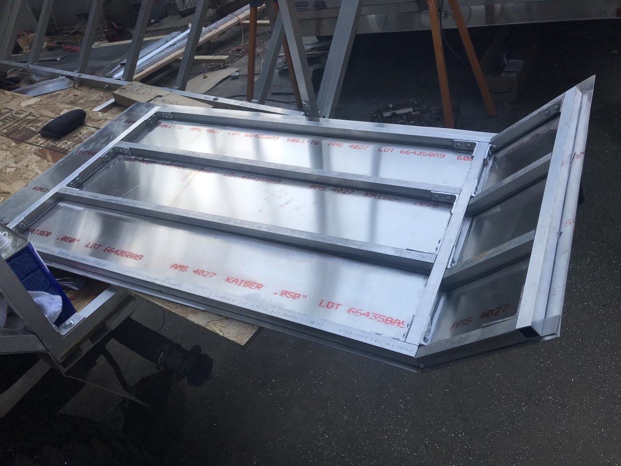

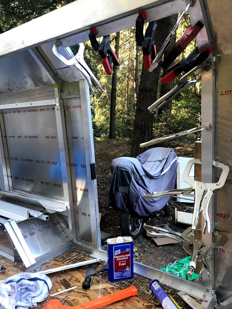

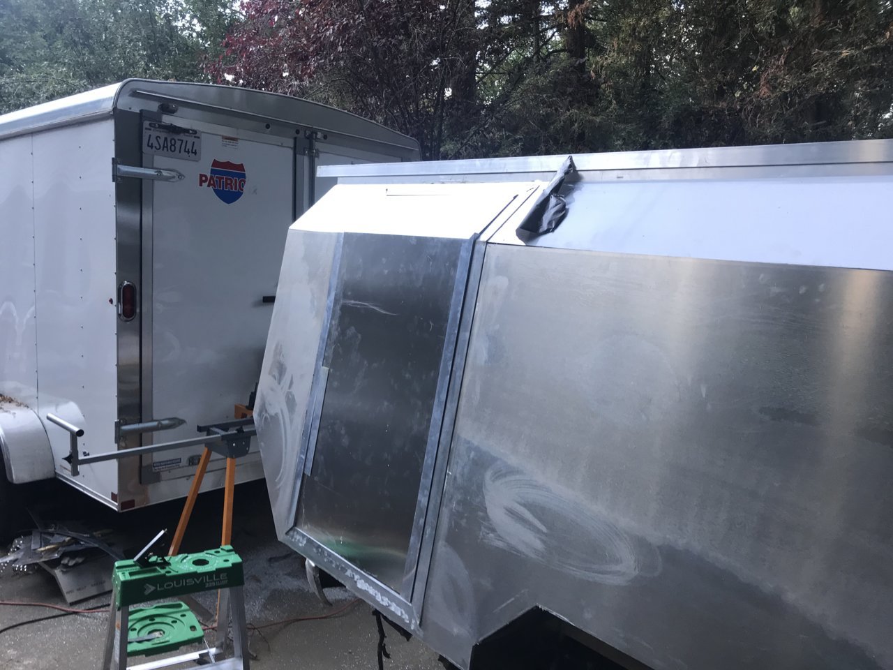

    Once the door frame was all set I built a door. I bracketed a frame together, then vhb taped the skin to the frame and glued the trim on.
    This door didn’t come out well. I spent a whole weekend on it.
    I built the second door by cutting and bending the skin first. I bought thinner vhb tape (.063 vs .040) and attached the trim to the skin and then vhb taped the frame to the inside.
    The 2nd door took 4 hours.
