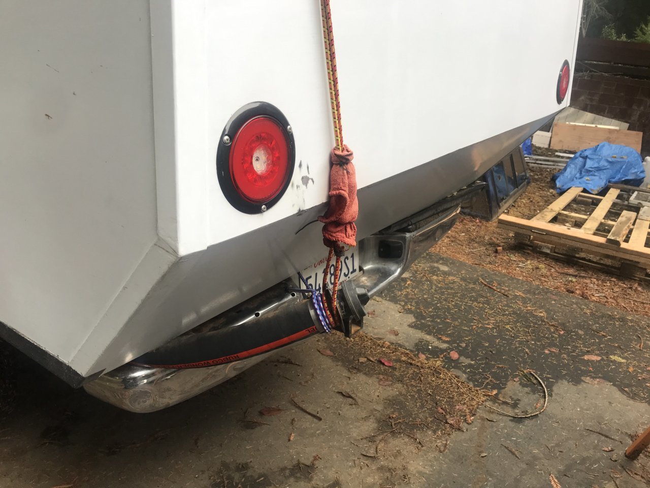

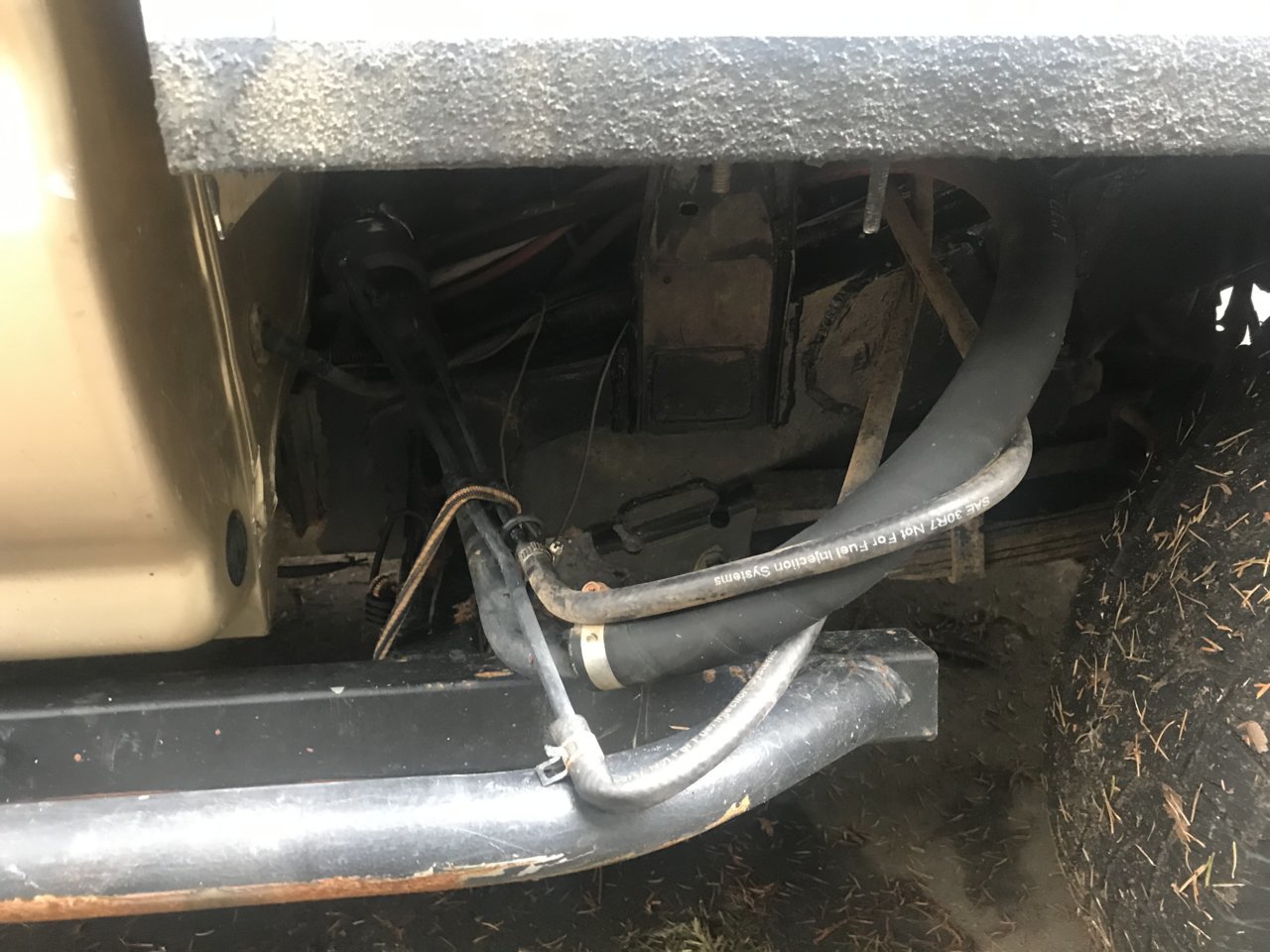

    I think I might have plan for the fuel fillers. I’m going to put each one in front of and behind the wheel well.
    The hoses will enter the bottom of the camper and come out the sides just above the wheel wells.
    To prevent fuel fumes from getting into the camper I’m going to place the hoses inside PVC pipe where they are inside the camper and seal these from the outside. That way when I fill the tanks if a little gas dribbles down the hose it’ll still be “outside” the camper.
    This is the current set up:
    The main tank has extra lung hoses. They’re bungeed to the sliders. When you want to fill up you have to un-binge and hold the filler neck with your hand while you fill up.
    The rear tank is even better!

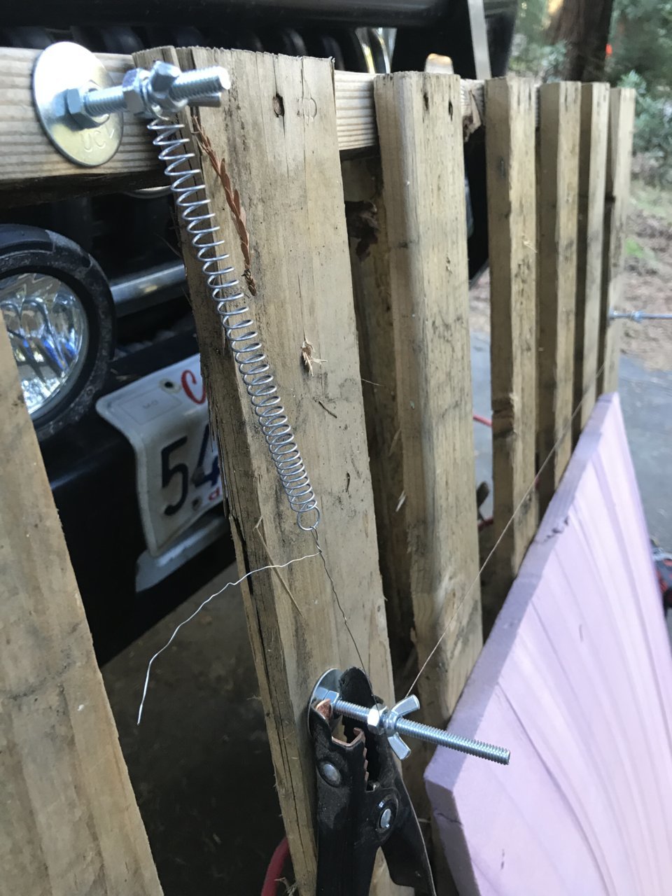

    For insulation and structure I’m using Owens Corning Foamular 250.
    The space the insulation is going in is 1” aluminum tube plus a layer of 3M CV62F commercial vehicle tape thats 1/16” on the inside and the outside for a total of
    1 1/8”.
    No one makes 1 1/8” foam so I tracked down 2” foamular. I found one place that sells 2” and it was down the street from my where I work.
    I have remove 7/8” off the thickness. And it has to be fairly even.
    I bought 24 gauge nichrome wire
    Some 1/4” nuts and bolts, a spring and grabbed a pallet.
    I just hook up jumper cable from the battery and slide the foam down the pallet into the wire and it cuts the foam nice and clean.
