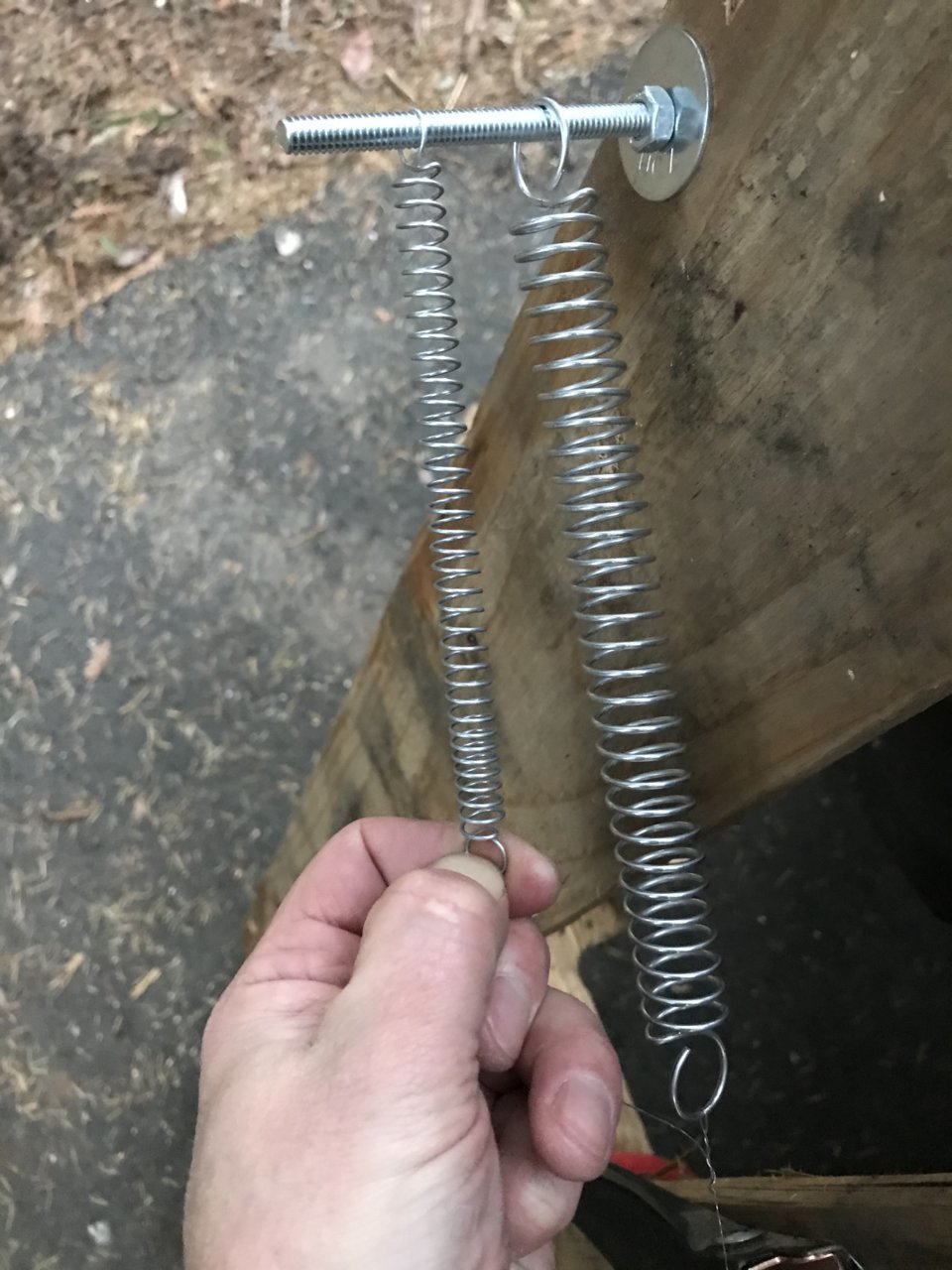

    Got a bigger spring for the foam cutter. I didn’t really test it well but the little I did test it seems much improved.

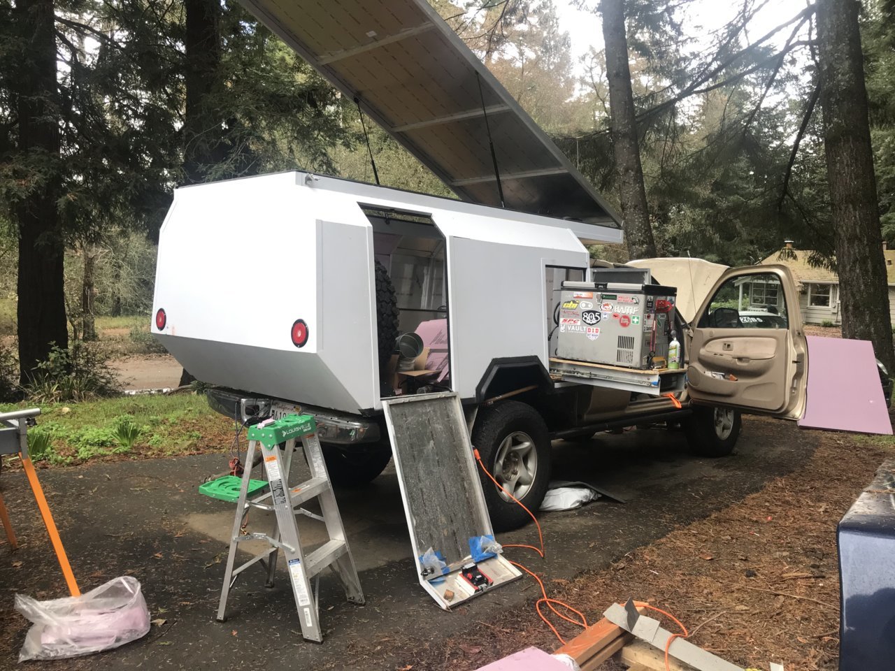

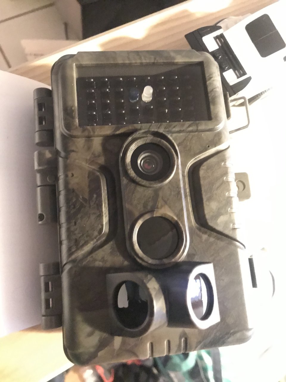

    Back to work!DCF7A126-1ED2-4CCA-841A-885D2ABD00A3.jpg Got this for my back yard and camping 9E030599-BF05-44F4-8E24-7CADF4F21835.jpg

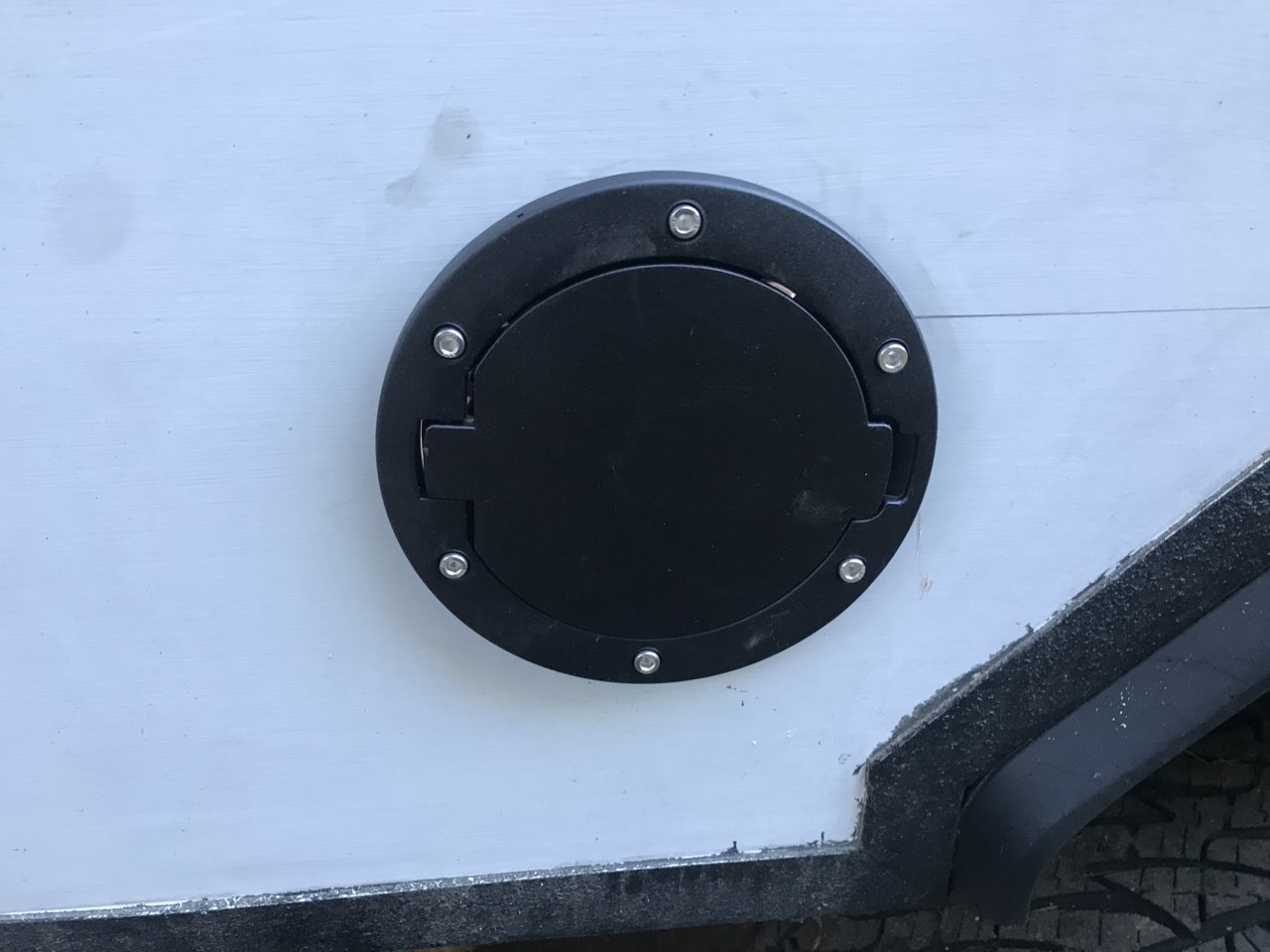

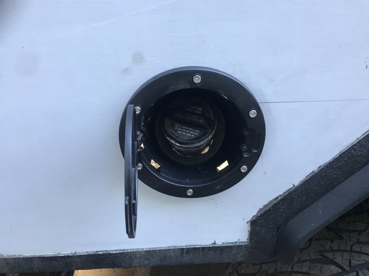

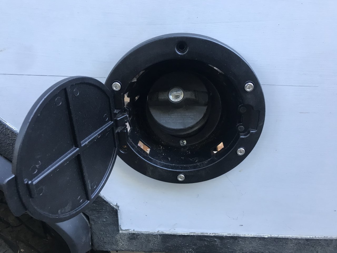

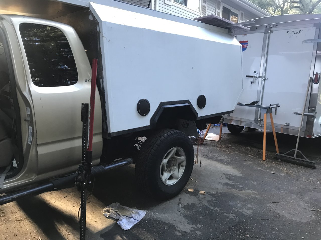

    Installed the fuel filler doors today. After I put some gas in the tanks and know I can actually put gas into them I’ll box out the hoses where they go through the camper to isolate them from the interior 0F818A03-ECA7-41F7-BC1D-537801B3B768.jpg F890064E-B27F-4D16-81E2-0F07AF3CFE85.jpg 77BF1834-9253-4B59-B87C-60E82DB3C8FD.jpg EB75B764-D548-4CA4-BC3C-42A3FB01401D.jpg

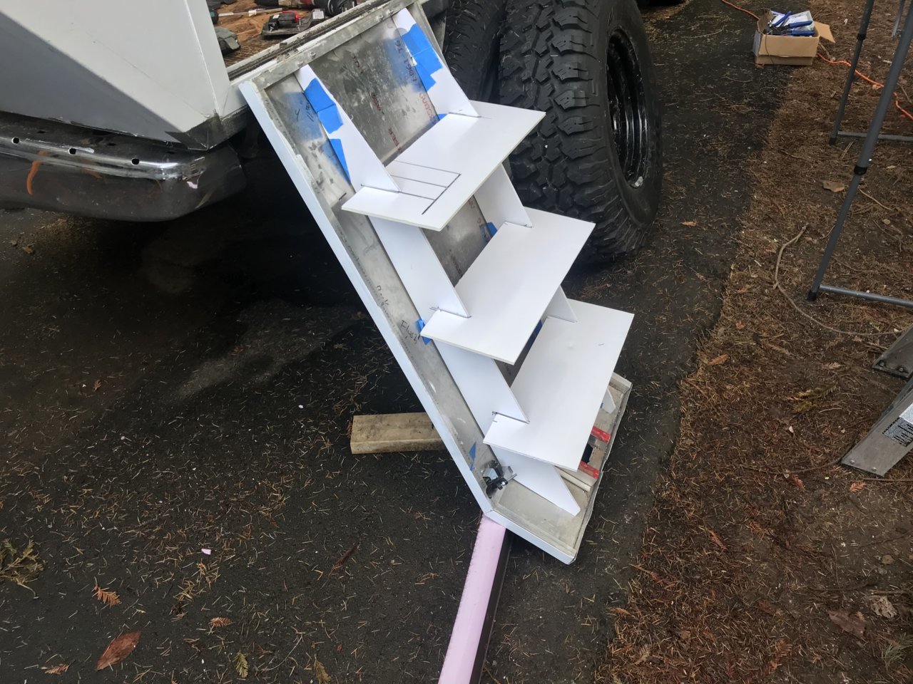

    7962038D-39C2-4567-AF0F-FCDB923516B1.jpg Took a break from foam and mocked up some stairs from foam core board.
