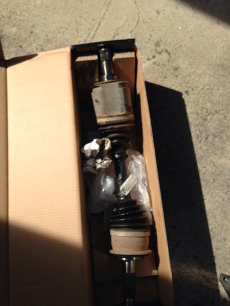

    I got the new CV in and changed both diff and transfer case fluids last week. ImageUploadedByTapatalk1436404799.143940.jpg

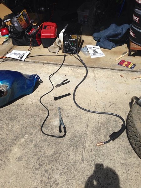

    Today we took off the bed
    ImageUploadedByTapatalk1440911302.690605.jpgImageUploadedByTapatalk1440911314.423415.jpg
    Bought a welder
    Did some welding
