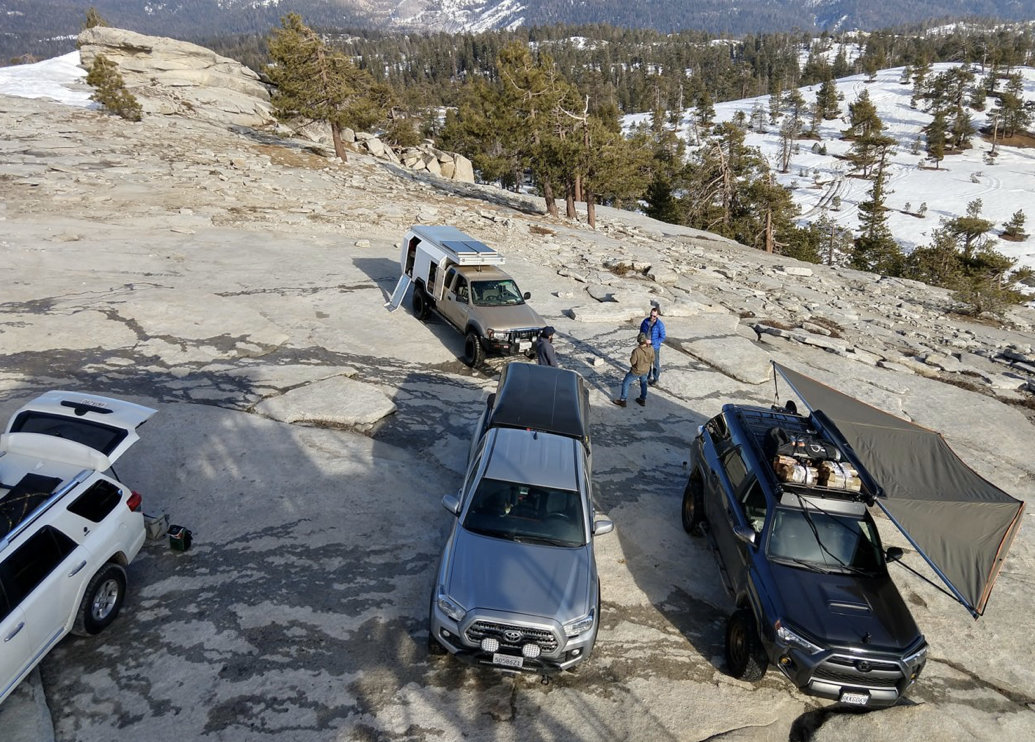

    Oh yeah, @theed took that pic. His truck is the 3rd gen front middle. The dudes with the 4runners on either side were cool.

    Yeah, what a coincidence it was running into you up there. ;)

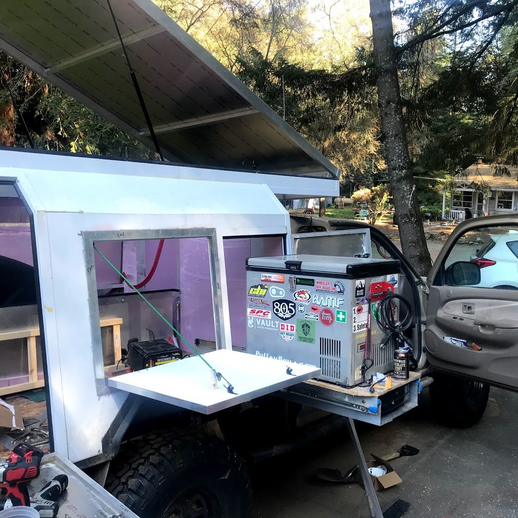

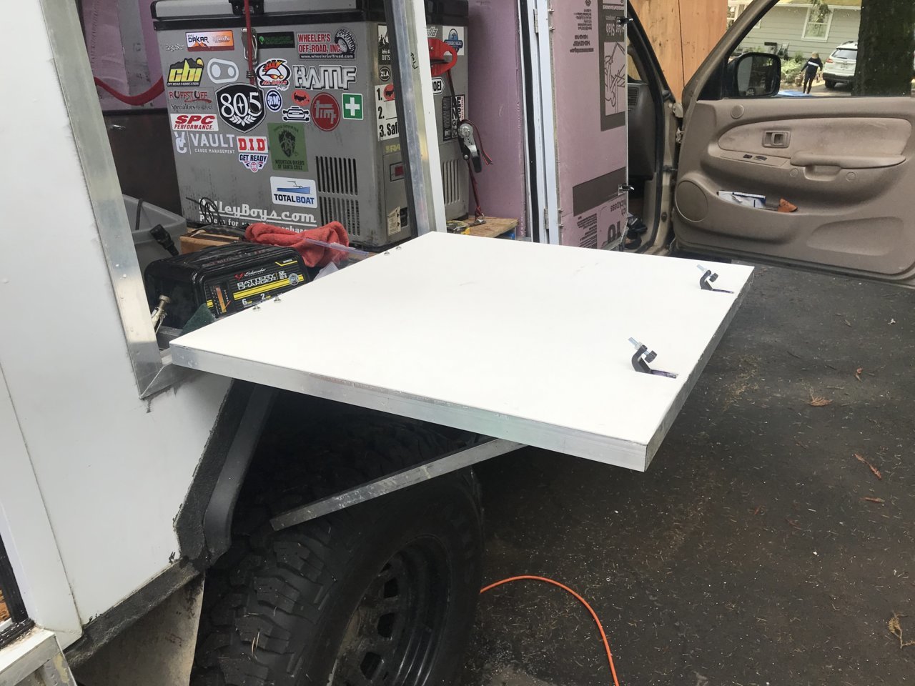

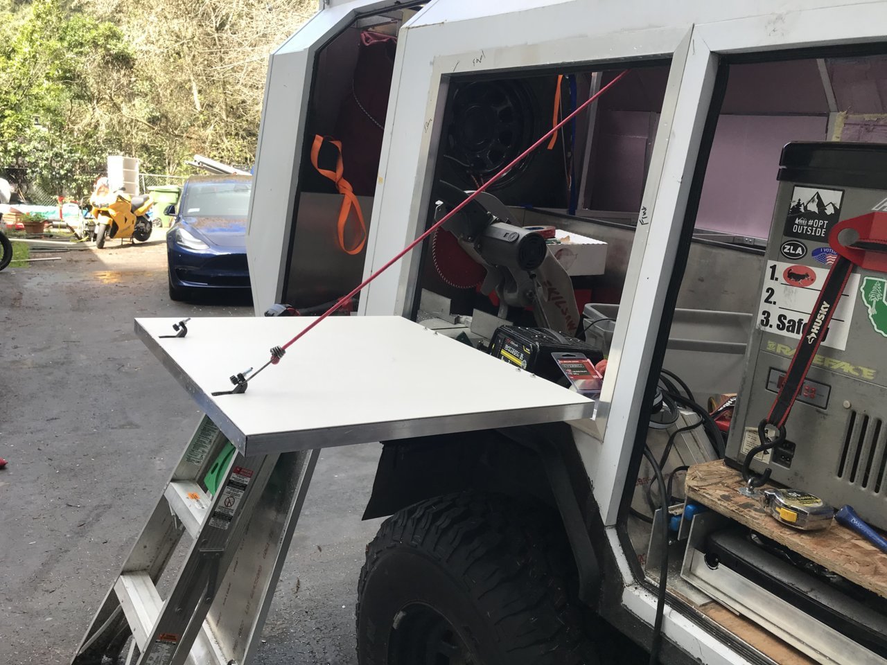

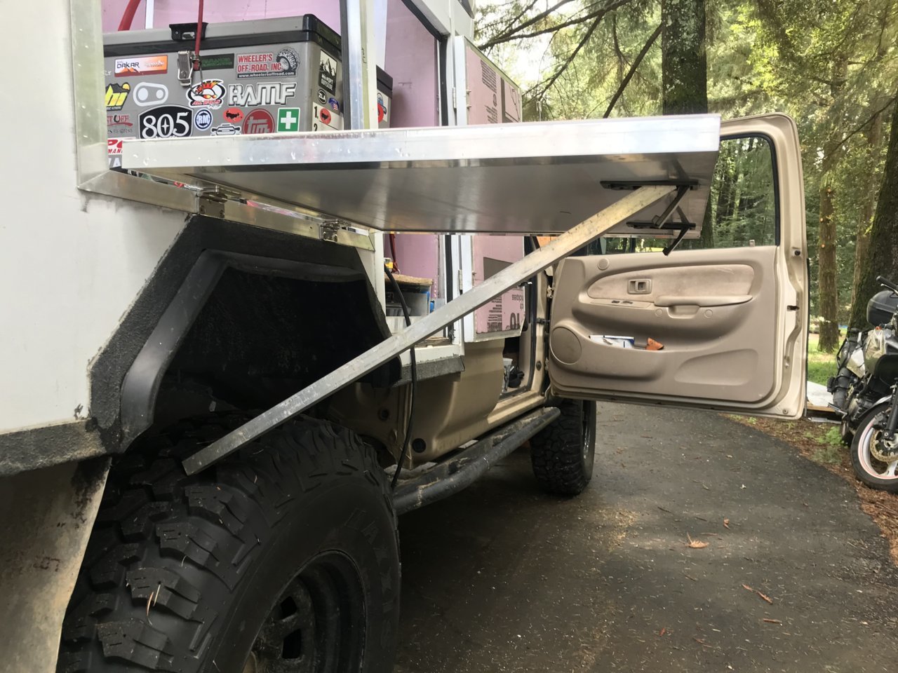

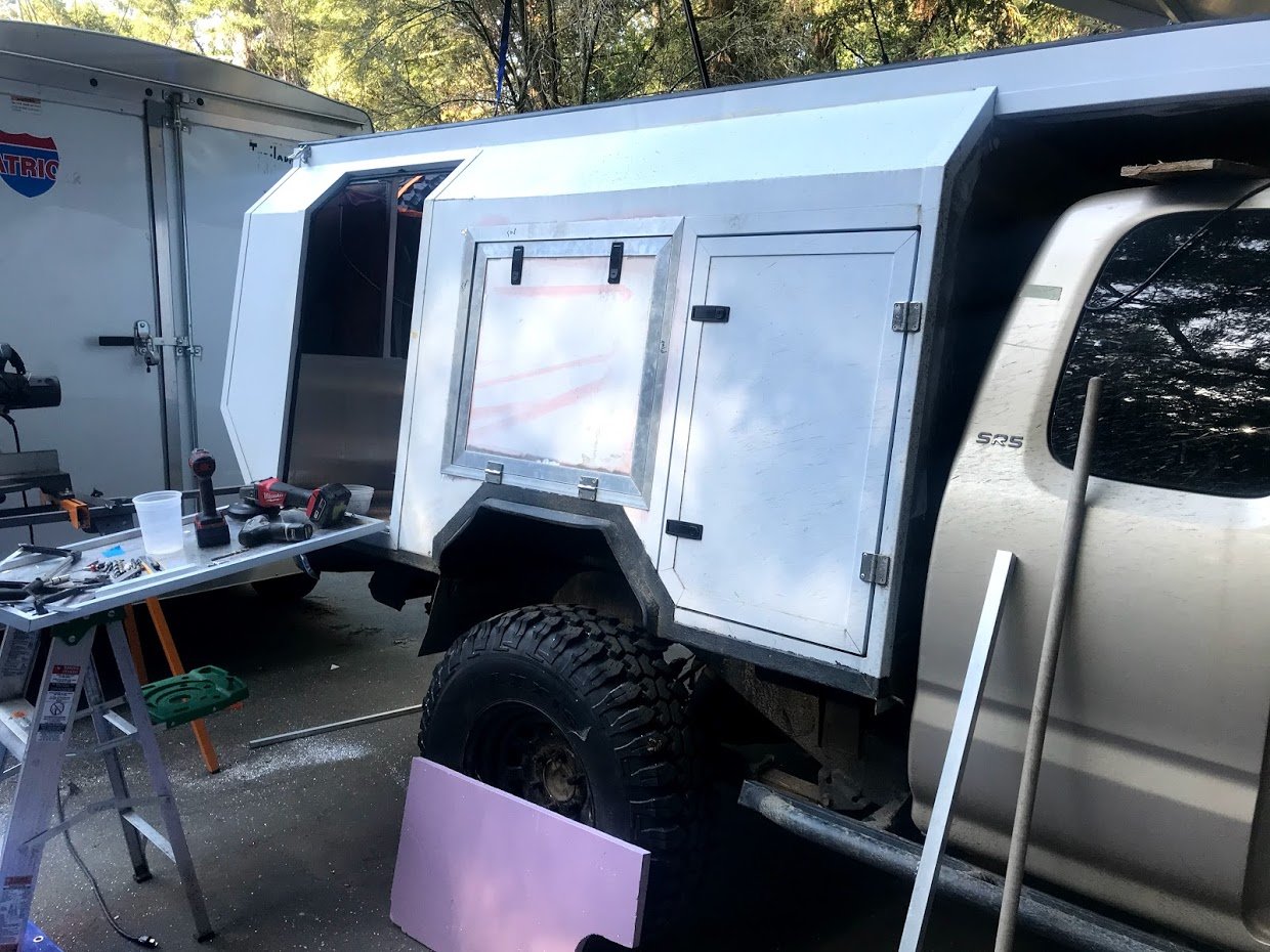

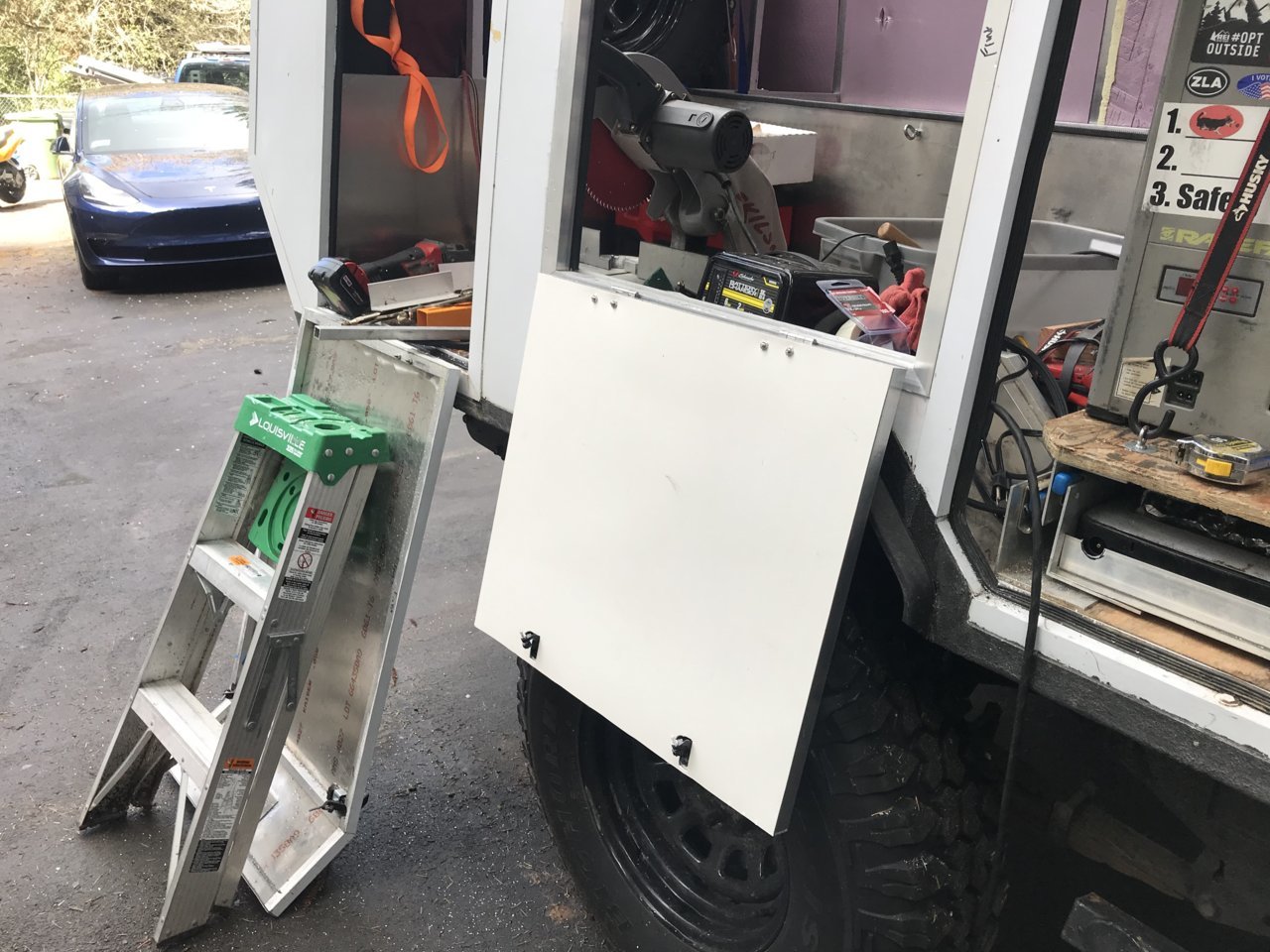

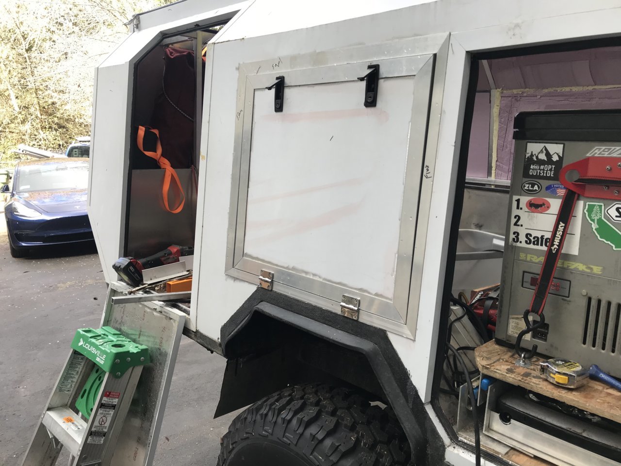

    I added the third passenger side door last weekend. It'll function as a work surface as well as a door.
    I covered the work surface side with plastic wall covering stuff.

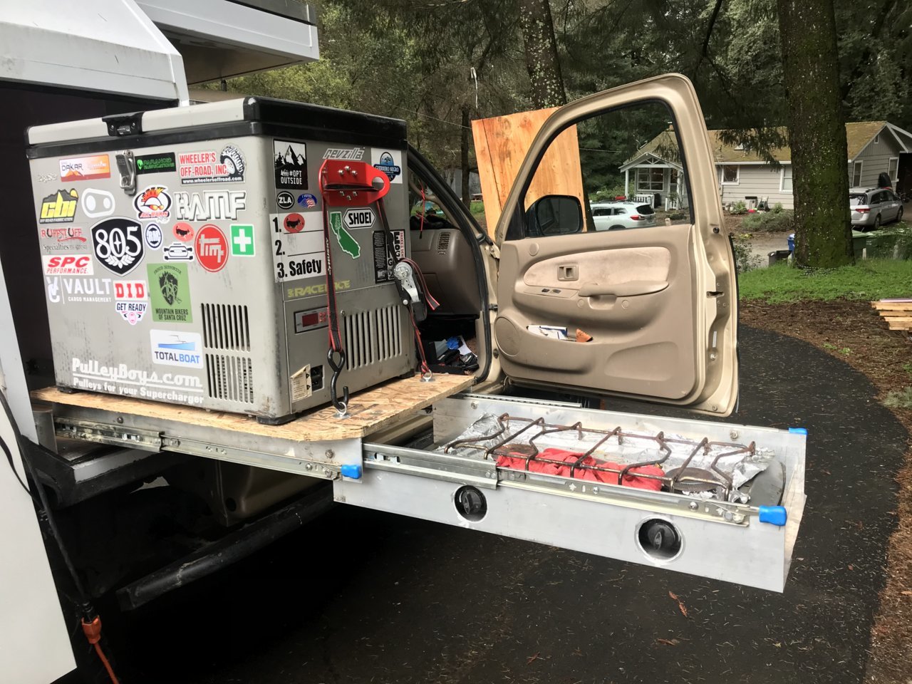

    Fixed the stove slide. It was locked closed and wouldn’t open.
    I removed the lid to the stove. It wouldn’t open before.
    I drilled holes for the stove valves.
    it’s a little janky looking. Some day I’ll replace the OSB with something nice and paint it.

    This door-
    Folds down
    and is meant to used as a work surface when it’s horizontal. I’ve played around with rope and bungies but they don’t work all that well.
    A simple leg works pretty well. You can adjust it by moving from one tire lug to another. Another upside to mud terrain tires.
