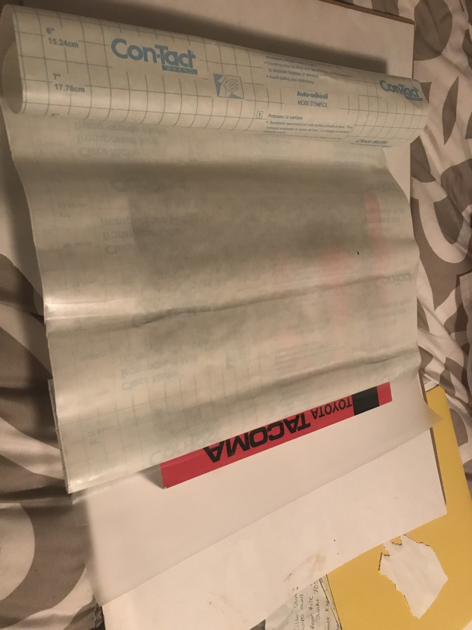

    Covered my factory service manual with contact paper.

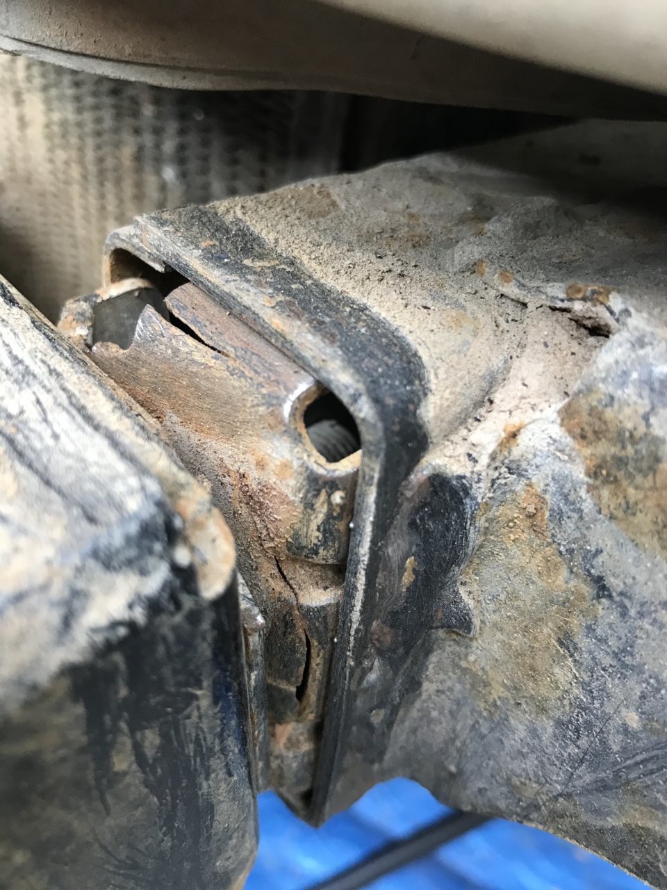

    Rebuilding my frame ends where the bumper mounts to the truck has been in the queue for awhile.
    I might have to move it up the list.

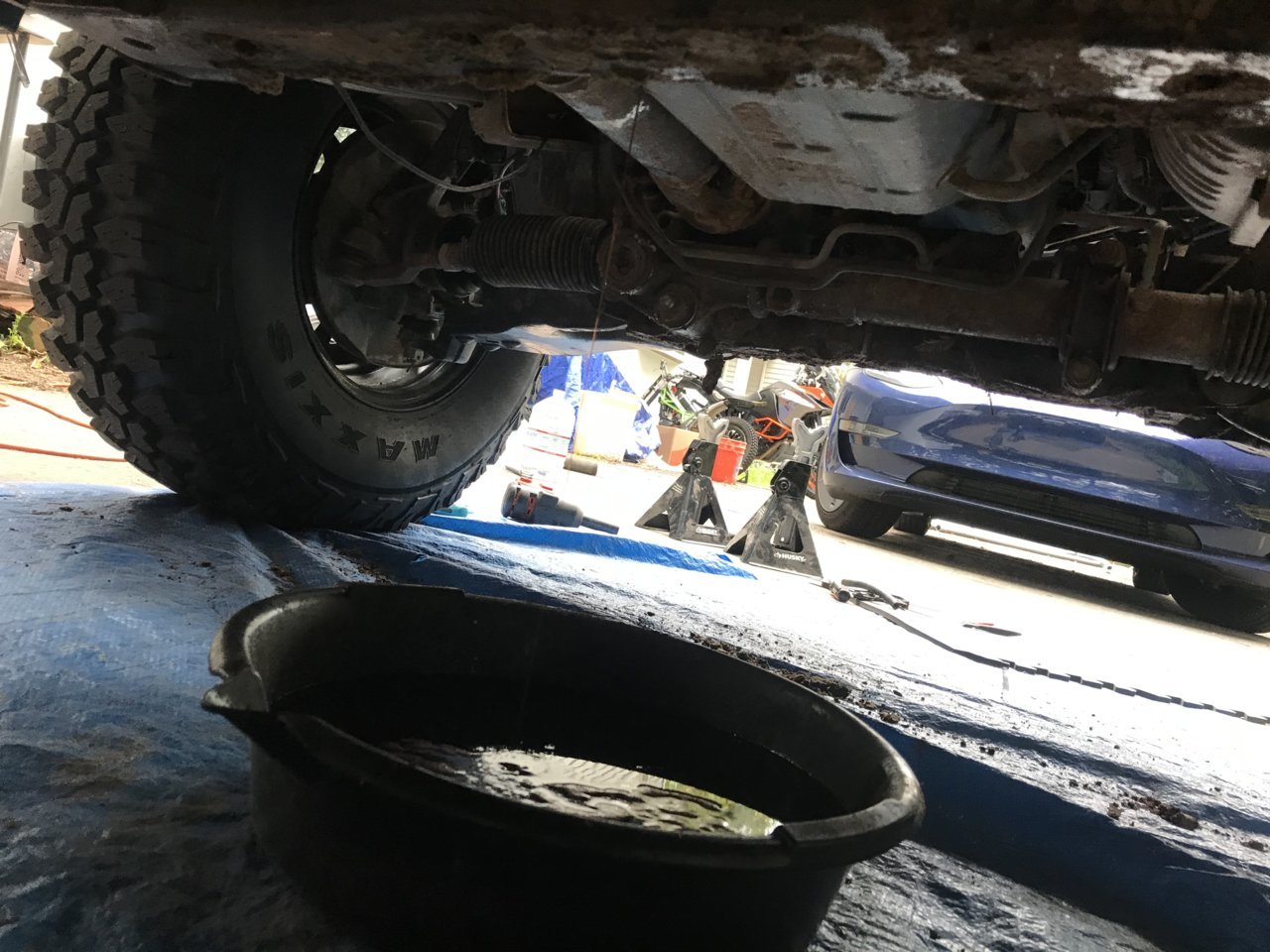

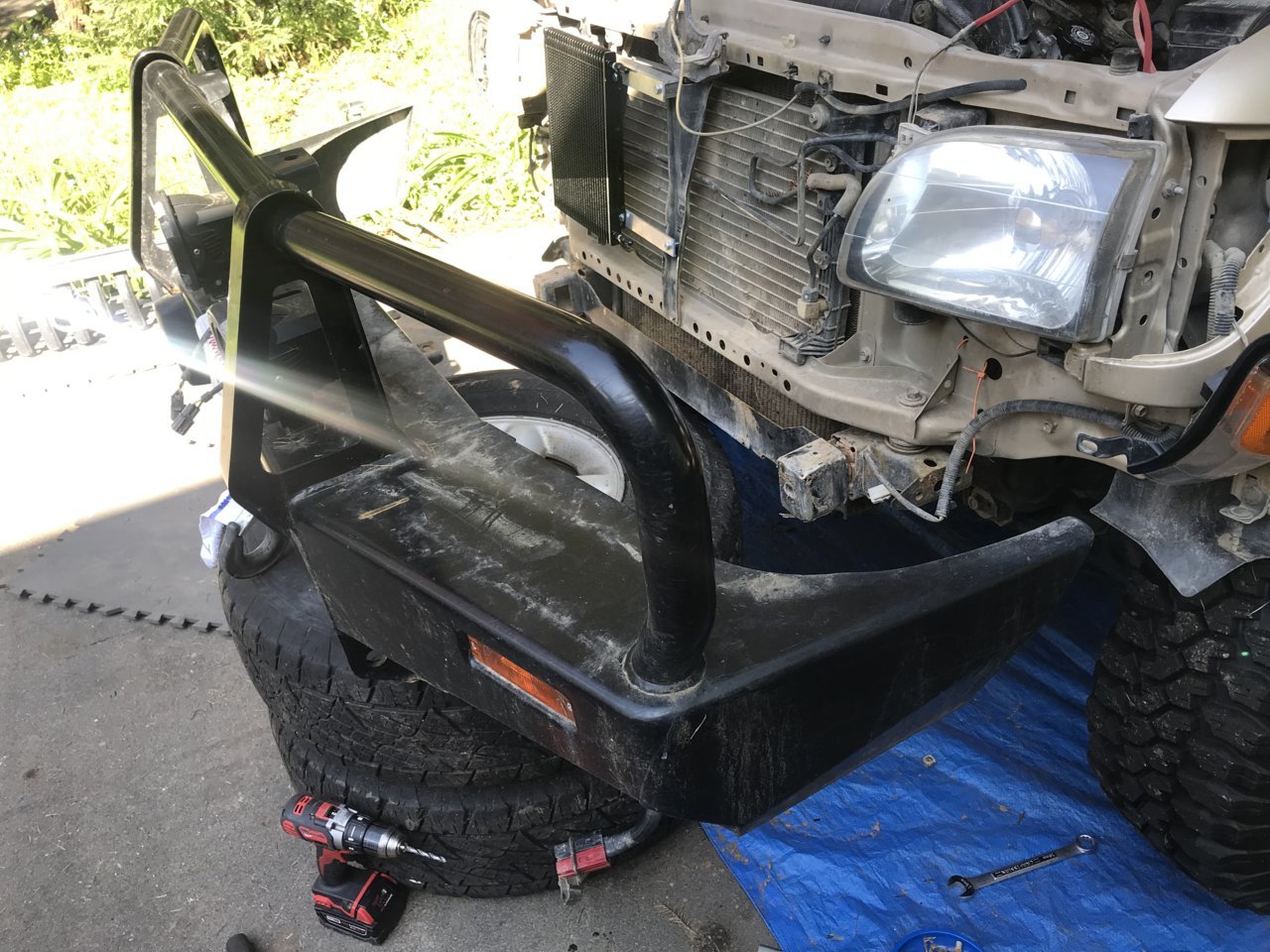

    I finished mounting and installing the transmission cooler. I bought this thing about a year ago. I made a last minute change to where the brackets attach to the truck so it’s a little crooked but that doesn’t really matter.
    Another benefit to having extra wheels and tires. I didn’t have to put the bumper on the ground. I just slid it onto the tires and moved the truck back a little.
    Also did a drain and fill on the transmission fluid. No more 12,000 miles trans fluid changes wit the cooler.
    The fluid I drained was thick and black after 12k miles from running hot.

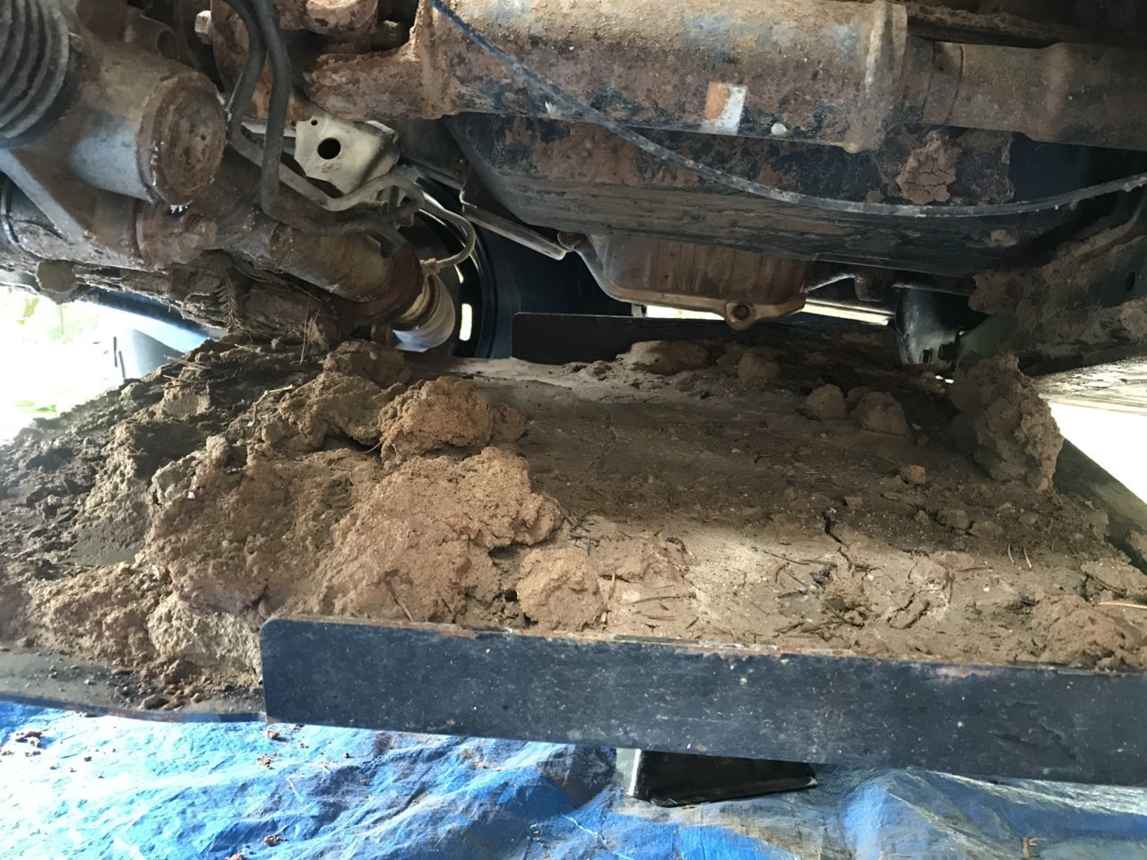

    Almost forgot about the mud. Back in November when I went to Baja. It got a little muddy.
    The middle skid had 35 pounds of dried mud. Between all three skids I was able to fill a small hole in the yard.

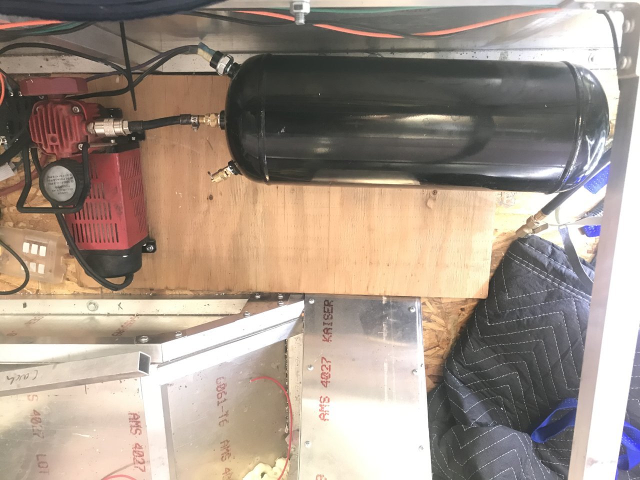

    Started the on board air project yesterday. I used the existing wiring, fuse, relay and switch for the fridge. I had over sized wiring for the fridge due to the length of the run and voltage drop. The compressor is much closer to where the fridge used to be.
    I just need to get a new switch cover.

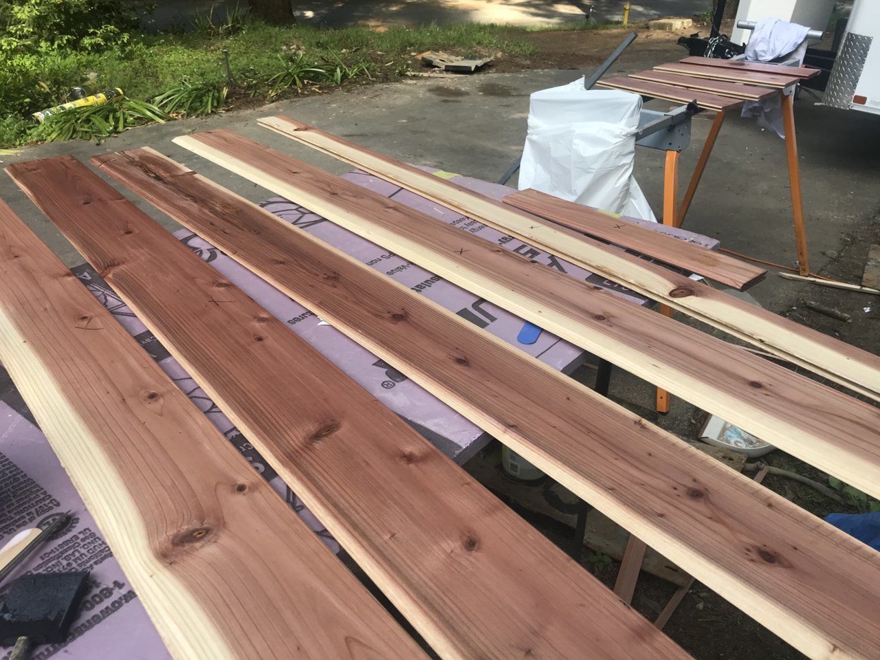

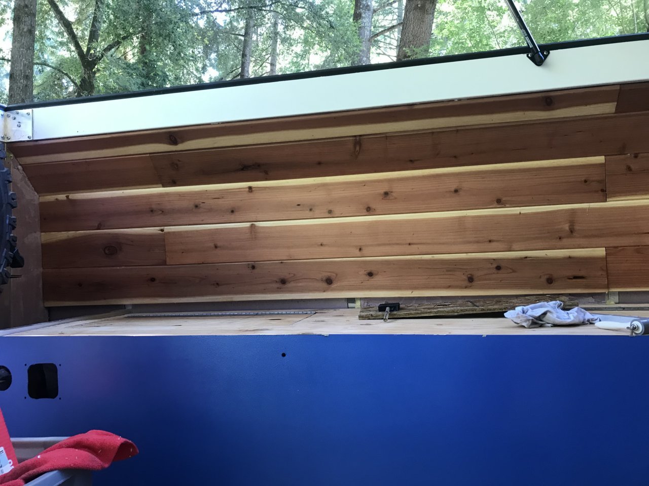

    Did some things to the interior.
    I got some redwood panels. I sanded them to 320 grit on the front.
    I did not sand the back.
    I applied 2 coats of water based satin polyurethane to the back.
    While that was drying I painted some stuff. This wasn’t the color I picked. There was some kind of mistake. This is called Mega Blue. They weren’t messing around. It’s really blue. It’s grown on me.
    Next I attached the redwood with the same double sided tape most the camper is built with and loctite PL300 where the wood needed to be attached to foam.
    I also painted some things white. Like that 4” piece of tube at the top.

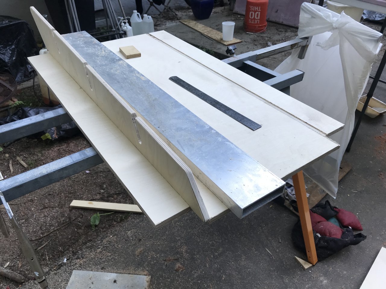

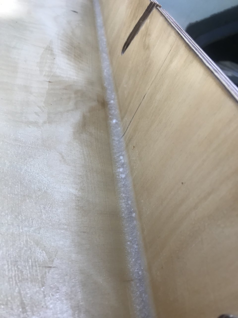

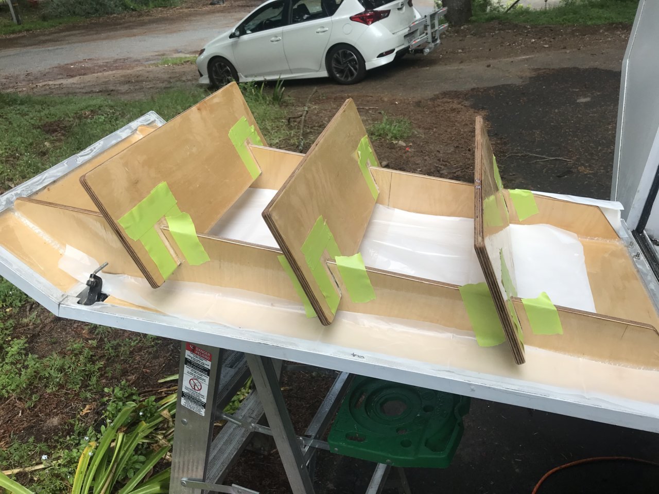

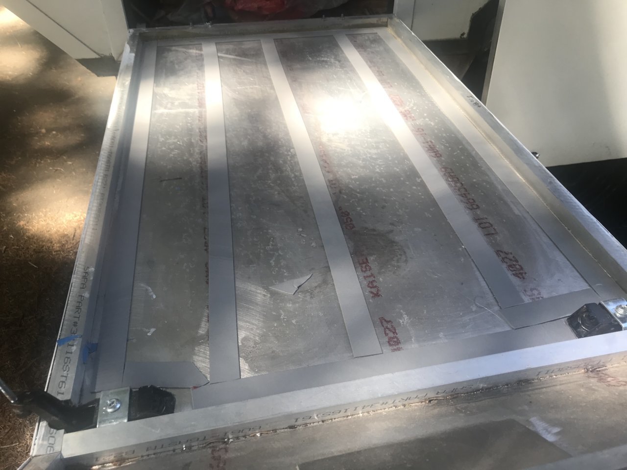

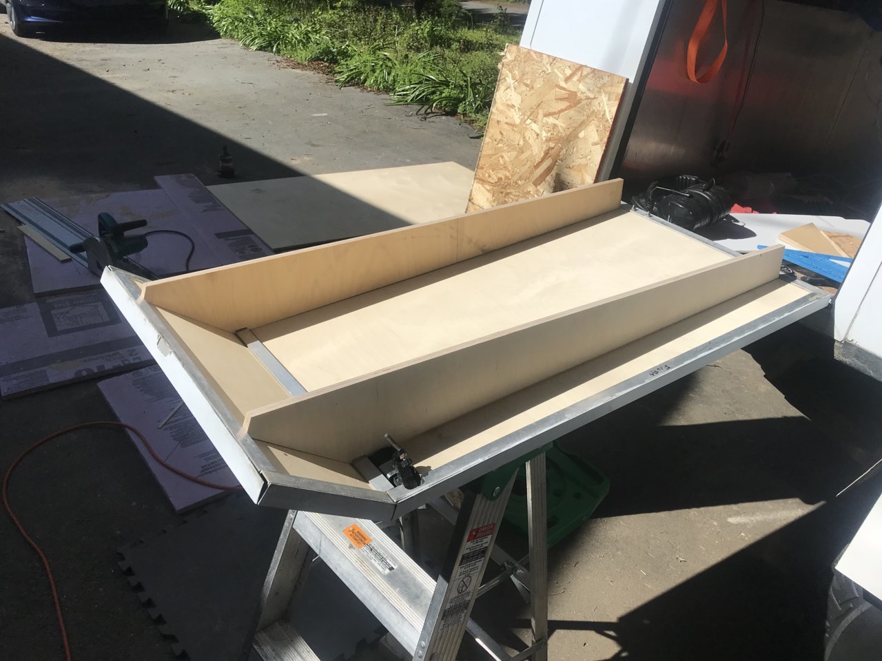

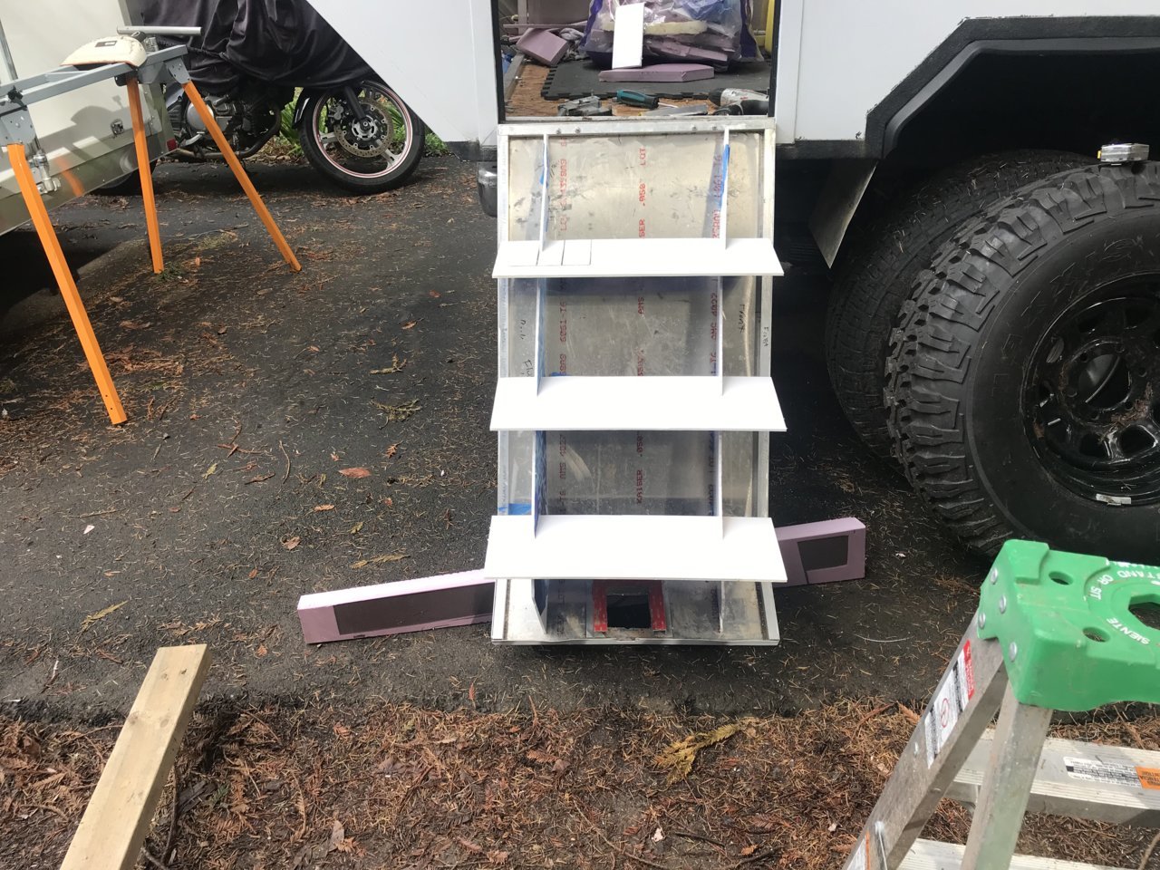

    Ive been working on a few things at once on the camper so I decided to hold off posting until I have something competed.

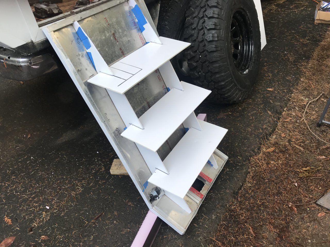

    Since I built the main the main entry door I’ve been using a small step ladder. It’s a pain in the ass and doesn’t work all that well.
    I built some stairs into the door.
    A while ago I made a mock up set of stairs out of foam core board.

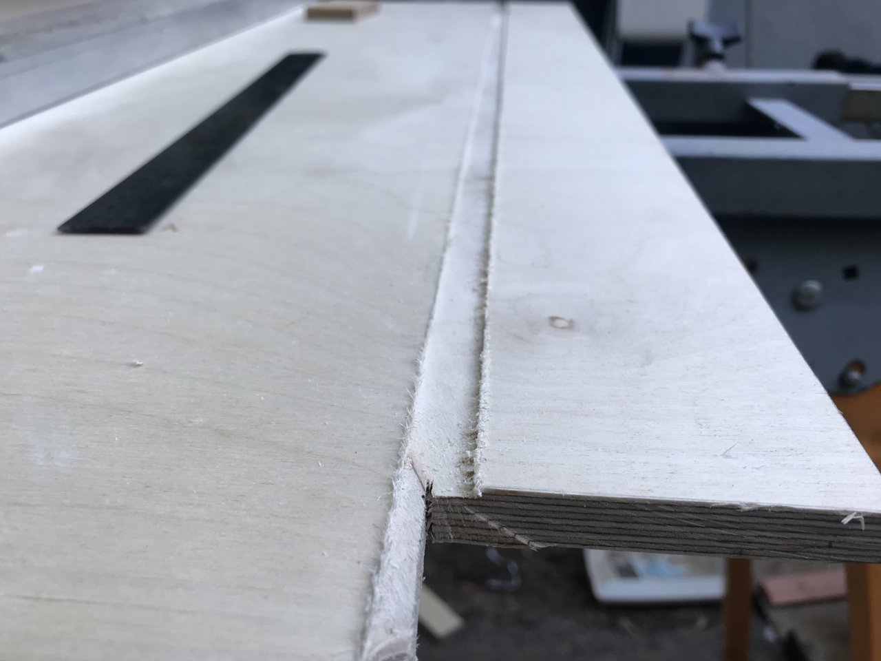

    I used the mock up foam core stairs to cut some pieces out of scrap OSB and used those as a pattern on some really nice plywood.

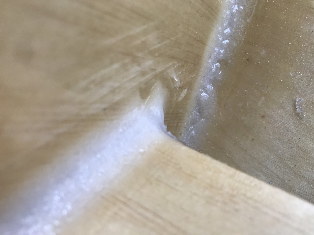

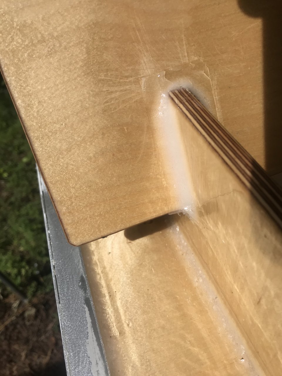

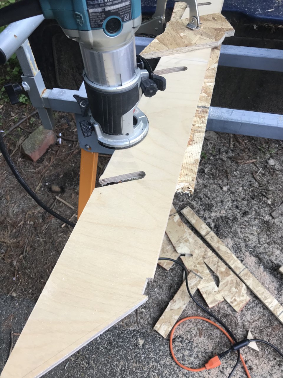

    I made the base for the vertical supports and cut some shallow dados into them with my router.
    I attached the main back piece with the the dados to the door with more 3M CV62F.
    I glued the vertical supports into the dados with loctite PL8X
    after the PL8X cured I added filets with epoxy thickened with System Three fumed silica. This stuff SUCKS! It’s super lumpy and makes a crappy filet. I got some Cab-O-Sil fumed silica later. Sooo much better! I’ll have some comparison pics later.
    I also added a sealer coat of thinned epoxy to the rest if the wood and sealed all the joints between wood and aluminum.
    One the thickened epoxy cured it was time to glue in the steps. Once the glue cured I masked off the steps where I’d add more epoxy filets.
    You can see the System three fumed silica thickened epoxy in the vertical supports compared to the Cab-O-Sil.
    I’d like to suspend the stairs with a 1/8” cable anchored to a step with swageless anchors.
    For now a foam block will do just fine.
    Here’s a video of the stairs in action. I’m pretty happy with them. I wish I’d made them earlier. The step ladder I had was going to try to kill me at some point. It was only a matter of time. The stairs are much better.

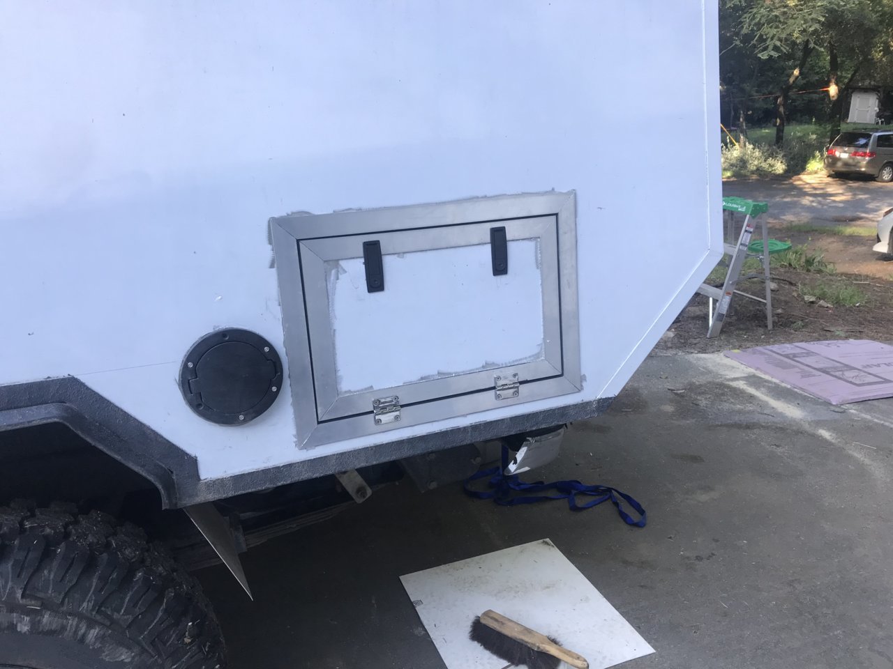

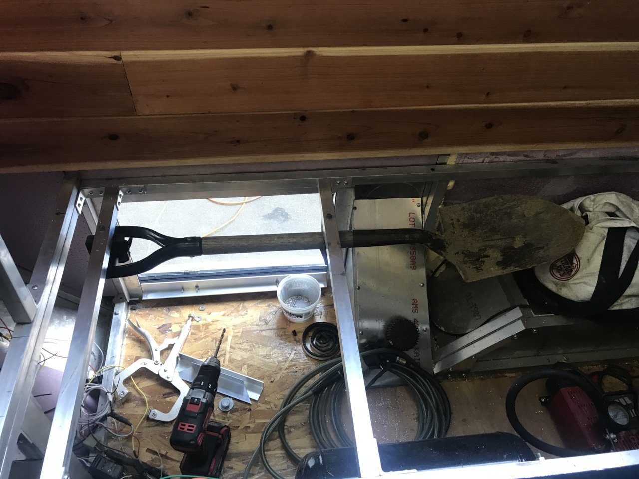

    I got the last door about 80% finished.
    It feels good to have the last door mostly done.
    I’m going to use the space under the couch and this access door to store recovery gear, my ax, shovel and access to the on board air system I built.
    The ax and shovel are gonna have quick fists to secure them to the top or below the couch. I had a pair of quick fists on hand for the shovel.
    view of the shovel from inside the camper with the couch cushion and plywood removed.
