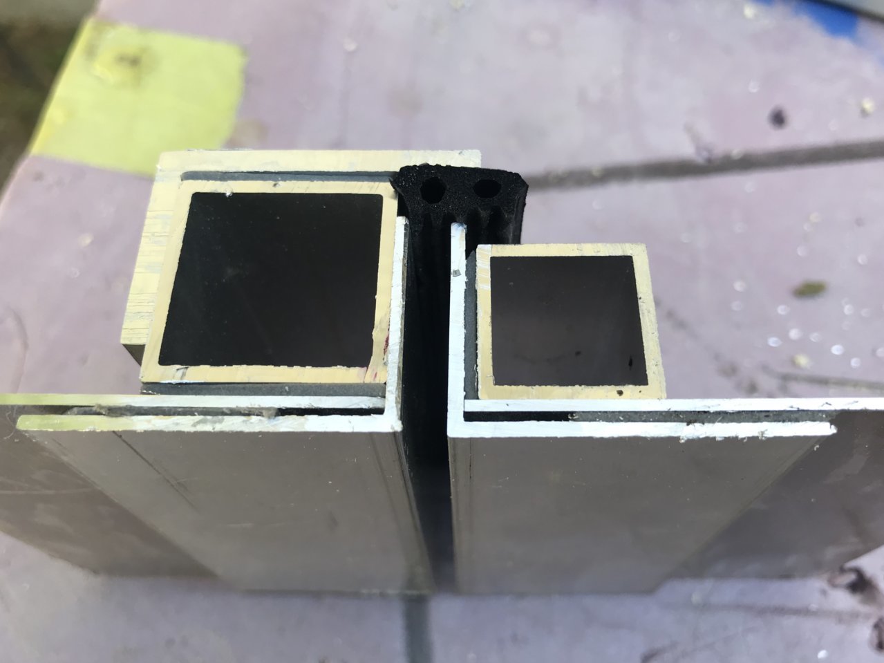

    Did you use z bar for your door jambs? I need to build a few hatches in my fwc and have been thinking it out. Z bar and then U channel with ply skinned in sheetmetal with a automotive stylebulb seal. But I am not sure if that will be enough to stop rain while driving.

    No I didn’t but I did look into z bar shaped profiles. As long as the dimensions add up that should work.
    I’ll make a cross section of a door jam and the door section today so you can see how they work and fit together.

    Look into h channel as well. Sometimes it’s called chair profile (I think)
    I didn’t use it because I couldn’t find it in dimensions that would work for me. It would have been way easier than what I ended up doing.

    Alrighty, I made a cross section.
    There is no interior skin in the cross section.
    Bottom of the pic is the outside, right is the inside.
    On the left is the door jam, on the right is the door frame.
    The outside has 1/16” x 1” x 1.5” aluminum angle. That’s adheres to the .050 aluminum skin with 3M CV43F double sided commercial vehicle tape. The little gap in the corner is usually filled with loctite PL8X polyurethane construction adhesive.
    Next in the door side (right) is 3/4” aluminum tube adhered to the skin with 3M CV62F tape, just like the other one but thicker.
    On the door jam side is 1”square tube followed by 1/8”x1”x1.5” aluminum angle...more CV62F.
    The weather stripping in the middle is marine grade self adhesive stuff I got at my local Ace hardware.

    Good ideas and thanks a ton for the pic. That should be significantly cheaper than using z bar. Depending on the hatch and where I decide to hinge it, I think on the upper frame I will try and use a T bar in place of the 1/16 angle to give a bit of a drip edge.
