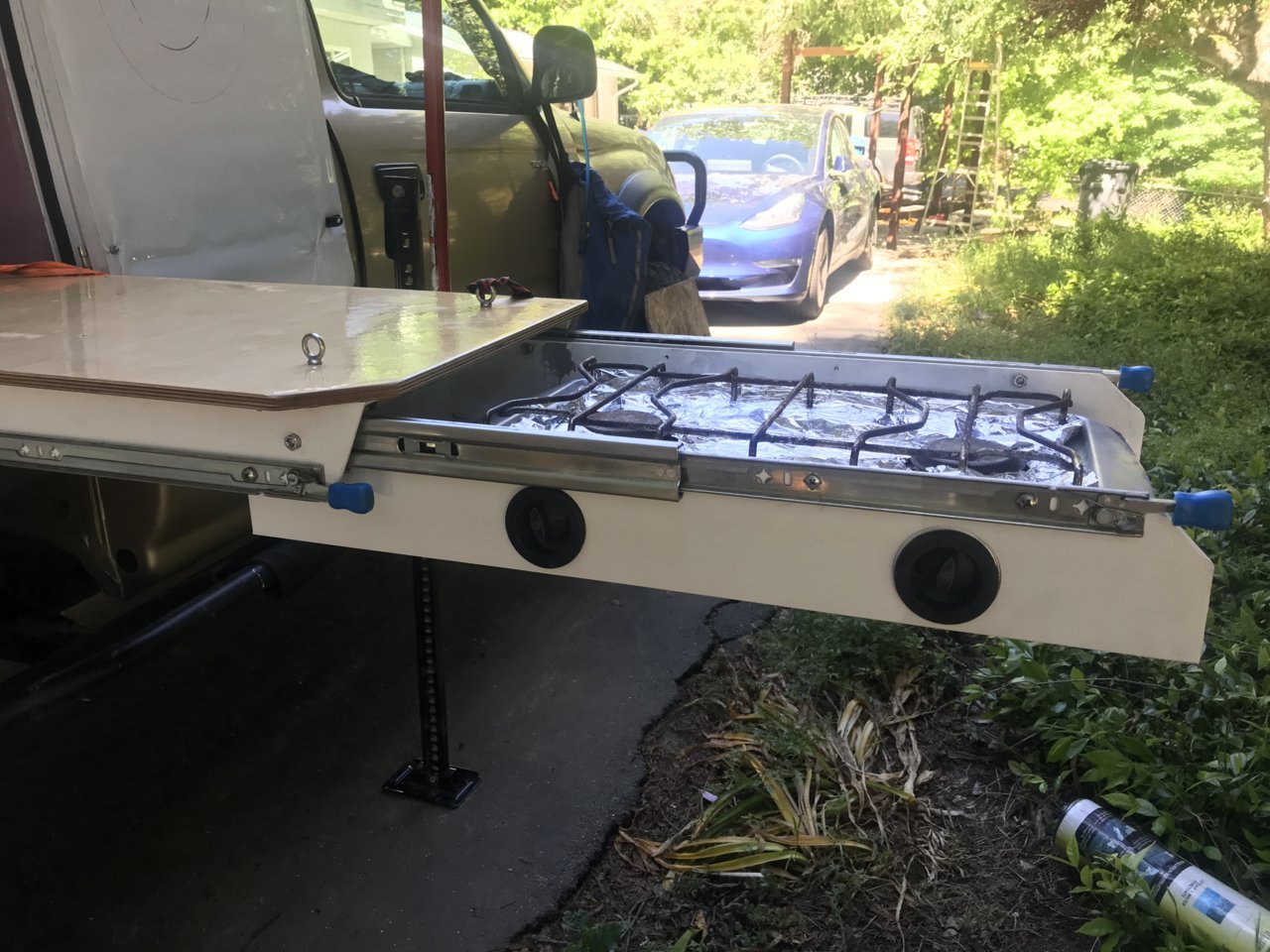

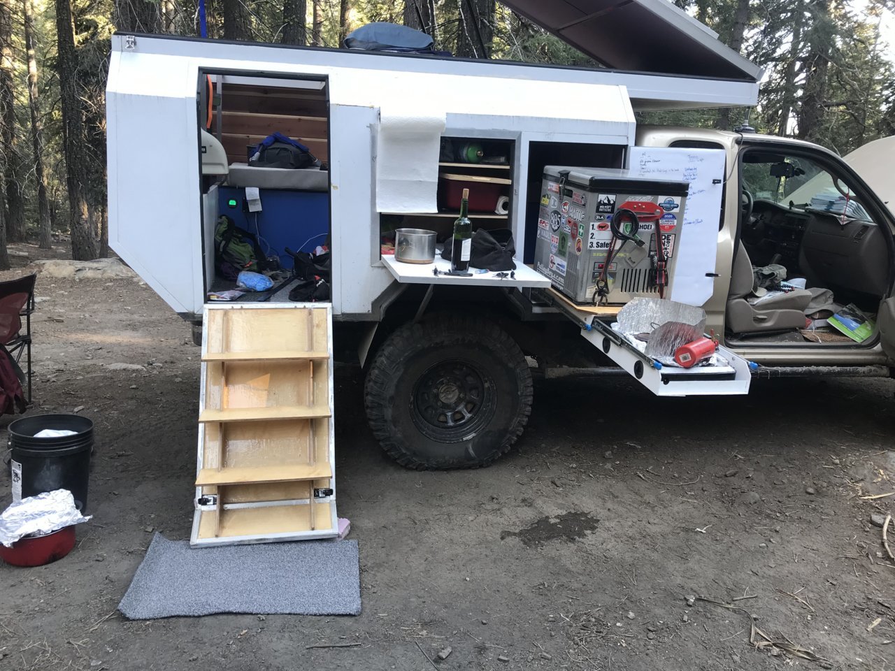

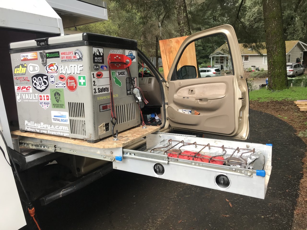

    Did a little work in the fridge/stove slide.
    I cut the angles where the slide releases are to make using them a little easier.
    Painted the aluminum angle.
    I replaced the OSB with Latvian birch plywood and covered the whole thing in epoxy.
    I made the plywood platform
    for the fridge long enough so it’s lodged between the door and the couch on the other side of the camper.
    It’s also long enough to fit a Dometic CFX65 now.
    Before:
    After:
    theed, realsystem, Chipskip and 4 others like this.

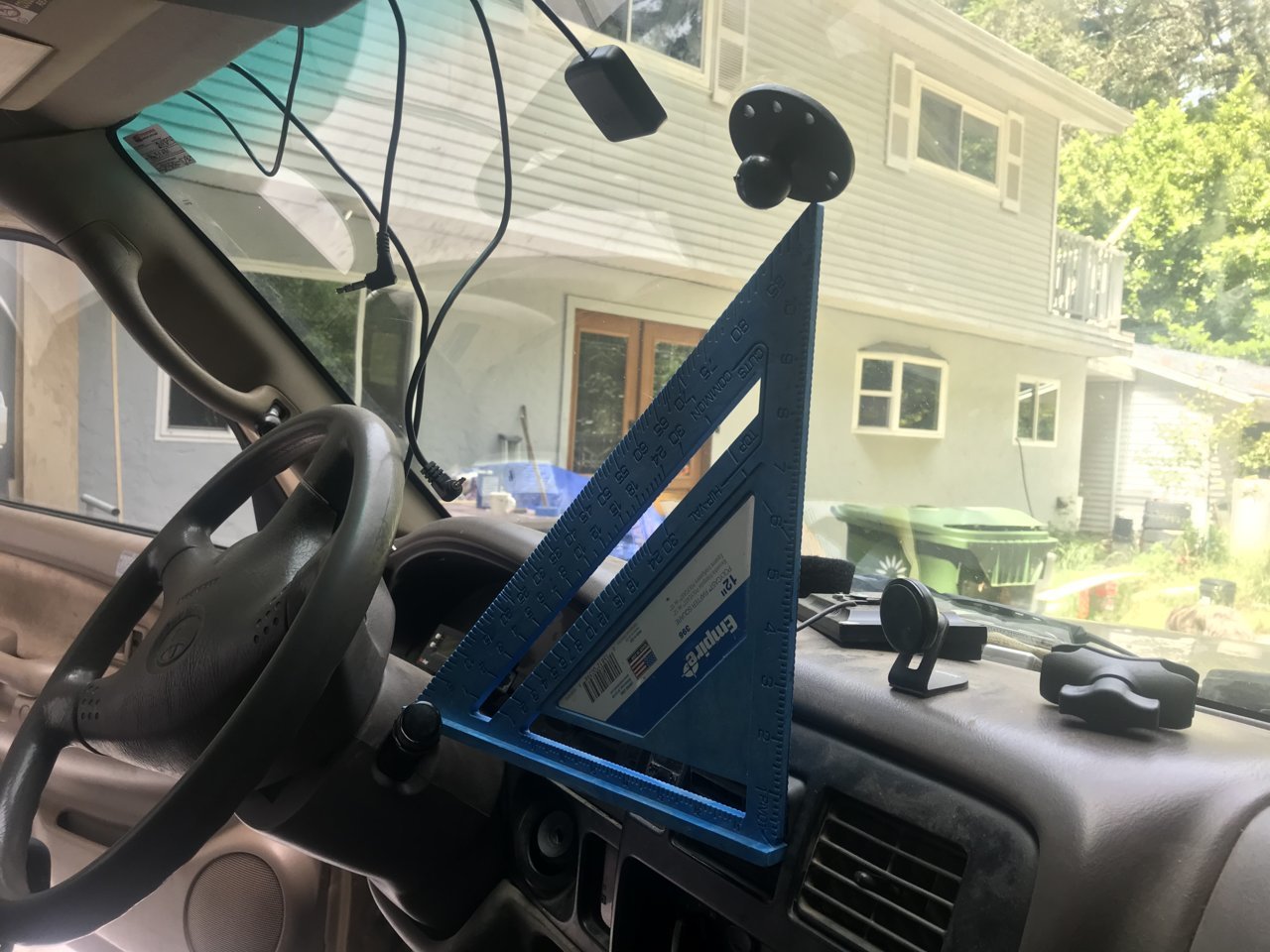

    The double sided tape holding my rear view mirror camera monitor thing failed to stick to the ram mount and fell off.
    I reattached it with some 5 minute epoxy. It kept slipping and seats were full of tools. I couldn't sit anywhere near the mount to hold it while the epoxy cured. It was getting harder and harder to keep in 1 place.
    This framing square worked pretty well to keep it in place.

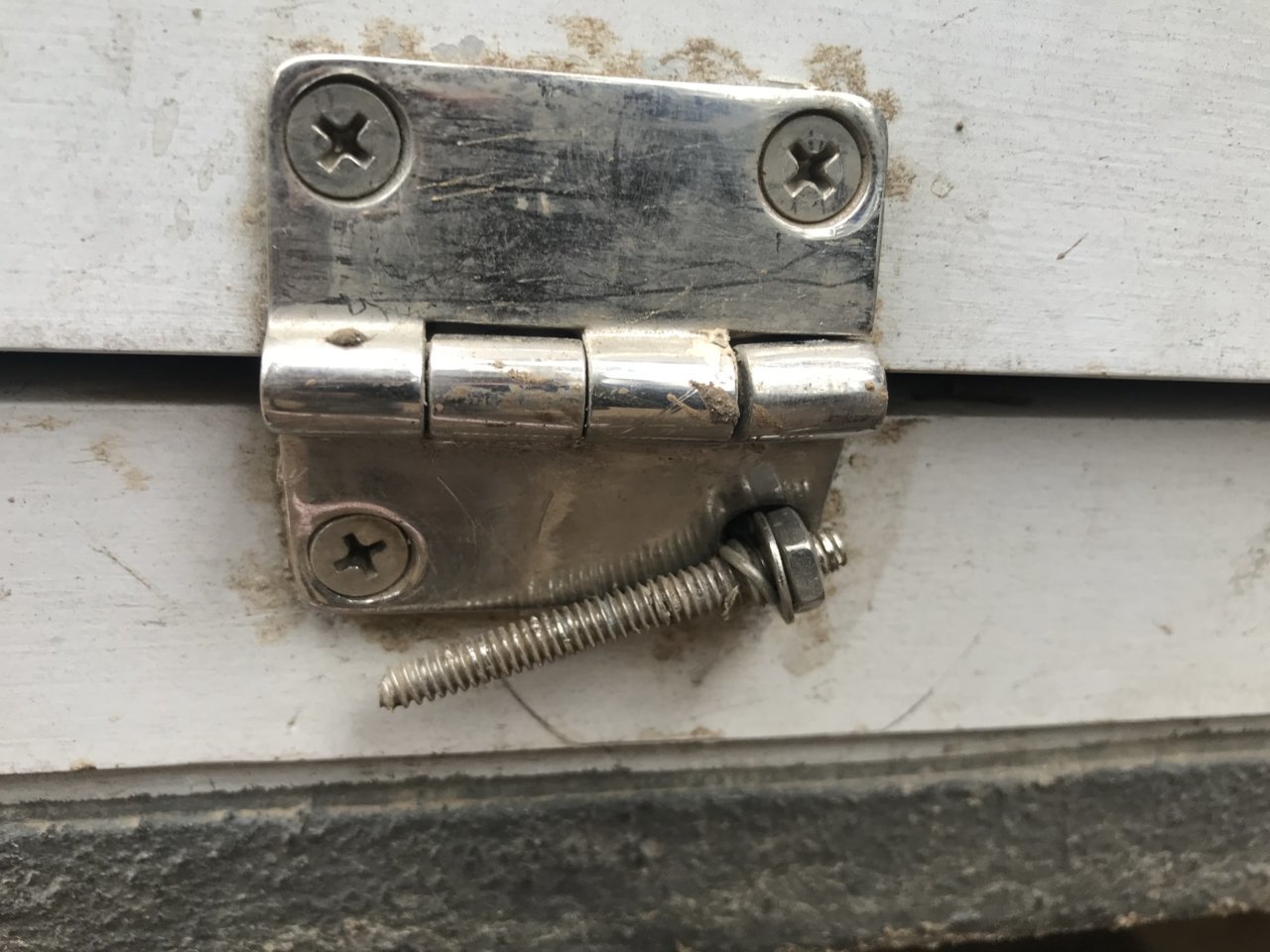

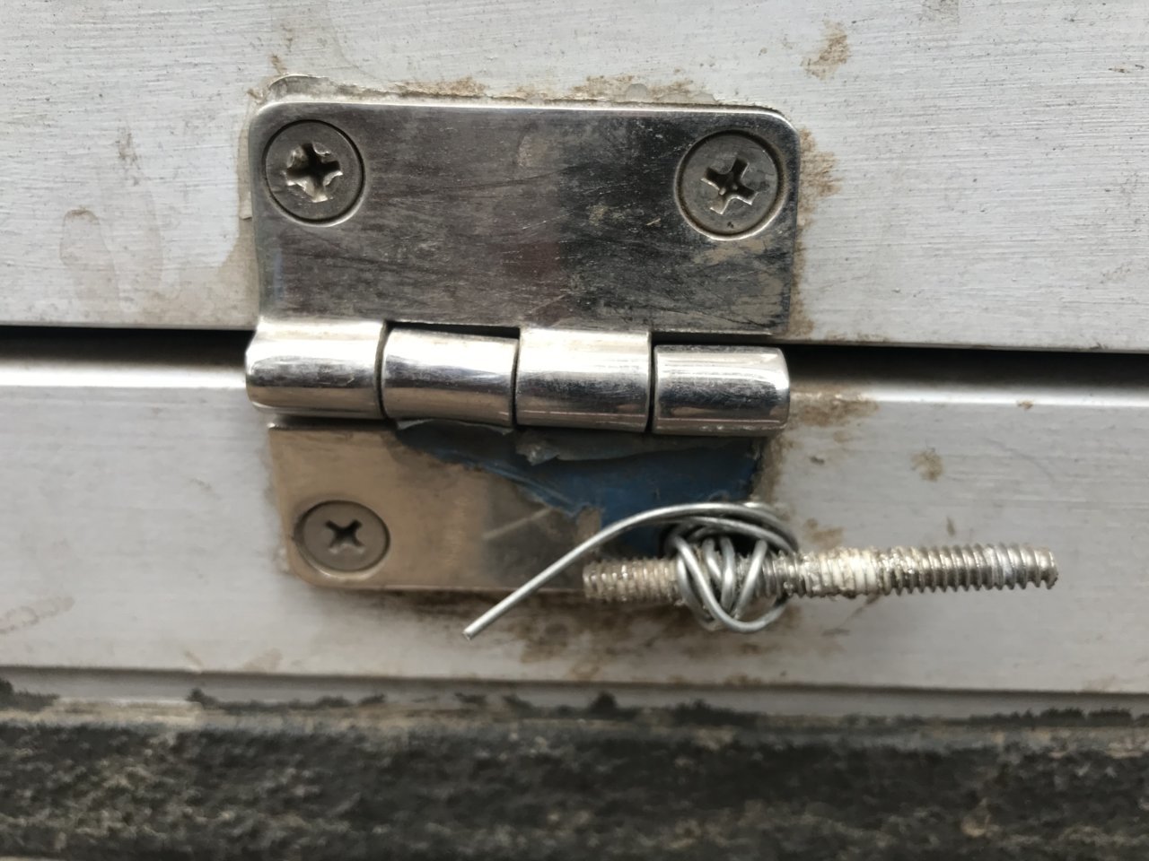

    The other day I was at a spot doing something with my truck.
    I had the main entry door open with it resting in the ground like this, but no mat and all other doors were closed.
    Got back in the truck and started driving away.
    I heard a loud snap sound.
    I never closed the door.
    It got half ripped off the camper.
    Luckily both #10 stainless screws on one side is of the hinge snapped.
    Both hinges are badly bent.
    No damage to the door or door frame though. Might have been overbuilt? It did carve a 4-5 inch furrow in the ground.
    So I stole a screw from the other hinge and used a bunch of bailing wire to put it back together.
    Ordered 3 new hinges (1 will be a spare)

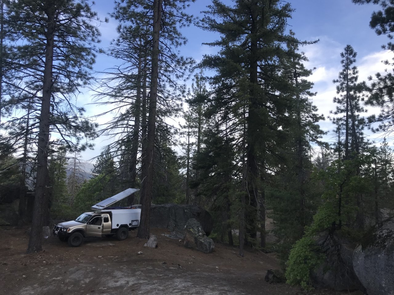

    I went out last week for some camping.
    Started out by going down near Big Sur area on Monday.

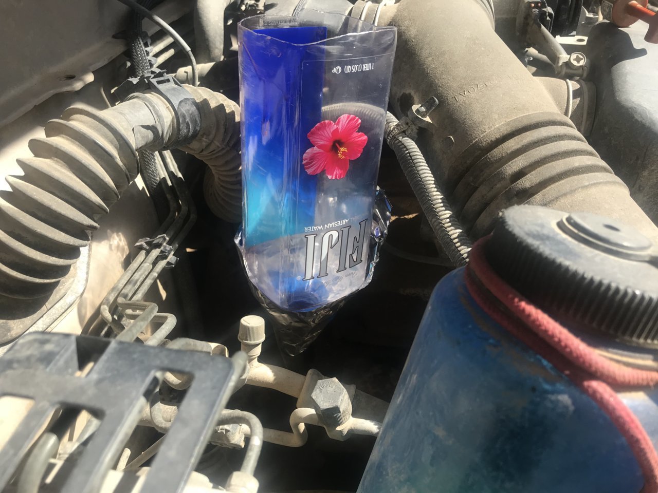

    On the way the transmission cooler I added 150 miles previously sprung a leak.
    I watched the temp go from 250>270>290>305 in a matter of seconds.
    I pulled over and put the hoses back to stock.
    Luckily I’d just met up with @theed and family and they were able to go into town and get 6 quarts of transmission fluid. I had a little with me but not nearly enough. Rigged up a funnel and added 3 quarts.

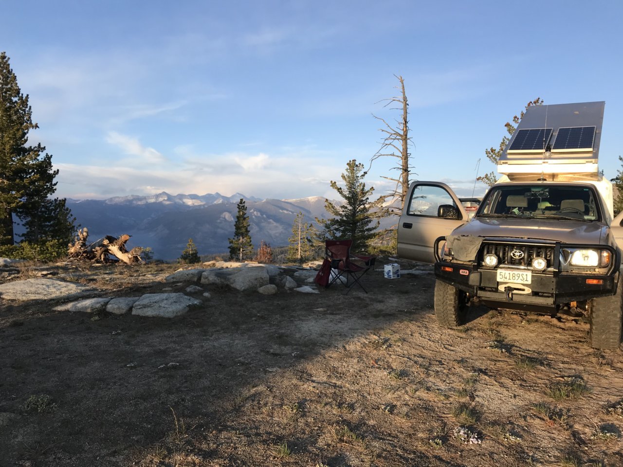

    After Big Sur I headed to Bald Mountain area. I kept adding transmission fluid a half quart at a time along the way. In the end it needed 5 quarts. The whole bottom of my truck is coated in transmission fluid.
    First night near Bald Mountain.
    I’ve had a few friends move away that gave me their white gas they couldn’t take with them so I converted my propane Coleman to white gas.
    Wednesday I drove up 168 to a nice spot with an amazing view of the Kaiser Ridge to the north and Lake Thomas A Edison, Silver Divide and a bunch of 13,000 foot peaks. I’ve gone back packing over there. It was cool seeing from this vantage.
    I hiked the upper 3 miles of the Dusy Ershim. It’s closed so no one was around. That trail is gnarly.
    Made a grilled cheese for dinner.
    After that I rolled over to the other side of 168. I moved about 8 downed trees off the road. The roads were standard uninteresting forest service roads. There were a couple nice views.
    Kaiser Ridge in the back ground.
    I headed back down to Bald Mountain and camped for a few days, met up withTHEED again and headed back Sunday.
    SwagThor, realsystem, theed and 2 others like this.
