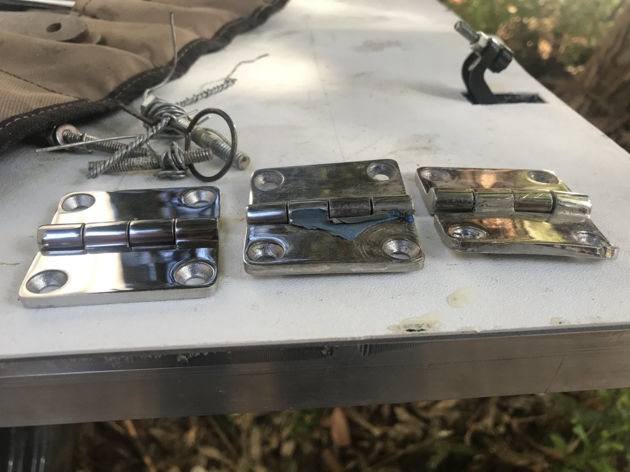

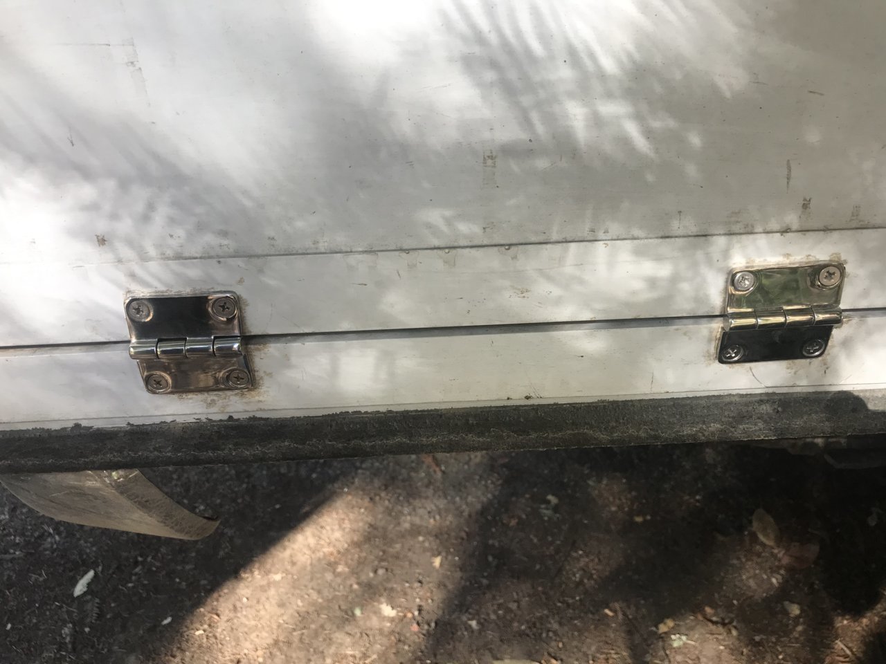

    Today I replaced the hinges that got all bent when I tried driving away with the door open.
    The new hinge is the left. The other two are badly bent.
    The small pile of junk on the upper left is the remains of what I used to hold the door on when the original screws snapped.

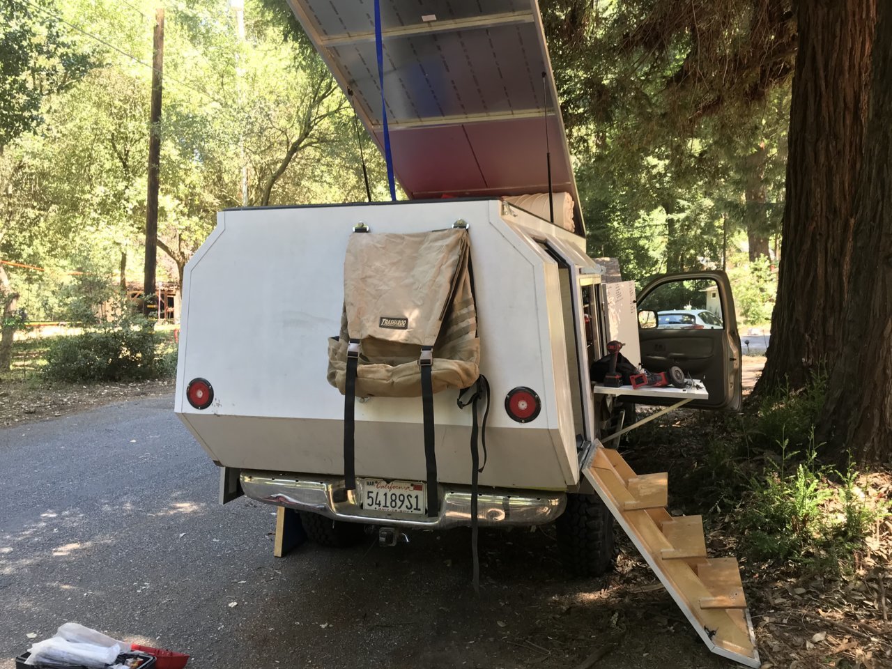

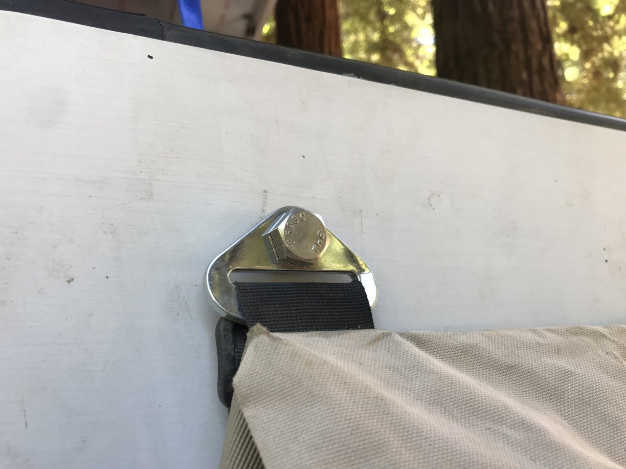

    When I went out for a week about a month ago not having a place to keep trash and a good water system was a drag.
    I have a trasharoo but no spare tire on the outside to mount it too.
    I’ve been contemplating how to mount my trasharoo for about 8 months now.
    I was going to double side tape 2” sections of aluminum hat channel to the back and run the straps through the channel. Hat channel looks like this:
    I couldn’t find it in usable dimensions anywhere.
    One day it occurred to me that the trasharoo’s straps resemble seatbelt webbing.
    Problem solved!
    I can use race harness tabs!
    I ordered some race harness tabs from summit racing. These:
    https://www.summitracing.com/parts/HSA-SRB241513NC
    I picked up some 1/2”x1.5” stainless bolts and nuts at ACE hardware and drilled some holes and ran the straps through the harness tabs.
    came out pretty good!

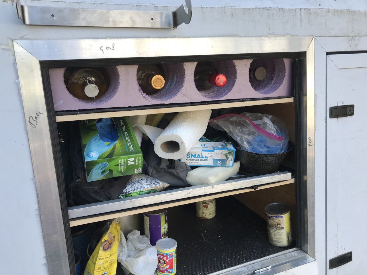

    Prototype for alcohol storage

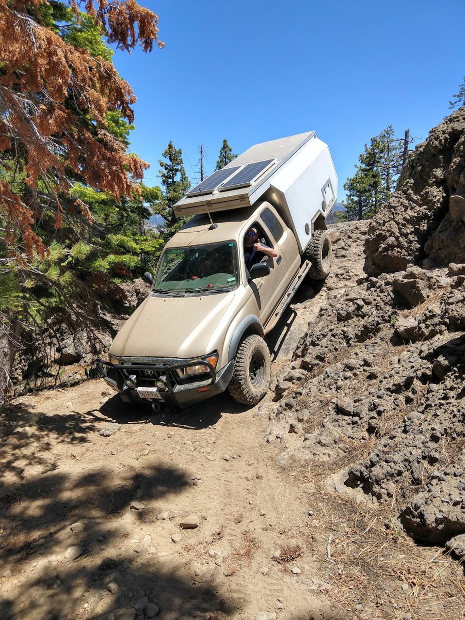

    Your approach angle checks out. (Departure angle needs a bit of help.)

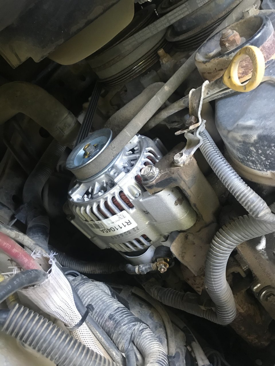

    I had some difficulties this weekend.
    Sunday as we were heading out from our campsite Bodonkadonk just shut off. Dead, no power to anything.
    Anything connected to the starter battery just turned off. Which aside from truck stuff is the Ham radio.
    It started right back up but would keep cutting out. Sometimes it would be a brief pause in power and then it would continue on.
    Around this time I noticed none of the guages, HVAC controls, turn signals, reverse light or cruise control would work.
    I also noticed the battery voltage was at 10.2. Normally when the truck is running it’s at 12.8 -14 volts. 10.2 isn’t right.
    I checked the fuses and the guage fuse was blown. So I put a new one in and jumped the truck off @theed truck.
    As I was backing up I looked down and the gauges weren’t working again...blew another fuse.
    That’s when I backed into a tree and put a very slight bend in the top of the camper.
    Later we determined the alternator had gone bad.
    While the truck can apparently run on as few as 7 volts the occasional shutting off was due to an intermittent battery connection issue.
    The battery would disconnect and the truck would shut off.
    I’ve never noticed it because normally the alternator powers everything.
    I picked up a new alternator at O’Rielly’s and installed it in about 30 minutes.
    Jumped the truck again and no issues for the next few hours in the drive home.
    I still need to sort out the battery connection issue and the guage fuse blowing. Once the new alternator was in it stopped blowing.
    It’s not the Kia alternator I wanted but it’ll do the job.
