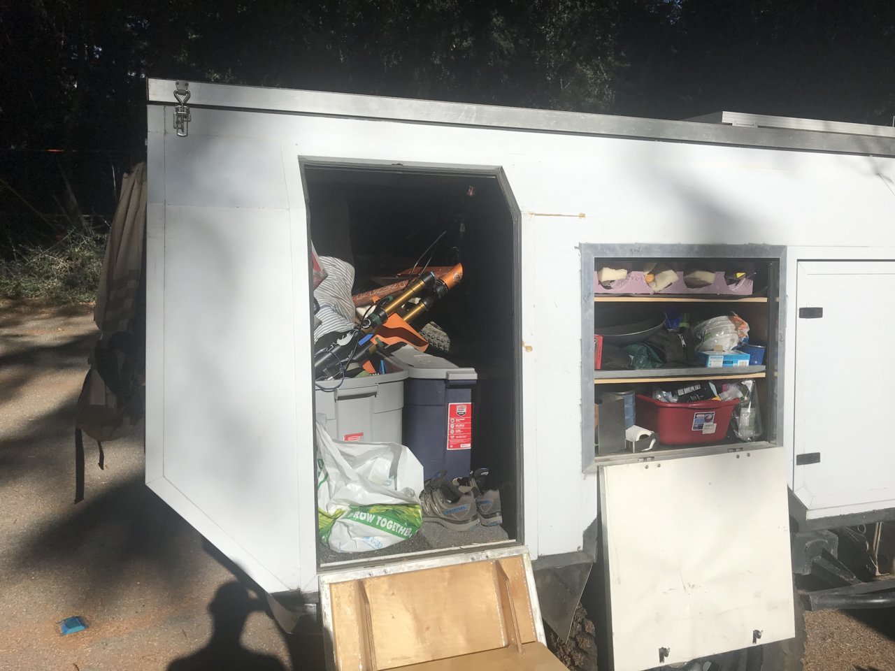

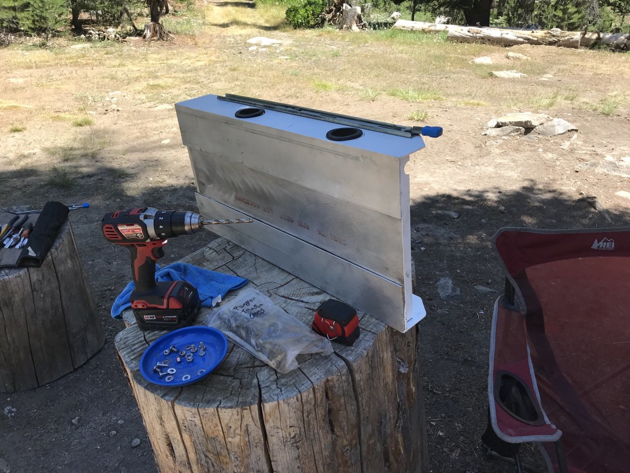

    I moved some bolt holes on the stove slide this trip. The hard part was not leaving any aluminum shavings behind.

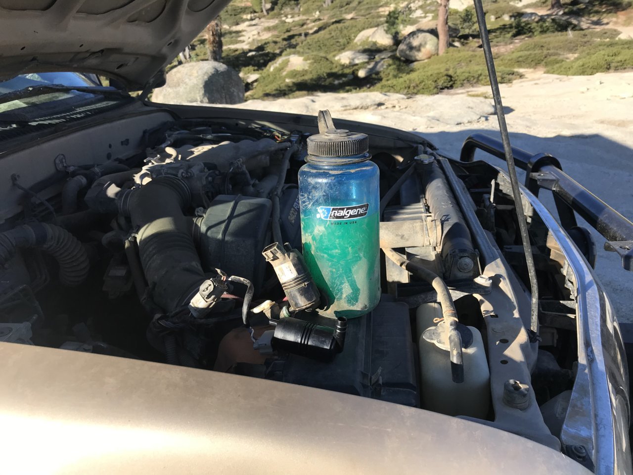

    I did this last Friday when I got to my campsite.
    I replaced the windshield washer fluid pump.
    The old one stopped working.
    I check to make sure it was getting power with my multi meter. It was getting power.
    I took the old pump off and hooked it up to the battery. It was dead.

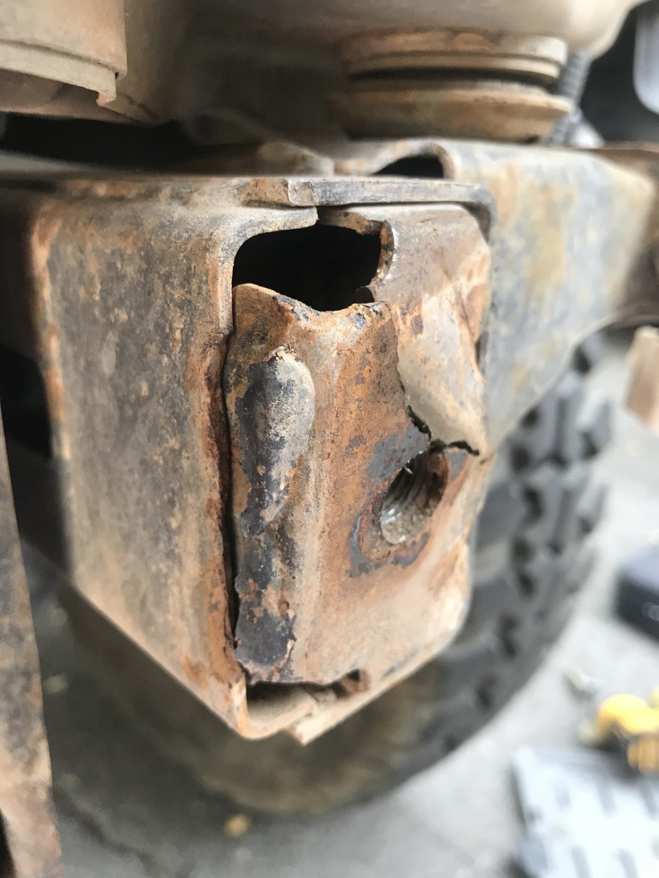

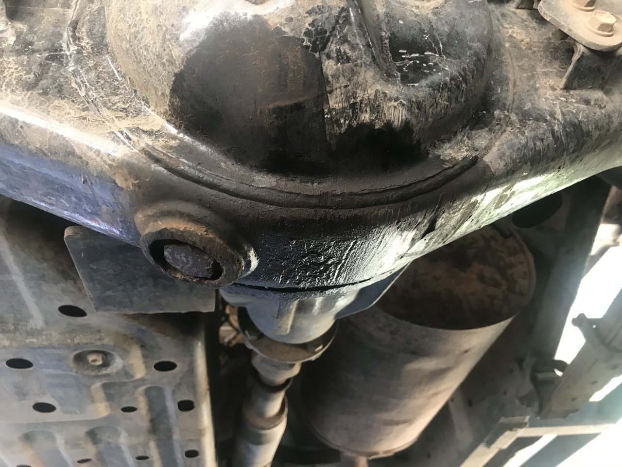

    The bracket that’s welded to the frame where the engine isolator mounts to is broken.
    The piece below came off with the 14mm bolt and nut. It looks like the other bolt and nut hole is the same. The passenger side looks fine.
    Anyone else have to fix this same thing? I’ve done zero looking into how to replace that part of the mount. I assume it would need to have another piece welded or a plate welded over the broken holes?
    Getting to that spot looks like a huge pain in the ass.

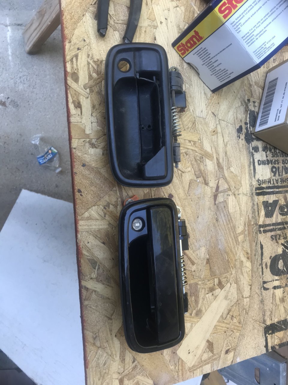

    Big big upgrade in passenger comfort today!
    A working door handle!

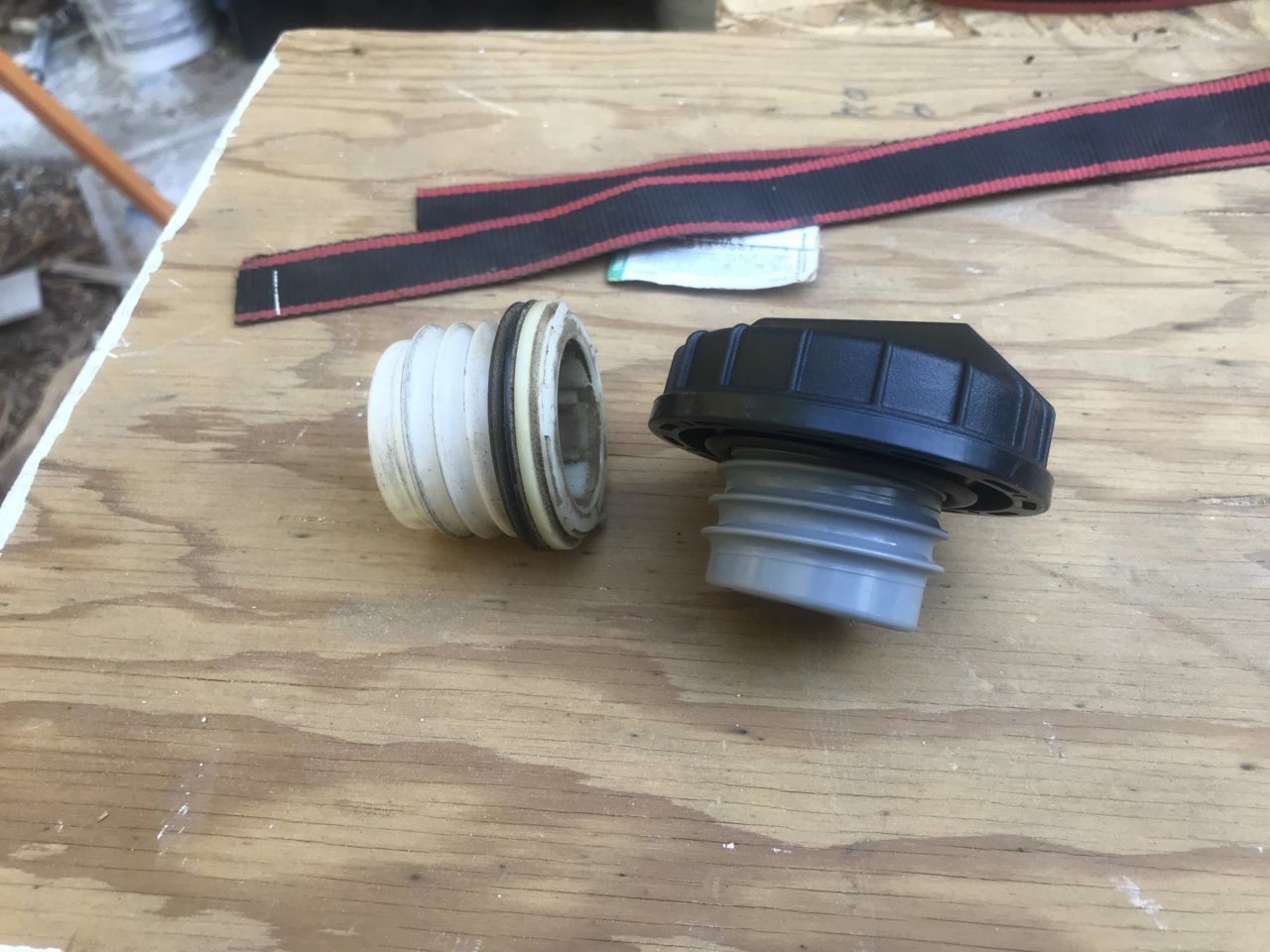

    New gas cap for the aux tank. I have no idea what happened to the old one.

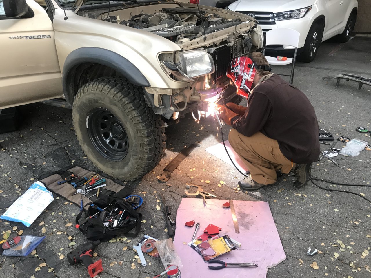

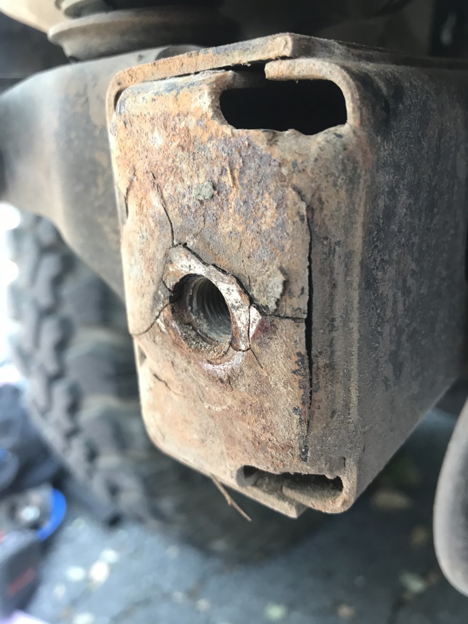

    I think these are broken.
    They’re fixed now with the help of @theed.
    I forgot to take a picture of them finished.

    This is on my list of “fixes before they break” big you winch while you were at slick rock?

    Man, that sucks. I have some 1/4” plate laying around, this winter I’m going to beef the frame horns up

    I welded those mid mounts up last time I had it off. My shielding tank was practically empty so the weld looked gross lol I got out and was so confused on why it welded so shitty. Then I seen the gauge lol

    I welded 1/4” plate in place of those a couple years ago. So far they’re holding up well.
