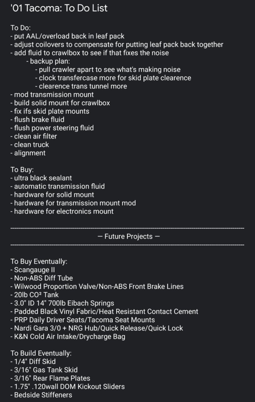

    In short, this is my to do list..

    That’s a good list.

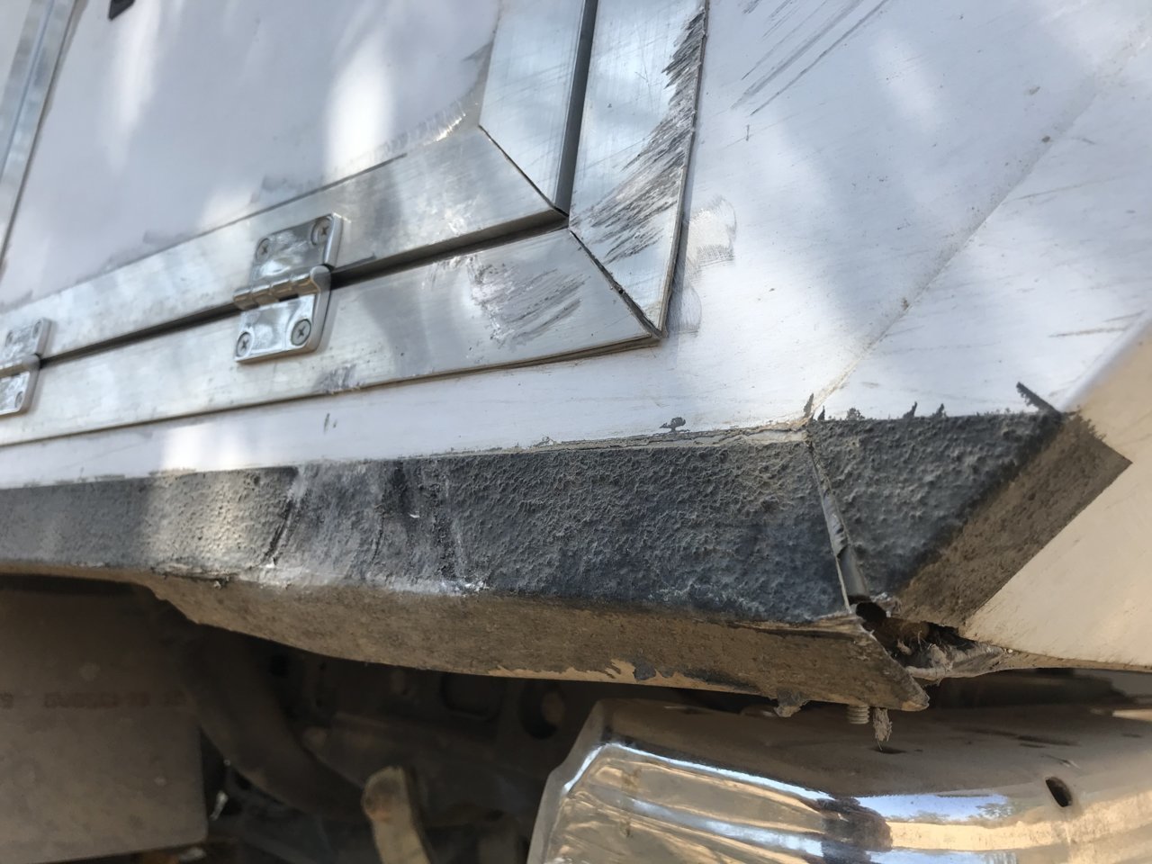

    I got attacked by a rock today.
    I won’t have to rebuild that corner but I think fixing and repainting the trim would take a full day.
    It looks worse than it is but needs maybe an hour to fix the seam in the back. It’s not waterproof as it is. Just needs some better adhesive. I used loctite PL8X. I should have used 3M marine 5200.
    The rest can wait. It’ll probably be a few years.

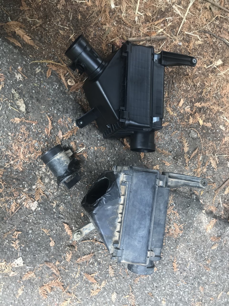

    Replaced the broken air box.
    The break is upstream from the air filter. I caught it early but am still going to do some 2,000 mile oil changes.
    The original survived to 248,000 miles but OEM is $490.
    So I bought an $89 knock off from eBay.
    Cleaned the MAF while in there.

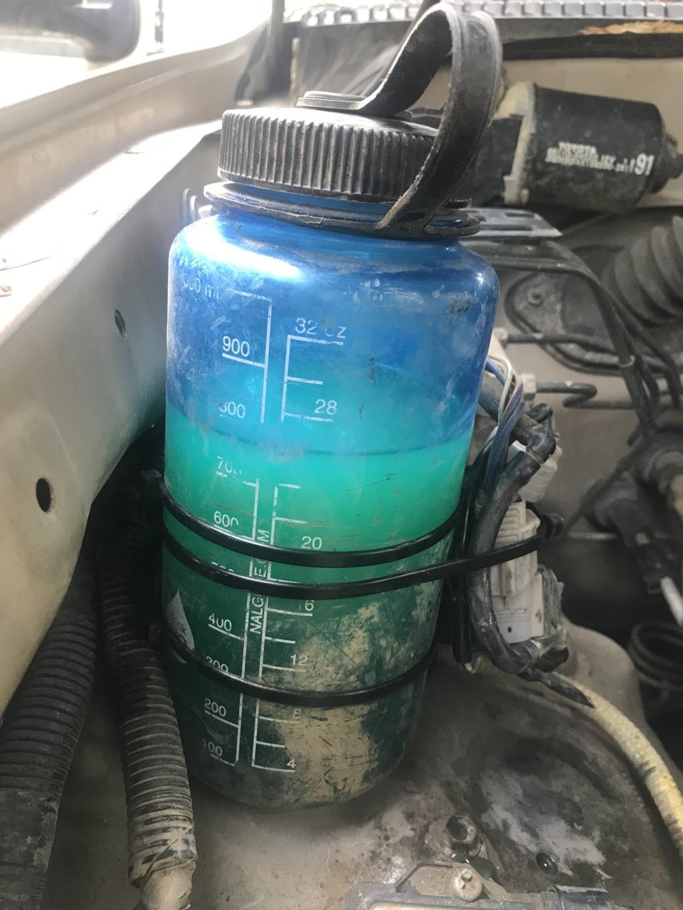

    Upgraded the windshield washer bottle mount from a bungee to zip ties.
