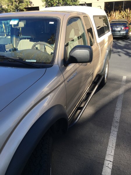

    Welded on my sliders with a little help from some friends.

    SWYPER and EDDO like this.
