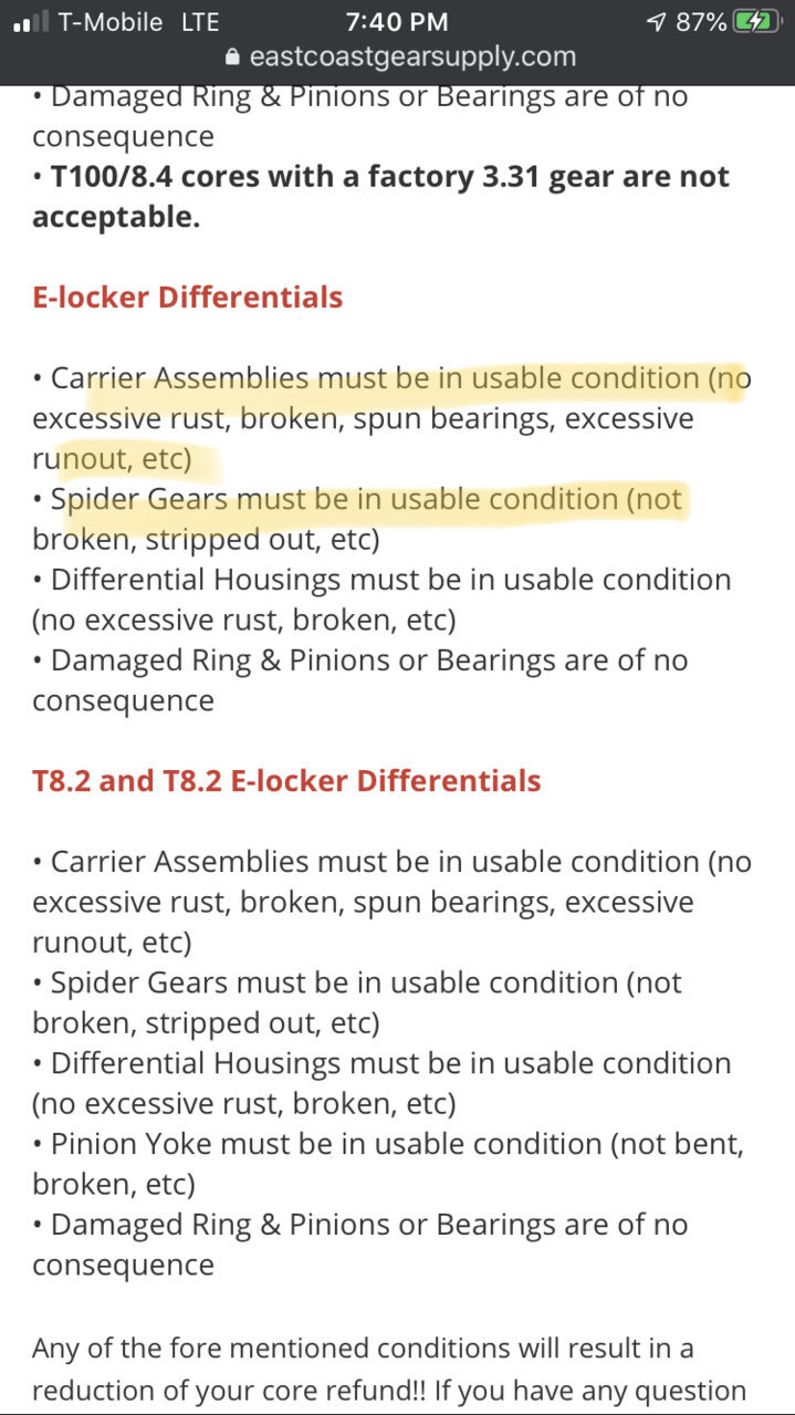

    I’m cool with the leave it at the shop approach.
    I figure I’ve done so much wrenching on my truck I’ve earned a break.
    Also-

    Cool. Just make sure it's a shop you trust and that has a great track record with diffs. I went with ECGS because the 5 year warranty was worth it to me. Their customer service is off the charts good. Like @betterbuckleup mentioned, it is probably at least worth a call to see what they would give you for a core knowing the spider and carrier are beat up.
