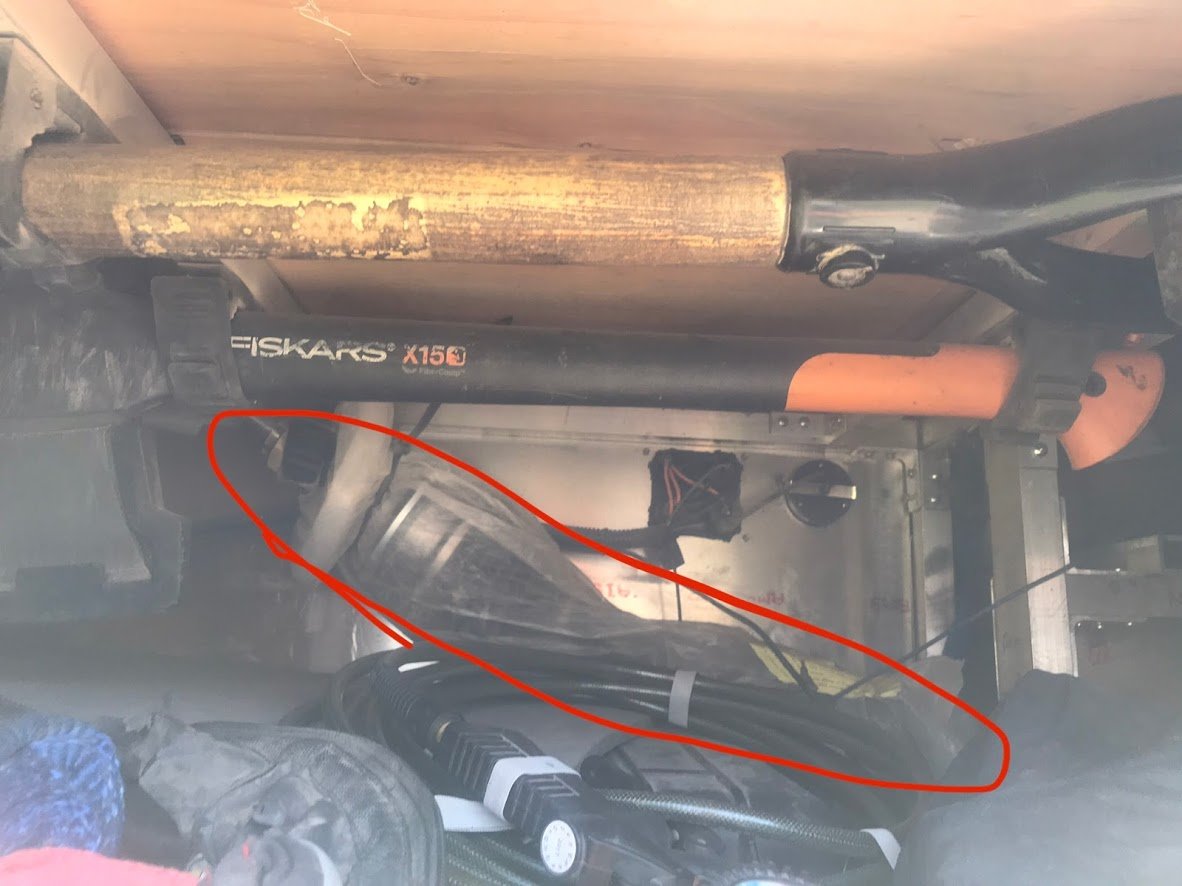

    Do you have a full picture of this setup? I’ve been looking for a way to store my spare axles

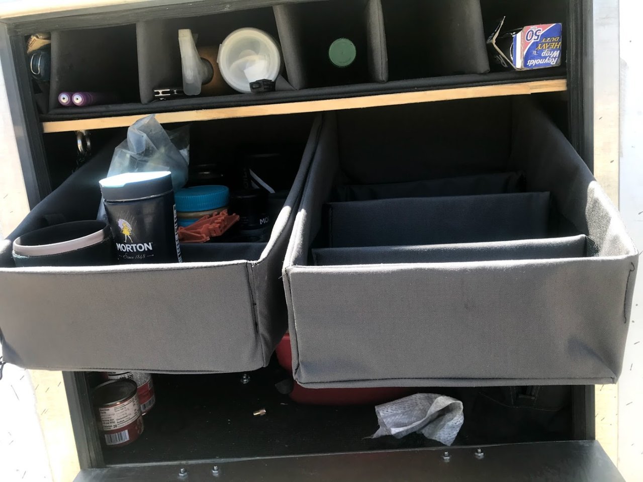

    This padded box has worked out pretty well.
    It has a couple problems. Everything falls over unless it's fully packed and it fits a little too well on the shelf it lives on. You have to remove it to get to it's contents.
    Mrs @theed borrowed my sewing machine a little while ago. She made me these new padded boxes to replace my current one.
    The new ones have velcro dividers so the contents will stay up right. They're full height at the back and short in the front. This way I can retrieve things with out pulling them out and if I do pull them out the full height rear wedges the box in place and keeps it horizontal with most of the box off the shelf.
    These came out great.

    I do.
    It's in here: This is behind the driver side wheel well on the back of the camper.
    Below you can see it all the way in the back circled in red. It worked okay for awhile. I'm having a hard time keeping both ends of the CV attached to the quick fists. I'm thinking a 3rd quick fist in the middle would be a good idea. It's a giant pain in the ass to put it back into the quick fist so i'm just letting it hang on one side. It's resting on my first aid kit which is in a pelican case.
    The shovel and ax work amazingly well. I also keep my recovery gear in that space for quick access. Not visible in this pick on right is the heat exchanger for the shower system. To the left is an air tank, air compressors, blue seas fuse block, some spare parts and golf cart batteries.

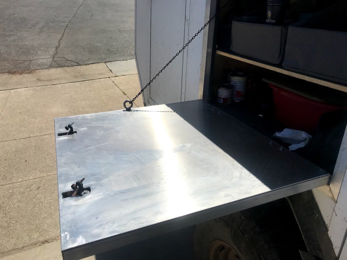

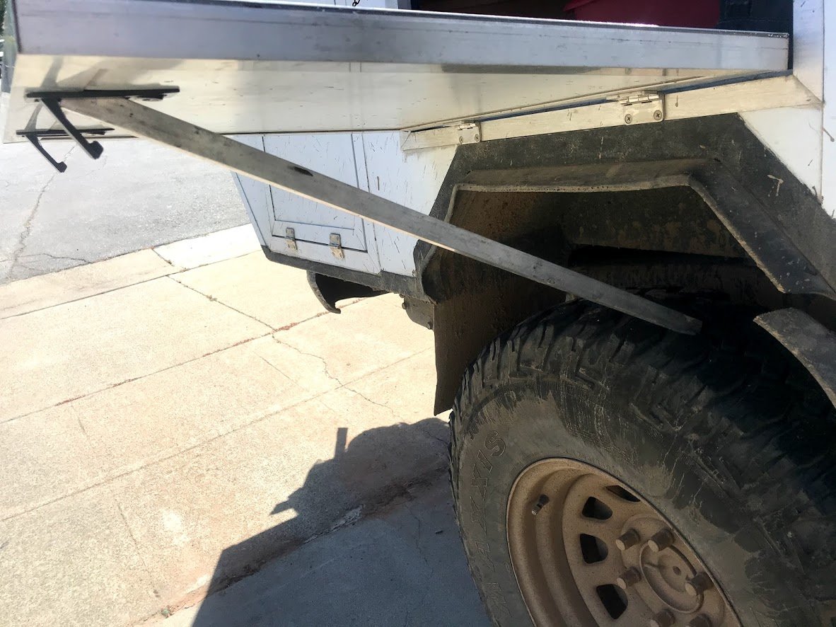

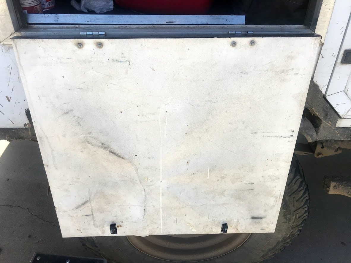

    I replaced the kitchen storage door's inside skin.
    The old door was made of 1/16" FRP panel that was double sided taped to the door's frame.
    It worked well until I melted it with my backpacking stove.
    The door support was a piece of 3/4" aluminum tube I had leftover wedged between the door's latches and the tire. This worked okay until it didn't and all my stuff that was on the door would end up on the ground.
    The original plan was to use stainless. I don't have a good means to cut stainless so I'd have to have a shop do it.
    Or I could use a piece of aluminum I have left over from the camper skin.
    So, I did that.
    It's double sided taped in place like the rest of the camper.
    For the support I bought a piece of chain and bent a link so it's adjustable. I already had the stainless eye bolt on hand. I used an M8 rivenut I already had to secure it to the door. The other end of the chain is attached to another stainless eye bolt that's secured to the wood of the cabinet by a T nut I had.

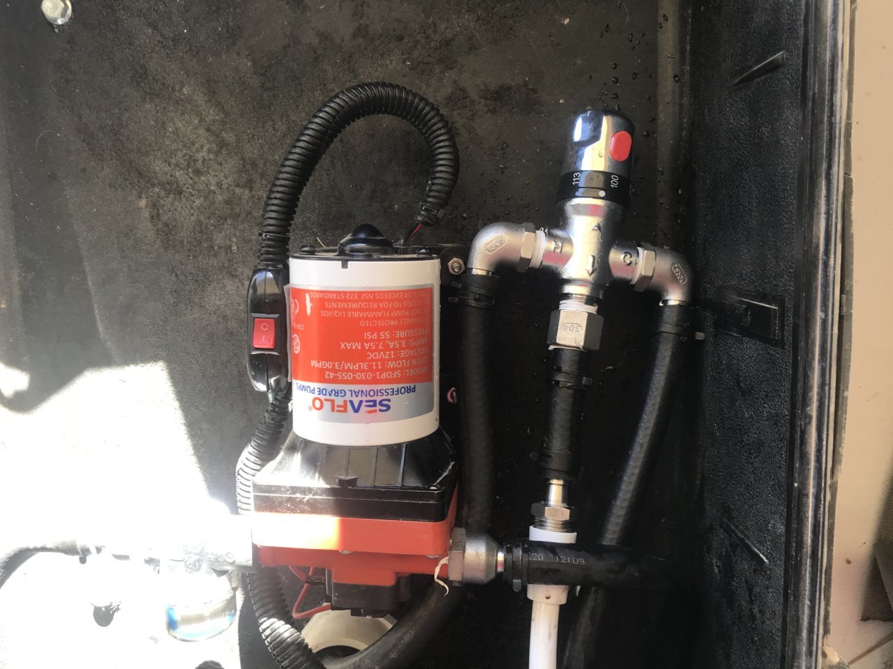

    Thermostatic mixing valve works great.
    I gotta clean it up and make it look neater. I might redo it in pex.

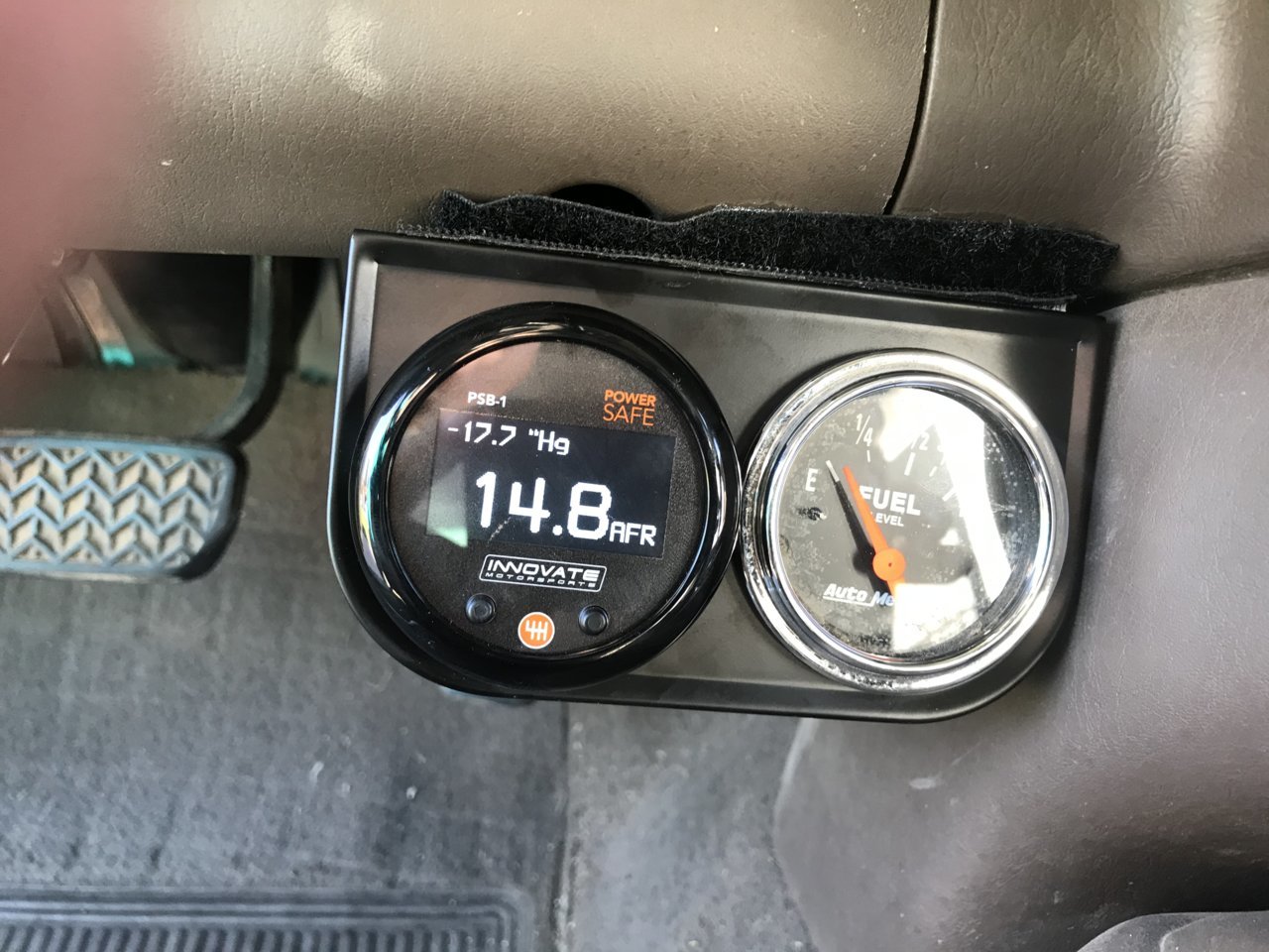

    Added an AFR/Boost gauge and a gauge holder for the 2nd gas tank.
    861DFEEC-2E7D-48E8-A099-75021C8FEC5C.jpg 0FB98D70-6298-42A0-B067-E83E791AD2E1.jpg 54FA81B6-5B70-4FE4-94E0-53686E934974.jpg
