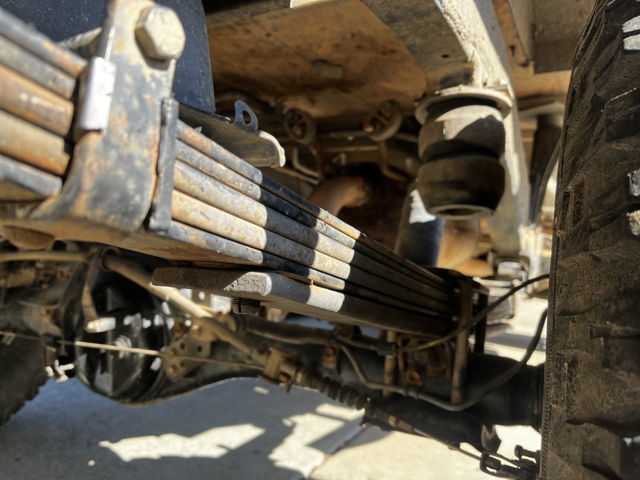

    So my 130,000 mile old man emu leaf packs aren’t up to the chore of carrying my fat ass truck. I have the Timbren load bearing bump stops and the truck sits solidly on those. It has very little up travel. .
    I was going to replace the OMEs with a set of Alcans custom leaf packs but a dental detour (I had 2 implants fail and become infected, they’ve been removed, cadaver bone was placed, new implants go in March 7th…super super expensive) is putting that on hold.
    but I have my own imojis.
    I decided in the meantime I’ll make a bastard pack with some junkyard leaf springs.
    I got some 2.5” wide leaves from a GMC Sierra pick up. (Yes, a 63” swap
    was tempting but I’m looking for load carrying more than flex and a 63 swap is a bit more than I want to deal with.
    I cut up the Chevy spring and replaced 3 of the old man emu springs with 2 of the chevys.
    The truck sits 4.5” higher than before. Way too high. And the driveline vibes are pretty bad.
    Next I’m going to remove one of the Chevy springs and see how that works out.
    besides the driveline vibration the ride is much much smoother and there’s a lot Less body roll on the corners.8AF1504F-C110-4301-B849-1F276749979A.jpg

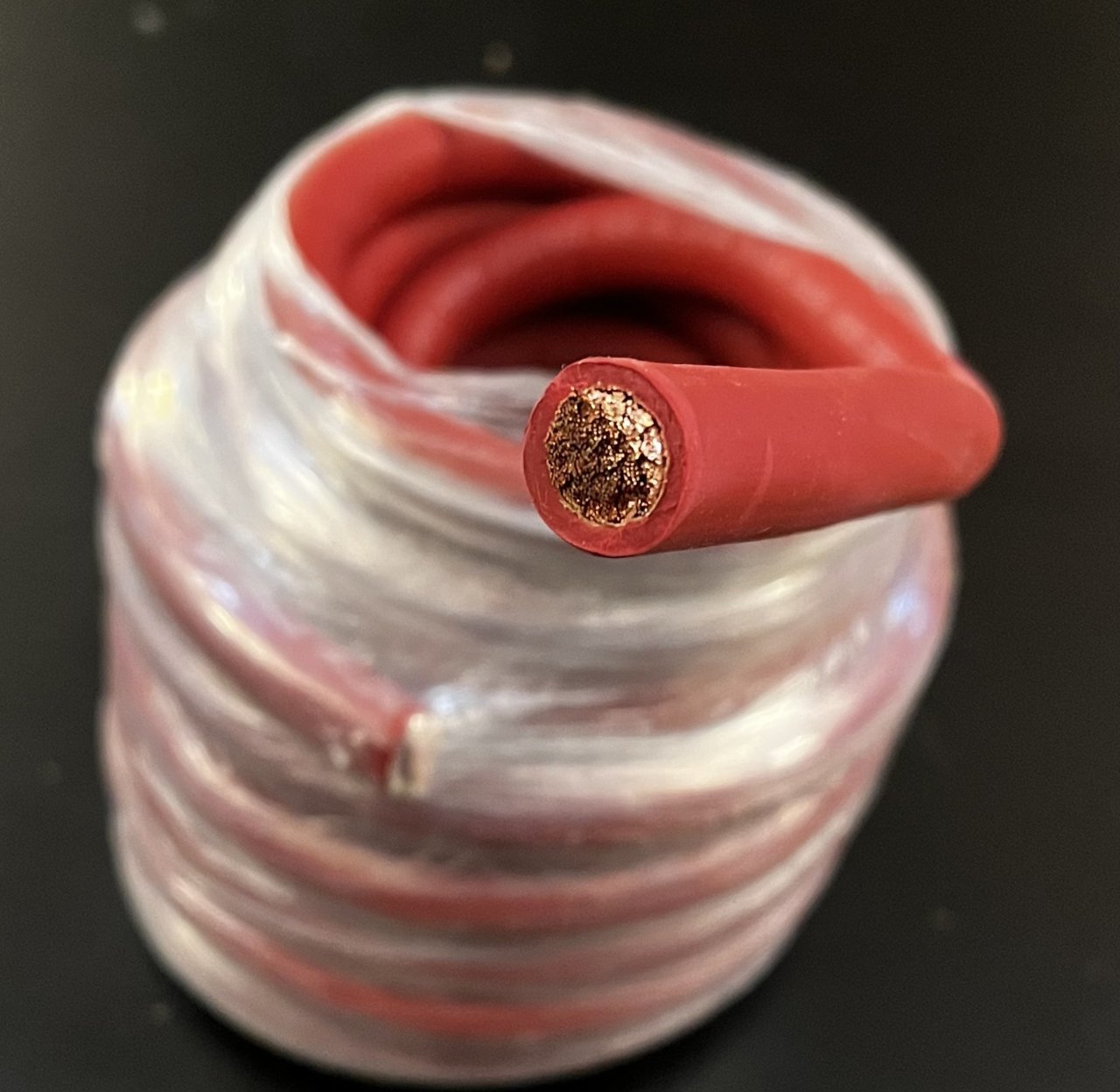

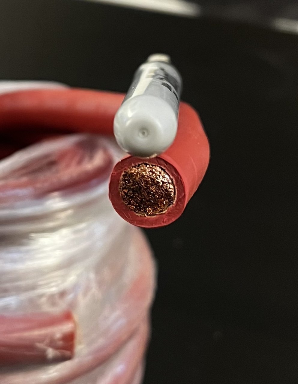

    Fatter battery cable
    That’s a sharpie

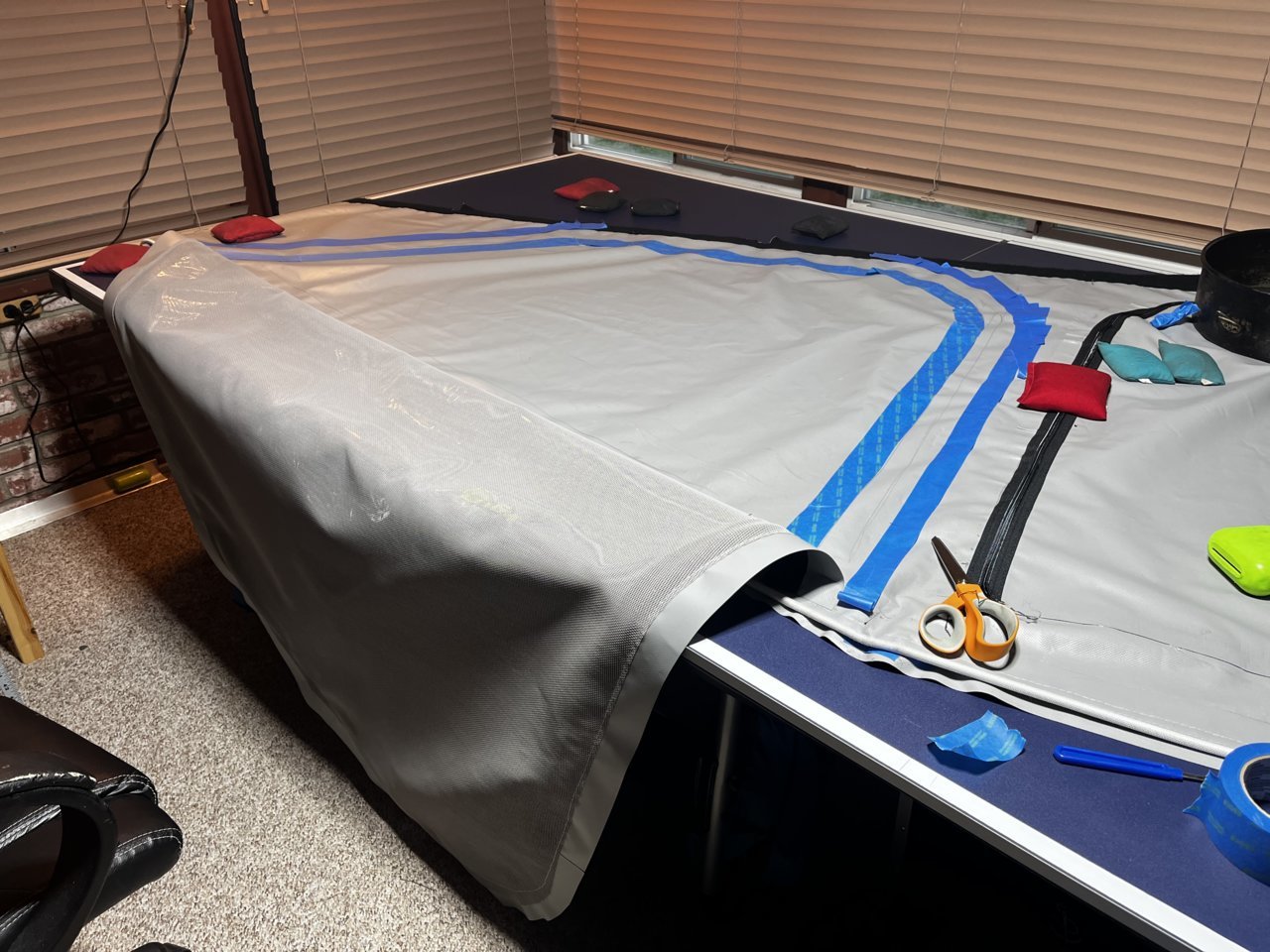

    Attaching the last window.
    Phessor, cbechtold and Dalandser like this.

    FUCK!
    I’m so close to being done.
    I started this thing in November and I just cut a giant hole through the screen and the clearly vinyl window.

    I think I’m going to patch the clear and sew the slice in the mesh together with thin light gray thread for now and make a better fix later.

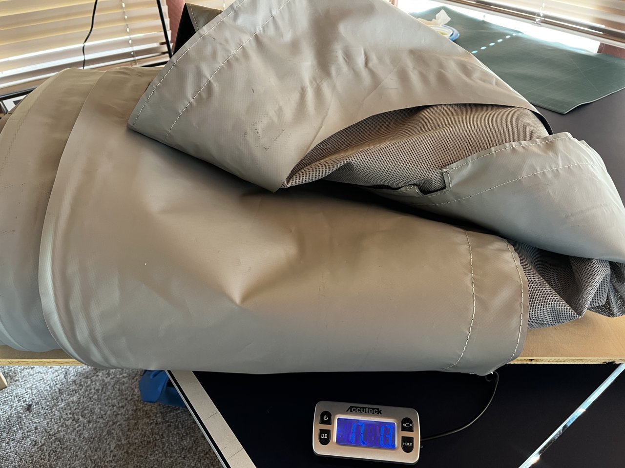

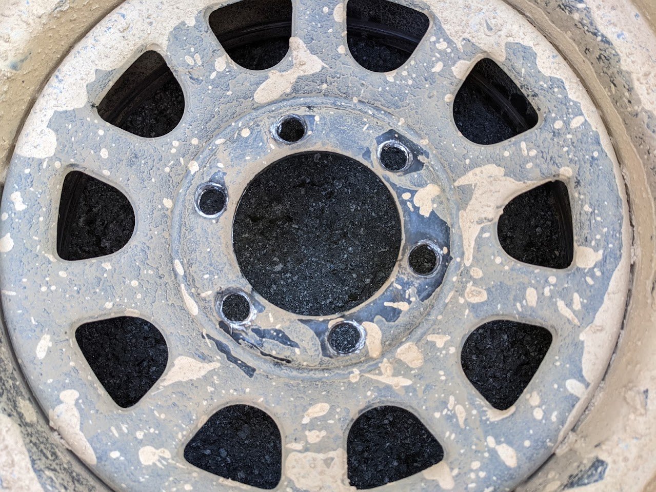

    That camper's heavy. Good job removing some extra weight and unnecessary material from the wheels!

    It’s not as heavy as I thought it would be. Just over 17 pounds.

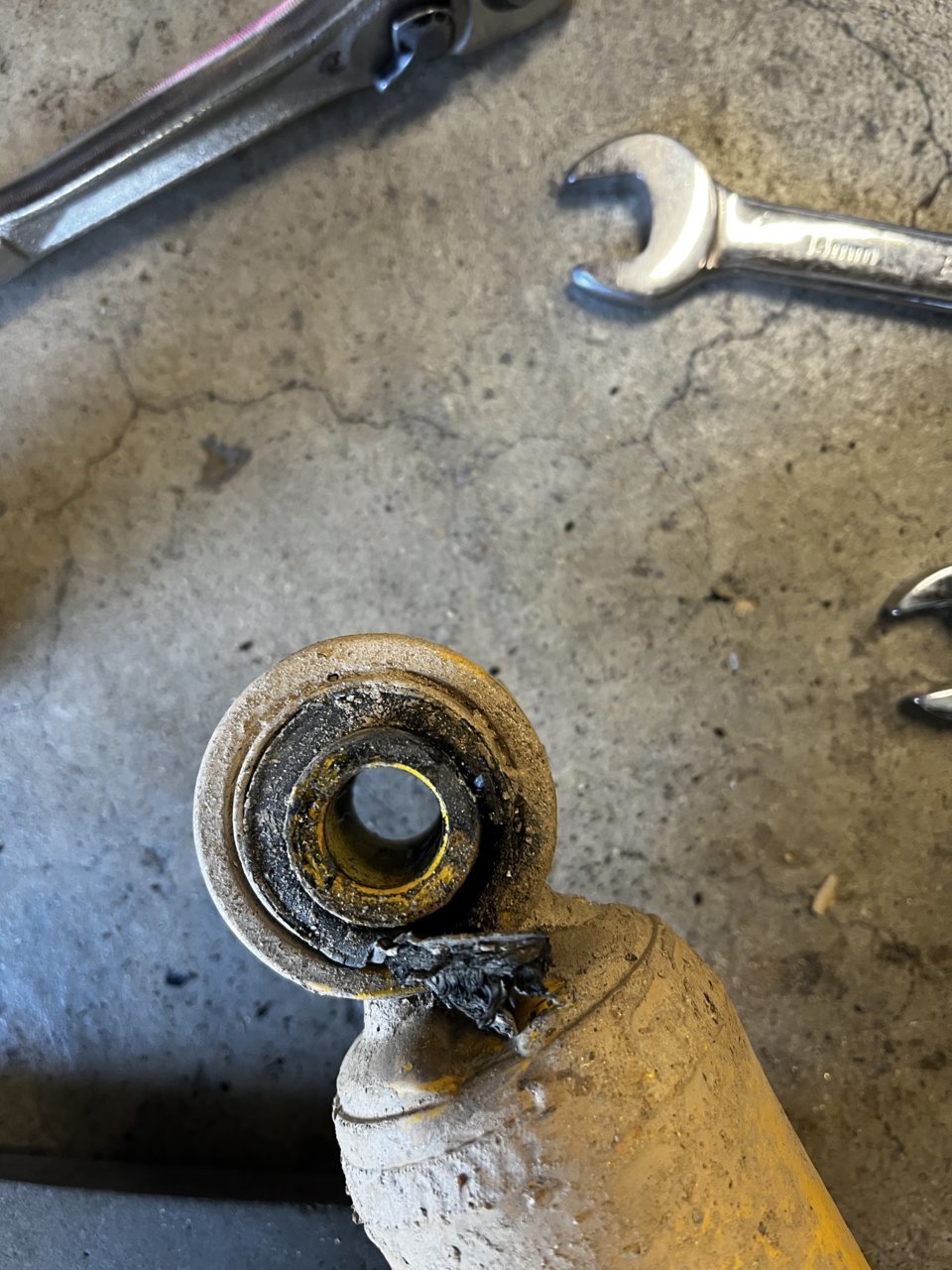

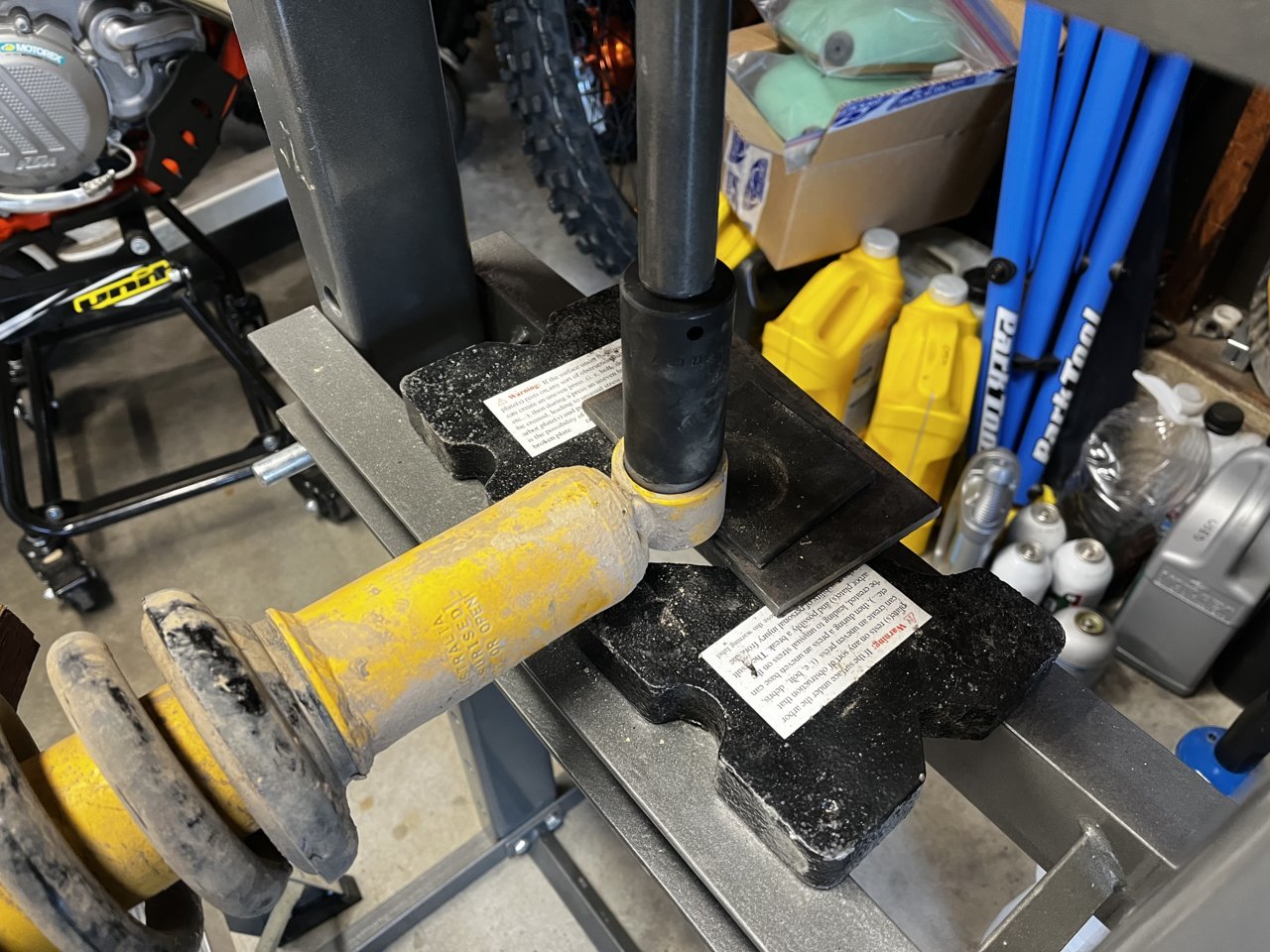

    Some fresh bushings for the font lower shocks.
    Driver’s side bushing well was on its way to being totally shot.
