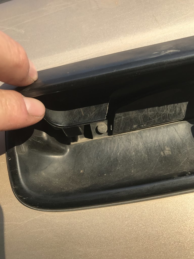

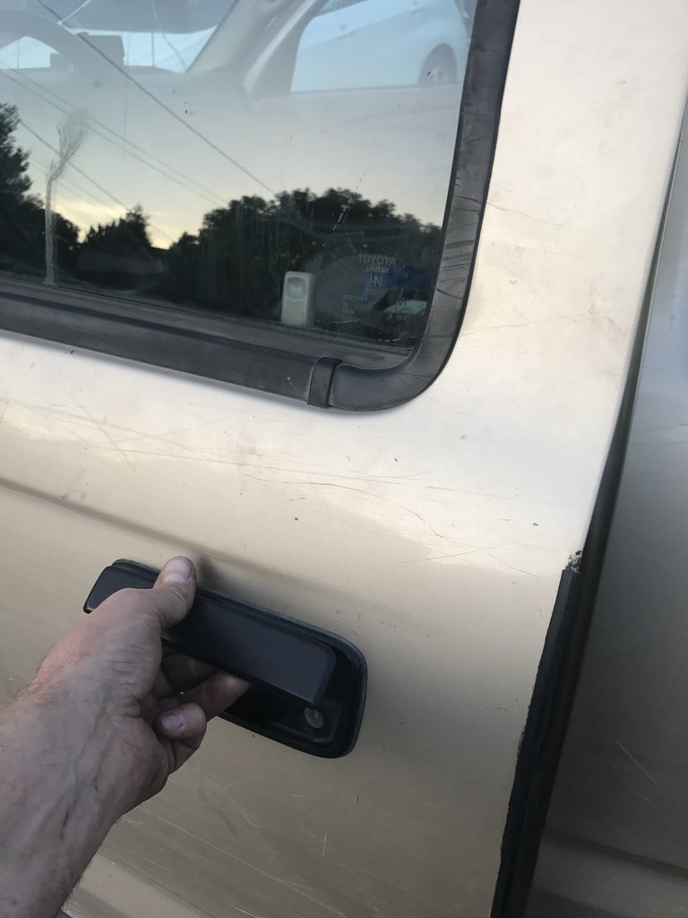

    Broke my door handle.
    I picked up a used OEM one at Toy Connection. I really lucked out with the wrecked Tacoma that they just got a hold of.

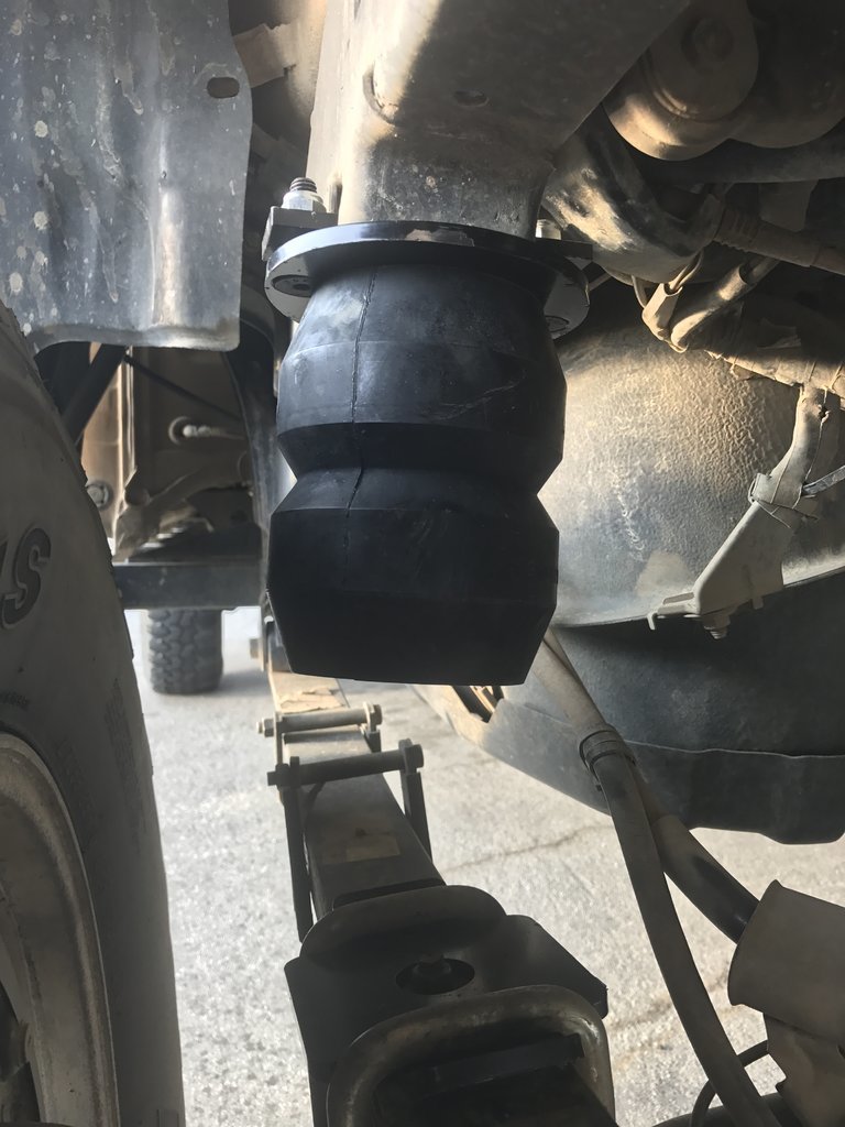

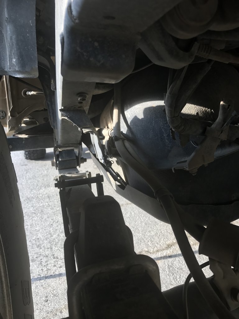

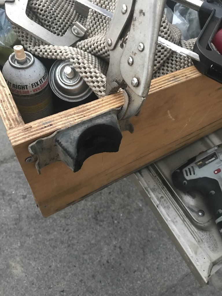

    Before -
    After
    So far so good. The body roll around corners is drastically reduced. I've hit a few big bumps. You can feel the timbrens when you do. It's a bit harsh. I gotta take them off roading to decide if they're staying.
    I did turn one of my stock bump stops into a part for my motorcycle mountain bike rack though.
    Before:
    After:

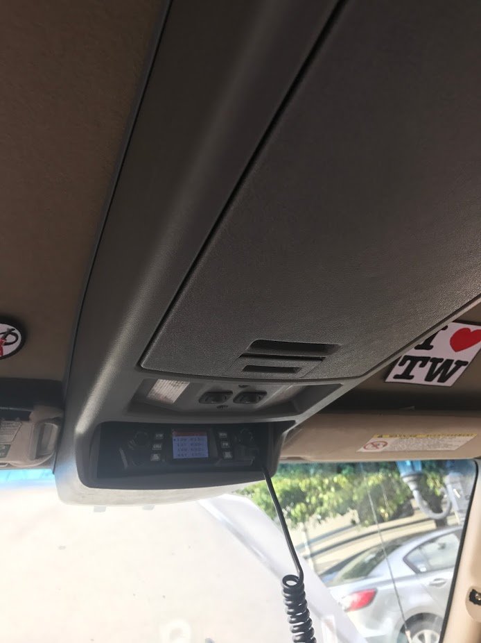

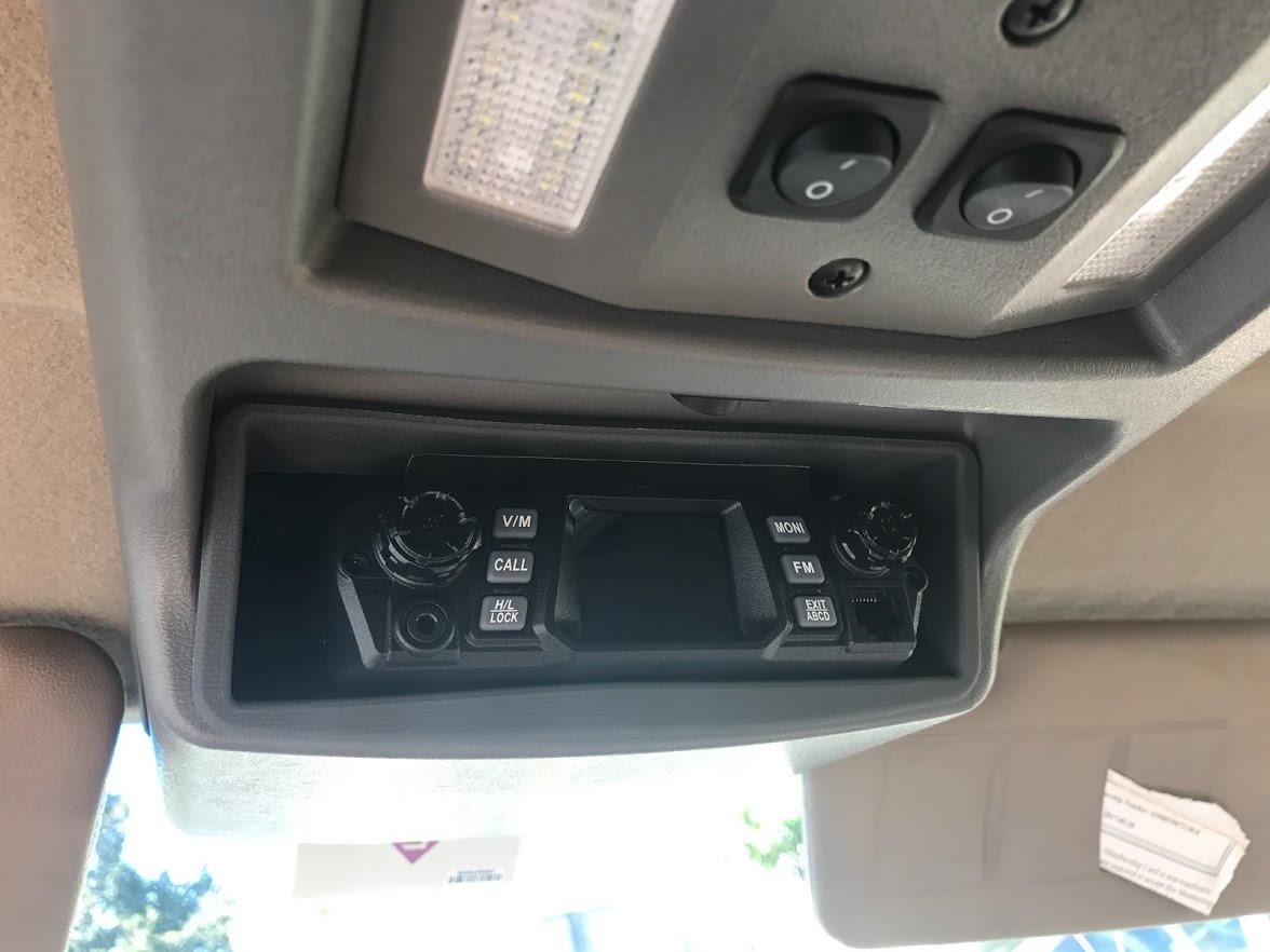

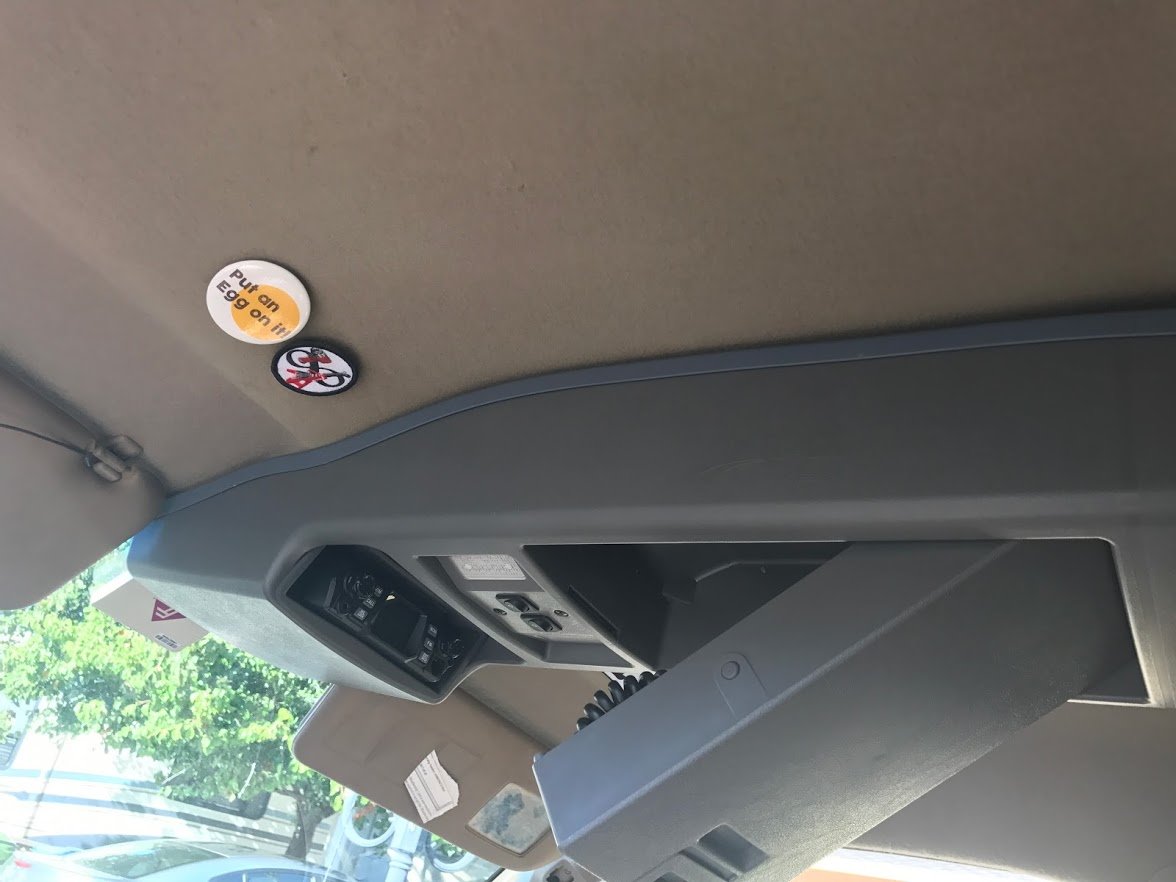

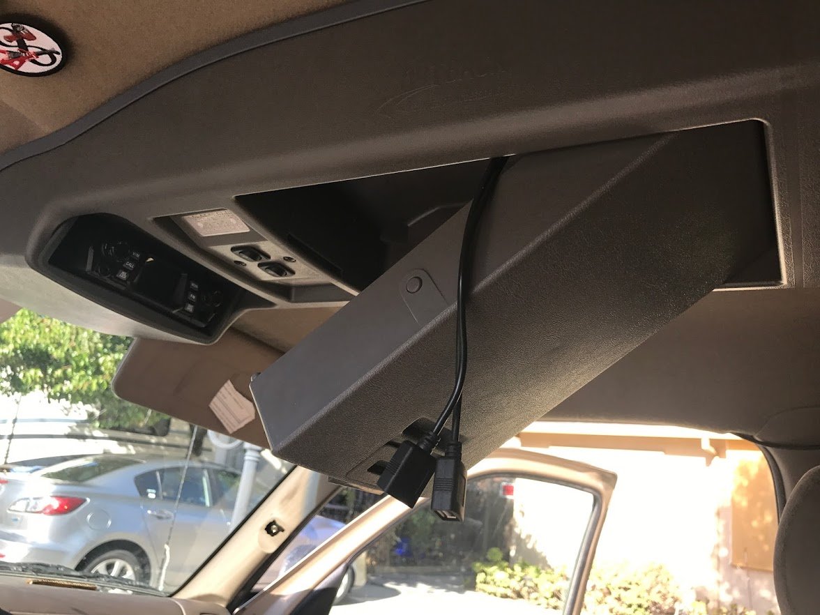

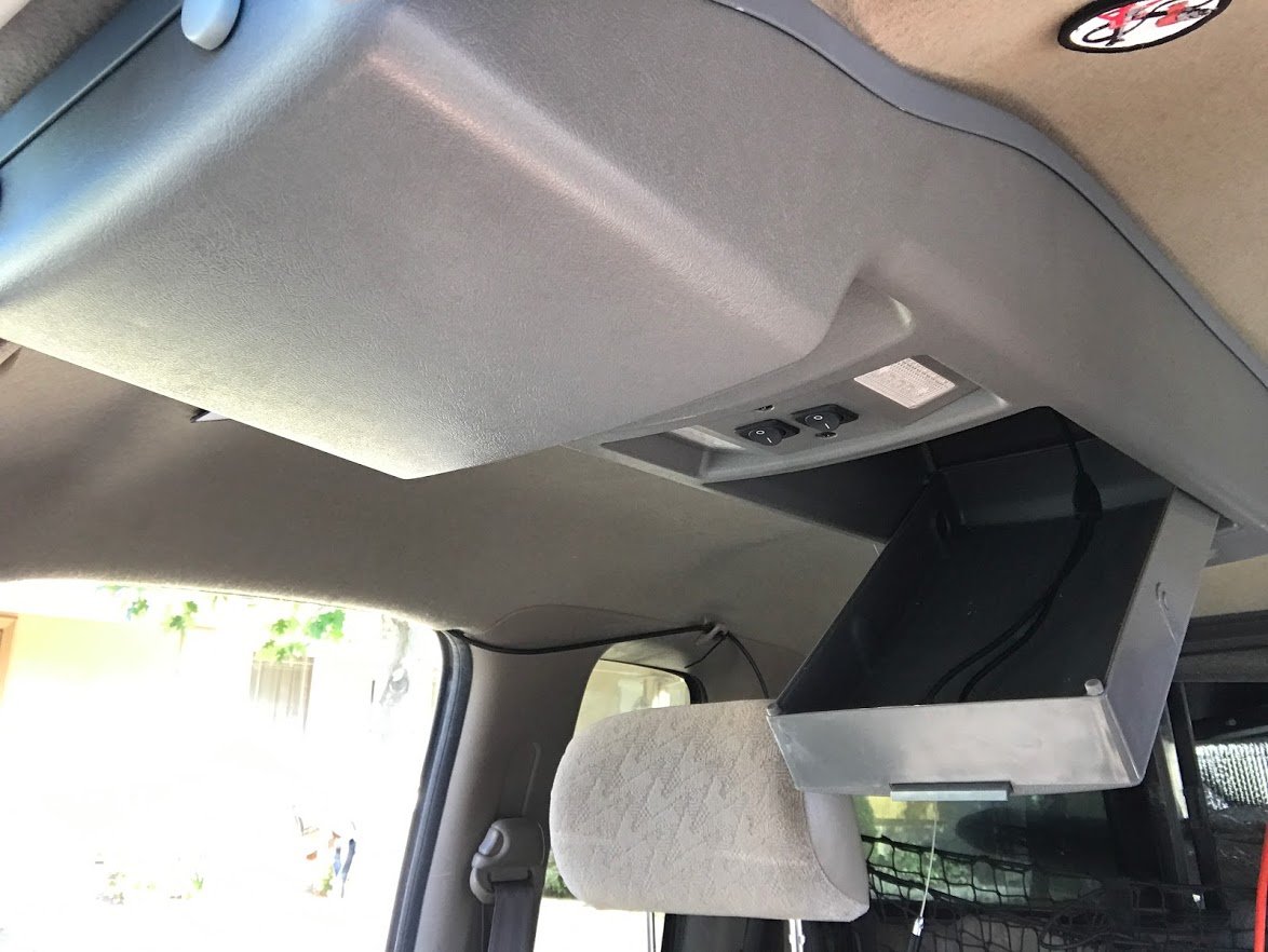

    I've always wanted an overhead console to mount a mobile ham radio into. After watching countless hours of Ronny Dahl and other Australian 4wd youtube shows where they have all this cool shit with over head consoles I finally decided something must be done.
    I spent way to much time drooling over http://www.consoles.com.au/Toyota_79Series_dual_troof.htm and others like it.
    Finally I said "Fuck it, I'm going to make this shit work" (I said this outloud).
    I found this thing on Amazon...but it's for an FJ cruiser...https://www.amazon.com/ARB-BRCFJ-Ou...506137805&sr=1-1&keywords=fj+overhead+console
    After a whole bunch of cutting and trimming and drilling and cursing I made it fit and I jammed a BTech UV 50x2 into. I added a couple USB ports because why not? It has a switch for each of the map lights, a switch for the rear facing "dome" lights and a switch to turn on all 4 lights. I converted that 4th switch to turn on my forward facing camera. It works really really well. I'm really happy about how it turned out.
    I shoulda spent the money on upper control arms but now I can talk to the International Space Station if I really really wanted to.

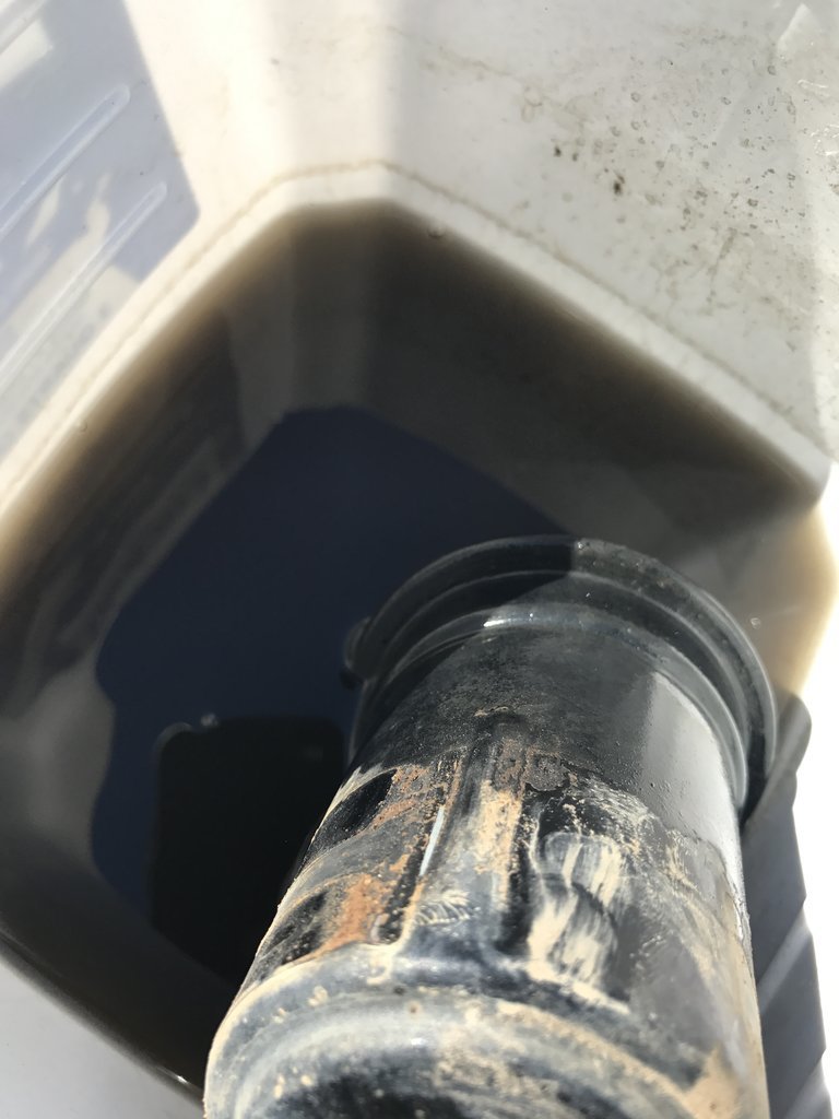

    Changed fuel filter. This is what was inside it.

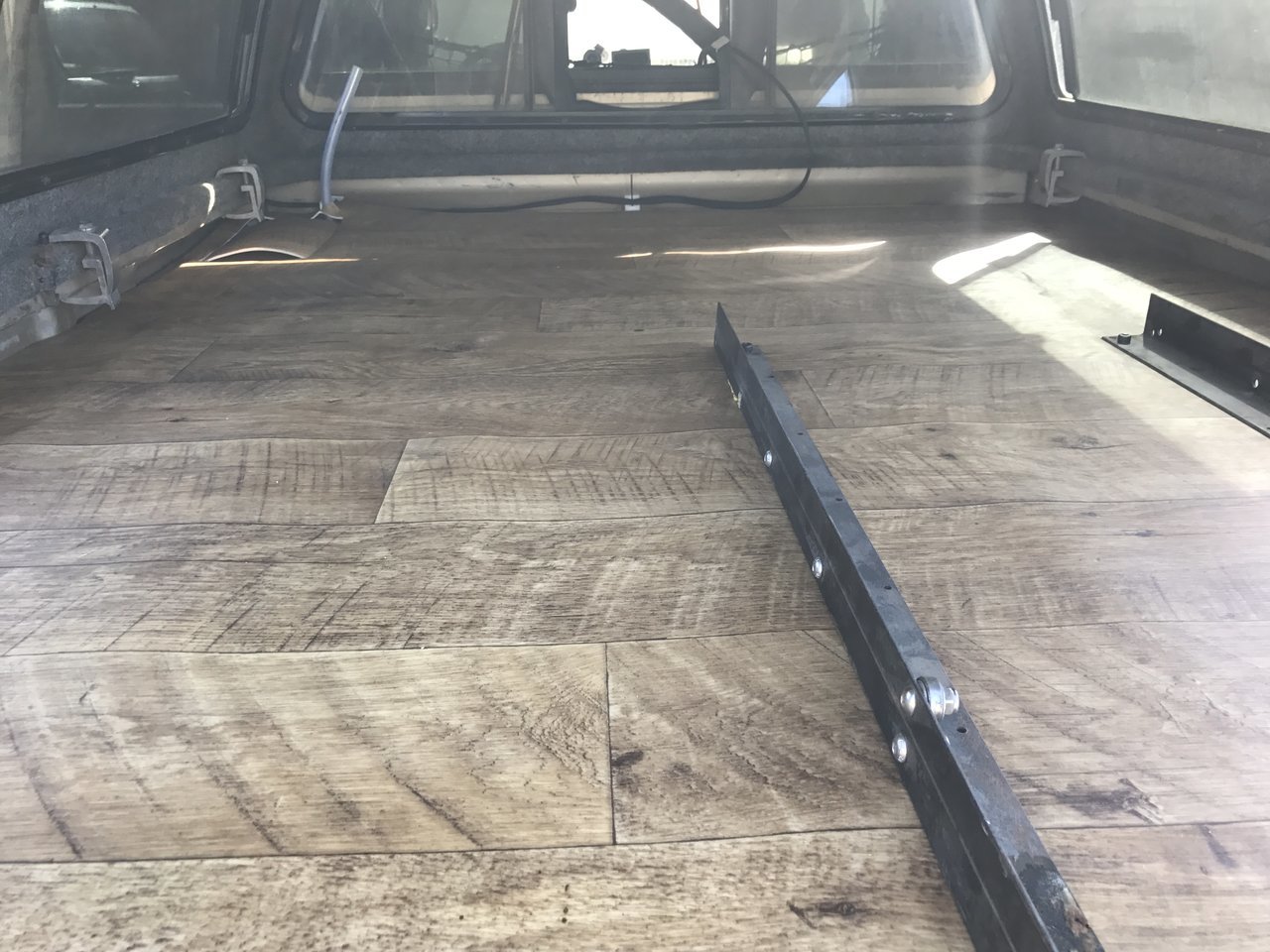

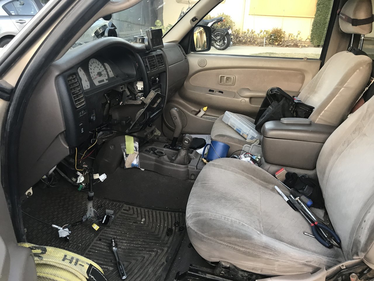

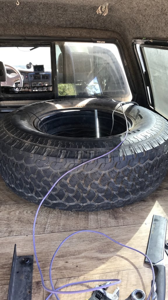

    Fixed the intermediate steering shaft. Soook much better!
    Got some vinyl flooring remnant for my sleeping platform.
    Secured my spare tire by bolting it to the platform.
    Celebrating with good beer.

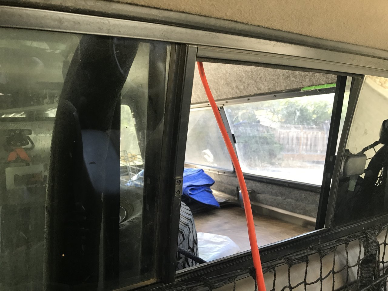

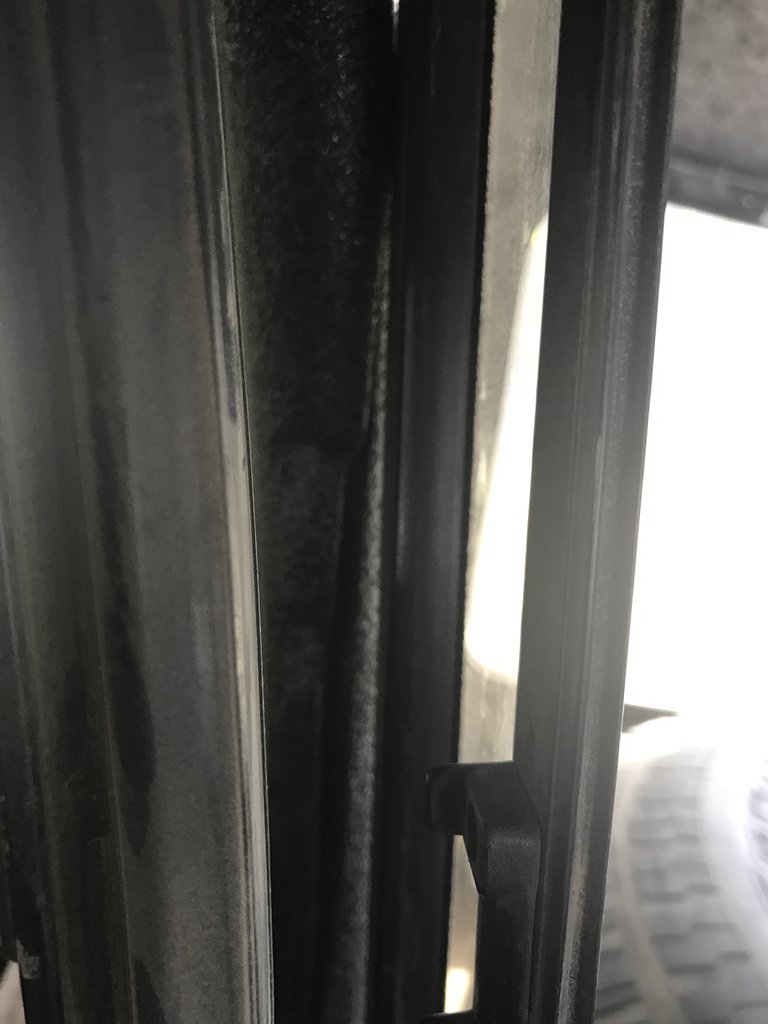

    Cool thread, just spent the evening going throughout it. Very entertaining and informative. A few questions, does the rear window inner tube cut down on road noise? And with the hole in the radiator fairing would it make sense to glue in a right-angle of abs to force the air to come through the radiator as much as it used to(abs can be heat formed to fit your cuts or to follow the radius of the battery corner)?

    The innertube does a good job of keeping the road noise out. It's the dust that it's really good at keeping out. On that note I determined the inner tube doesn't work. As you go up and down in elevation...as we do here in CA...the tube expands and contracts with air pressure. Yesterday I loosened the camper shell clamps and slid the shell forward about 1/2 inch. I glued the two ends of some pipe insualtion together and shaved the sides down with a knife. I jammed that in there. It's quieter and won't expand and contract.

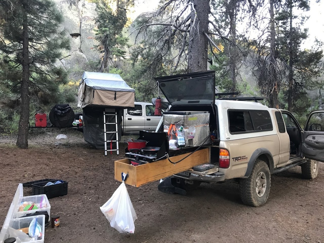

    I don't think I've posted any pics of my truck in it's camping mode. Here are some pics from this past summer.
    Near Tuolomne, CA
    Slick Rock Trail
    970btu, frenchee, EDDO and 3 others like this.

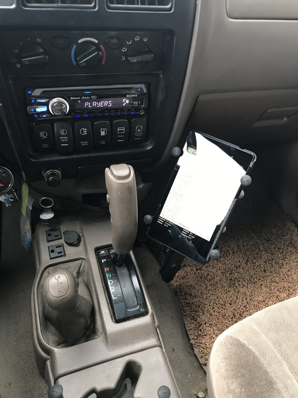

    Tablet Mount

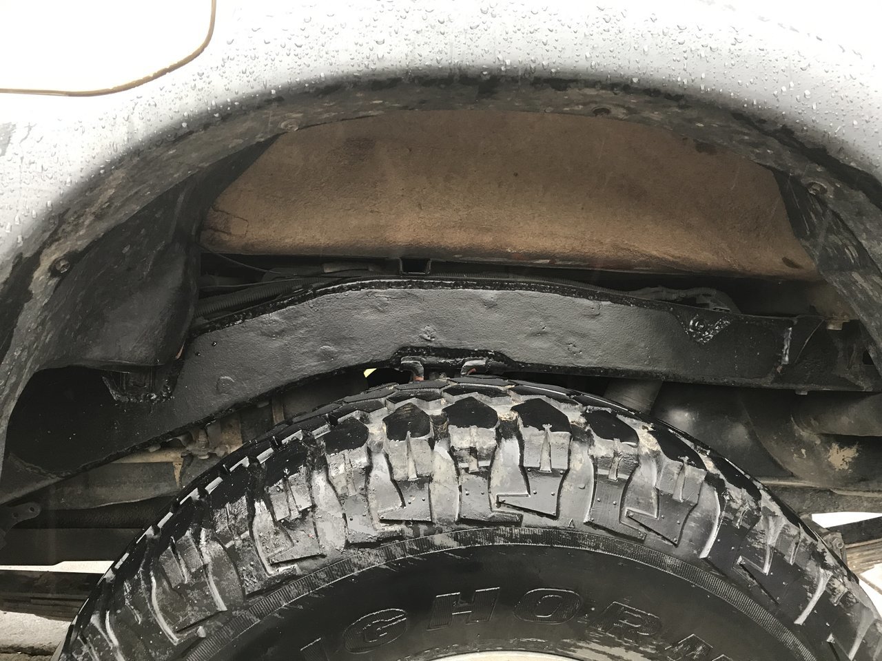

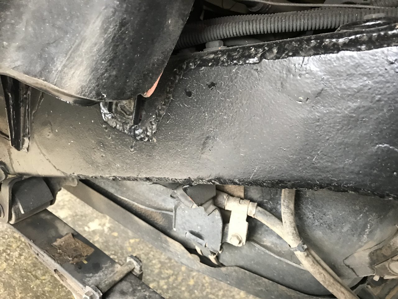

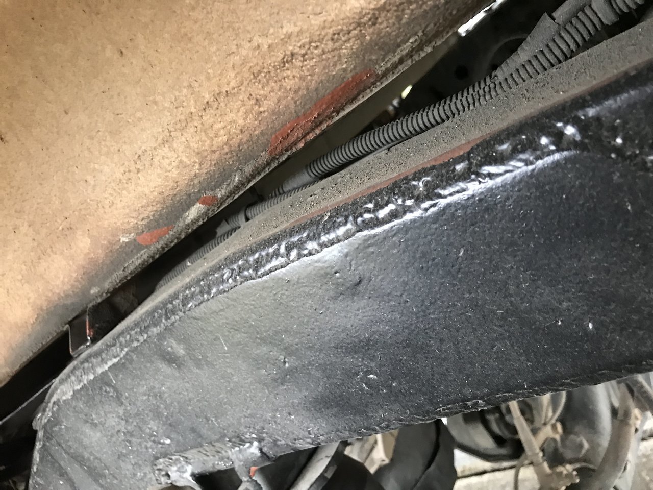

    I've had these frame plates under my bed for a few years. @Fuergrissa amd I welded them on a few weeks ago. Well...he welded Inised the angle grinder for clean up and prep.
    I'm pretty happy with how they came out.
