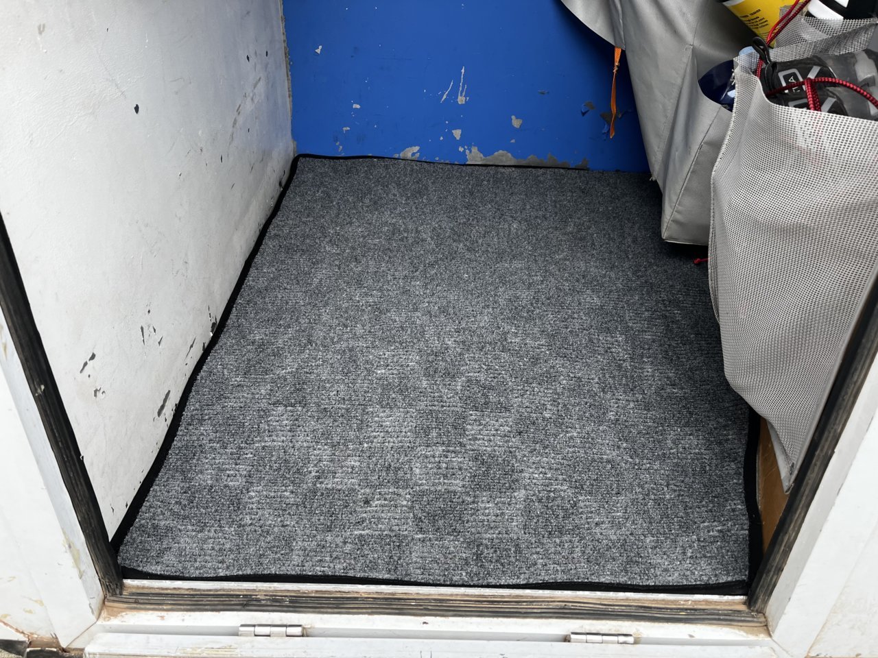

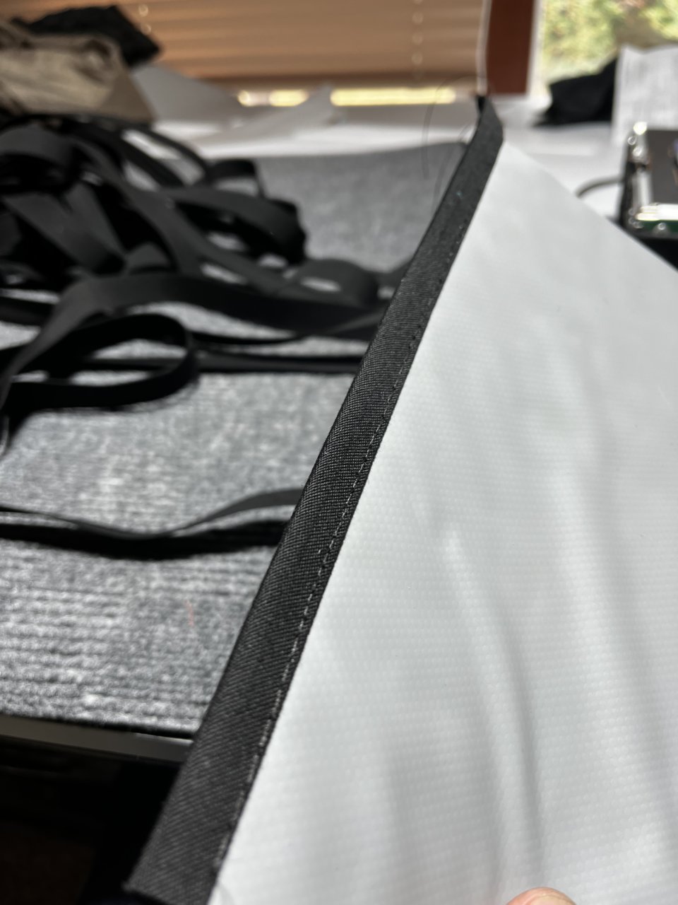

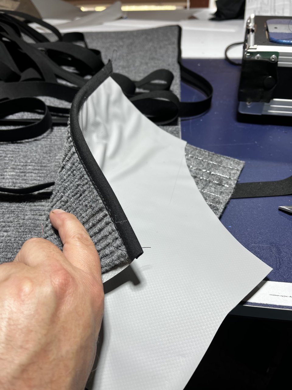

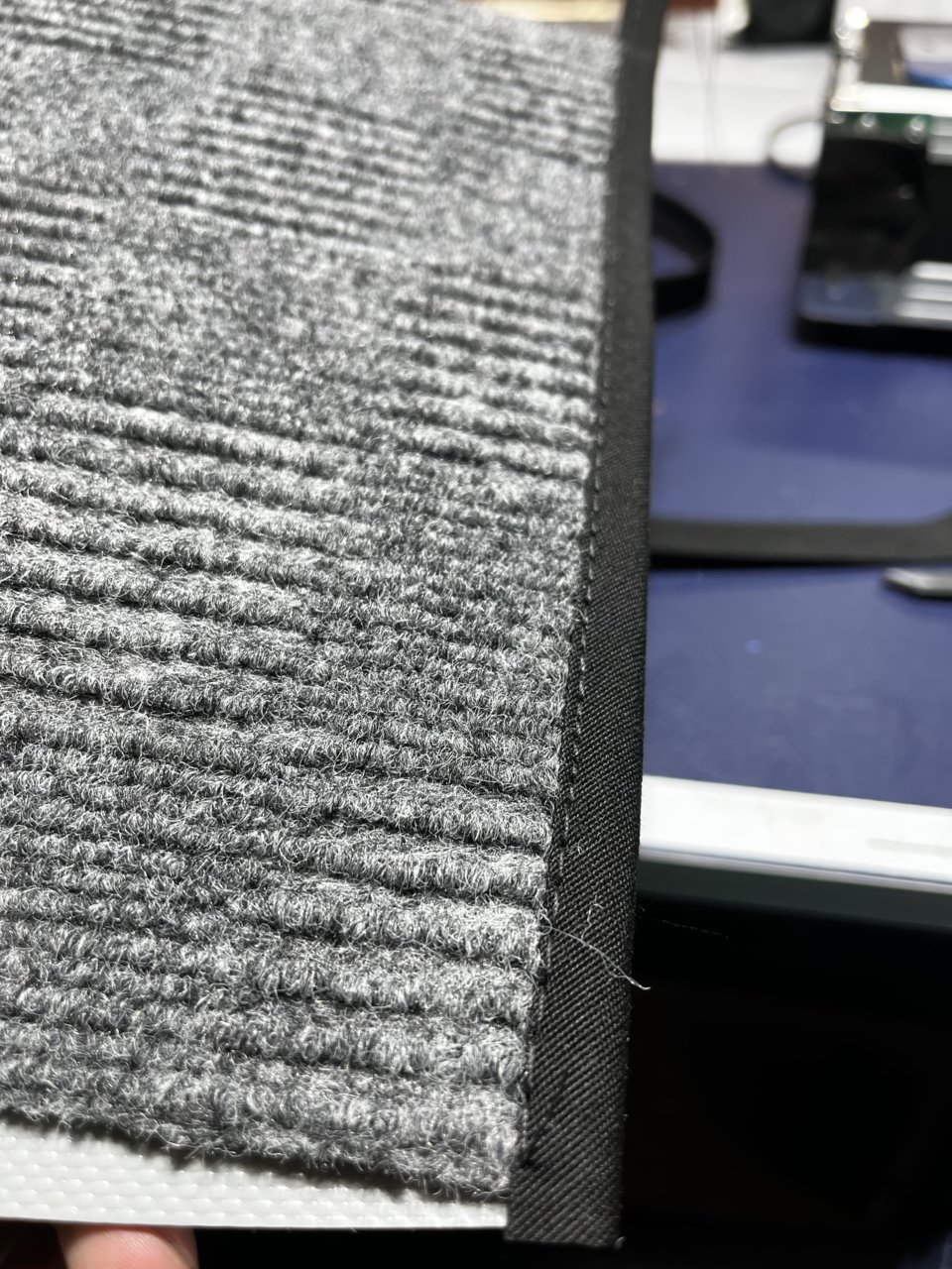

    I broke my sewing machine last week sewing together carpet, 18oz vinyl coated polyester and sunbrella bias binding tape.
    I was moving the needle side to side and had a brain fart and moved the needle while sewing.
    The needle bent and collided with the retaining ring cap spring, broke in half and the broken half jammed into the shuttle gib hook.
    It bent the cap spring and put a huge burr into the gib hook. And through the “shuttle transmission group” out of timing.
    I put a spare spring retaining cap into it and tried to file and buff out the burr on the gib hook but decided to buy a new one and work repairing this one later.
    I had a spare cap spring and still need to fix the timing.
    Right now is sews but it sounds horrible making this banging sound and it chews the thread up from getting caught on the burr on the gib hook.
    new parts showed up today. First test came out good!
    Bottom side under the carpet.

    The carpet came out good

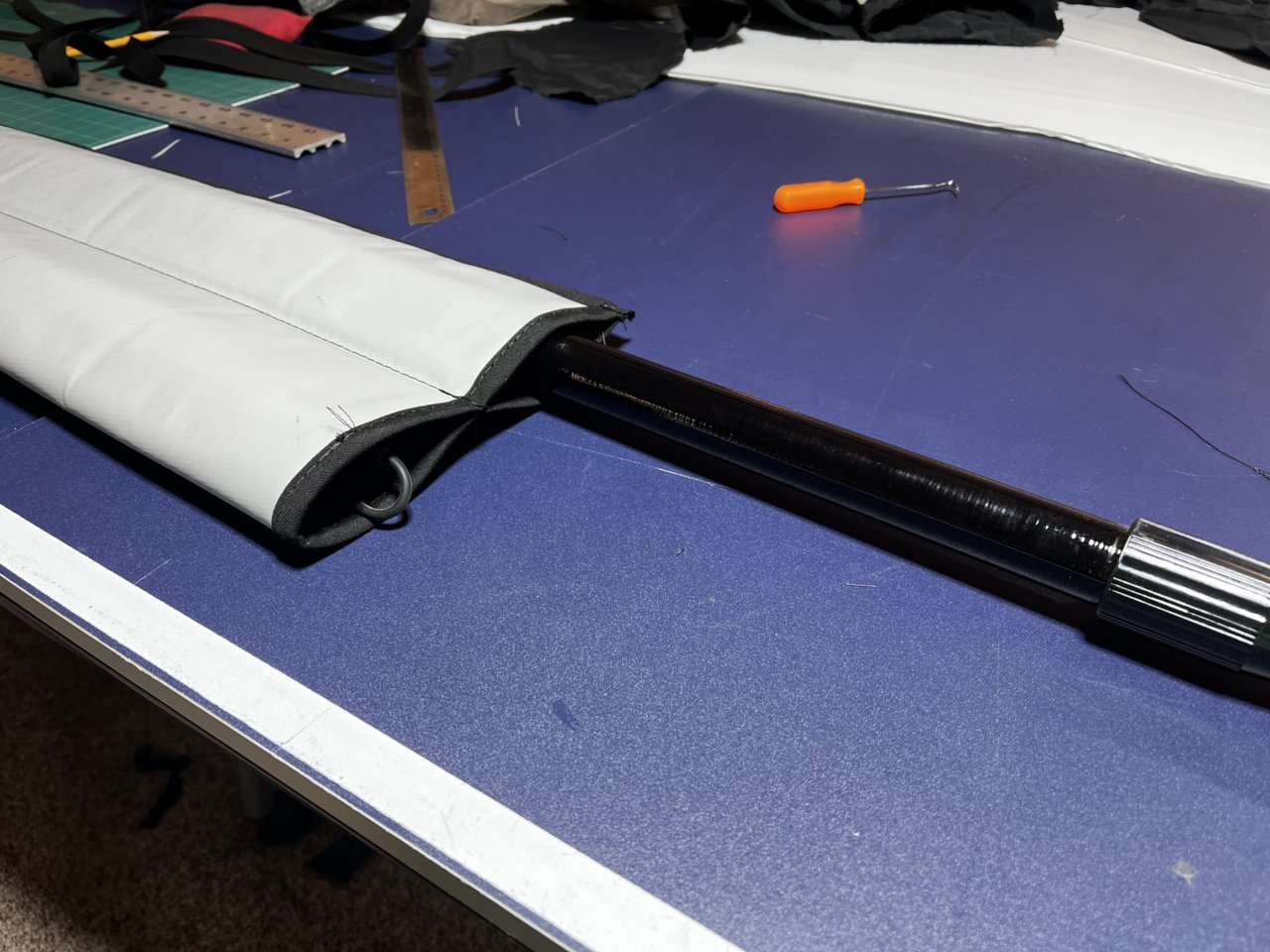

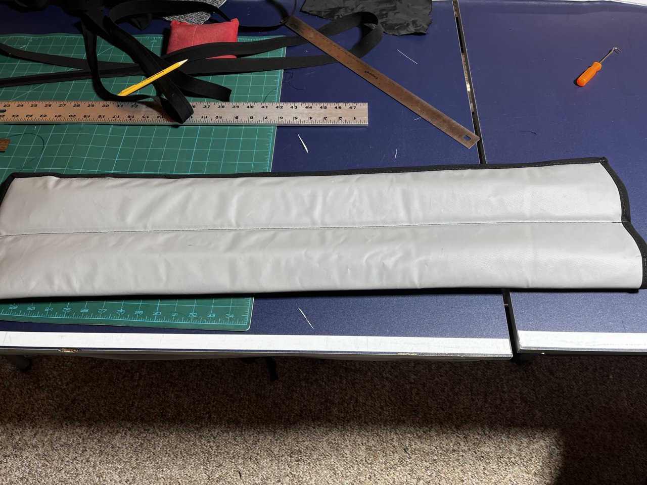

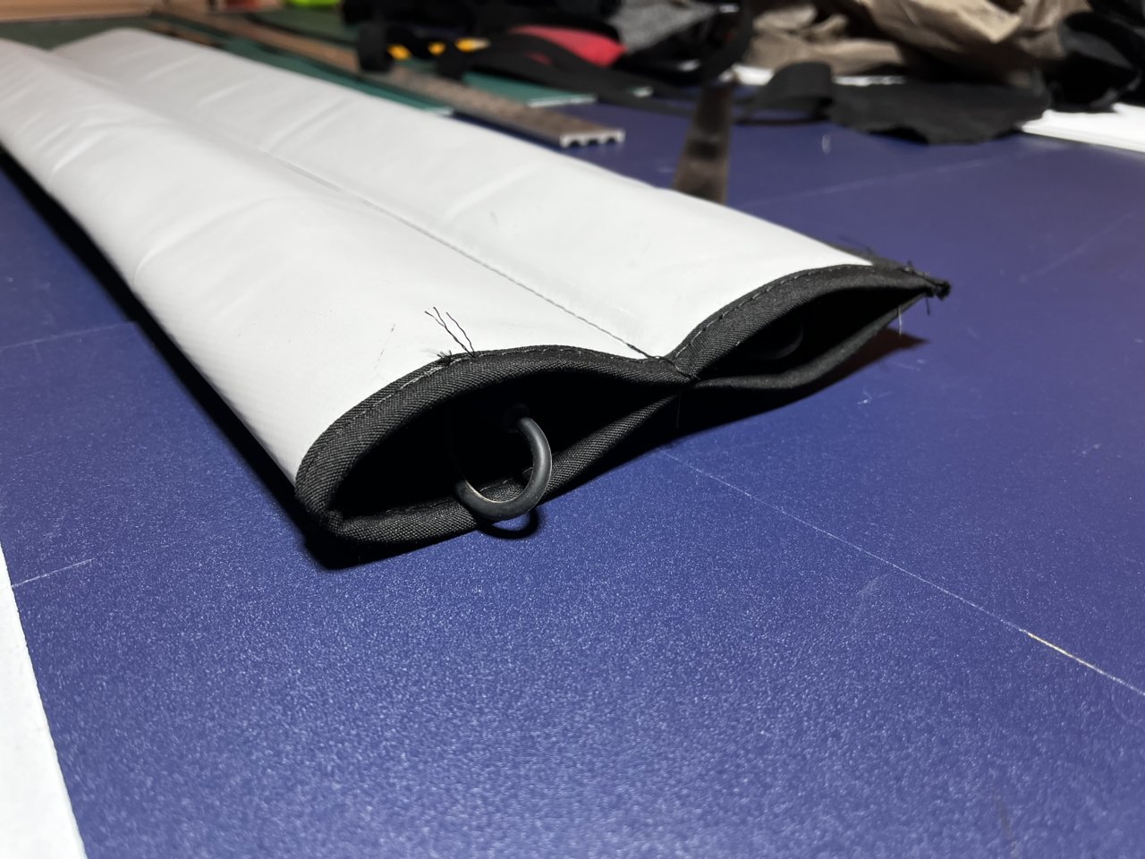

    I bought these poles for the awning I made.
    KOMCLUB Telescoping Tarp Poles,Adjustable Tent Poles for Tarp,Heavy-Duty Design,Portable & Lightweight Fiberglass Tent Poles for Shelter,Camping, Awning, 4 Sections Adjustable to 98.51 in(Set of 2) https://www.amazon.com/dp/B08CDR6YLG?_encoding=UTF8
    The bag they came in is crap and they were vibrating together
    So, I made this padded bag out of Pellon Flex Foam, 18oz vinyl coated polyester and some random black fabric I had that I used for the liner.

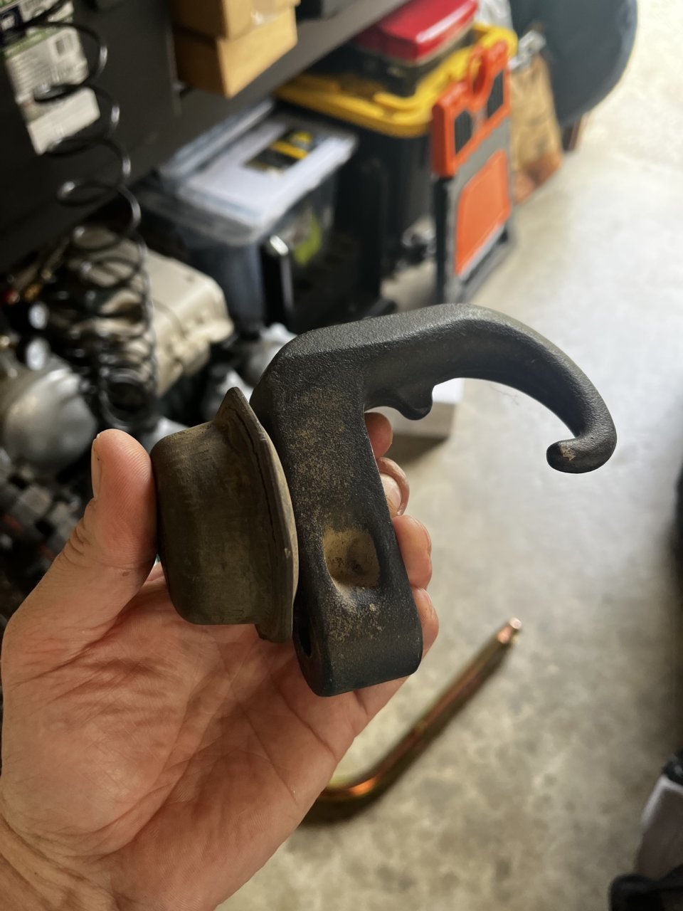

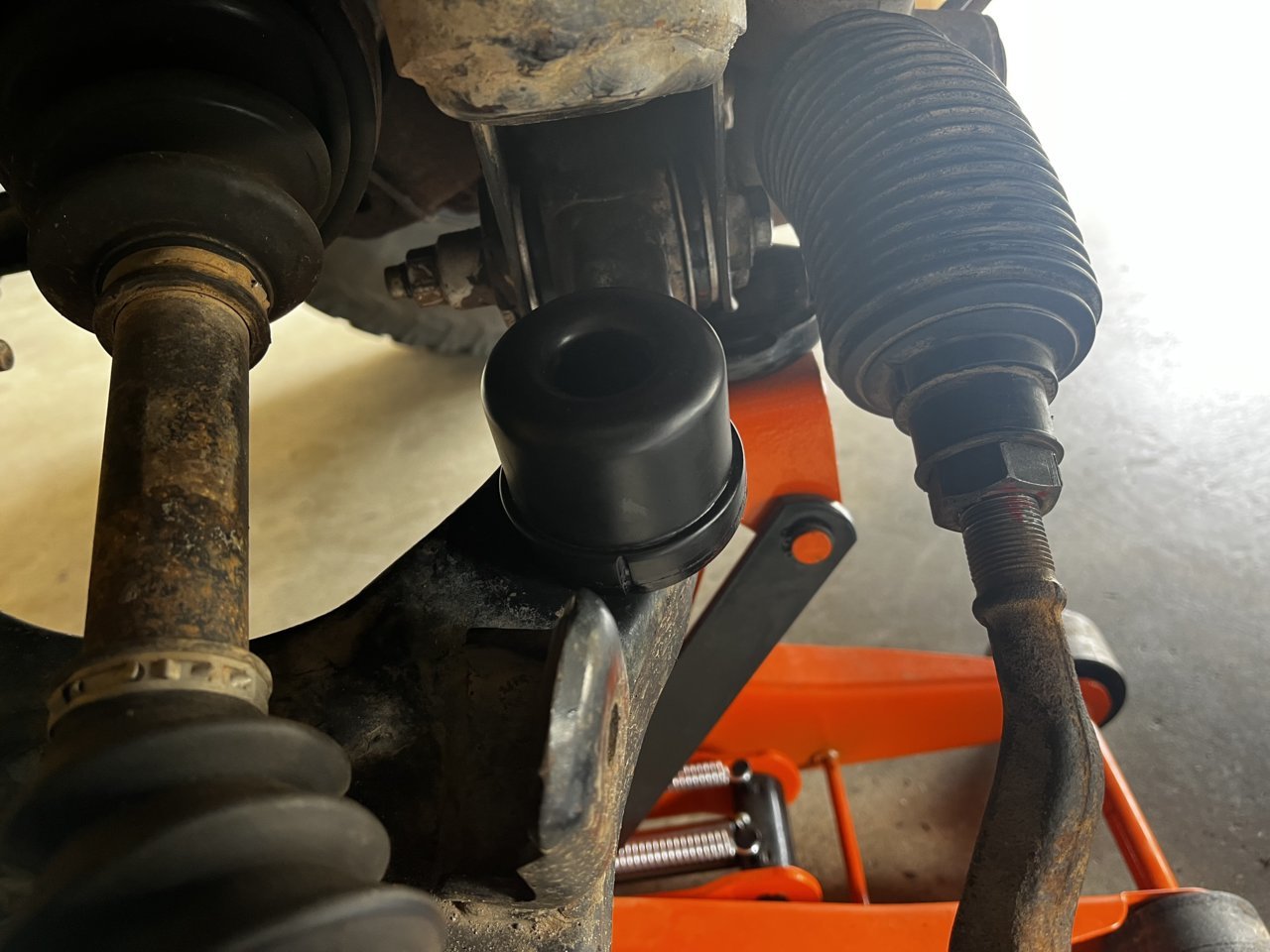

    This weekend I replaced the drivers side inner tie rod…no pics of that.
    I replaced my front bump stops with durabumps.
    I think these two would make a cool hammer.

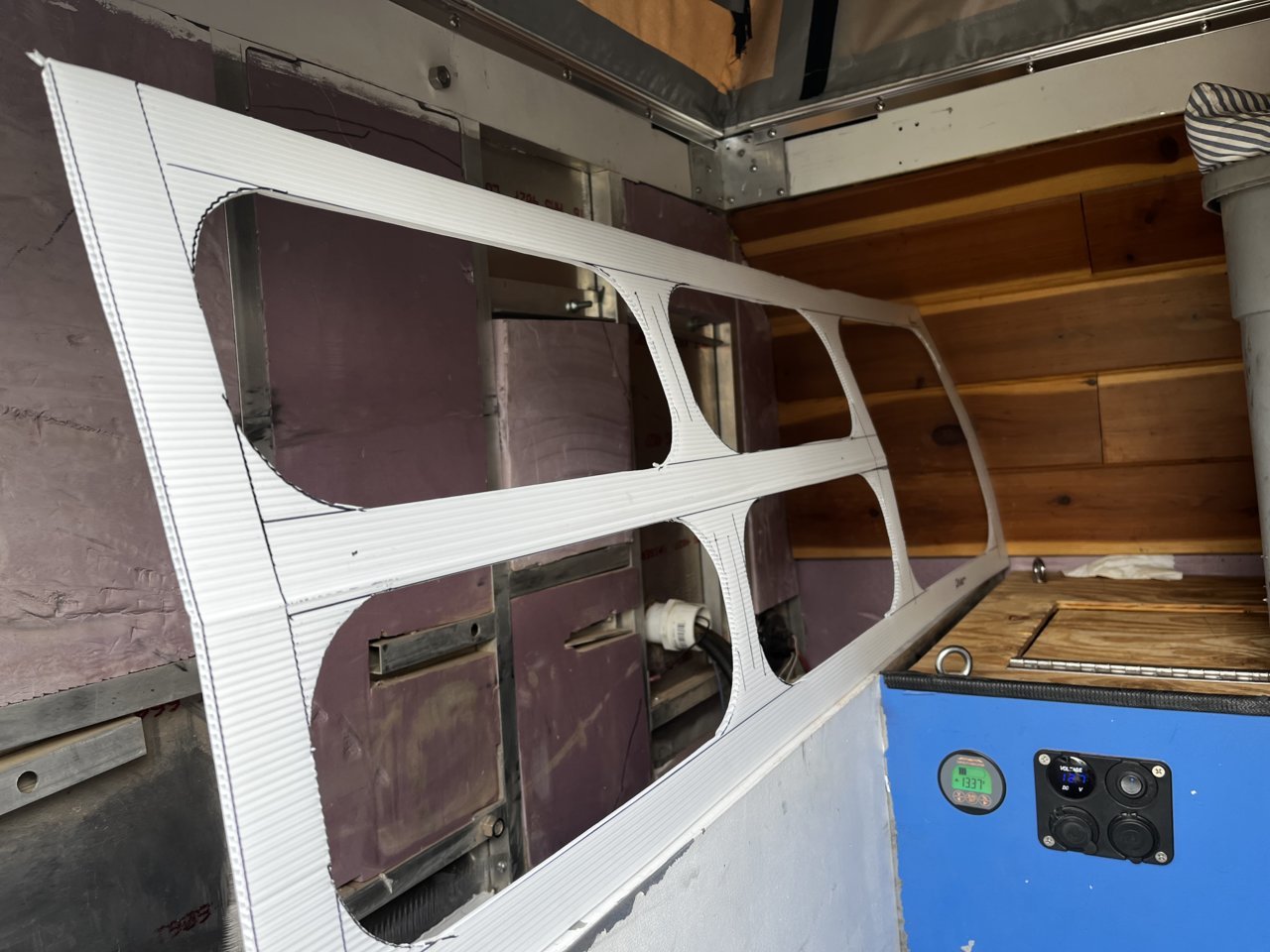

    And made a template for camper shelves
