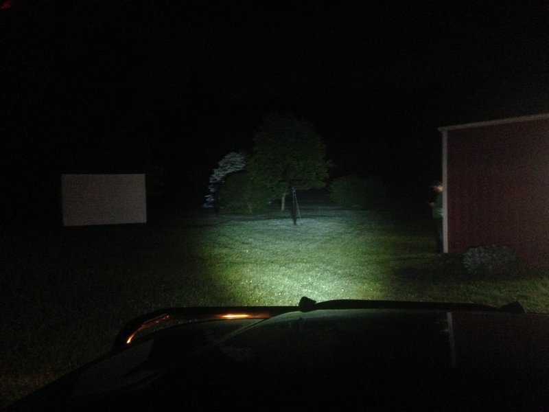

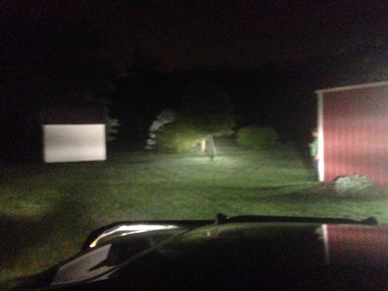

    Well I finialy got it done. What I ended up doing was this.
    #2 #6- jumped together to an add a circuit going to the parking light fuse in the instrument cluster fuse box
    #8 #7- jumped together running to the main chassis ground in the engine bay
    #3- to relay
    **FUN FACT**
    The Bussman 30A add a circuits that can be found at autozone need two fuses in them to work properly, had I known that It would have took half the time to install this light bar.
    Light bar alone
    Light bar with high beams
    For reference the bush in the center of the picture is ~25 yards away, the shed ~15 yards
