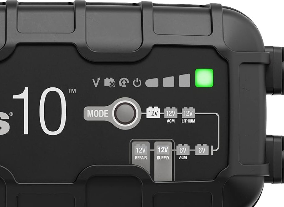

    The app runs on a Windows machine, and (I assume) a USB connection to the interface hardware.
    They recommend buying a $99 Noco Genius 10 12v charger (from Amazon) as a safeguard during flashing to avoid bricking your ECU.

    I recommend a Noco Genius 10 set to the Supply Voltage 12.0V Button for any ecu flashing.
    This is selected by the MODE button which will light the "12V Supply" indicator.
    Don't use any smart charger that doesn't not have the supply voltage setting.
    You will brick your ecu.
    Make sure your PC will not start another program or update windows.

    For what it’s worth, I have flashed a bunch of times and never once used a battery tender to maintain voltage nor have I turned off Bluetooth on my phone. Not saying you should skimp, but it hasn’t ever mattered to me. The flash process being about a minute long means it’s pretty quick and in my experience, as long as I have about 12.4-12.6V at the prepare step, I’m good to go on the flash. And I even have a stock condenser fan added that runs the entire time I do a flash. Nobody else has that. Still fine.
    I should add that I don’t use Bluetooth from my phone to the truck at all (I only use wired CarPlay, not Bluetooth audio stream), and so if communication from the truck to the phone is the concern, then my input is not relevant. So if you do use Bluetooth, then turn it off. If you don’t connect to the truck then it won’t matter.
