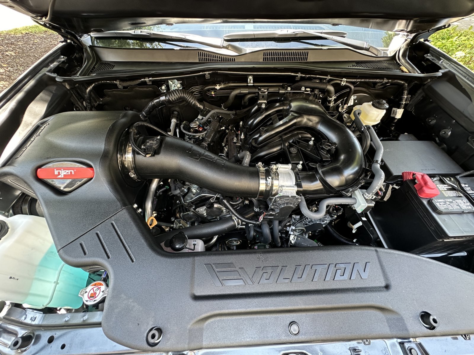

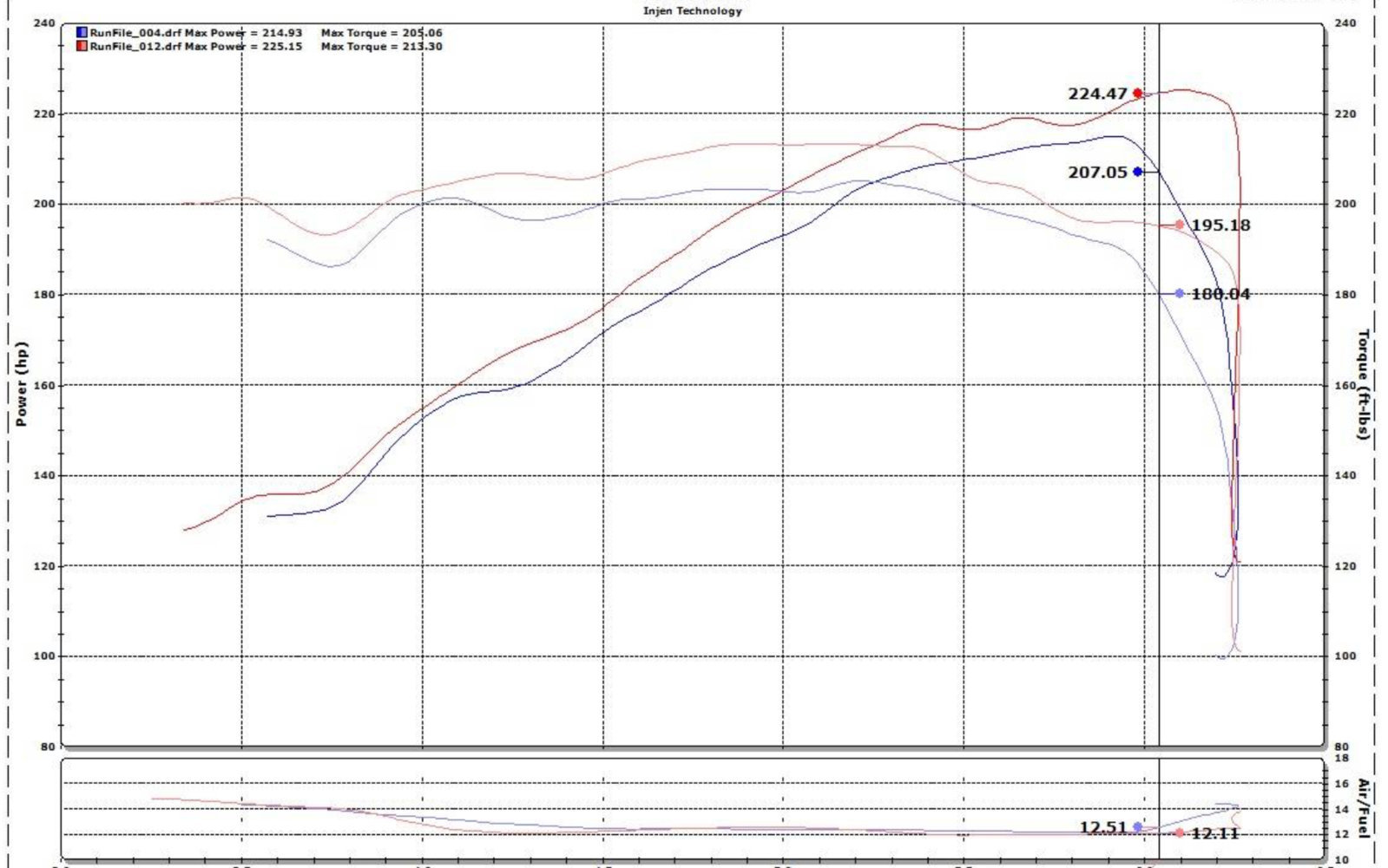

    Totally disagree about CAI’s being worthless. I run Injens Evolution intake and although I installed it before my tune I did notice a difference immediately. Also, intake air temps are significantly better than stock. Injen is also the only company that provides technical data and a dyno for their intake. They make great intakes for many vehicles.

    More power to you,Sir. I disagree. And that is my opinion with experience with them. Closed CAI that pull air from outside the engine bay are true cold intakes and work much better than those KN or Injen open filters with heat shields. No Go.

    I have logs that show otherwise. I’m not making this up. I don’t have a dyno but I do know for a fact that stock IAT’s were 8 - 12 degrees higher vs the Injen intake. I see as little as 1 degree over ambient on the Injen intake at highway speeds. Injen pulls air from two places. The fender and above the radiator.

    I appreciate your response and experience I just don’t care for these parts bc they don’t perform for the money; I like to put my money in parts that make more of a difference. I did like the sound the KN intake made but it wasn’t changing the power that I could tell at all.

    On NA engines you don’t tend to gain much anyway. Though IAT’s help with timing and the more advance the better. It also sounds great. Is it worth $350, I guess that depends on the user.
