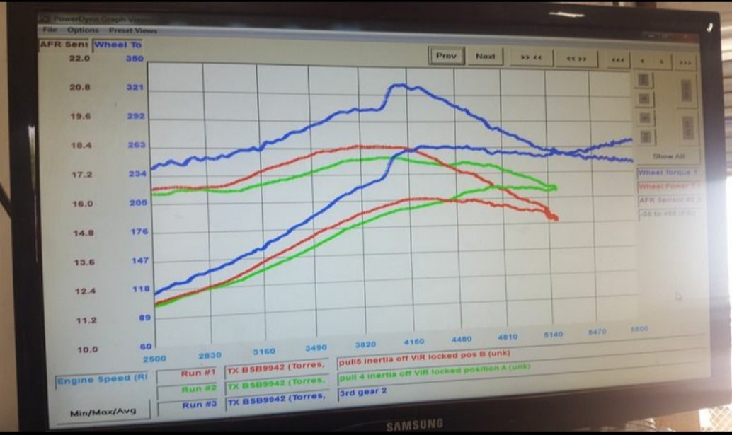

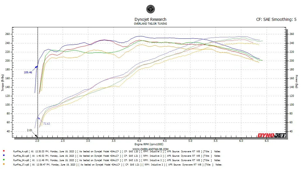

    Looks like two of the tunes are making less power than stock across most of the rpm band.
    Do any of the other tuners provide the same Dyno data? I only ever see butt dyno claims of 3rd gens popping wheelies and beating raptors light to light after getting tuned.:notsure:

    I read all of it.
    And the question I’m left with is?
    What is the dip in HP/TQ between 3,500-4,000 RPM?
    What’s happening here to cause the dip?
    Are the intake runner flaps moving?
    As one can tell, I’m not concerning with the “tunes” and who is “better”.
    IronratPR likes this.

    717
    I’ve wondered the same thing. Could be intake runners, valve timing, a switch from direct to port…. I’d be interested to know.

    The dip you're referring to is the ACIS system (intake runner flap) creating a turbulence/disturbance in the plenum that affects the resonance tuning gains the system generates. It's a byproduct of how Toyota designed the plenum on this platform. Taking advantage of the longer runners the system creates, tunes the intake system to produce power at lower RPM ranges in comparison to shorter intake runners which are tuned to frequencies more conducive to high RPM output. The crossover point or where the ACIS system crosses over from long runner to short runner mode will suffer a dip on this application unless it's moved to a point low enough in the RPM range where the system is not yet improved the VE of the engine enough to make an appreciable difference in the torque. This can be offset by other methods to boost torque (increasing ignition advance), but the VE improvements of the ACIS system cannot be matched by changing cam timing, increasing ignition timing, or through AFR tweaks. Toyota knew this and it's been in use on various Toyota engines for quite some time through various names (TVIS, ACIS, etc).

    I had a suspicion that’s what it was.
    I do believe there were tests done on the 1GR with the runners pinned open and closed.
    The conclusion was, leaving the runners active resulted in better numbers over all.
    Thanks for the reply.

    That's correct. @Torspd had done this testing on the 1GR. The design of that intake manifold (thankfully) doesn't create the disturbance that is found in the 2GR-FKS manifold.
