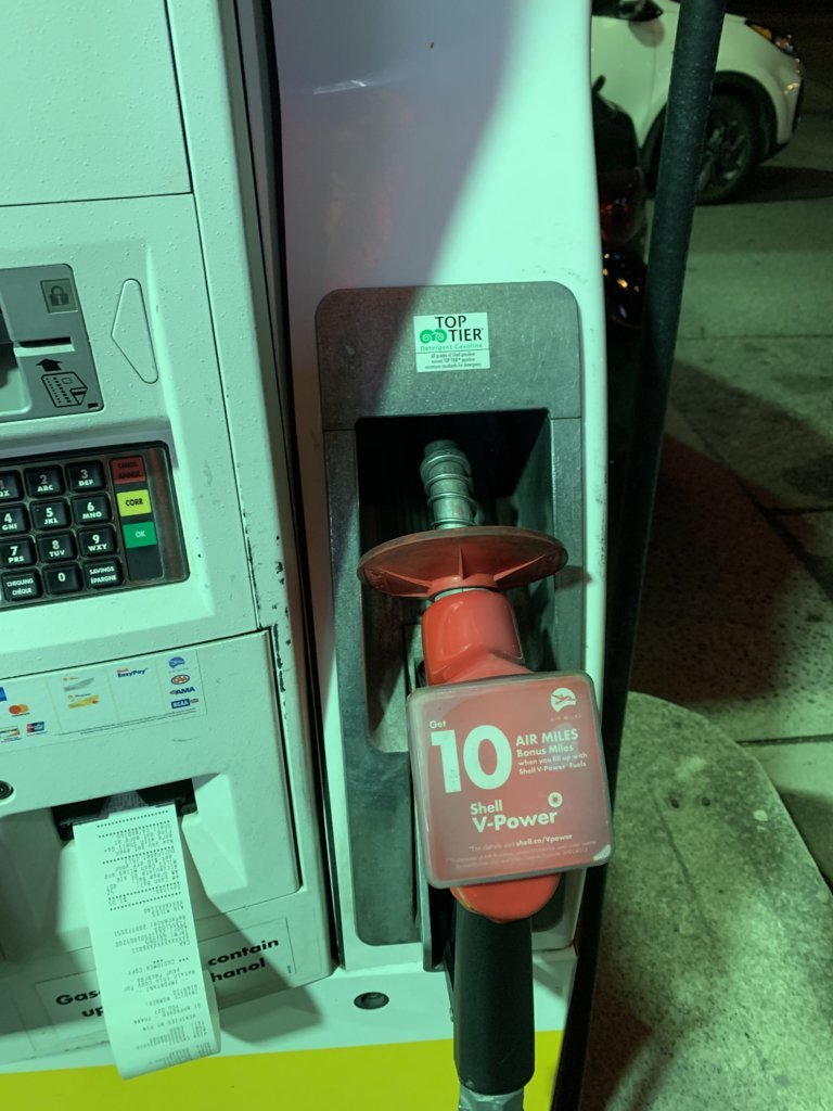

  18. May 12, 2025 at 3:05 PM
    #18
    SimonSaysBoo
    SimonSaysBoo Member
    May 8, 2025
    #470851
    15
    Tacoma 2.7
    Induction, Ceramics, Wrangler Kevlar, Shell VP
    Worked in upstream and downstream etc etc..
    Shell V Power if you can afford it. If not Exxon Mobile for Regular. BP is in the Middle. All others are below these.
    It's about detergents.
    (Costco fuel is also ok)
